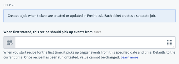

Step 2 - Define input fields
This component tells Workato what fields to show to a user configuring this trigger. In this case, we want a simple input field that allows a user to pick a timestamp value. This will be used in our trigger code later on to pull tickets created/updated before the recipe was started. This is a great tool to provide to users of your connector for retrospective syncs of data.
input_fields: lambda do |object_definitions|
label: 'When first started, this recipe should pick up events from',
type: 'timestamp',
optional: true,
sticky: true,
hint: 'When you start recipe for the first time, it picks up ' \
'trigger events from this specified date and time. Defaults to ' \
'the current time.'
end
New/updated ticket input fields
Various other key value pairs exist for input/output fields other than the ones defined above. Refer to Input fields for more information.
