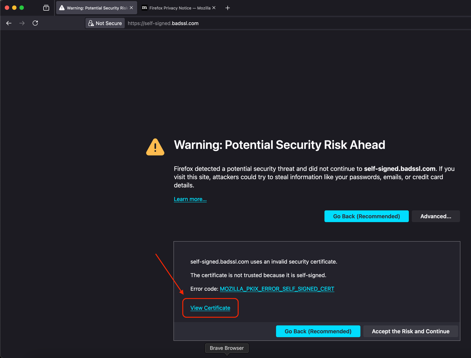

Open a browser like Firefox and go to a secure page that uses a self-signed SSL certificate. For example: https://self-signed.badssl.com/.

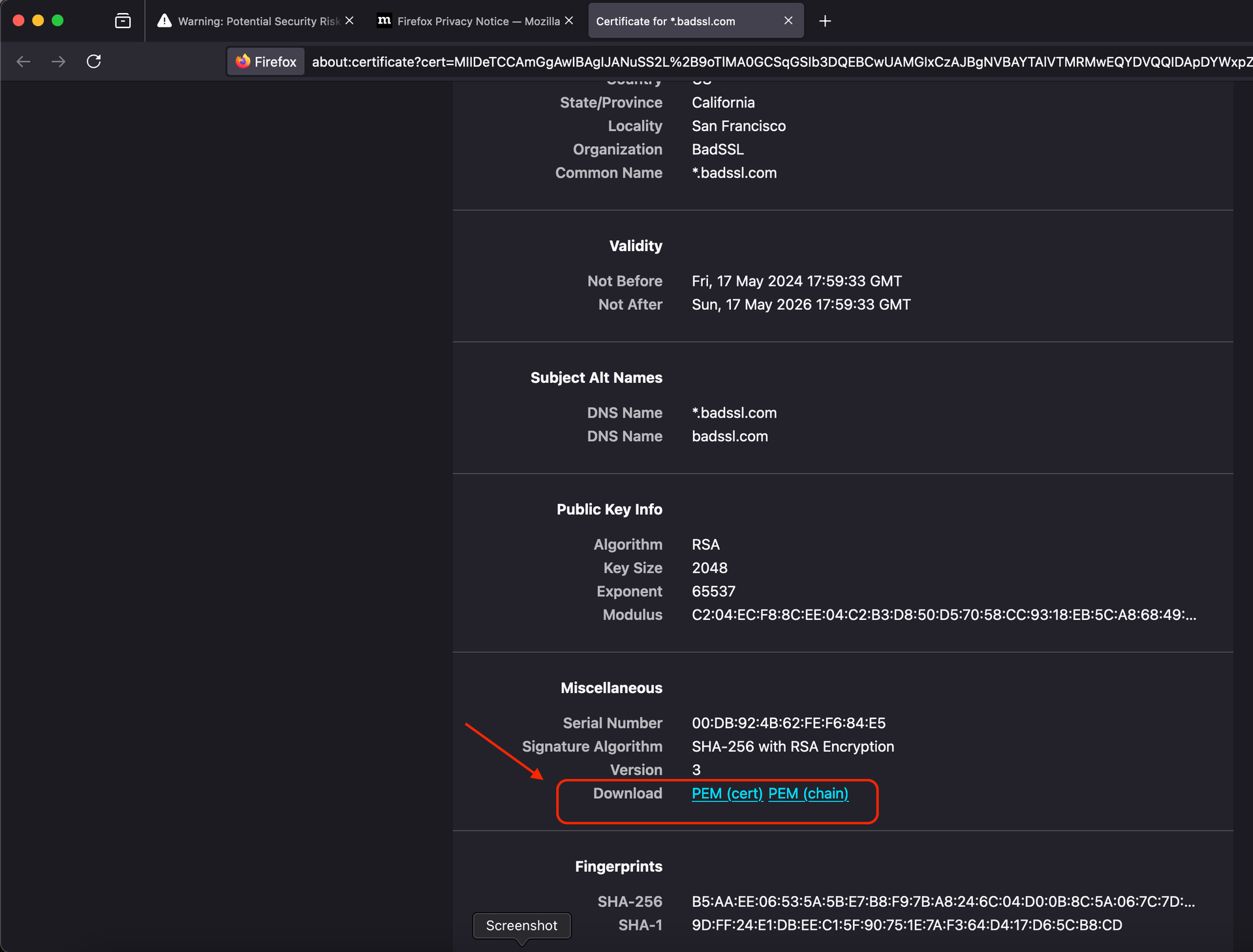

Click Advanced… > View Certificate to display the certificate details.
Obtain the certificatesObtain the certificates
Click PEM (chain) to download the full certificate chain as a .pem file.
Download the certificate chainDownload the certificate chain

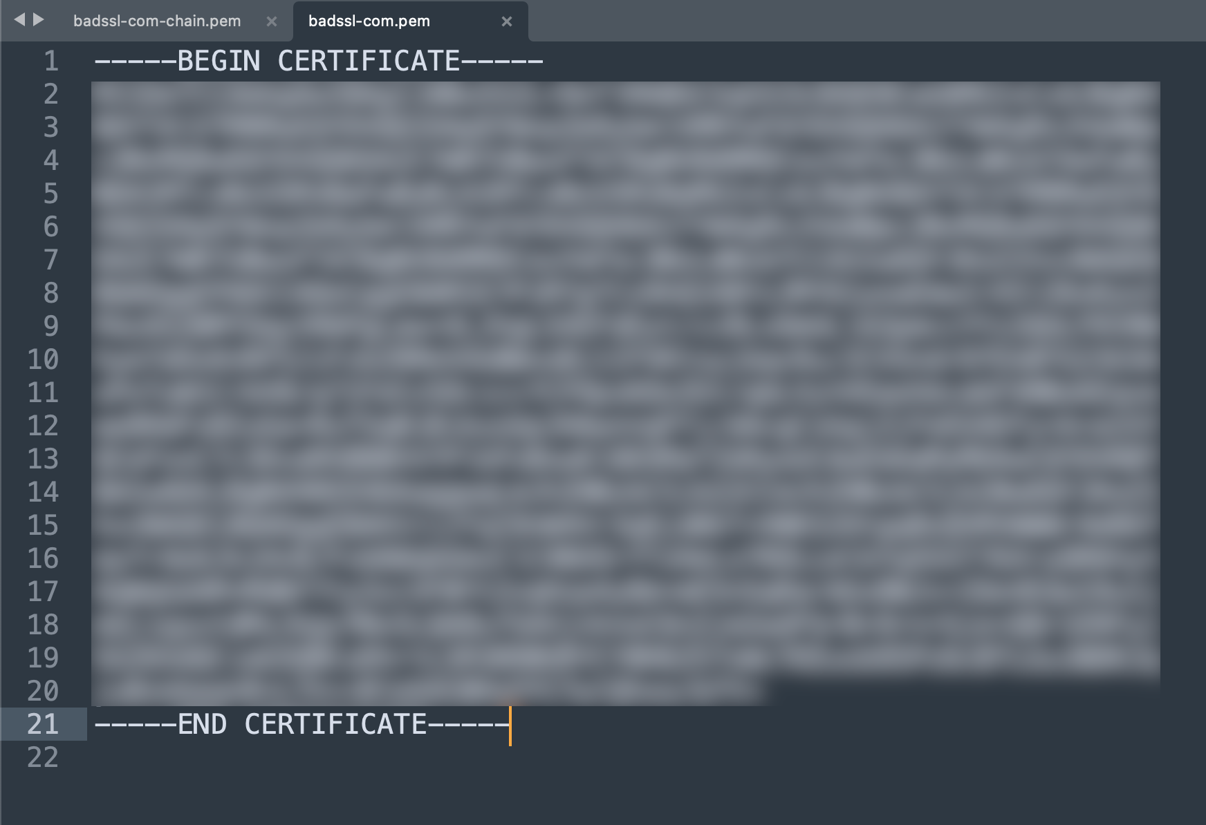

Open the downloaded file in a text editor. Confirm that it includes one or more certificates, each wrapped in -----BEGIN CERTIFICATE----- and -----END CERTIFICATE-----.
Open the downloaded certificate using a text editorOpen the downloaded certificate using a text editor
Copy the full certificate content, including all BEGIN/END blocks.

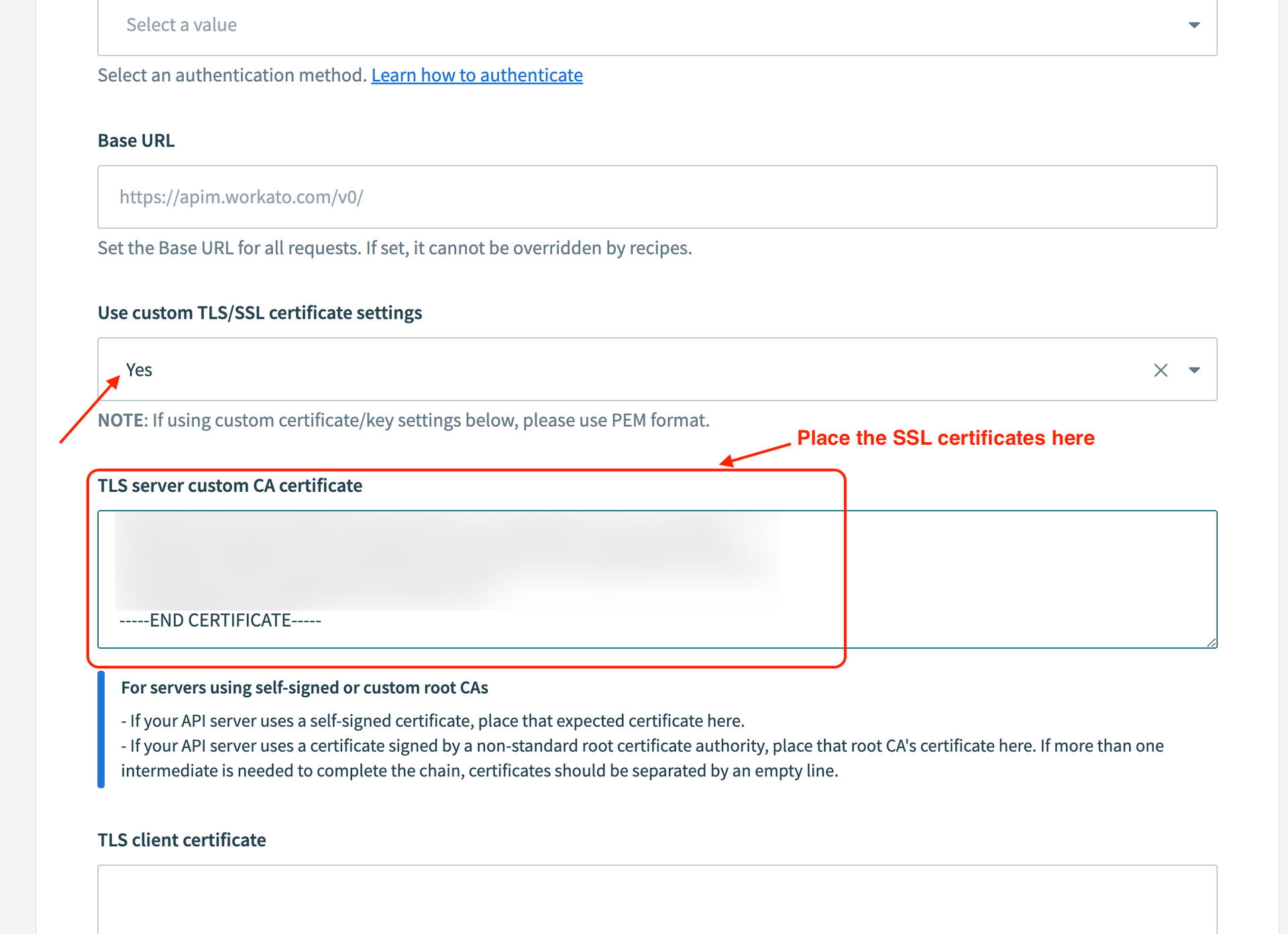

Set the Use custom TLS/SSL certificate settings field to Yes.
Paste the downloaded certificate chain in the TLS server custom CA certificate field.

Separate each certificate with a blank line if the chain includes more than one.
Paste the downloaded certificate contentsPaste the downloaded certificate contents

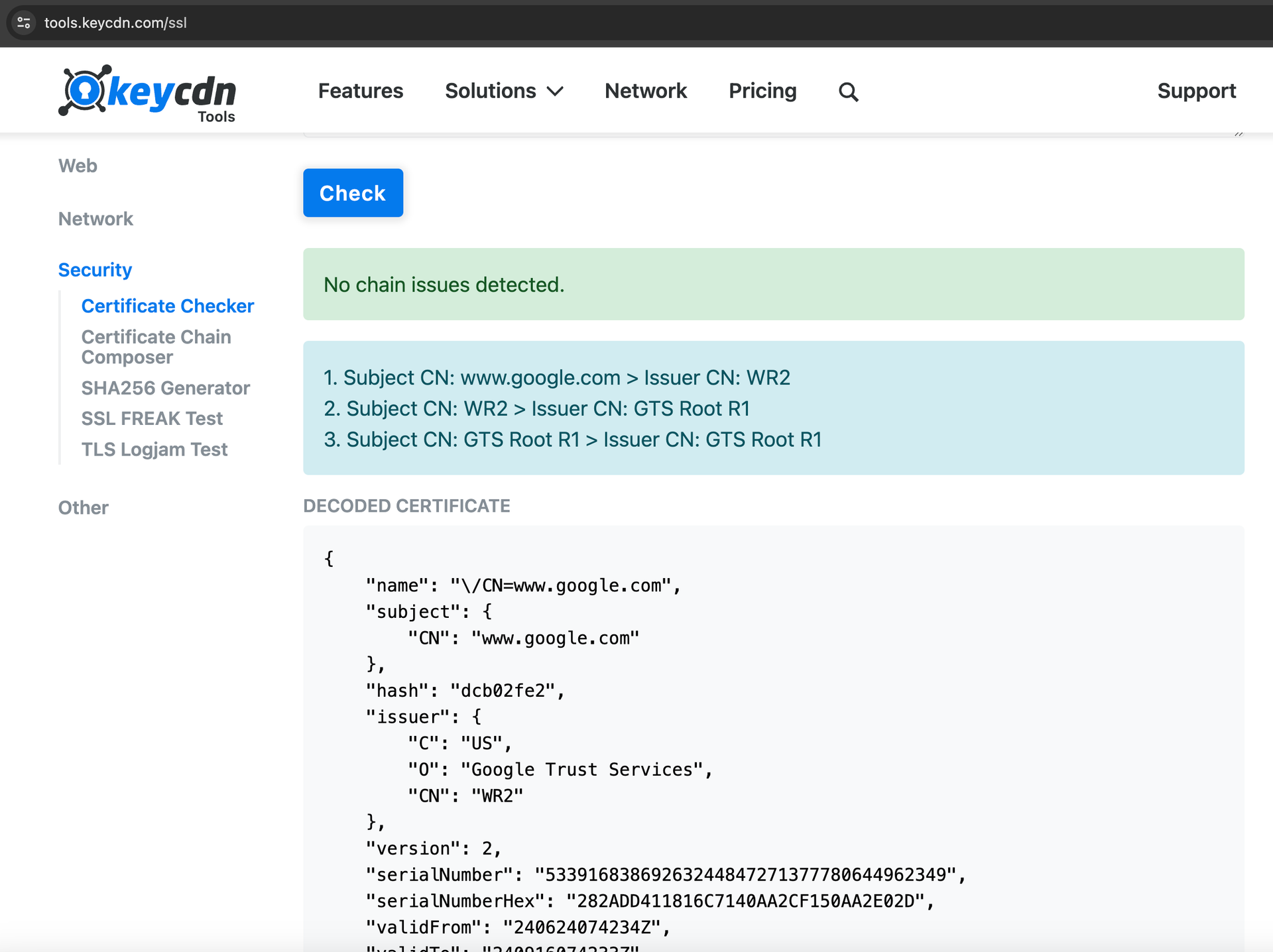

Check the certificate chain with a tool such as KeyCDN SSL Checker to confirm that the target server returns a valid and complete chain.
Example of a certificate chain check for https://www.google.comExample of a certificate chain check for https://www.google.com
