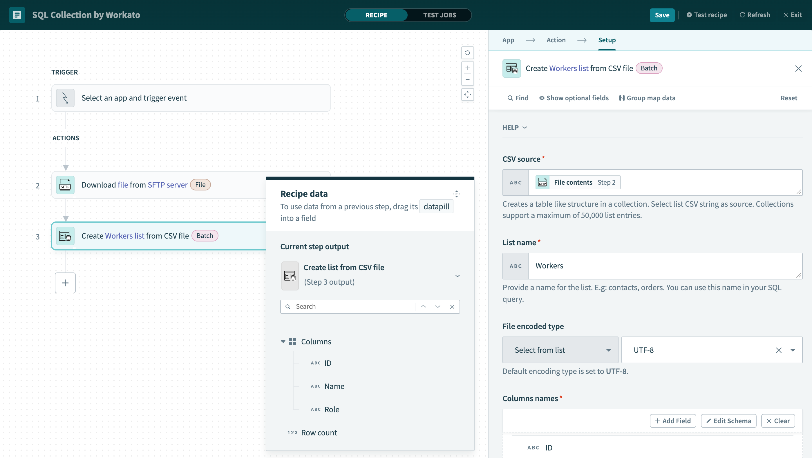

SQL Collection by Workato
SQL Collection by Workato is a robust native application that provides you with the tools required to manipulate table data. You can use SQL Collection to synchronize related data across multiple systems, such as databases, web services, and more.
SQL Collection by WorkatoSQL Collection by Workato

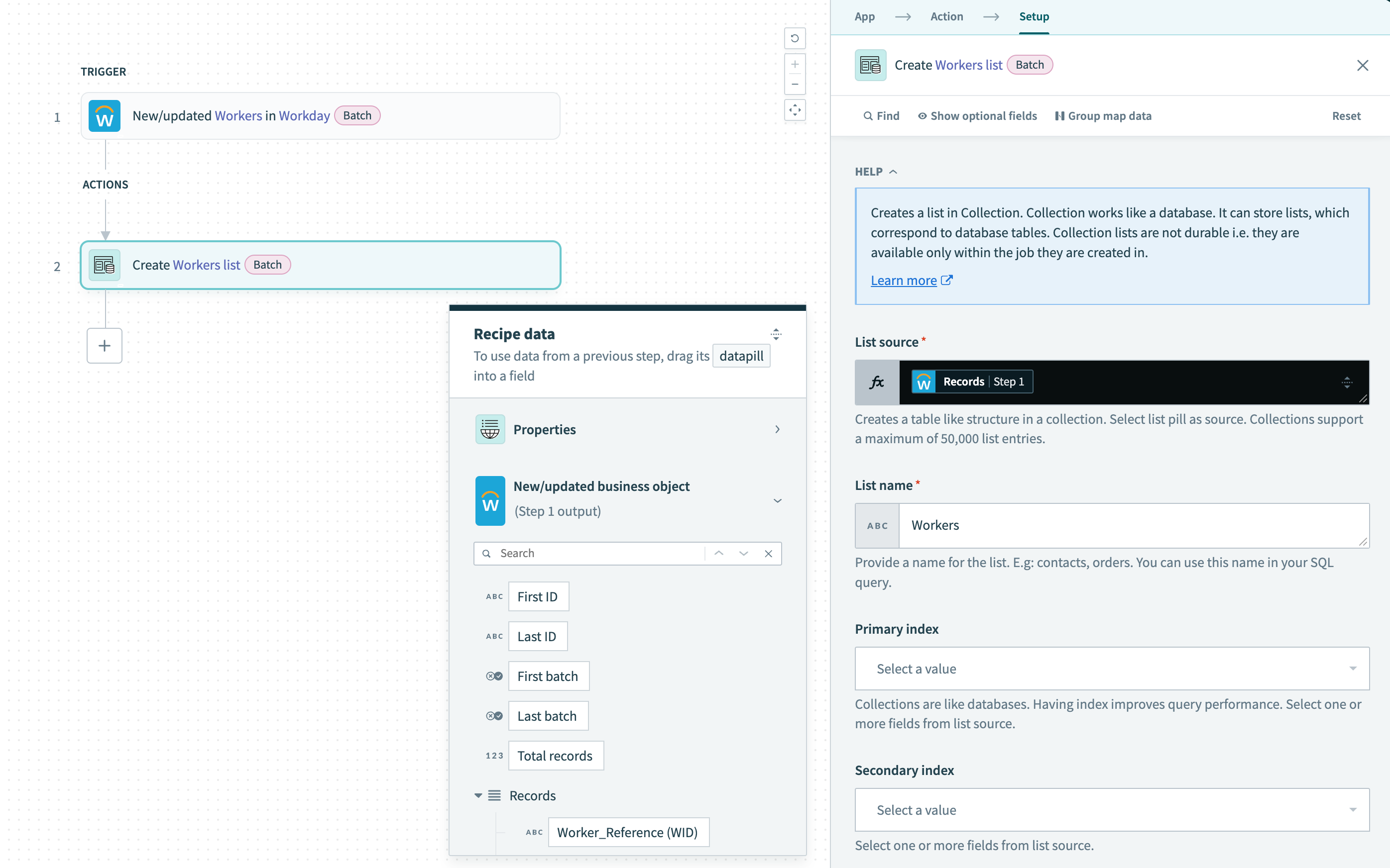

Create list in SQL Collection action
This action creates a SQL Collection list in the recipe from a list input. The SQL Collection list contains the column headers according to the schema of the list.
Note that the List source field must be in formula mode when you add a list datapill.
For example, you can take a list of all workers from Workday.
Create list in SQL CollectionCreate list in SQL Collection
Input fieldDescription
List sourceSelect a list datapill. Ensure that this field is in formula mode.
List nameThe name of the list.
Index primarySelect one or more columns as the primary index of your list.
Index secondarySelect one or more columns as the secondary index of your list.

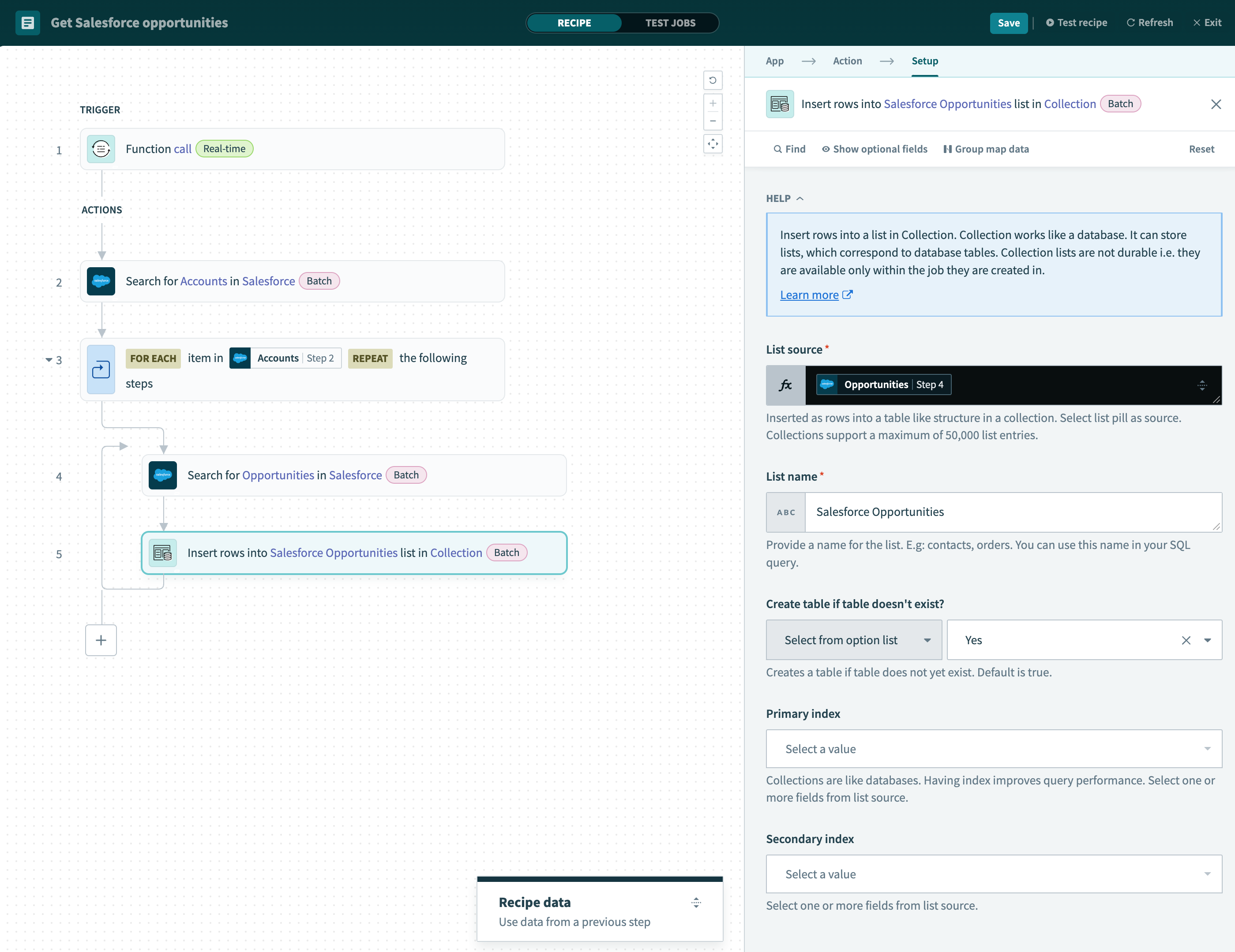

Insert rows in SQL Collection action
This action inserts rows into a SQL Collection list in the recipe from a list input. The SQL Collection list contains the column headers according to the schema of the list. You can use this in a repeat loop.
Insert rows into list in SQL CollectionInsert rows into SQL Collection
Create table if table doesn't exist?Creates a table if table does not exist.

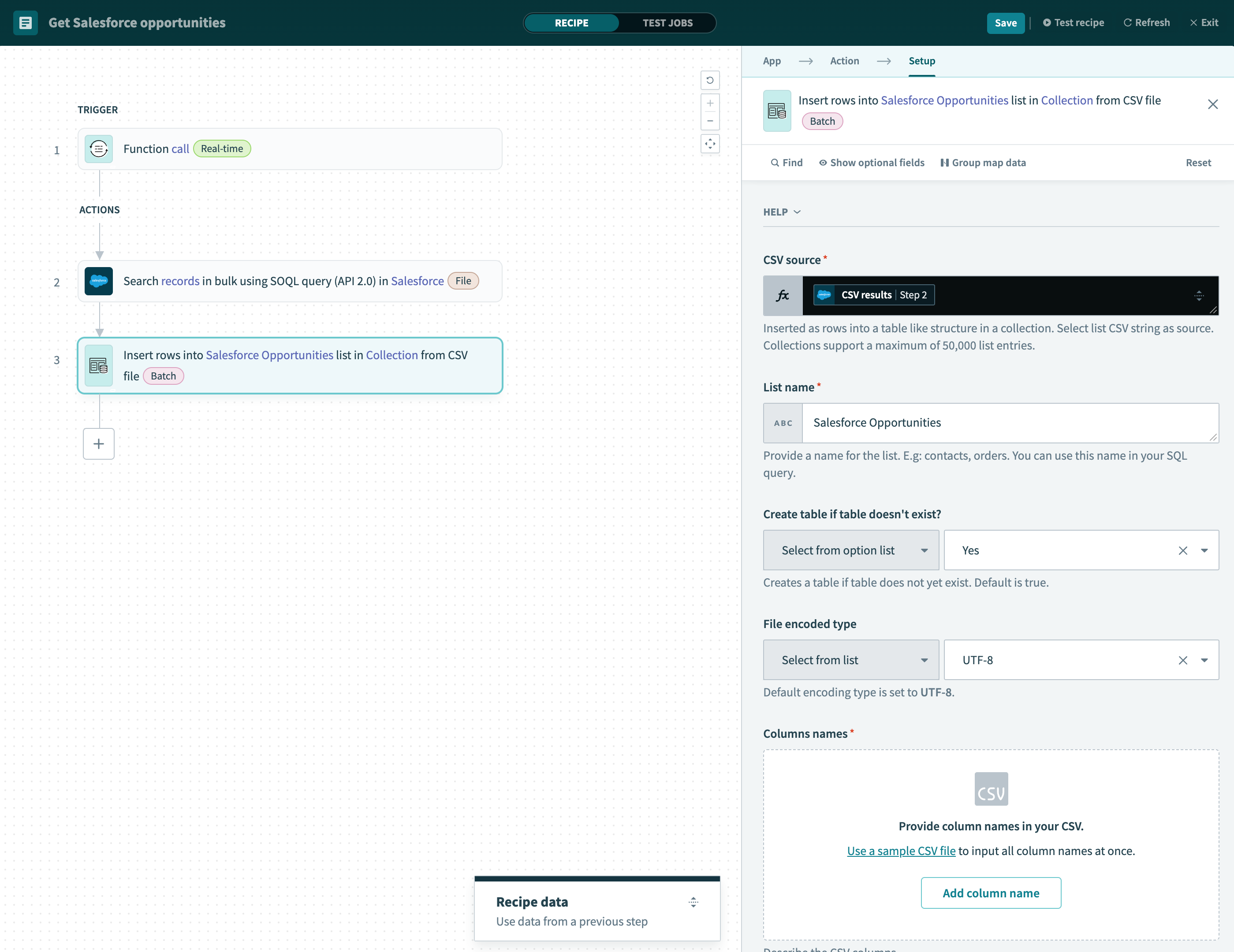

Insert rows in SQL Collection from CSV file action
This action inserts rows into a SQL Collection list in the recipe from a CSV file. It will contain the column headers according to the schema of the CSV string.
Insert rows into list in SQL Collection from CSV fileInsert rows into SQL Collection from CSV file
CSV sourceSelect a CSV string as source input.
File encoded typeSelect the file encoded type. The default value is UTF-8.
Column namesThe column headers in your CSV source input. Select use a sample CSV file to define your schema with a CSV file.
Ignore CSV header rowSelect Yes if the CSV source has a header row, otherwise select No.
Column delimiterSelect the character used to separate value in each line of the CSV.

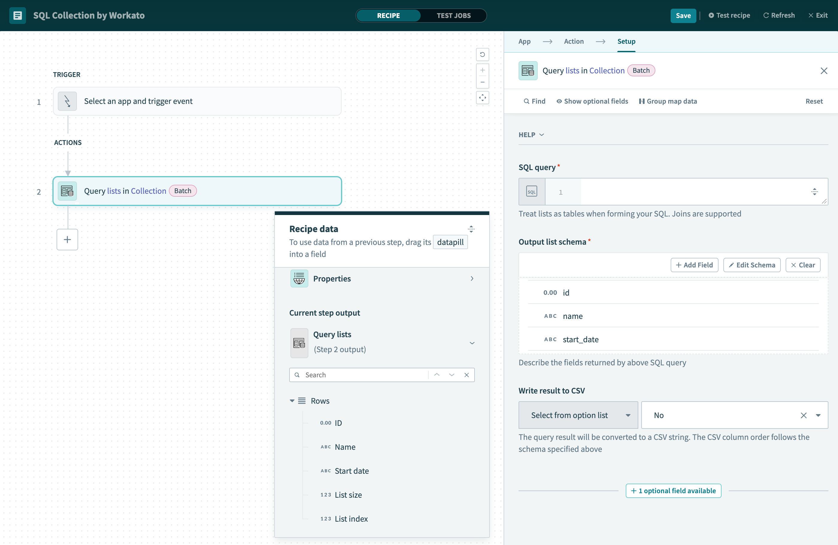

Query list in SQL Collection
This action allows you to perform standard SQL queries on your lists.
Query list in SQL CollectionQuery list in SQL Collection
SQL queryWrite your SQL query. Normal SQL syntax applies.
Output list schemaDefine the schema according to your column headers in your output list. Select use sample JSON to define your schema with JSON.
Write to CSVSelect Yes to convert the query results to a CSV string, this will display the input fields below. To use this query output in further SQL queries, select No.
Add CSV headerSelect Yes to use the column names as a CSV header row, otherwise select No.
Column delimiterSelect the character used to separate values in each line of the CSV.
Here are some commonly used SQL keywords that can be used in the Query list action.
SQL keywordsDescription
SELECTUse the SQL wildcard * to call all the columns in this list.
WHEREDefine conditions that specify what data you want to retrieve from the list.
JOINUse JOIN, LEFT JOIN, INNER JOIN to combine lists.
INSERT INTODefine new entries for your list.
DELETEDefine rows to remove from your list.
Remember to query the full list before exporting or loading it into your target systems. Some SQL keywords (for example, INSERT INTO, DELETE) do not return list outputs. Therefore, datapills from these actions do not contain all the rows/columns in your SQL Collection list.

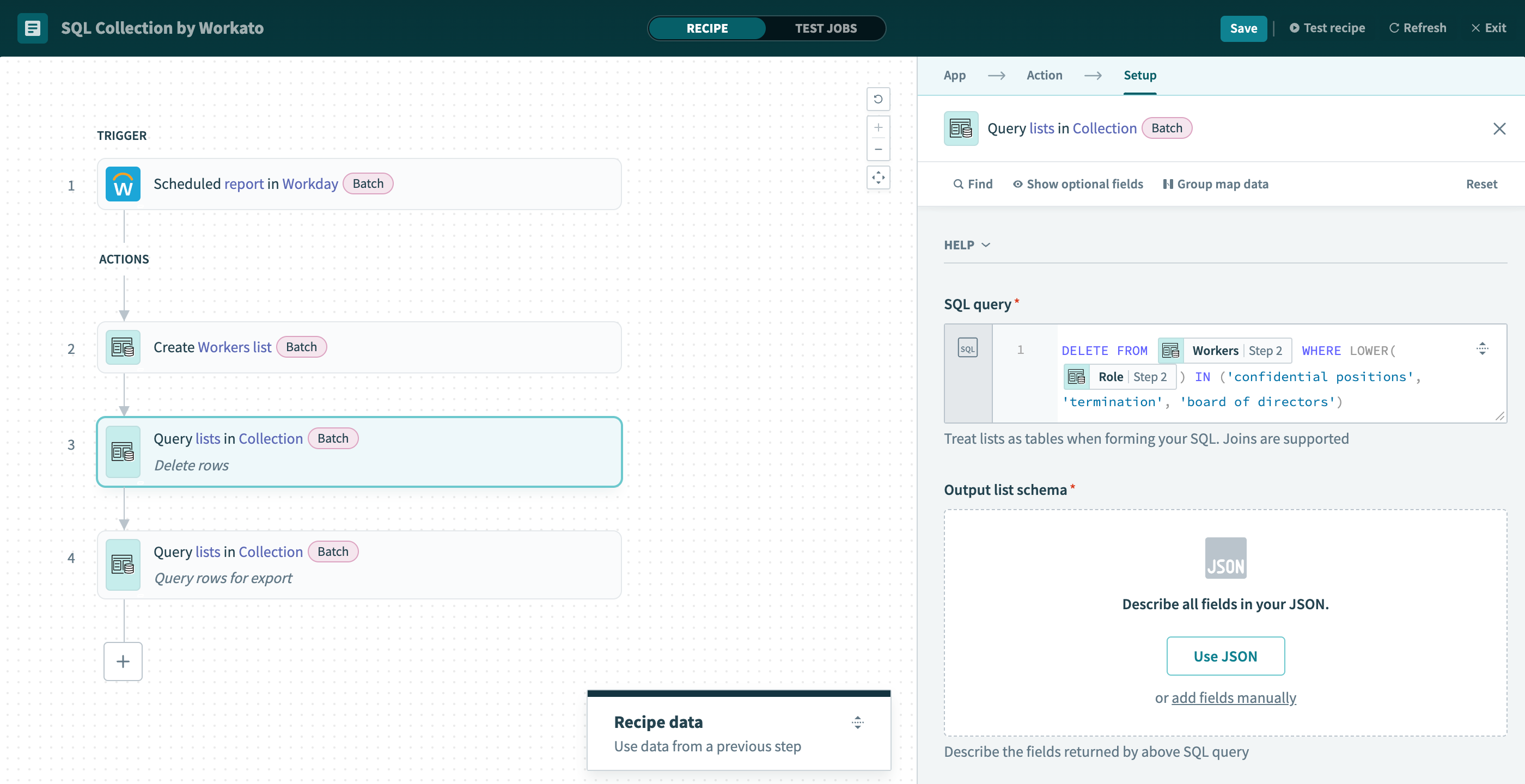

Example query: delete rows from list
For example, you can tailor your workers list from Workday to exclude certain groups of people.
Delete rows with Query list in SQL CollectionDelete rows with Query list in SQL Collection
Since a DELETE query does not return a list output, datapills from this step should not be used to export your list.

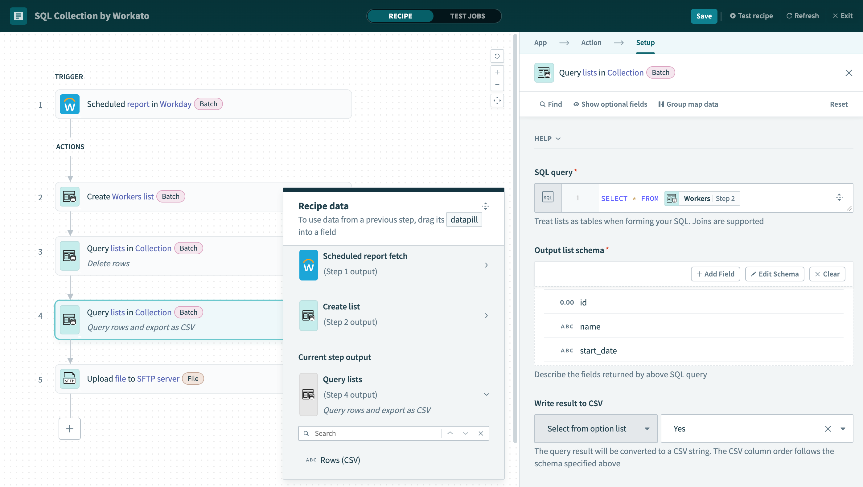

Example query: Export SQL collection as CSV
Export rows as CSVExport rows as CSV
Run a SELECT query to retrieve all rows from that SQL collection.
sql
SELECT * FROM workers_list
Next, select Write to CSV in the action configuration. The output of this action can be directly exported as a CSV file.
