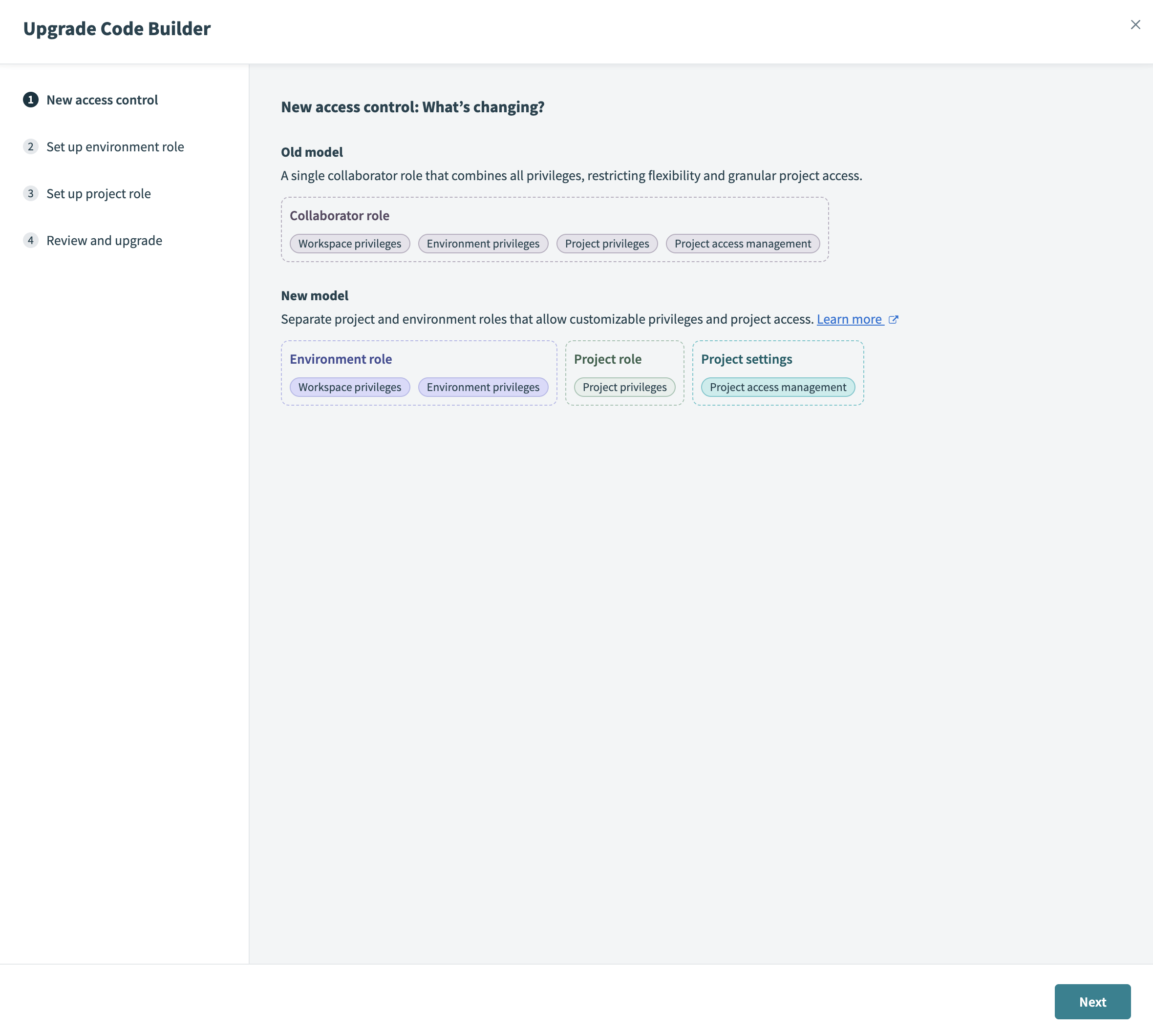

Workato's new access control model replaces collaborator roles with environment roles and project roles. This separation improves flexibility, clarity, and project-specific access control.
Using the bulk-migration tool follows a two-step process. The tool first generates a staged report at an individual-collaborator level that lists the new environment role each user receives, the collaborator groups they join, and the project roles they hold for each project. After you review the report, you can run the full migration.
The migration wizard analyzes all legacy collaborator roles, consolidates their permissions into new environment and project roles, and creates collaborator groups that reflect existing access patterns. It supports bulk migration, generates a summary report, and preserves equivalent access levels across your workspace.

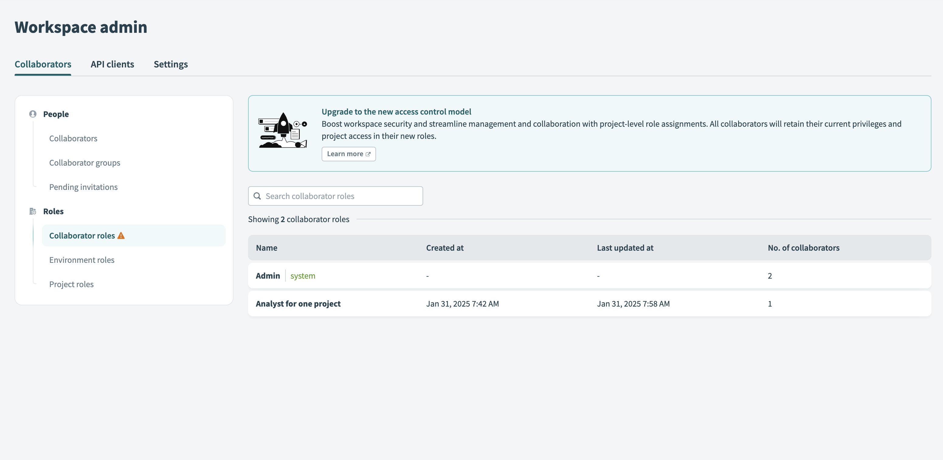

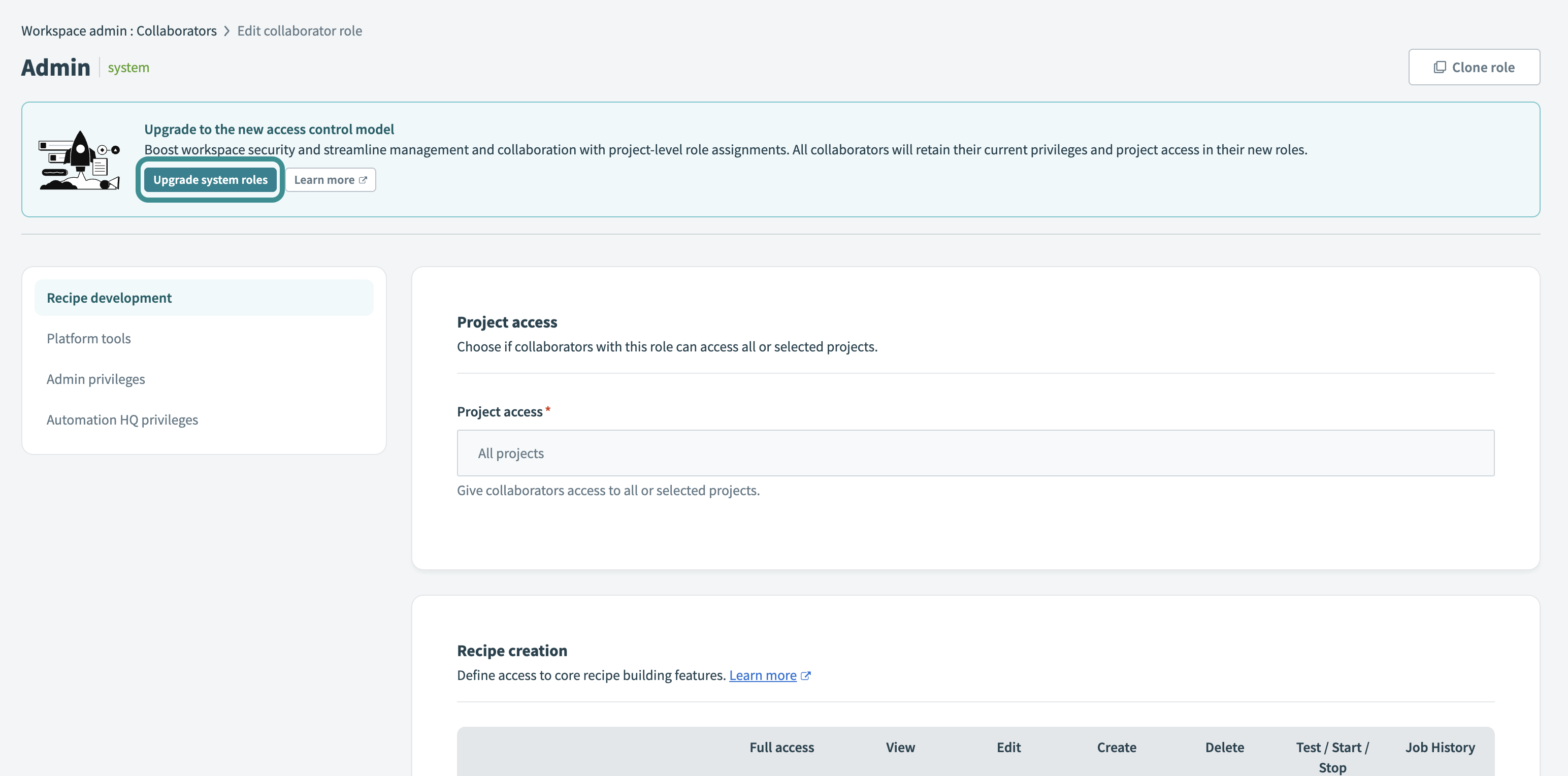

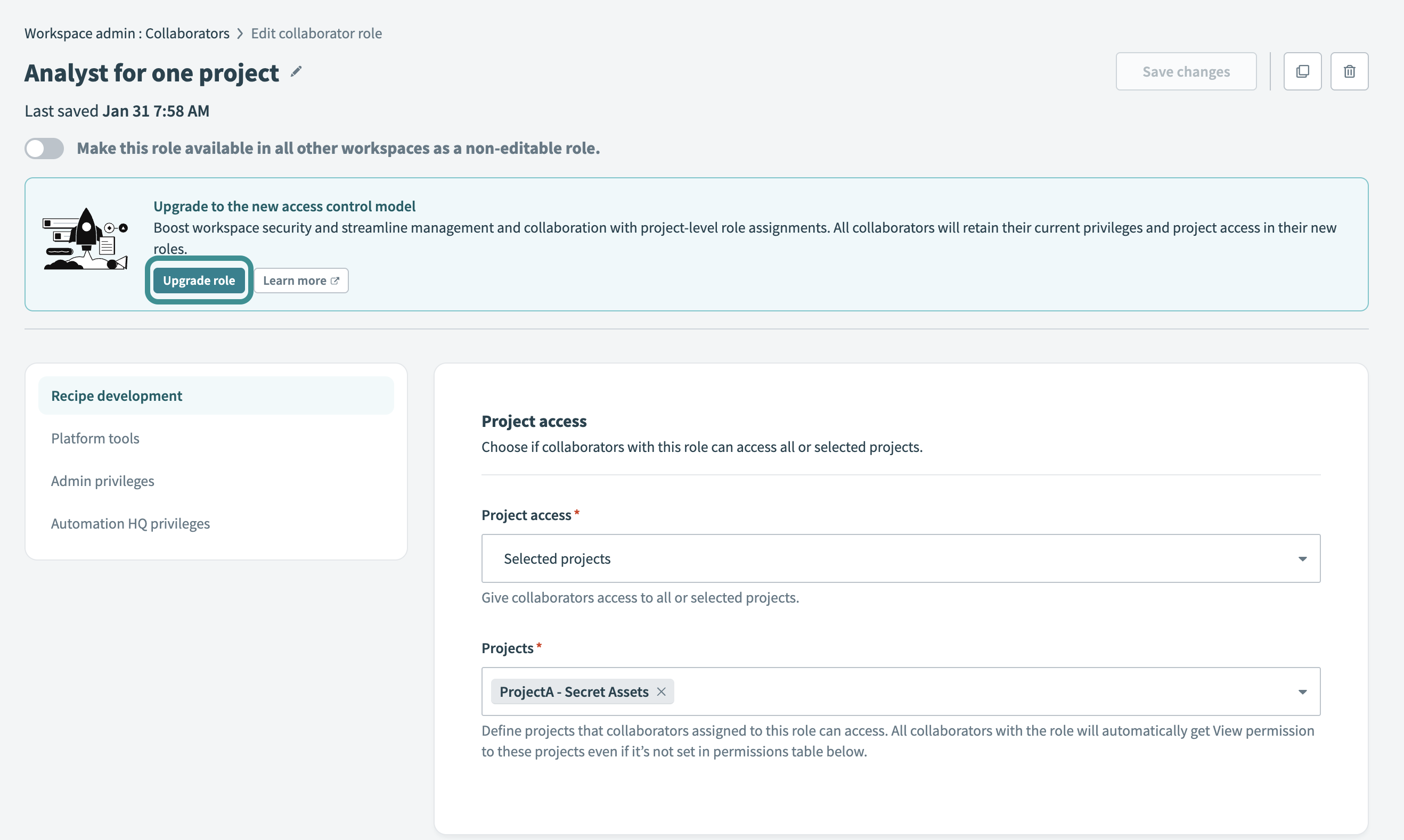

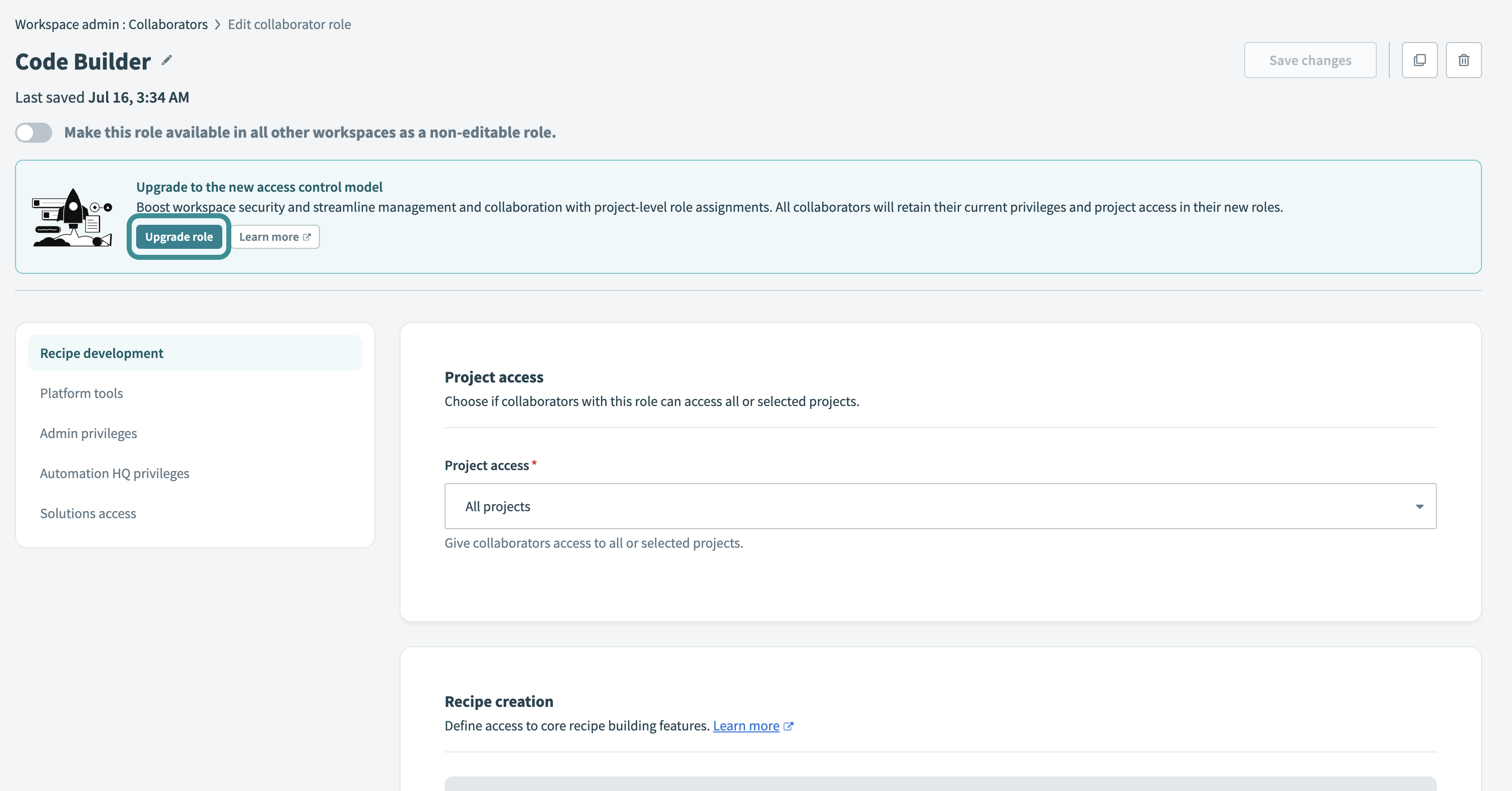

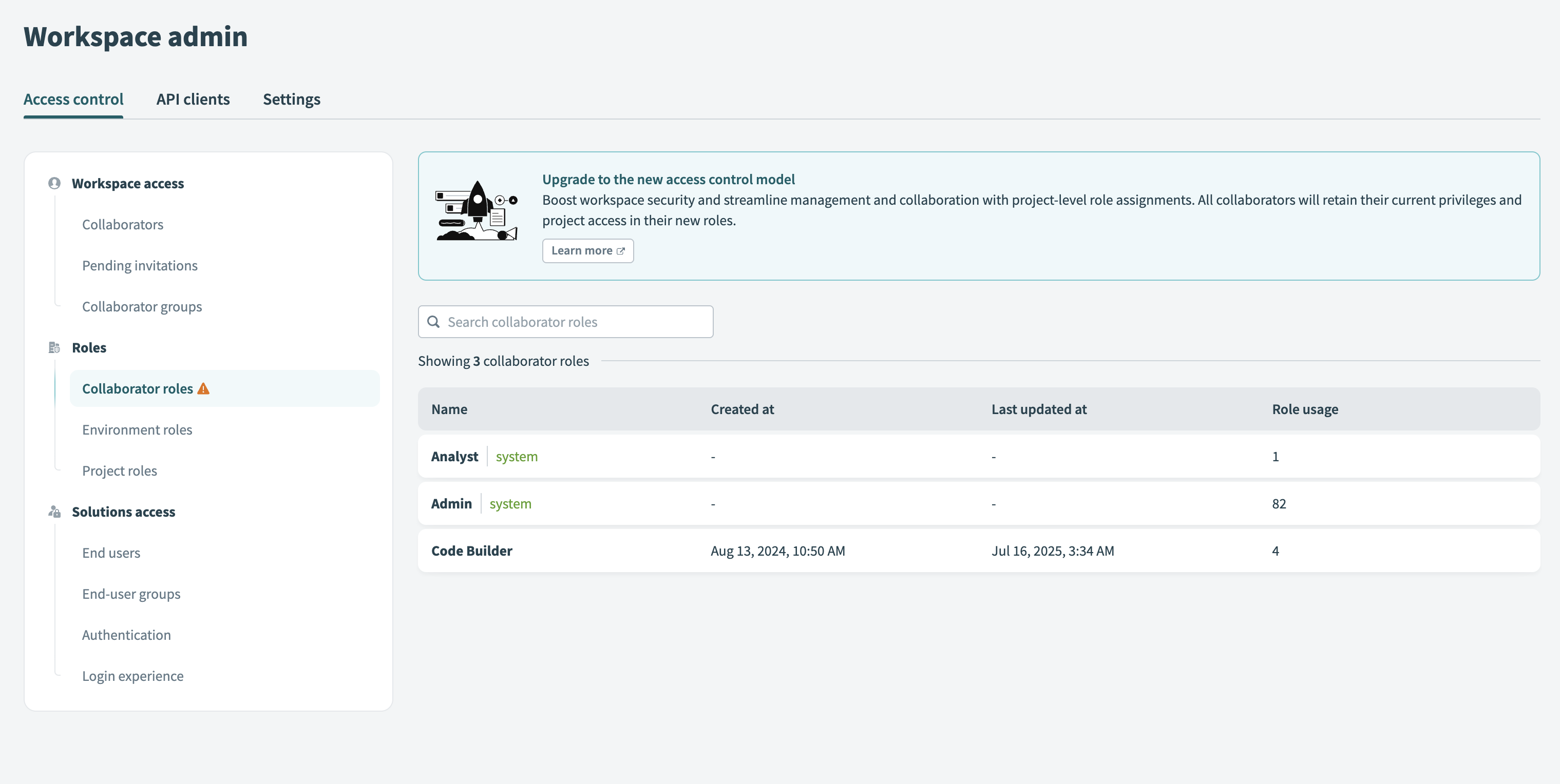

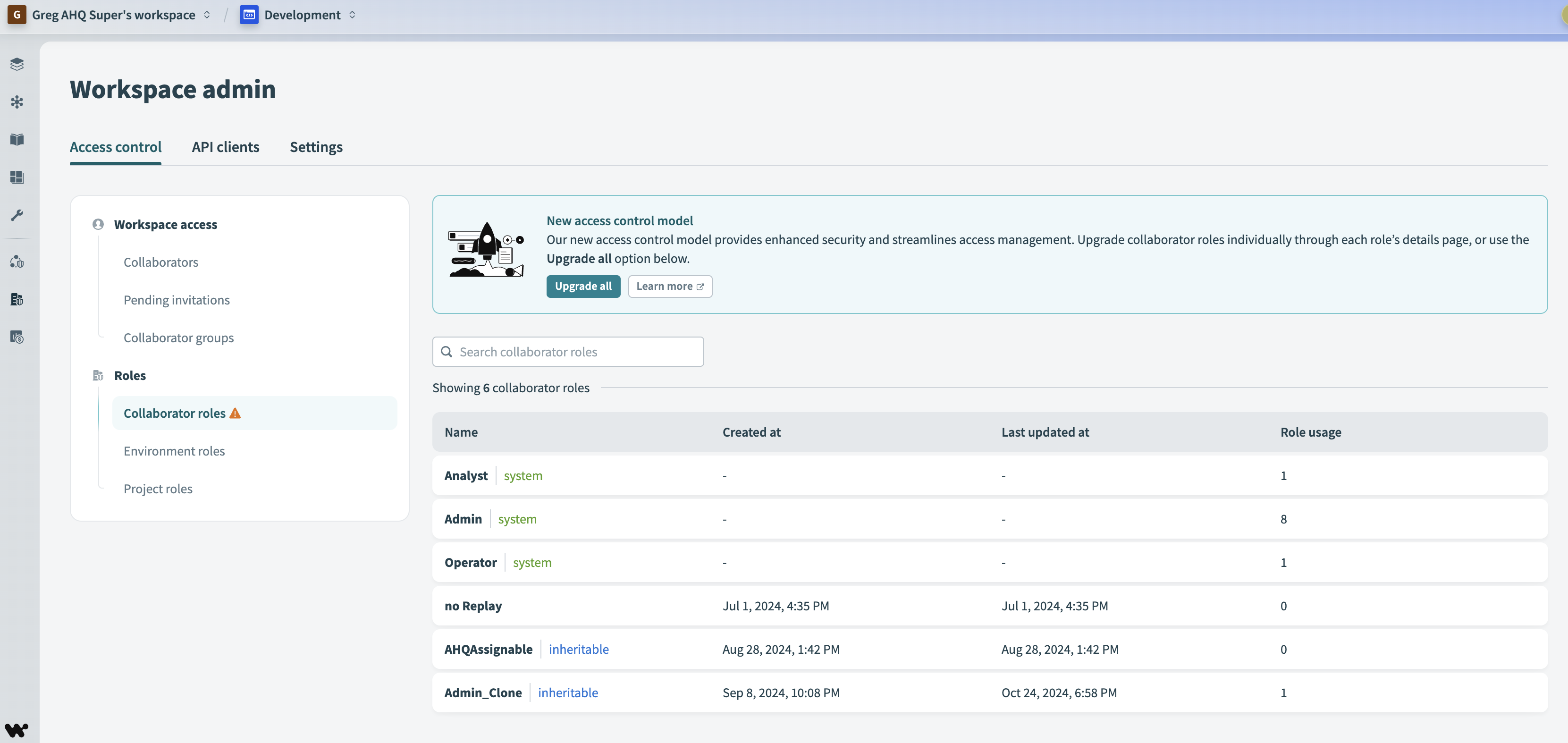

Go to Workspace admin > Access control > Collaborator roles.
Click Upgrade all in the banner to open the migration wizard.

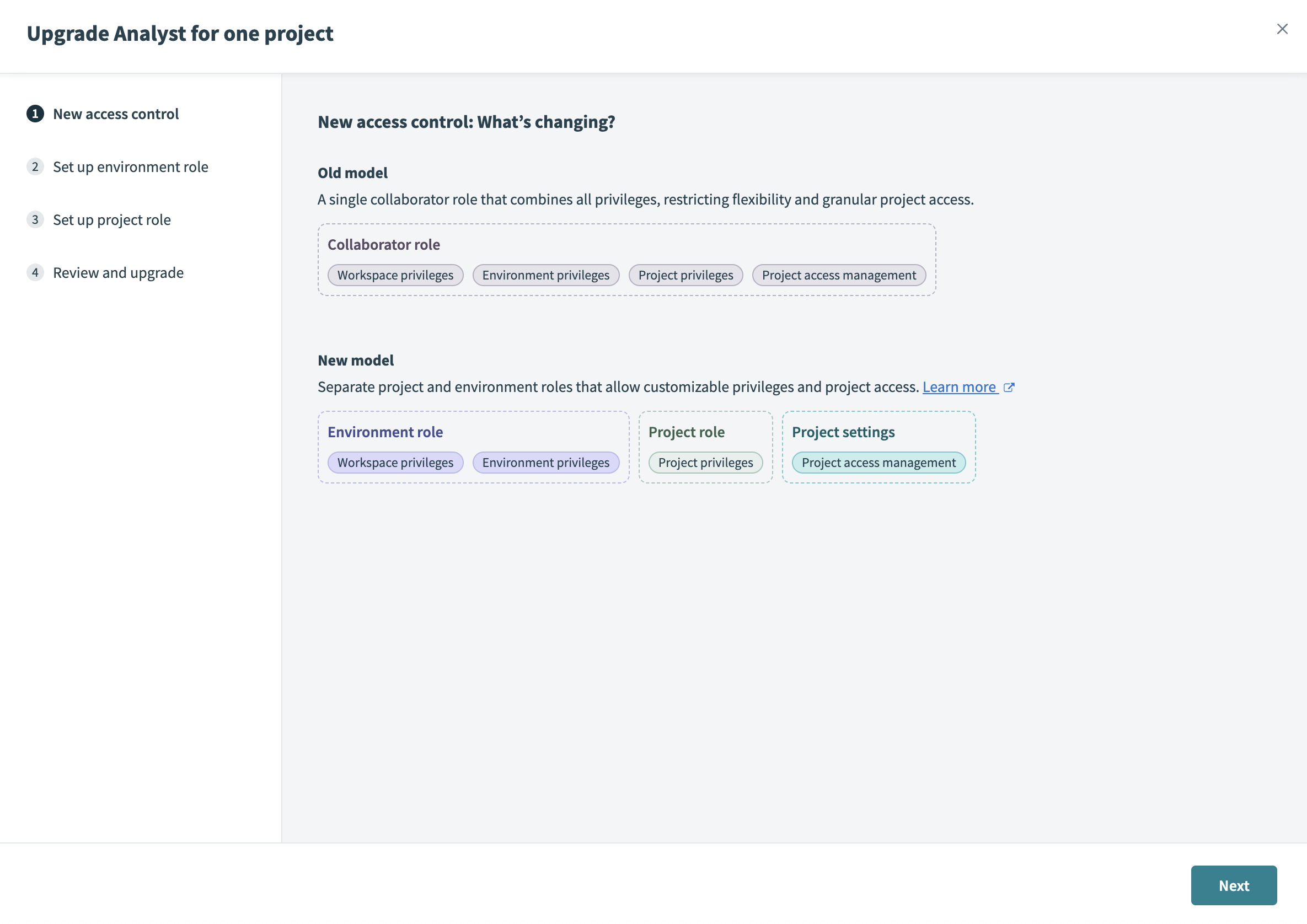

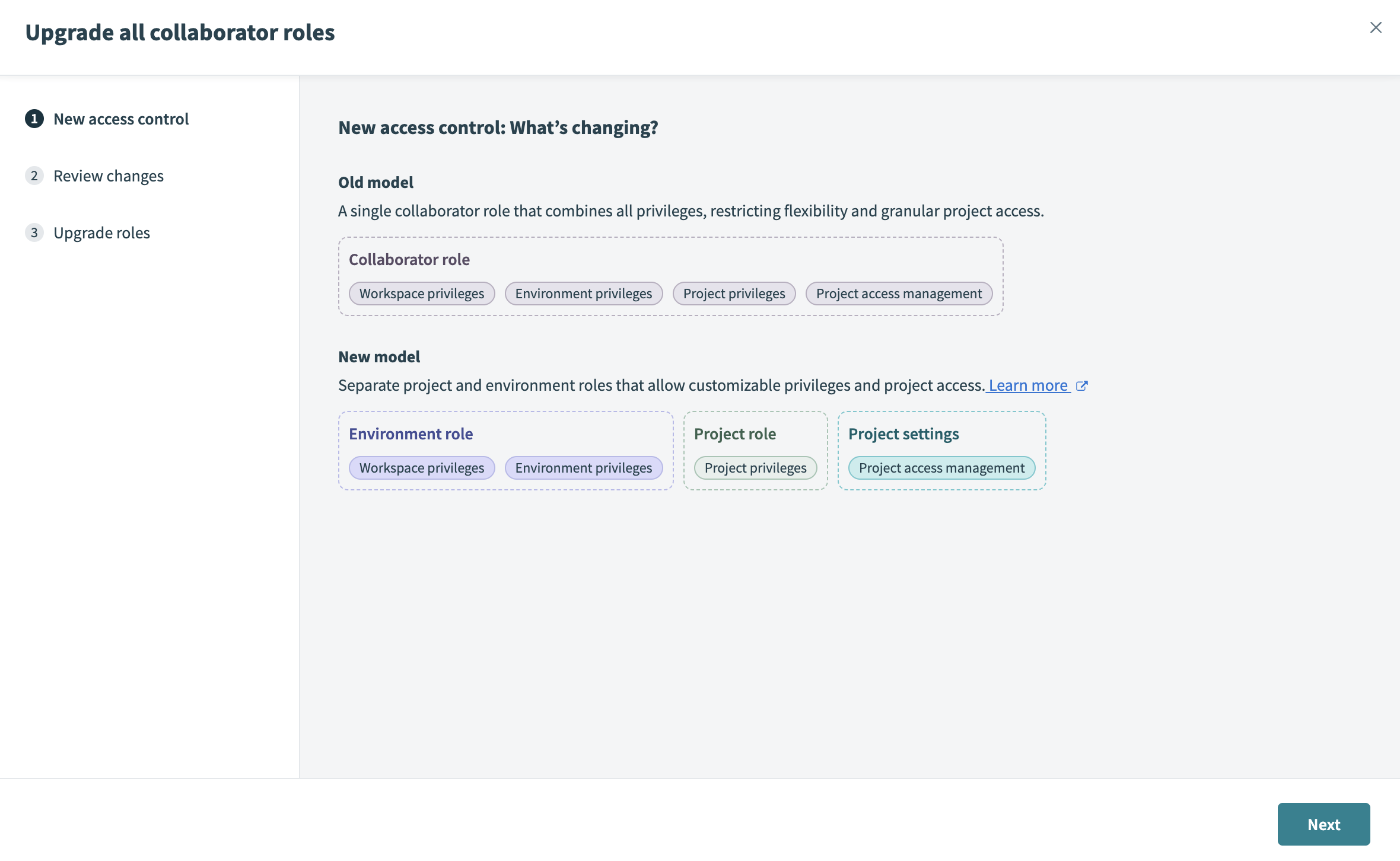

Upgrade roles

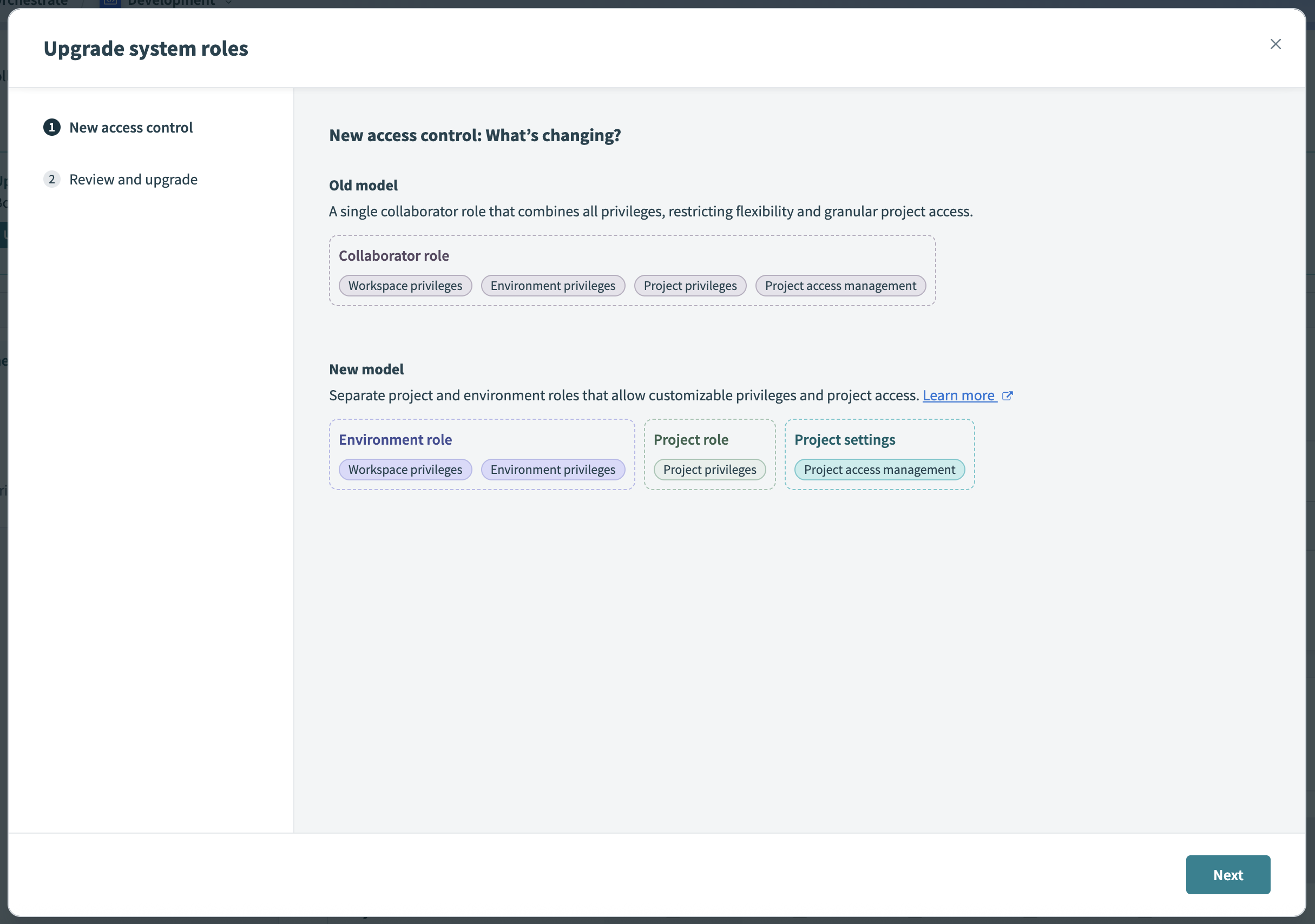

Review the overview of changes. The wizard demonstrates how the old model combines workspace, environment, and project privileges, and how the new model separates them into environment and project roles.
Review new access control model

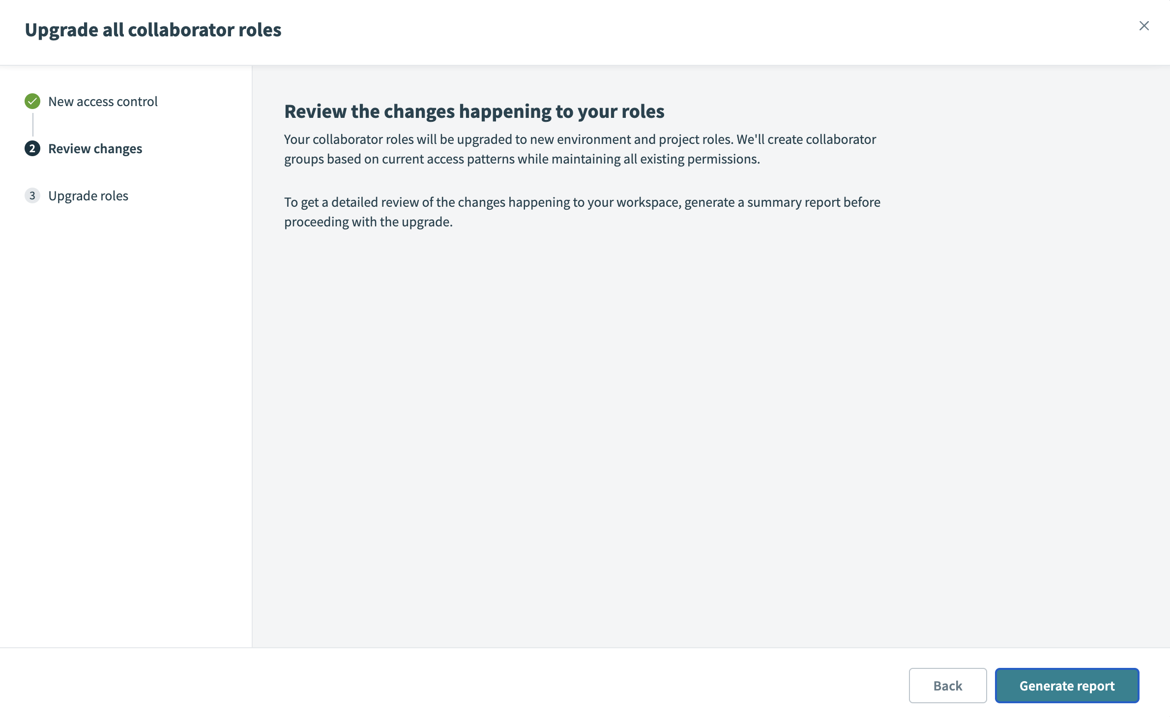

Click Next.

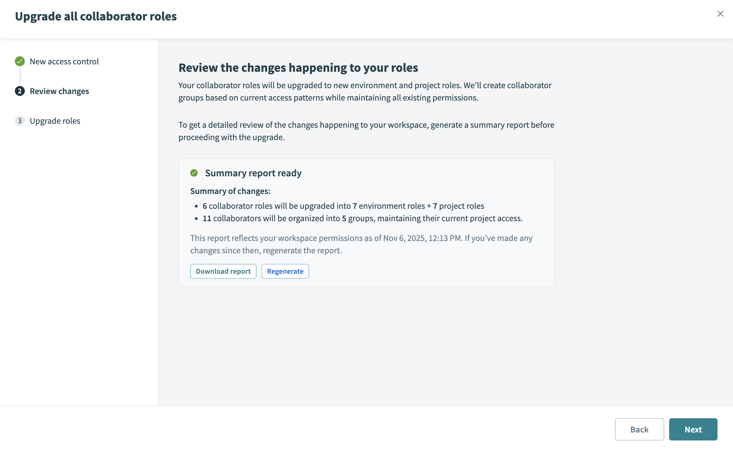

Click Generate report to analyze your workspace's roles and collaborators.
Generate summary report
Workato evaluates existing access patterns and emails you when the report is ready.

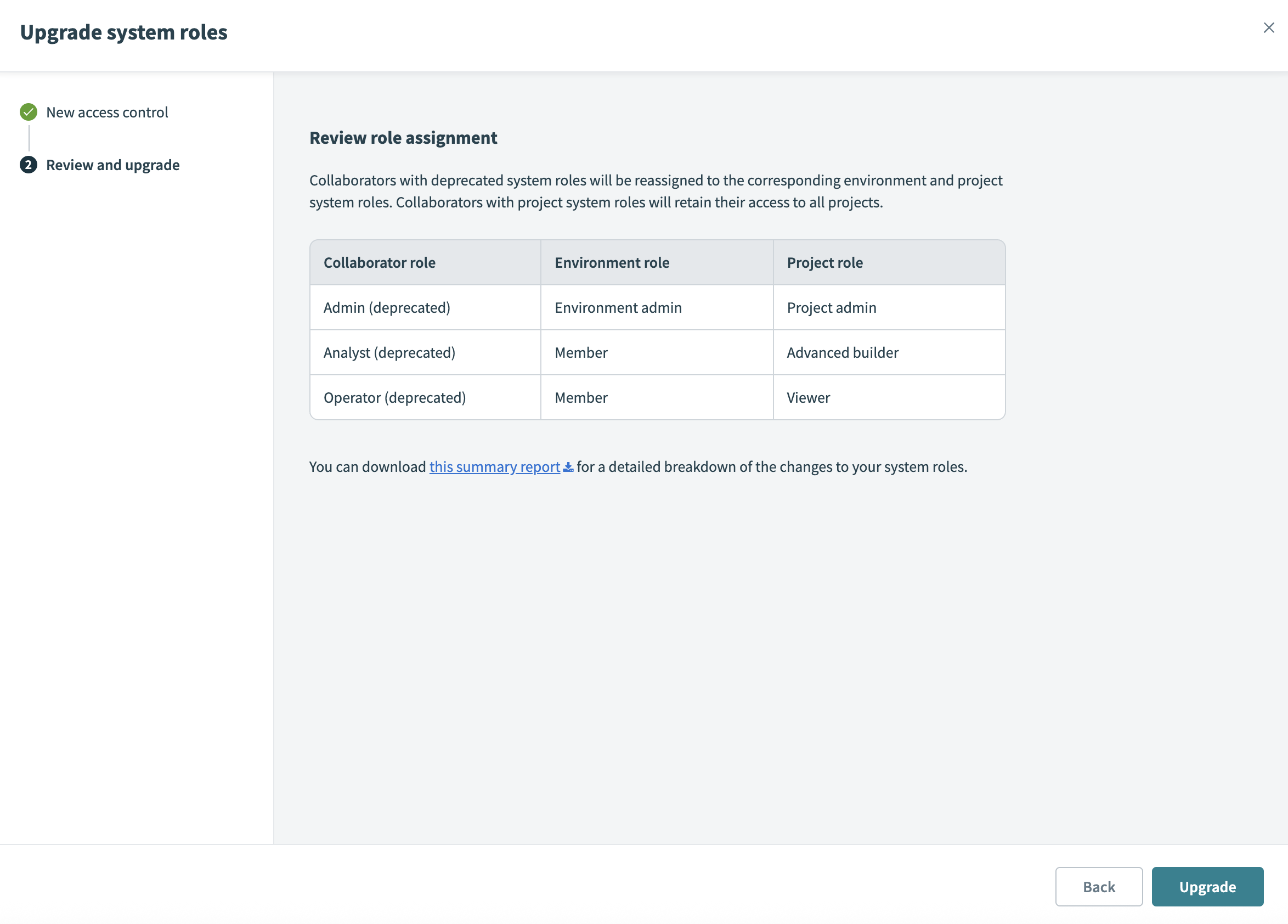

Click Download report to review the generated report. It provides a complete view of how your existing roles and collaborators map to the new model, including the following:
- All legacy roles mapped to new environment and project roles
- Newly created collaborator groups
- Any custom role mappings preserved from the old model
- Project-level assignments showing which groups manage which projects
Review summary report
You can also click Regenerate if you made permission changes.
Refer to How the migration wizard determines new roles and groups to learn more about how roles and groups are mapped.
Click Next to proceed.

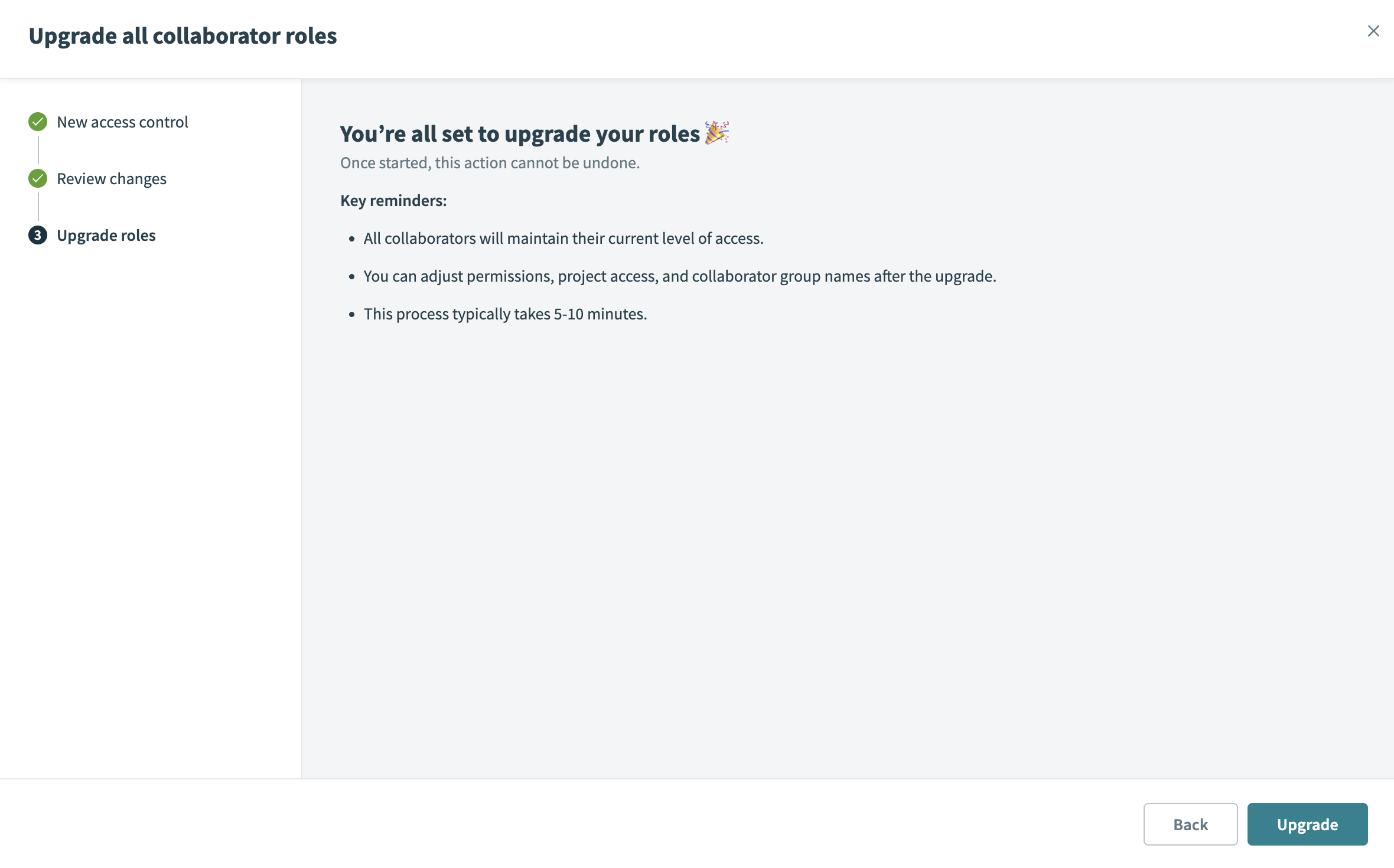

Review the following key reminders before you upgrade:
- All collaborators maintain their current access levels.
- You can adjust permissions and project access after migration.
- The process typically takes 5–10 minutes.

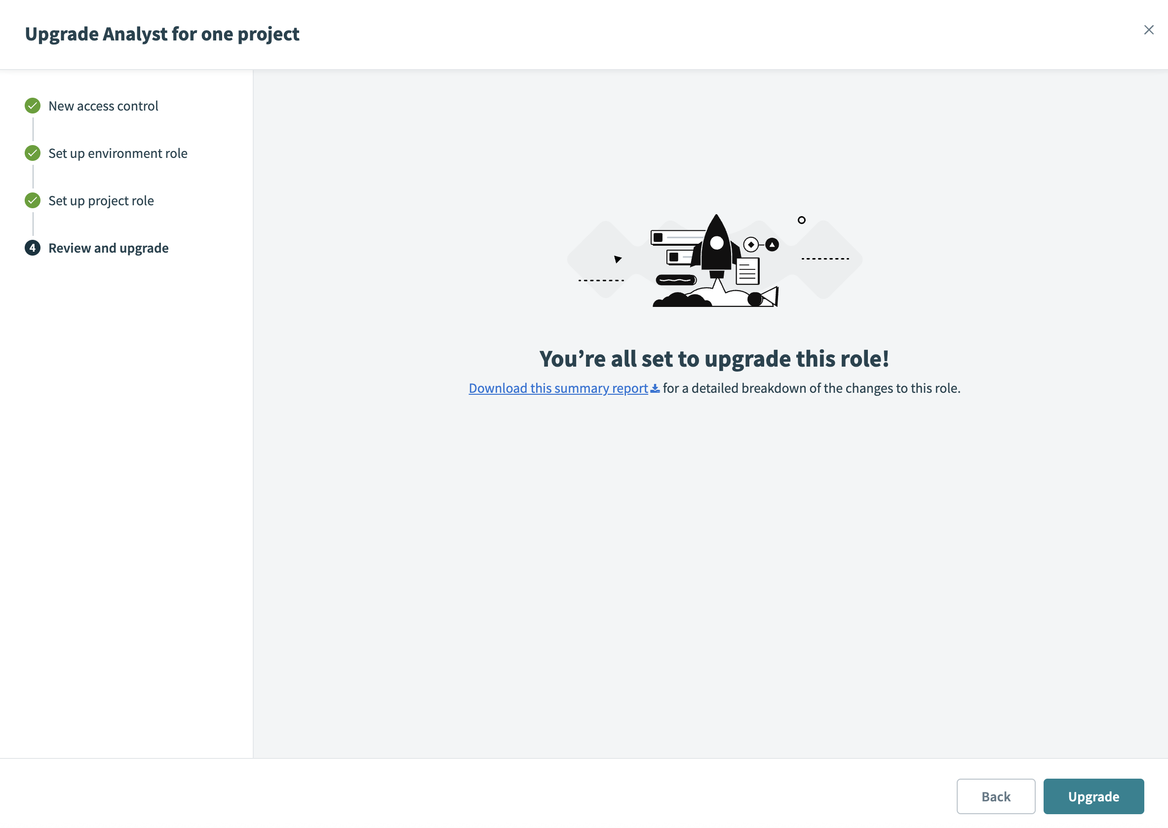

Click Upgrade.
Upgrade roles
Workato processes the upgrade in the background. You can leave the page and will receive an email notification when the upgrade completes.
A confirmation message appears when the migration completes. New Collaborator groups appear under People > Collaborator groups.

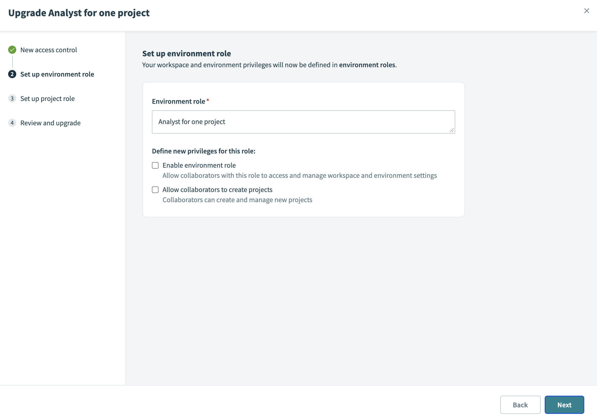

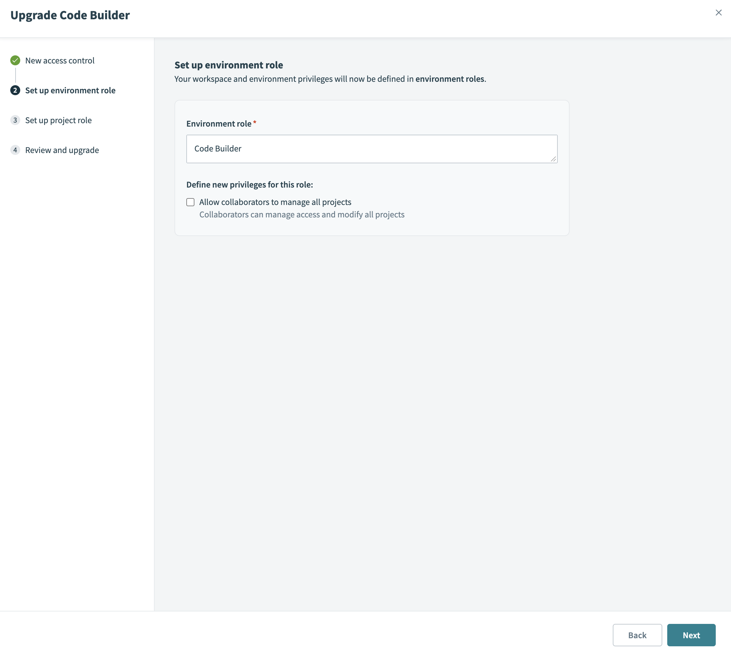

# Environment roles
The wizard compares each collaborator's permissions across the workspace and assigns one of the new environment roles:
| Legacy access pattern | New environment role | Description |
| Full workspace-level permissions | Environment admin | Has full administrative control of the workspace. |
| Limited workspace access | Environment manager | Can manage most environment resources but not user access. |
| Recipe or project only permissions | Member | Can use resources in assigned projects only. |
Custom or cloned roles are preserved as equivalent custom environment roles with the same permission scope.

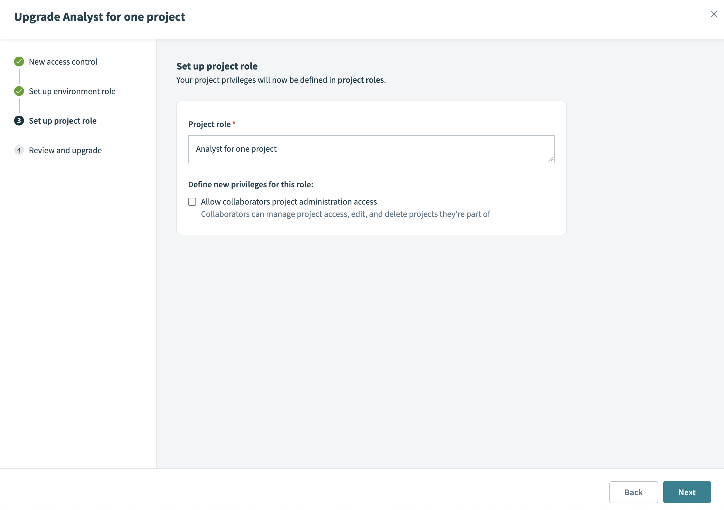

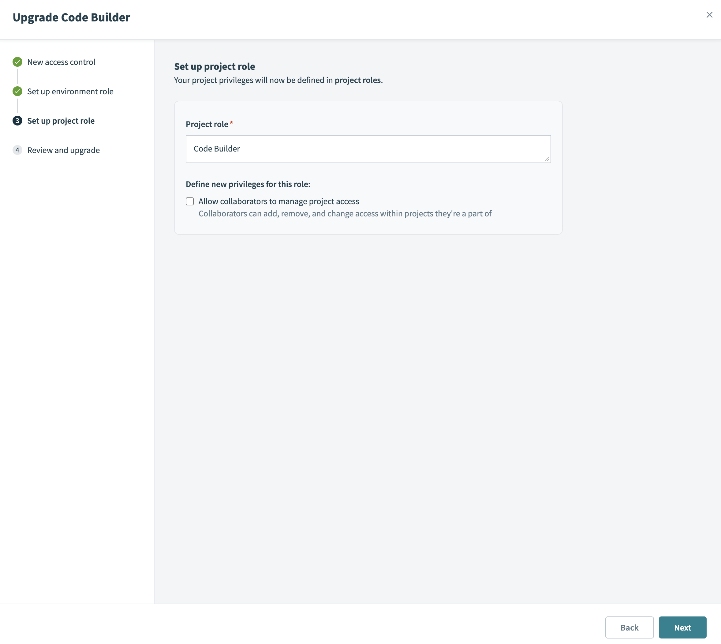

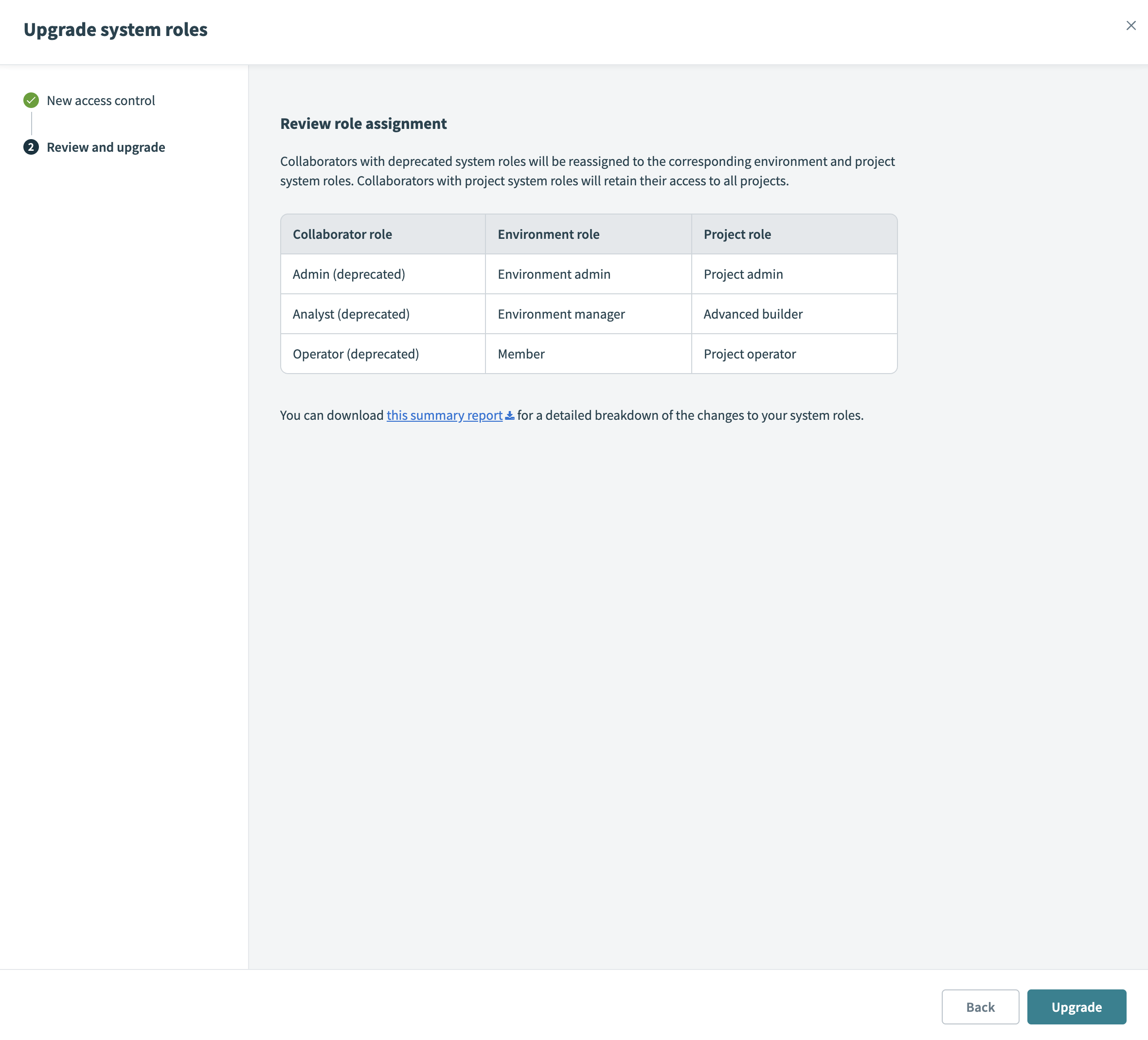

# Project roles
The wizard analyzes what collaborators could do in each project (for example, edit recipes, manage folders, run jobs). These permissions are converted into project-level roles that represent equivalent access:
| Legacy role | New project role | Description |
| Admin | Project admin | Full control over the project, including managing collaborators and resources. |
| Analyst | Advanced builder | Can build, edit, and test recipes within the project. |
| Operator | Project operator | Can monitor and run recipes but not edit or manage settings. |
Each collaborator group receives one or more project roles per project. Collaborators inherit those permissions automatically through their group membership, ensuring they retain equivalent access after migration.
