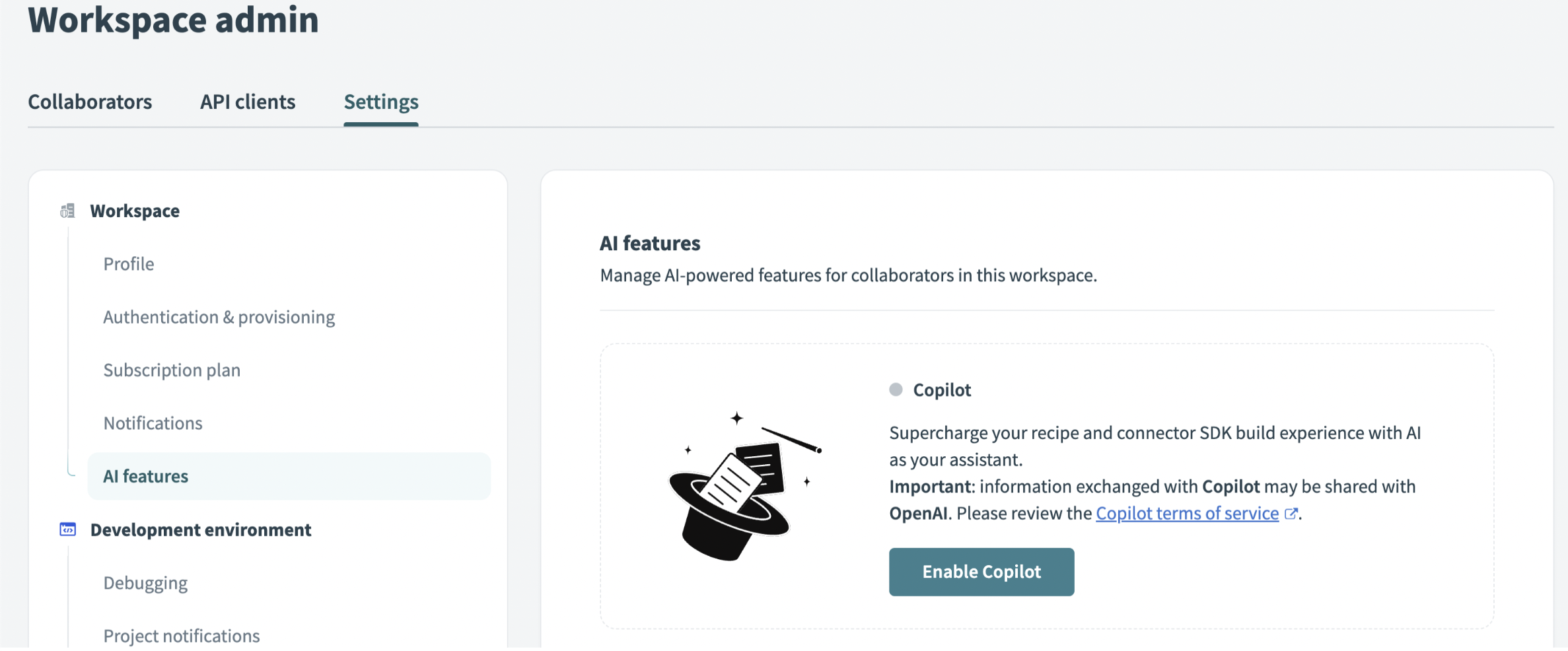

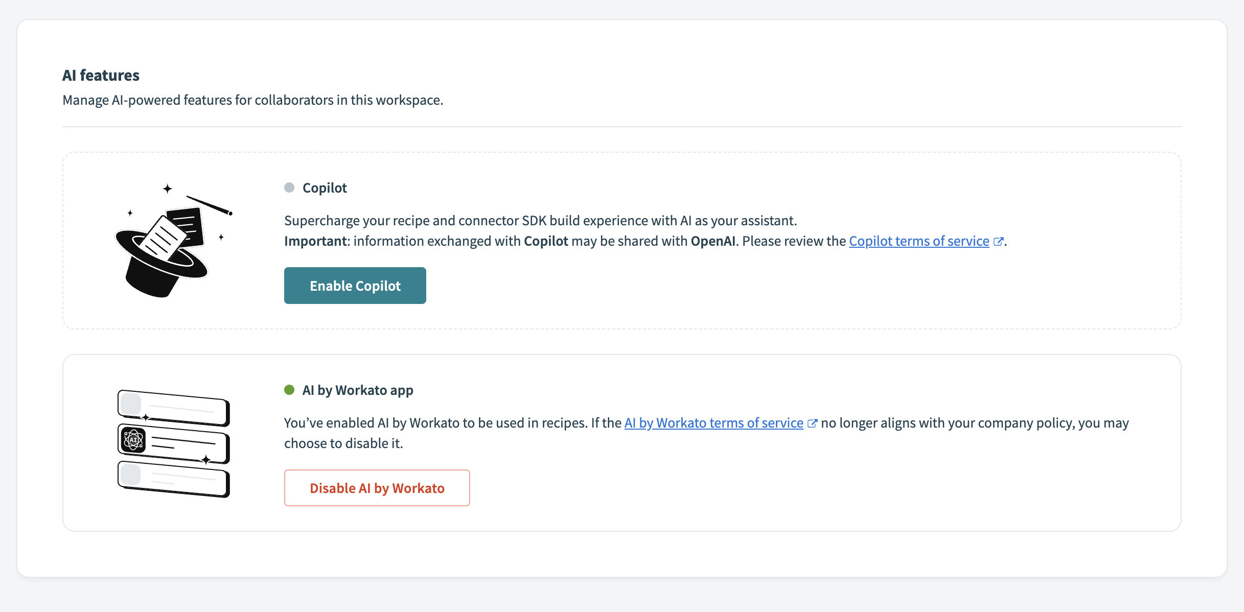

Complete the following steps to set up Copilots in a standard workspace:
Go to Workspace admin > Settings > Beta.
Ensure that Copilot's terms of service comply with your company's policies.
Click Enable Copilot.
Enable Copilot in your workspace settingsEnable Copilot

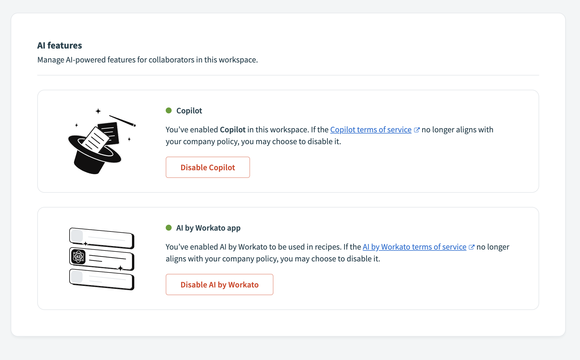

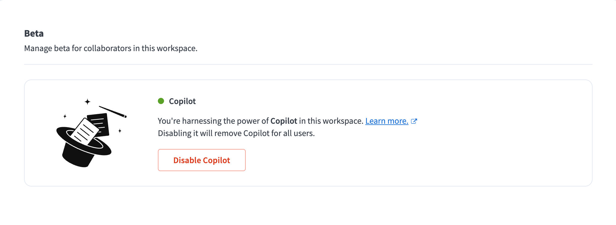

You can disable Copilots at any time by navigating to the same settings and clicking Disable Copilot.
Disable Copilots in your workspace settingsDisable Copilots

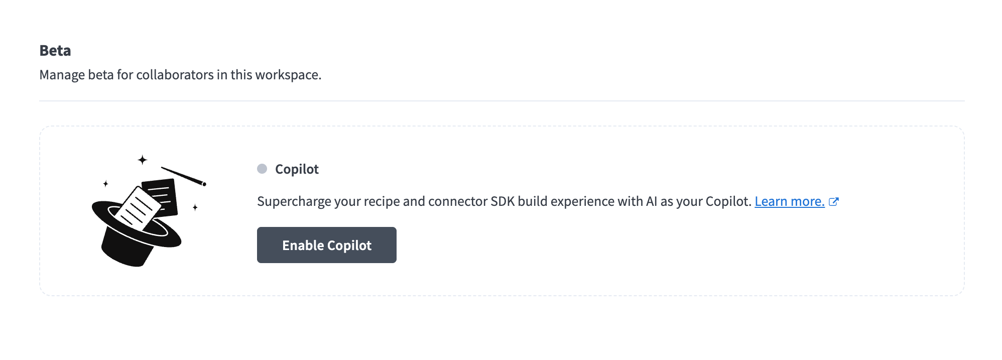

Complete the following steps to set up Copilots in an AHQ workspace:
Click Workspace admin > Settings > Beta.
