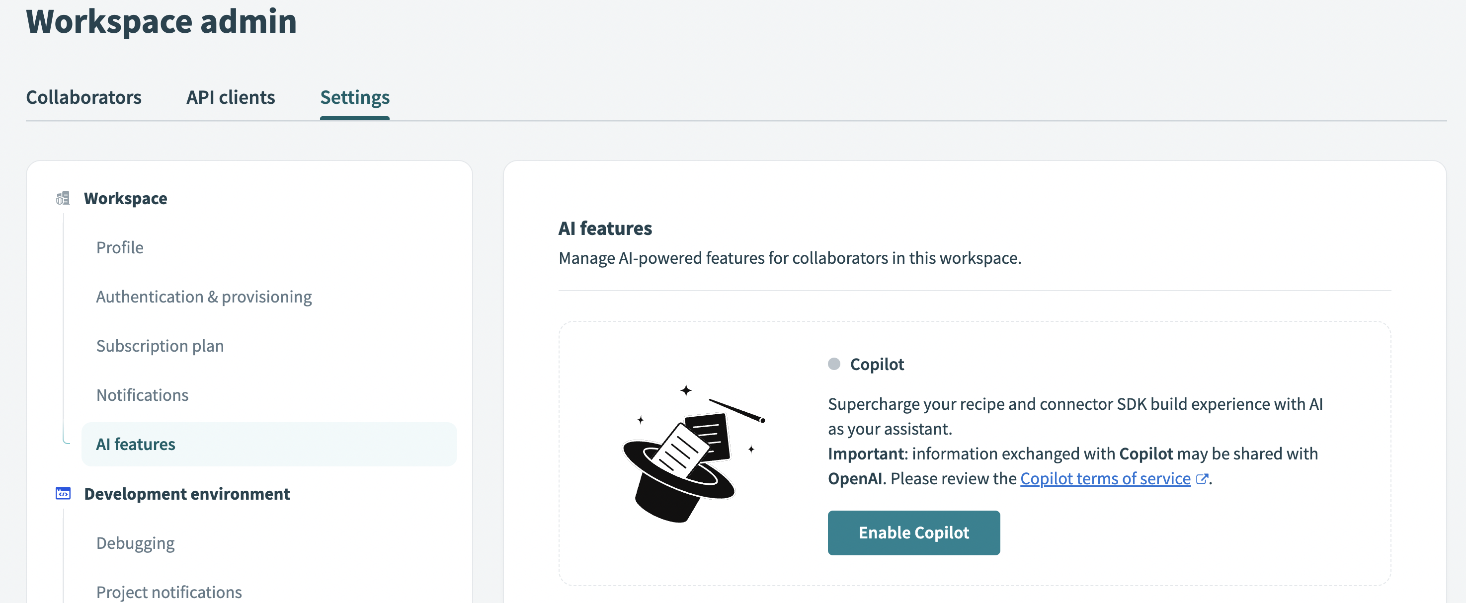

Standard workspaces
Navigate to Workspace admin > Settings > Workato AI.
Ensure that Copilot's terms of service comply with your company's policies.
Click Enable Copilot.
Enable Copilot in your workspace settingsEnable Copilot

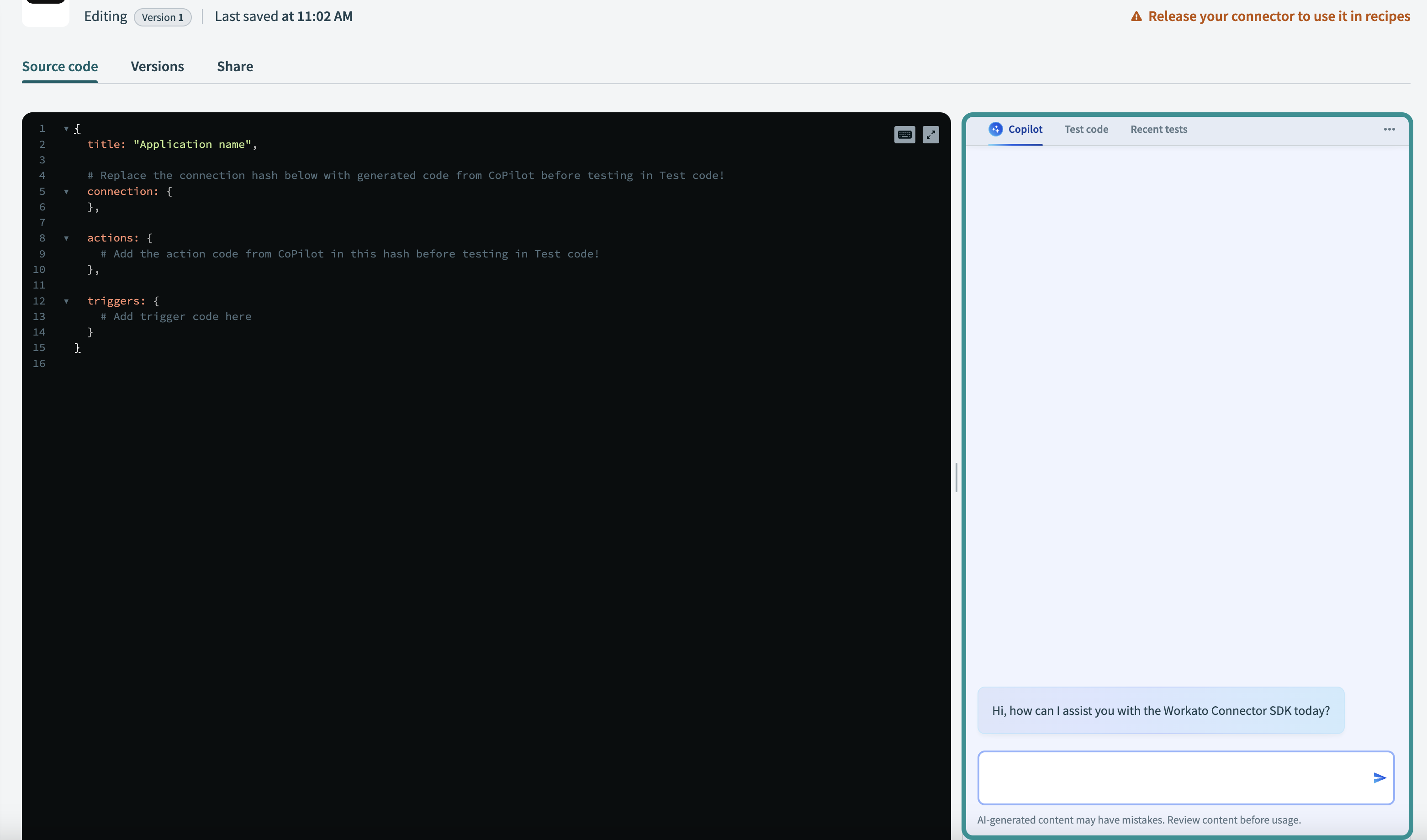

Click Tools > Connector SDK.
Create a new custom connector or select an existing custom connector.
  • If creating a new connector, you can start by providing some basic information about the API, or you can directly interact with Connector Copilot to build your connector step by step.
  • If modifying an existing connector, you can change the authentication logic or generate a new action as required.
Connector Copilot appears in its own dedicated tab, next to the Test code and Recent tests tabs.
Copilot chat windowCopilot chat

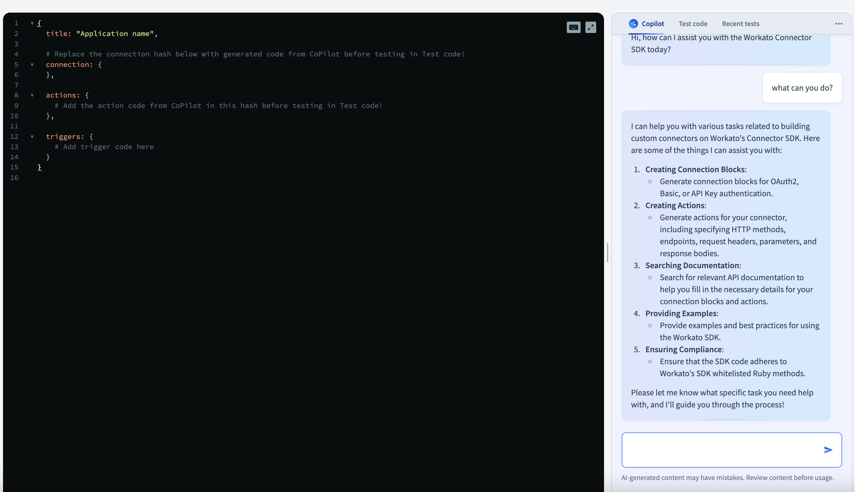

Accelerate connector development
Connector Copilot allows you to build your connector quickly and efficiently. Describe your business objectives and connector needs, and Connector Copilot helps you get to production faster.
Copilot interfaceConnector Copilot interface

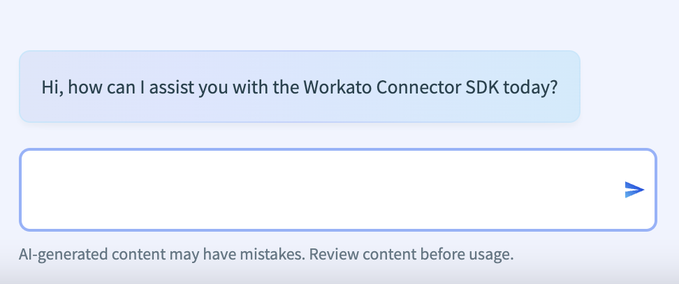

When you first enter the Connector Copilot chat, you can ask questions about your connector, APIs, and Workato SDK documentation at any time, in any order. If you ask about Connector Copilot's capabilities, it provides a list of its current capabilities.
Copilot capabilitiesConnector Copilot capabilities

Connector Copilot can assist you with the following tasks:

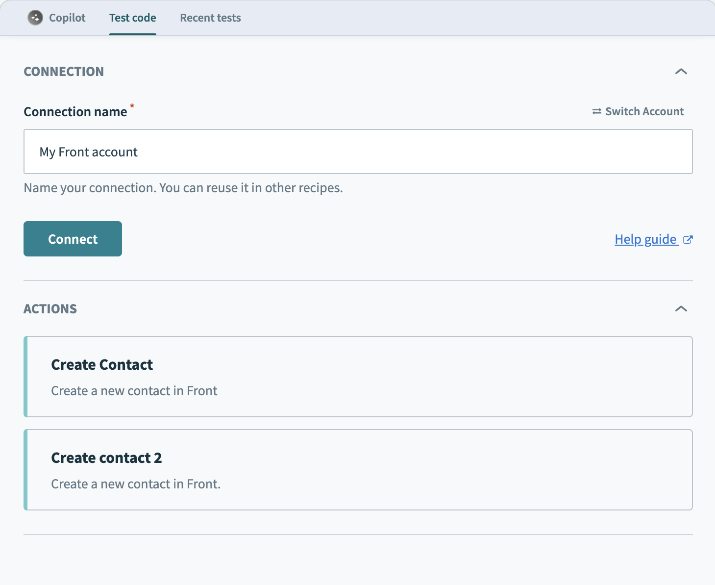

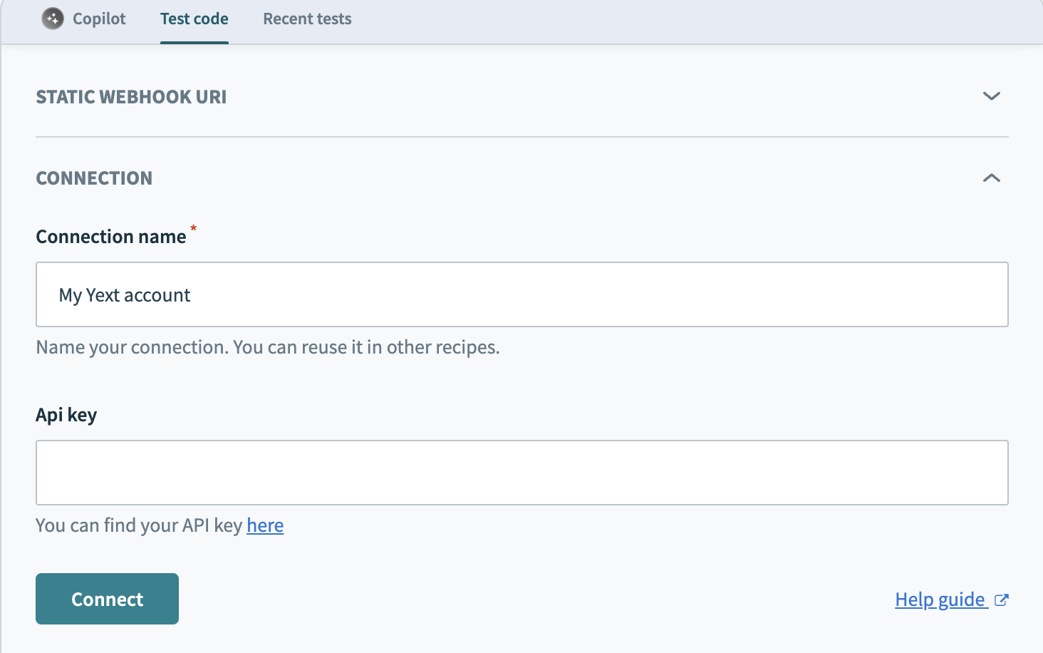

Switch to the Test code tab to test the generated connection. You must supply the relevant credentials to authenticate your connection.
Test your connectionTest your connection
Review the authentication logic in the Recent tests tab. You can also review the input and output of the authentication and any API calls that were made in the process.

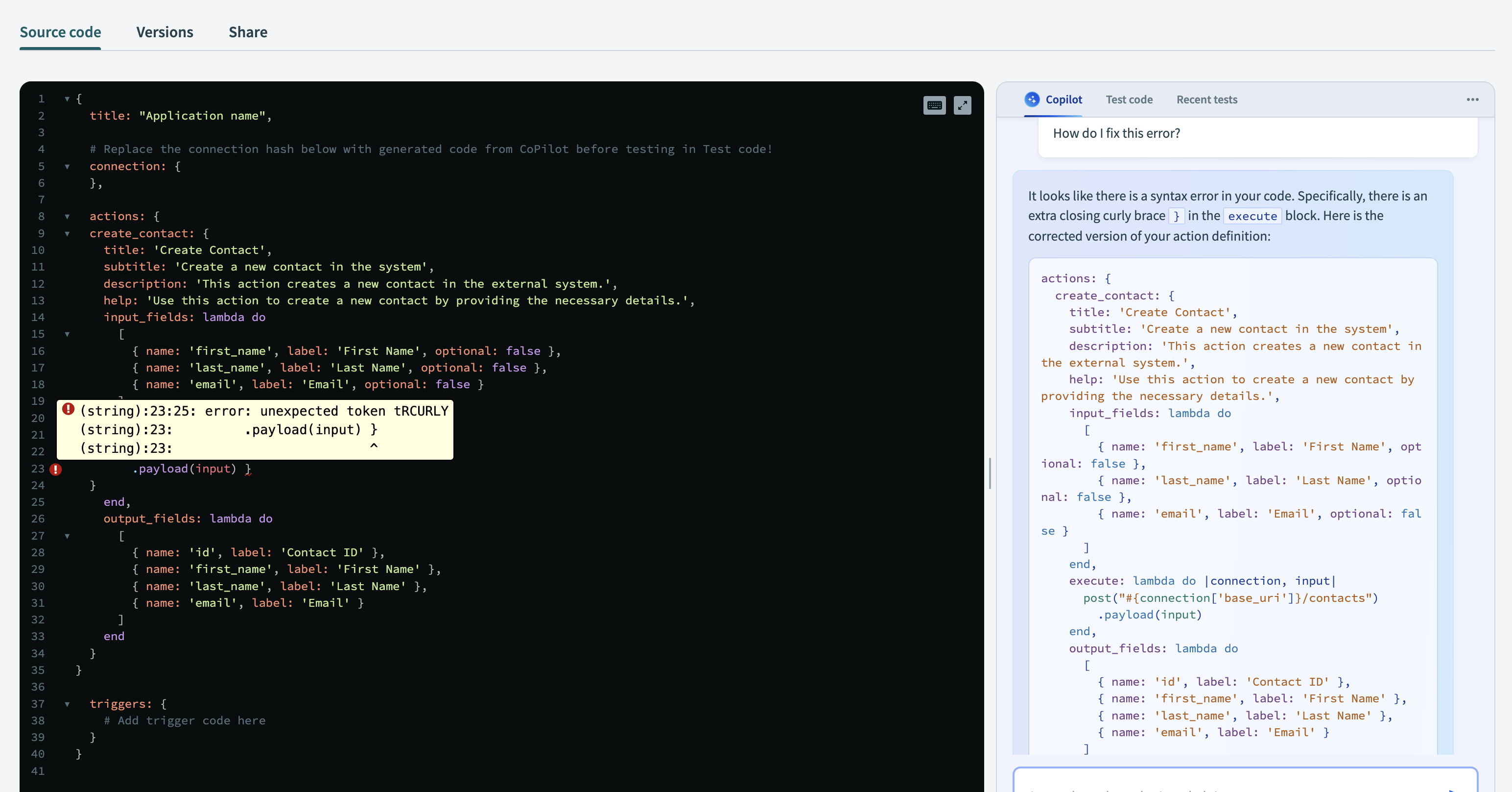

Fix errors and explain the SDK
After generating your connection or action code, Connector Copilot offers additional options to help you refine and troubleshoot your code. You can paste errors and code snippets into Connector Copilot for explanations and solutions. This allows you to request edits, fix API errors, or prompt other queries. Being specific about your requirements helps Connector Copilot deliver better results.
How to use Connector Copilot for troubleshooting
Complete the following steps to identify and fix errors in your code with Connector Copilot's assistance:

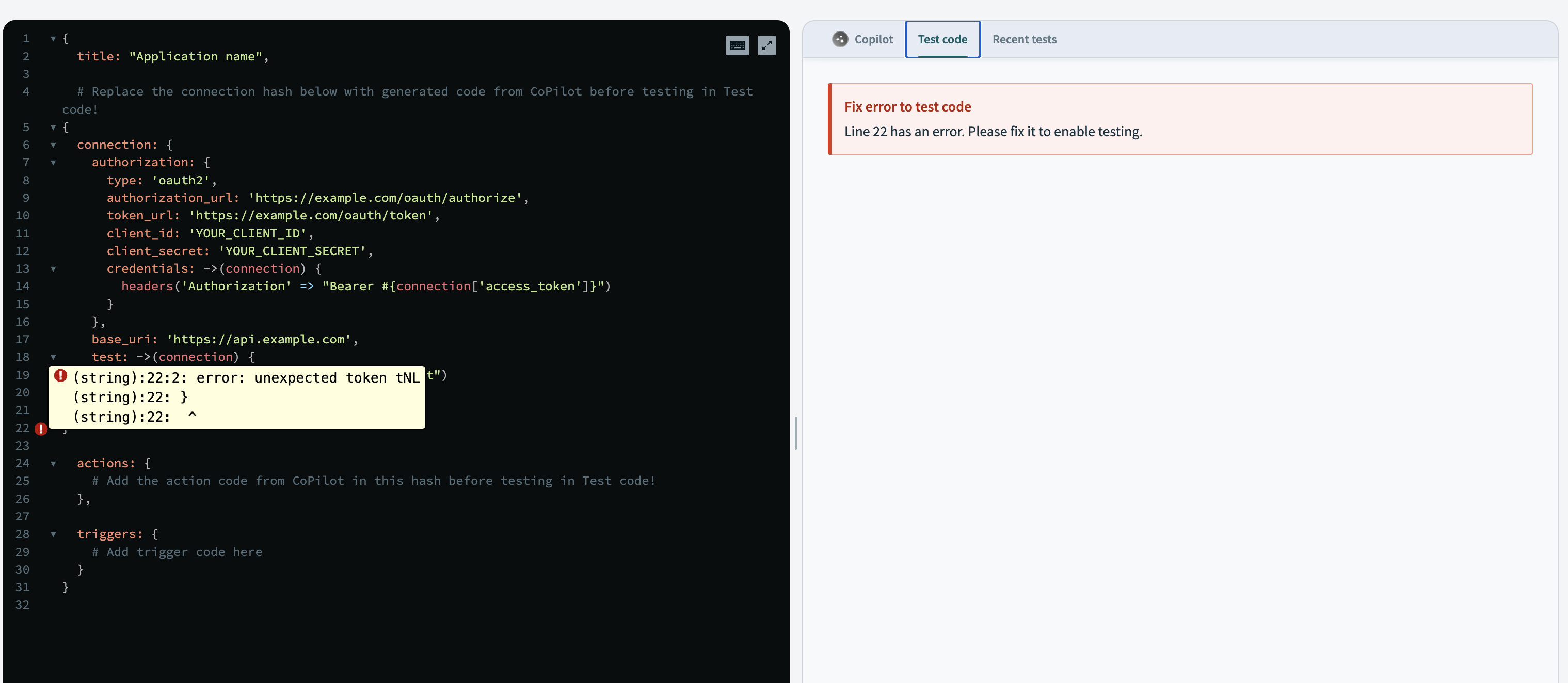

Switch to the Test code tab to run your generated connection or action. Observe any errors or issues that occur.
Troubleshoot your codeTroubleshoot your code
Inspect the source code for any potential issues or errors.
Copy the error message or relevant code snippet from either the Test code tab or the source code.
Paste the error message or code into the Connector Copilot chat and ask for help. For example:
  • "How do I fix this error?"
  • "Can you explain this part of the code?"
Troubleshoot error messageTroubleshoot error message
Connector Copilot can provide explanations, suggest edits, and guide you through the troubleshooting process.

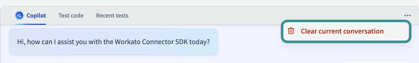

Clear the conversation
Clicking on the ellipsis (...) menu provides you with the option to clear your current conversation. This option clears the chat history with Connector Copilot, which is useful for resetting Connector Copilot to get better and more accurate answers. This action does not clear any code you have copied into your connector.
