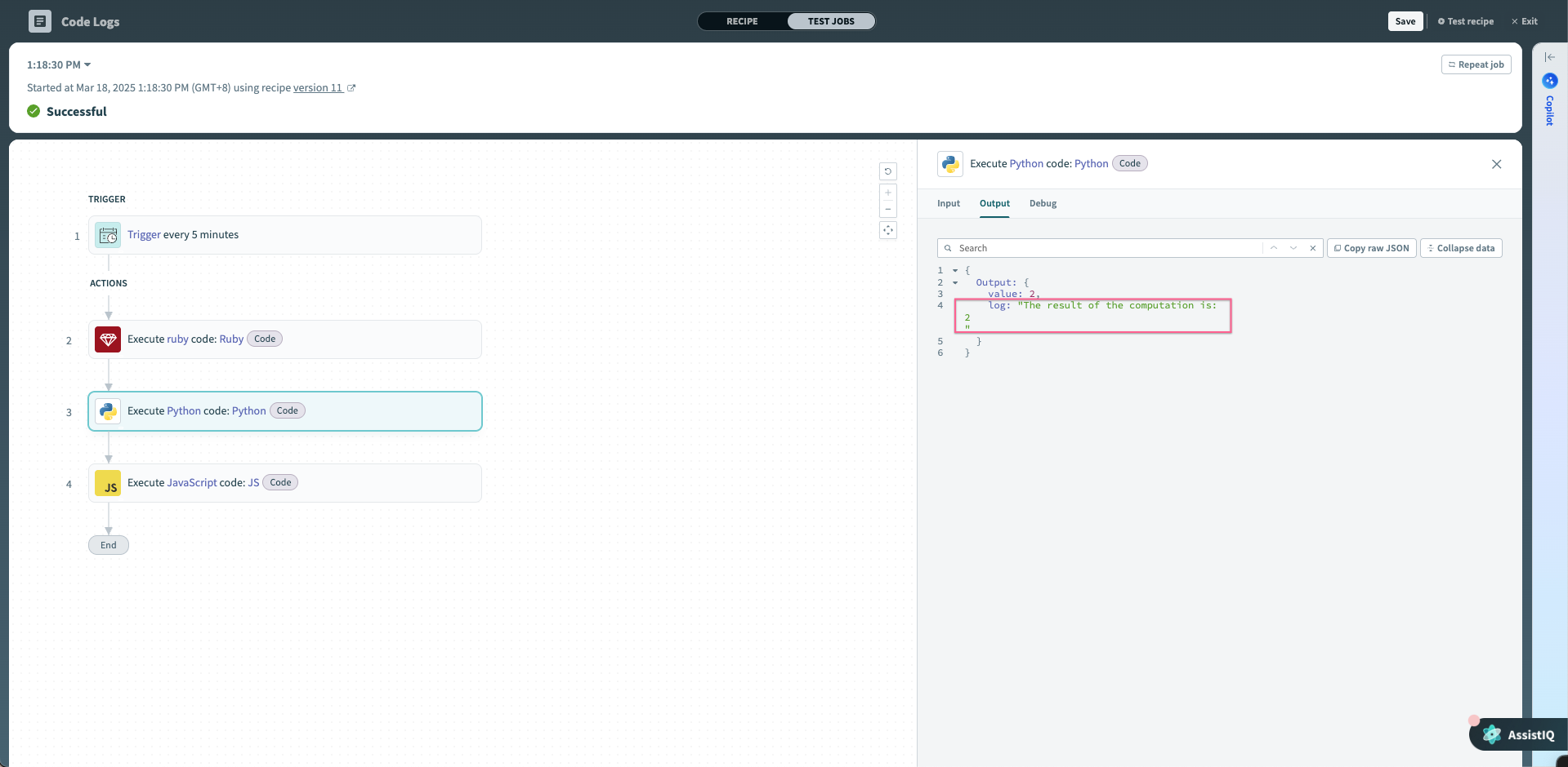

Logging
To help with development and debugging, Workato supports logging intermediate values using print statements. Note that Workato only displays print statements inside the main function. Each print statement is displayed as a new line.
printOutput of print statements inside main function

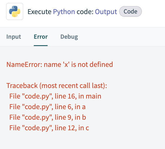

Error stacktrace
When the "Execute Python code" action fails due to an error inside the main function, Workato displays the relevant error stacktrace to help you debug your code.
Error stacktraceSample error stacktrace
