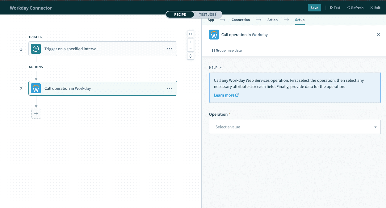

# Operation
Select Maintain Contact Information
Full list of all operations in Workday Web Services. To find the operation that you want, use keywords to filter and reduce the list of possible matches.

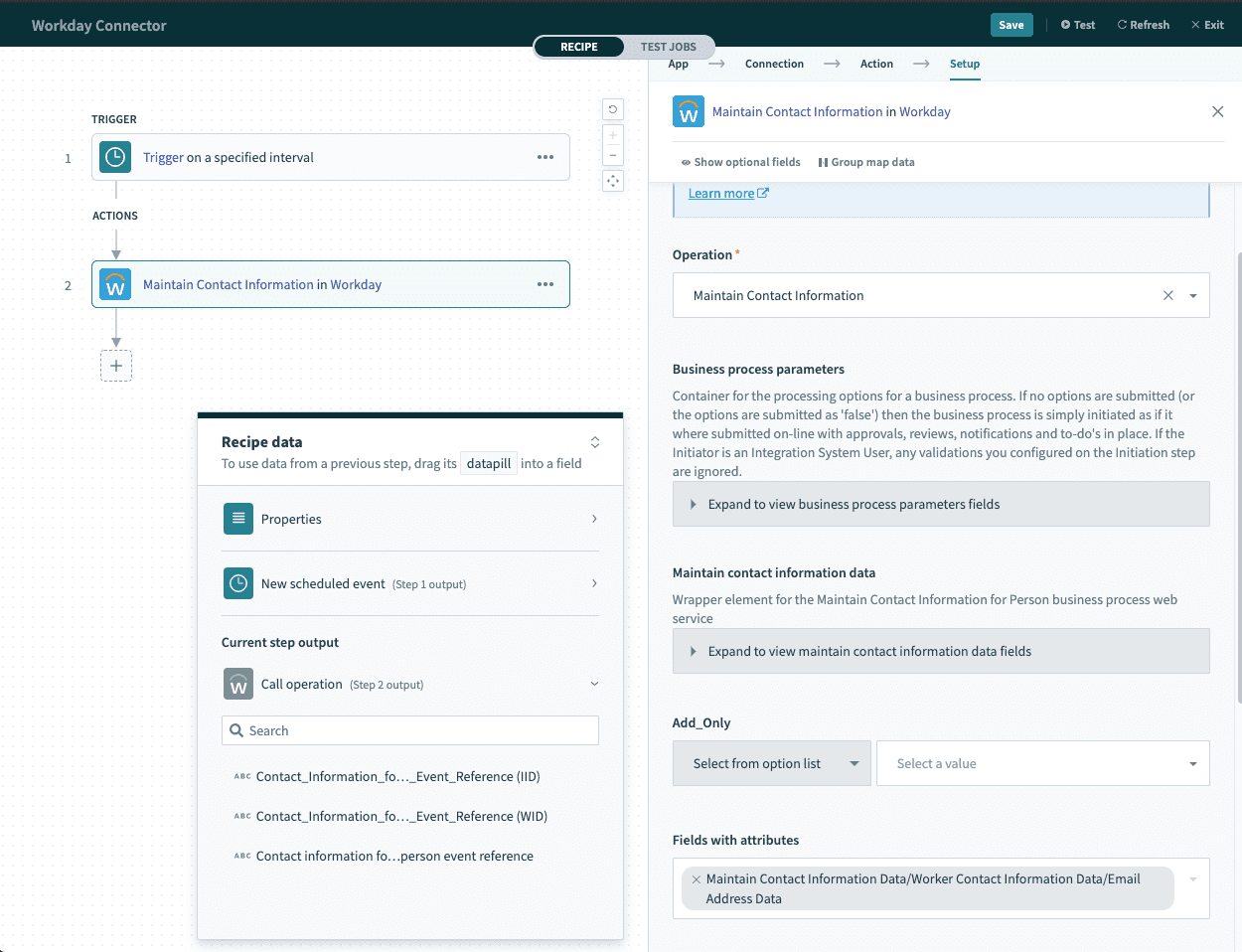

# Fields with attributes
Selecting Email Address Data to include attribute values
If you want to add new email addresses to a particular contact without replacing the existing email addresses, we can set the Do_Not_Replace_All attribute of the Email address data field to false.
Select Maintain Contact Information Data/Worker.../Email Address Data. This generates all possible attributes for the Email address data field, including Do_Not_Replace_All.

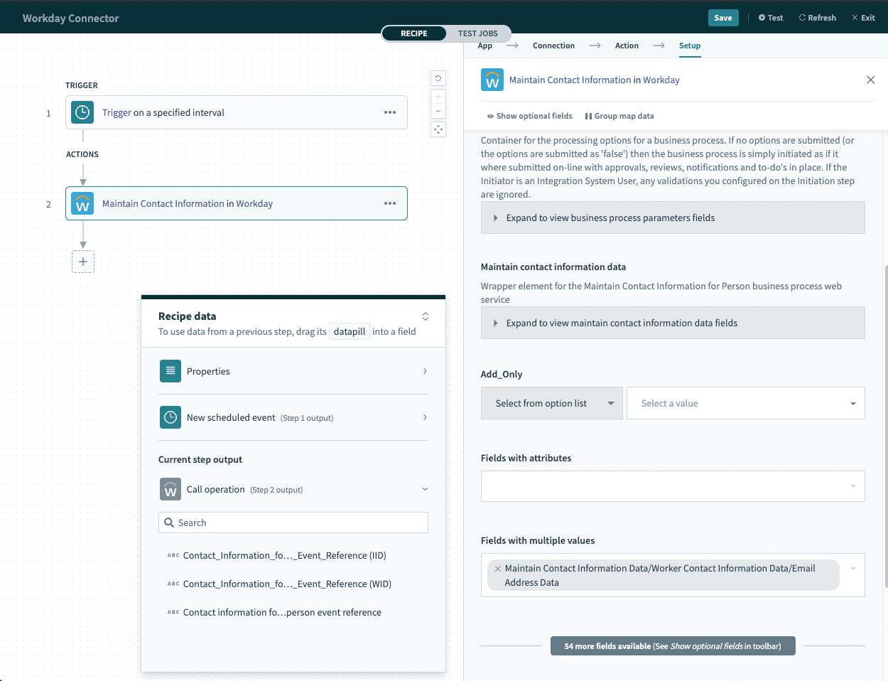

Selecting Email Address Data field to be repeated
If your use case involves more than one email address, you have to send multiple email addresses in a single operation.
Select Maintain Contact Information Data/Worker.../Email Address Data. This changes the Email address data into a list type input field. In further operations, you can map one or more email addresses using this list.

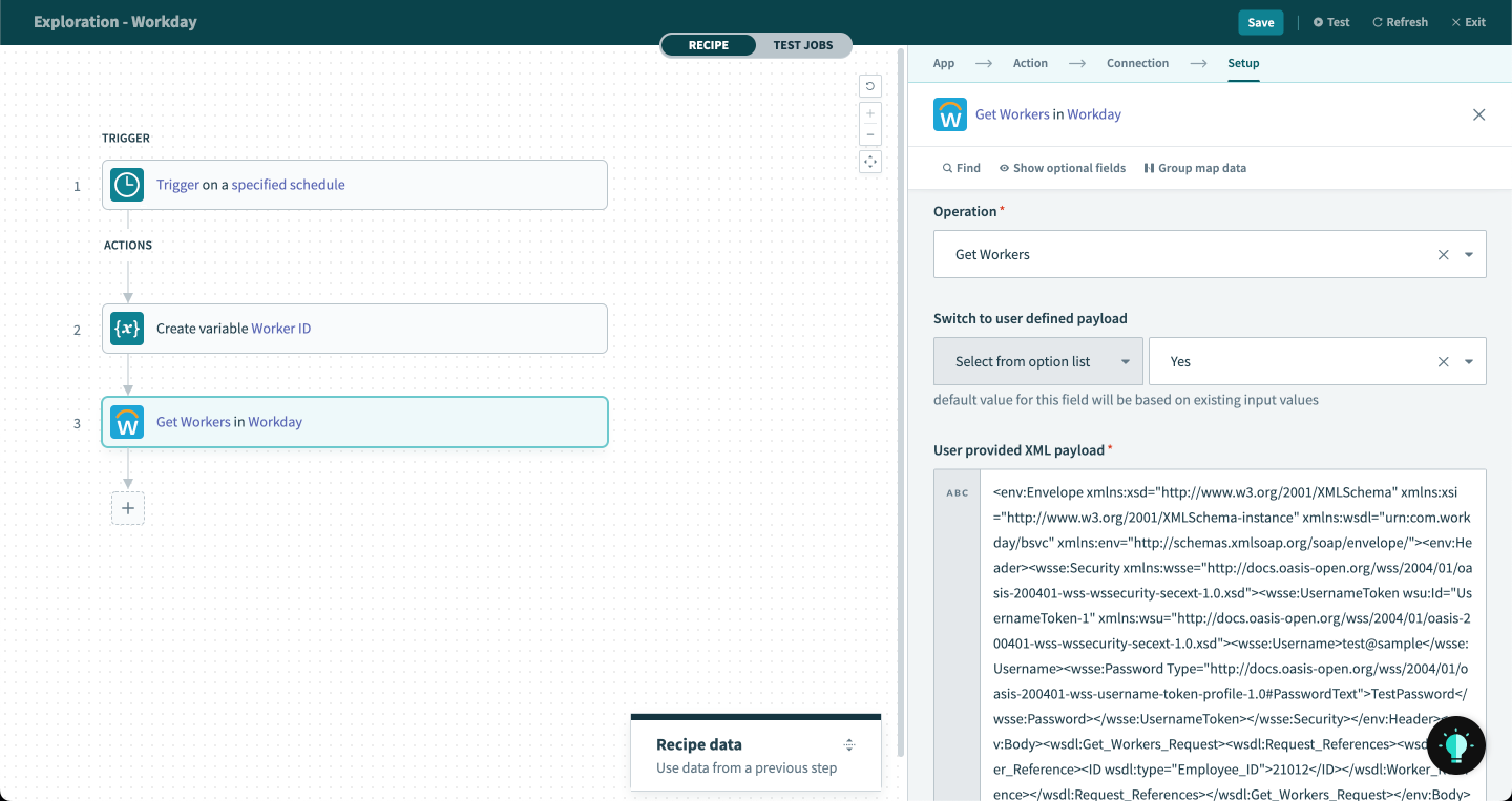

# Input (user-defined payloads)
Switching to a user-defined payload
When you customize the XML payload sent to Workday, you can use the Workday connector's support for a user-defined payload.
Follow these steps to switch to user-defined XML payload from guided input:
Select the operation to perform.
Set the Switch to user-defined payload input field to Yes to enable user-defined payload mode. Use the multi-line text input field to edit the raw XML payload of the request directly.
Workato automatically populates all guided input fields configured before switching to user-defined payloads in the raw XML payload.
When working with the user-defined XML payload mode, keep the following considerations in mind:
- Workato will insert or replace the
Securityportion of theHeaderfield with values based on the selected connection. - Workato does not sync customizations made in user-defined payload mode back into the guided input mode. These customizations are not retrievable when switching back to a user-defined payload.
- You must check and fix any guided input fields configured using formula mode to ensure proper generation of the XML payload.
Here is an example of a valid custom XML payload:
