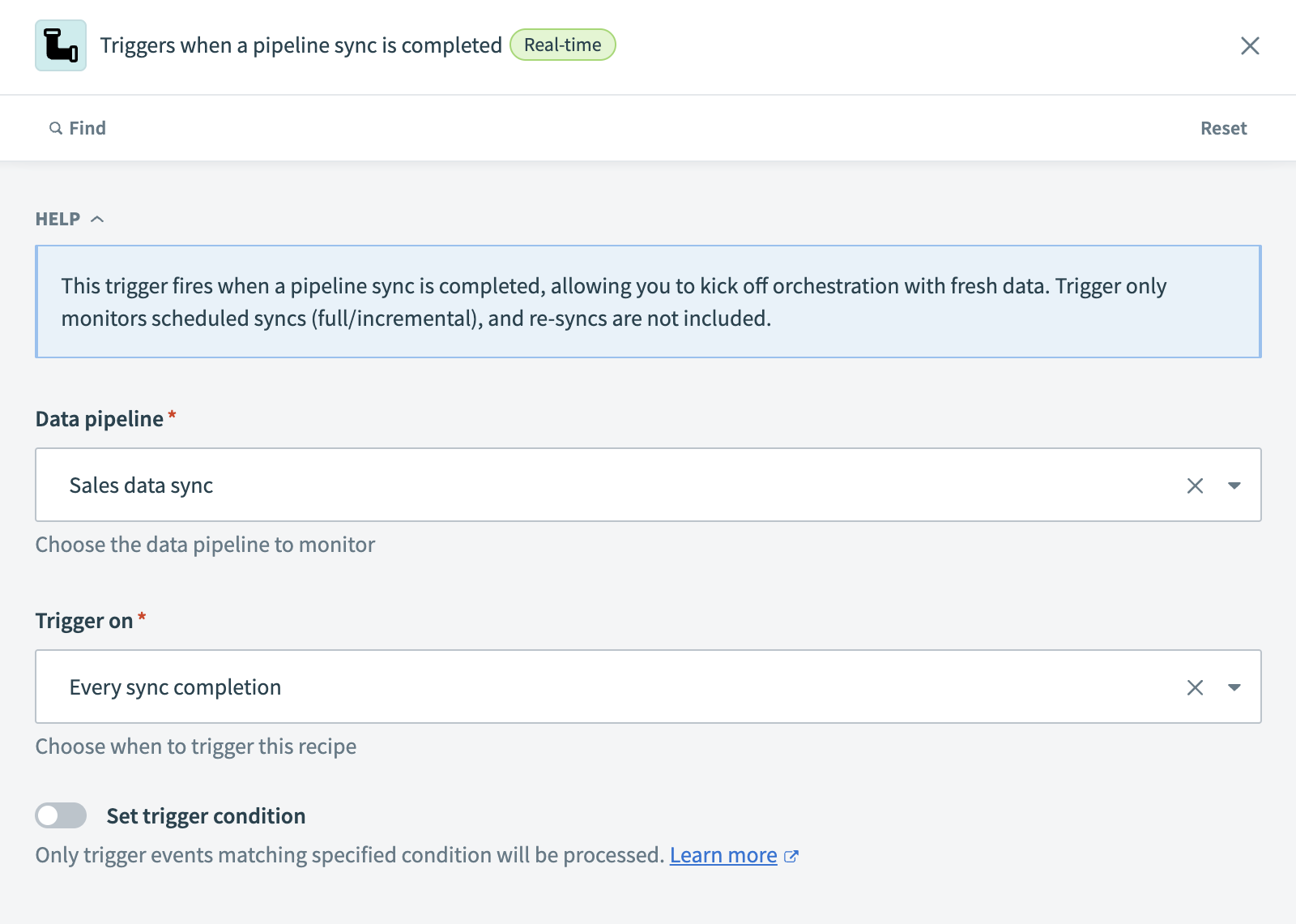

Search for PipelineOps by Workato and select it as your app.
Select the Sync completed real-time trigger.
Set up the data pipeline trigger
Choose the Data pipeline you plan to monitor.
Select Every sync completion in the Trigger on field .
Workato recommends selecting Every sync completion instead of Failed syncs. This ensures you capture object-level failures, which may not be tracked under sync-level failures.

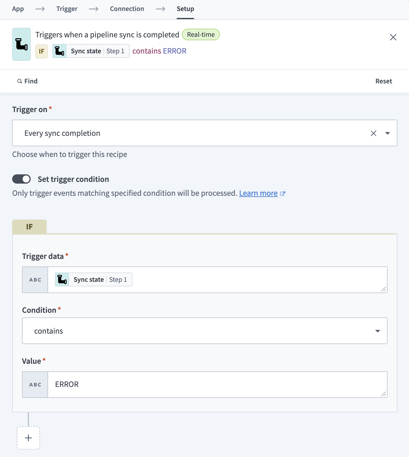

Set up your trigger condition
Set up a trigger condition
You can set a trigger condition directly in the trigger setup.
Enable the Set trigger condition toggle.
Map the Sync stateStep 1 datapill to the Trigger data field.
Set Condition to contains.
Set Value to ERROR.

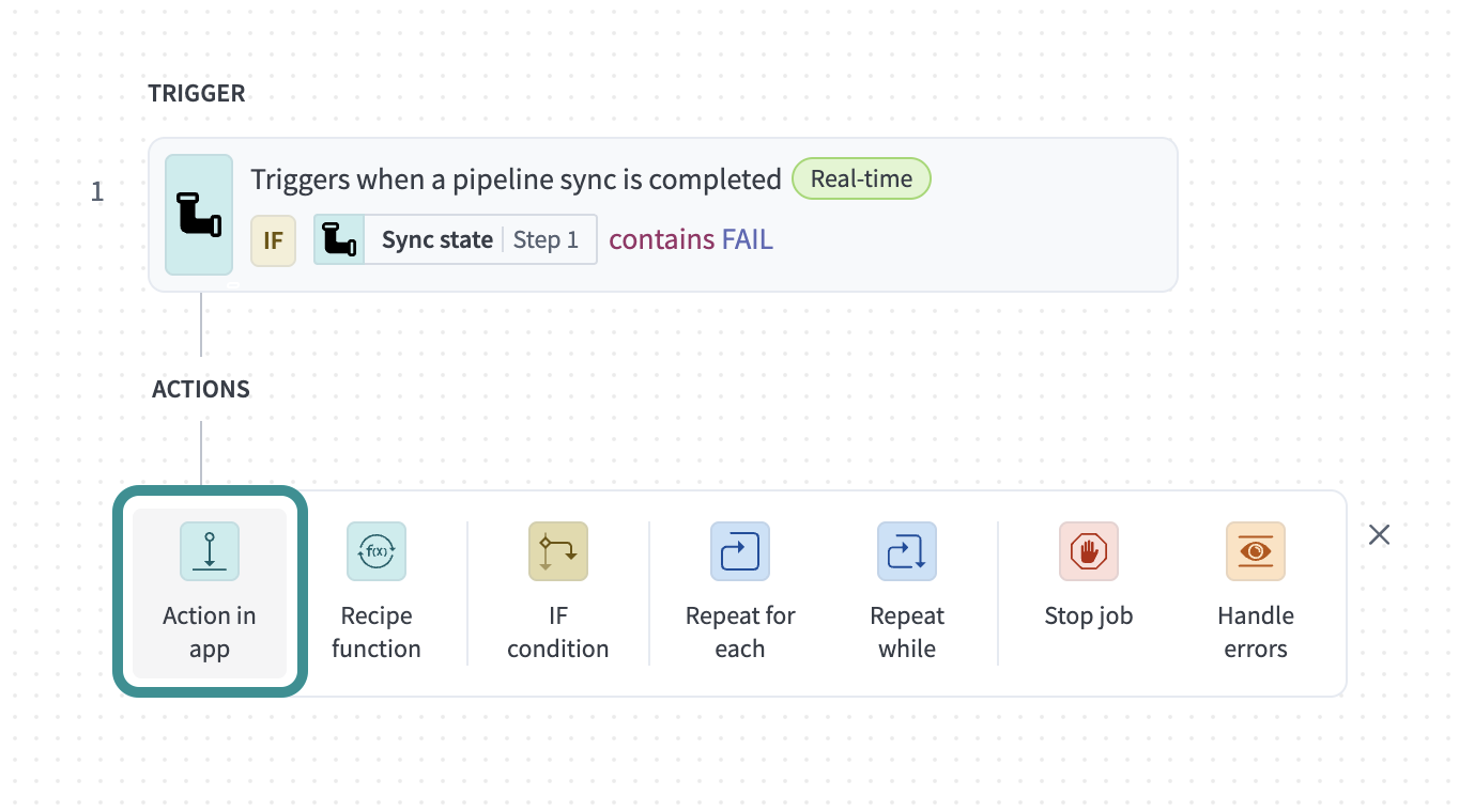

Click + Add step, then select Action in an app.
Select Gmail

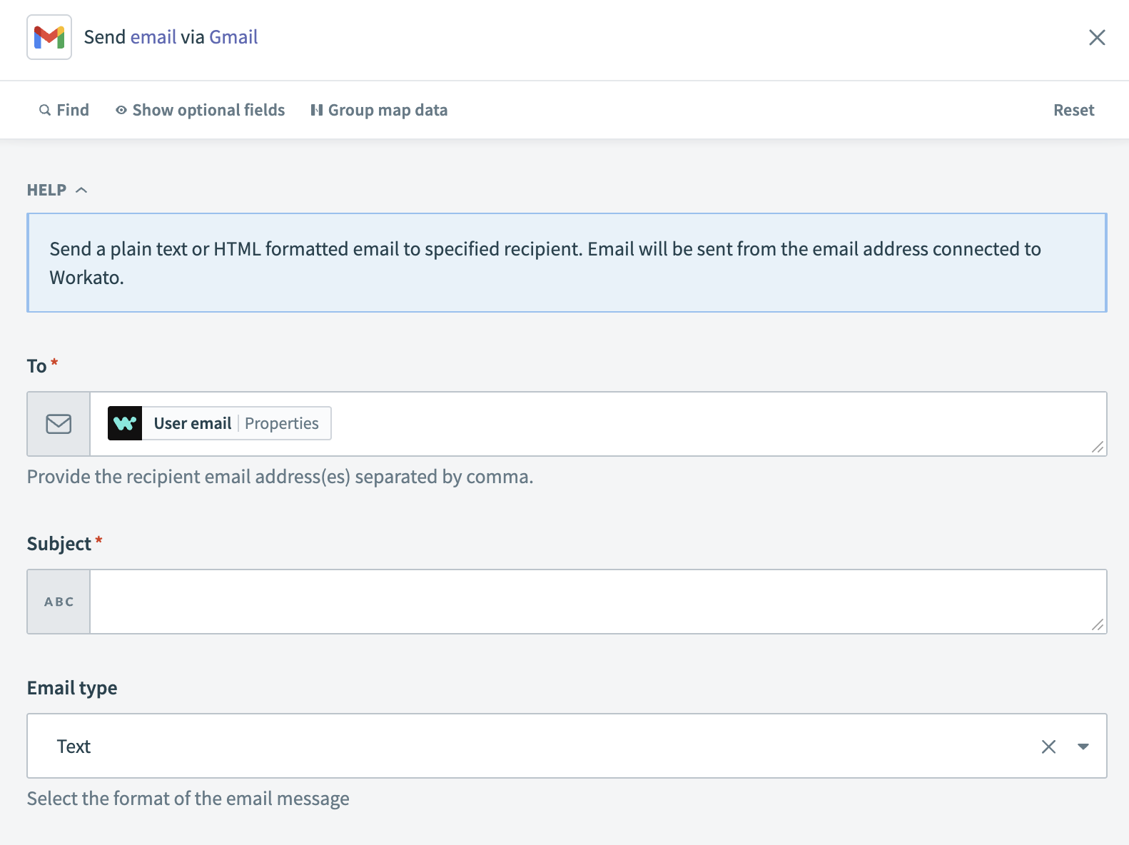

This step sends an email from your connected Gmail account when a pipeline sync fails.
Select the Send email action.
Enter one or more recipients in the To field. Separate multiple email addresses with commas.
Configure your Gmail action
Enter a subject in the Subject field, such as Pipeline Sync Failure Alert.
Select Text or HTML in the Email type field.
Enter the message body in the Message field.
