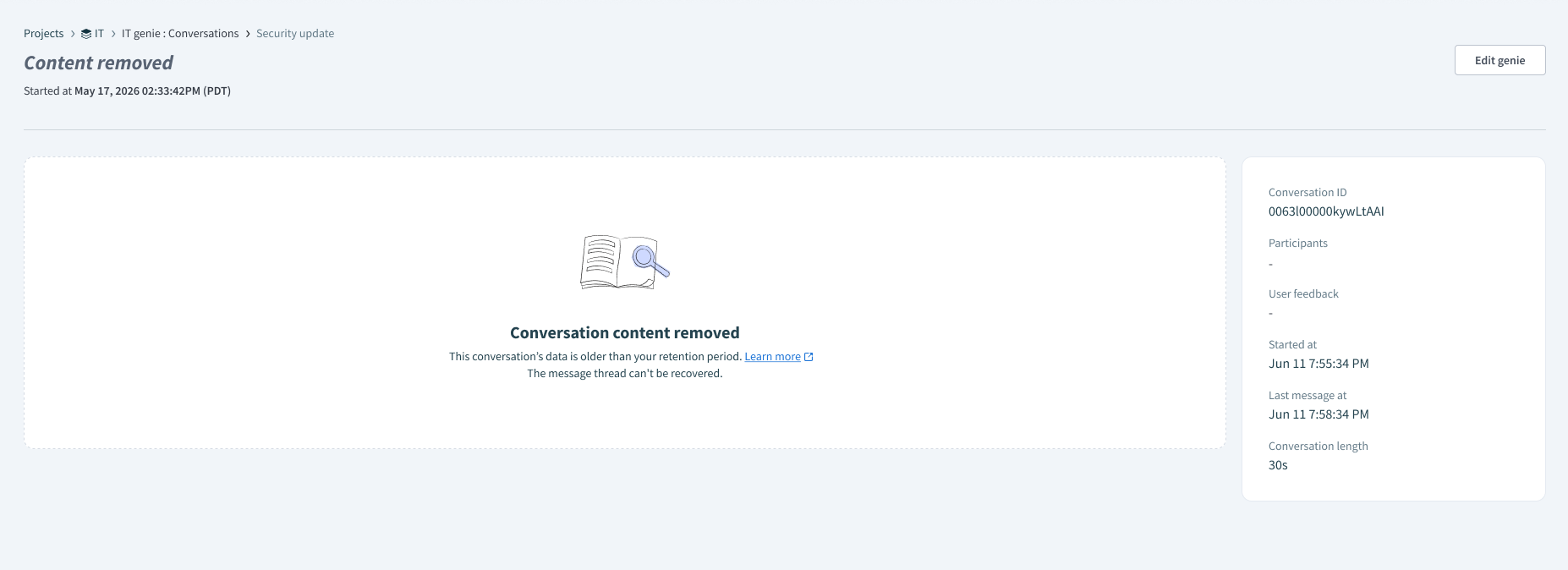

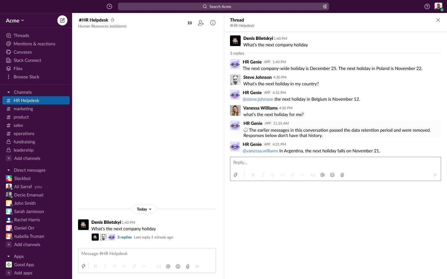

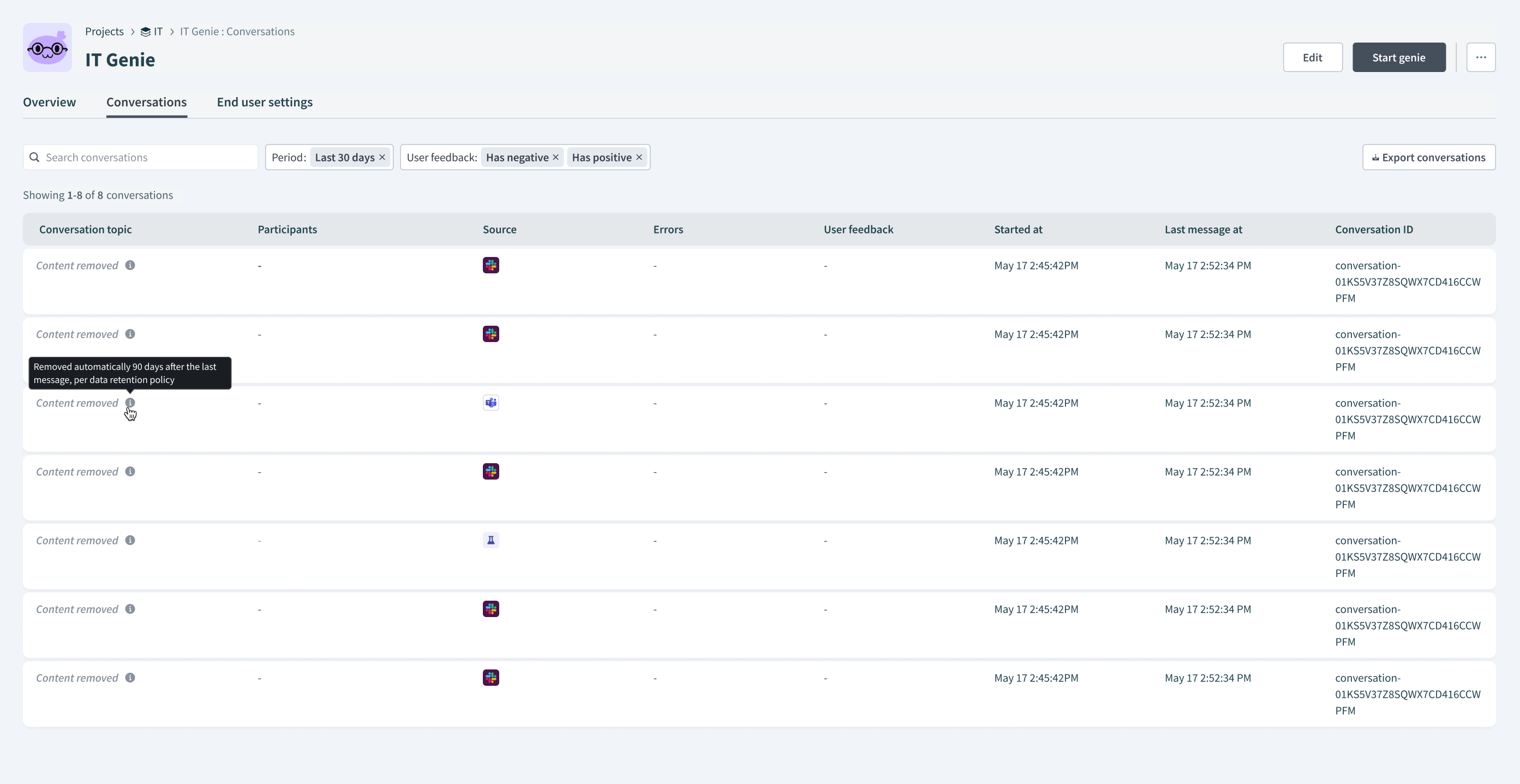

# Conversation data retention
Conversation record retention length affects the utility and level of risk for genie usage. Longer retention provides more history for debugging, QA, and compliance evidence. It also means more personal data retained for longer, increasing the risk surface for data breaches and the compliance burden under privacy regulations.
The proper retention period depends on:
  • Operational need: How far back do builders need to look to debug issues? 90 days of conversation history is sufficient for operational purposes for most genies. Edge cases that require looking further back are rare enough that they do not justify indefinitely long retention.
  • Compliance requirements: Some regulatory frameworks specify minimum or maximum retention periods for AI system interaction records. Financial services firms subject to MiFID II may be required to retain client communication records for five to seven years. Healthcare organizations subject to HIPAA may have specific retention requirements for records involving patient data. Identify the applicable requirements before configuring retention.
  • Privacy obligations: Under GDPR and similar frameworks, personal data should not be retained longer than necessary for the purpose for which it was collected. If conversations are retained for debugging purposes, the retention period should be the minimum needed for debugging - not indefinitely. Document the retention purpose and period as part of the genie's data protection impact assessment if one is required.
  • Data subject rights: Users may request deletion of their personal data under GDPR, CCPA, or similar regulations. Have a process for responding to these requests that includes conversation history. Know how to identify all conversation records for a specific user, how to export them for a subject access request, and how to delete them for an erasure request. Verify that the Workato platform's retention and deletion capabilities support these requirements.
