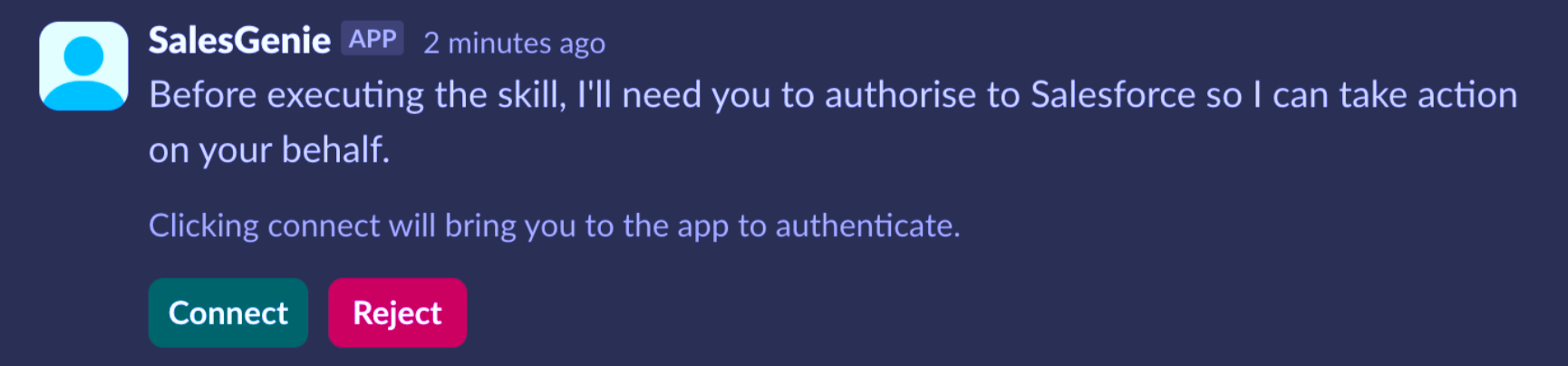

User connections link to the parent connection, environment, and user ID in Workato Identity when you use verified user access to create connections at runtime. The genie calls a skill that uses the parent connection when an end-user talks to a genie and triggers a recipe. The genie responds in one of the following ways:
  • Connection prompt: The chat interface prompts the user to click Connect if they've already created a runtime user connection. The skill recipe executes using this child connection.
  • Create a runtime connection prompt: The chat interface prompts the user to create a runtime user connection if they haven't already created a runtime user connection. The skill recipe executes using this child connection.
Connect prompt in the chat interfaceConnect prompt in the chat interface

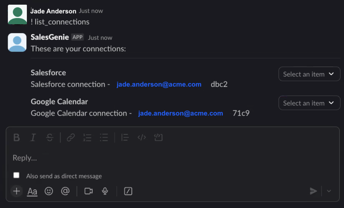

Keyword management in genie chat
You can manage your runtime user connections through the Slack and Microsoft Teams chat interfaces by typing the ! list_connections keyword directly into the chat.
KEYWORD FORMAT
You must include a space between ! and list_connections to correctly use the keyword.
The ! list_connections keyword allows you to:
  • View a list of your current runtime connections
  • Disconnect an active connection
  • Delete a saved connection
WORKATO GO KEYWORD MANAGEMENT NOT SUPPORTED
Workato GO doesn't support keyword management. You can manage Workato GO runtime user connections by going to Data sources > Genie Data Sources > Check Connection.
Complete the following steps to use keyword management:
Go to the genie where you plan to manage your connections.
Enter ! list_connections in the Slack or Microsoft Teams chat. The genie responds with a list of your current connections.
Keyword managementKeyword management
Use the option drop-down menu to disconnect or delete a connection.

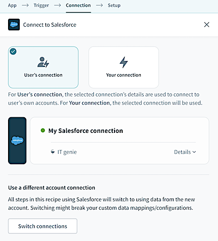

Complete the following steps to add verified user access to a skill recipe:
Go to the skills recipe where you plan to add verified user access.
Search for and select the app you plan to use. A list of available actions for the app displays.
Select the action you plan to use.
Select the connection type you plan to use for the skill recipe.
  • User's connection: Genie skill recipes perform actions based on the identity and permissions of the user who connects to the application. Users authenticate with their own credentials to execute the skill.
Connection typeSelect User's connection to enable verified user access
Refer to the Add skills section of the Agent Studio documentation for more information.
