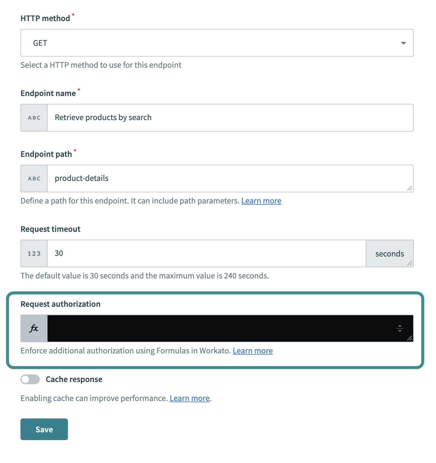

Configure custom authorization
Complete the following steps to configure custom authorization for an API endpoint:
Go to Platform > API platform > API collections.
Select the API collection with the endpoint where you plan to enforce custom authorization.
Click the relevant endpoint.
Open the Settings tab for the endpoint.
Go to the Request authorization field.
Go to Request authorization
Define your authorization claims using Workato formulas. Refer to the Example formulas section for more information.
Click Save to validate and apply the claims.

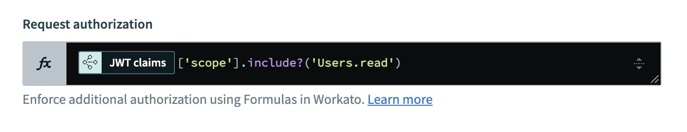

JWT claims in validation formulas
To validate JWT claims, you can use the following structure:
Reference JWT claim
This example formula checks whether the scope claim includes Users.read and uses the following components:
- JWT claims: The datapill that refers to the JWT claims in the token.
scope: The field that refers to the specific claim..include?('Users.read'): The method that checks whether thescopeclaim includes theUsers.readpermission.

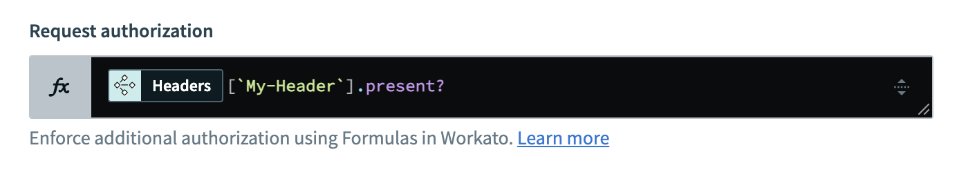

Headers in validation formulas
Header names follow canonical header key naming conventions. Request headers like my-header should be referenced with proper capitalization, such as My-Header. For example:
Reference headers
This formula uses the following components:
- Headers: The datapill that refers to the headers in the request.
My-Header: The field that refers to the specific header..present?: The method that checks whether the header is present in the request.

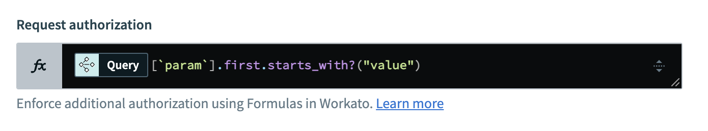

Query parameters in validation formulas
Query parameters are key-value pairs that can contain multiple values in an array. To reference a query parameter’s value in a formula, you must specify its position in the array. For example, to access the first value of a query parameter, use the .first formula, as shown in the following screenshot:
Reference query parameters
- Query: The datapill that refers to the query parameters in the request.
param: The field that specifies the query parameter..first.starts_with?("value"): The method that retrieves the first value in the query parameters array and checks if it starts with the stringvalue.
