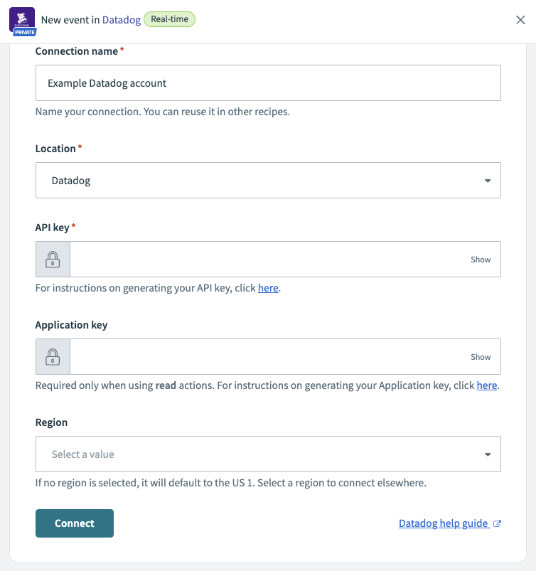

Complete the following steps to connect your Datadog account in Workato:
Datadog connection fields
Search for and select Datadog as your connection on the New connection page.
Enter your Datadog API key. Refer to the Datadog Add an API key guide to generate this value.
Optional. Enter your Datadog Application key if you plan to perform read actions. Refer to the Datadog Add application keys guide to generate this value.
Use the Region drop-down menu to select the location for your Datadog account. This field defaults to US 1 if left blank.
