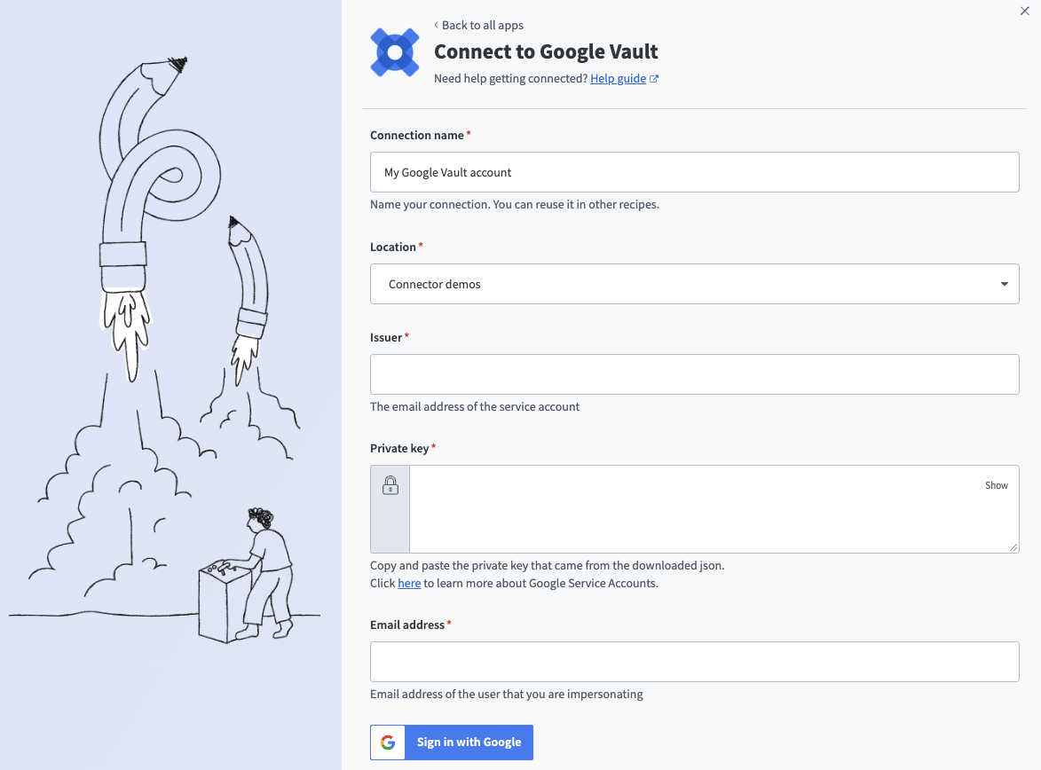

# Create a connection to Google Vault on Workato
Workato supports JWT authentication to connect to Google Vault.
Complete the following steps to connect Google Vault to Workato:
Click Create > Connection.
Search for and select Google Vault on the New connection page.
Google Vault connectionGoogle Vault connection
Enter your service account email address in the Issuer field.
Paste the private key from the downloaded JSON file in the Private key field.
Enter the user email address that serves as the primary subject of the JWT in the Email address field.
Click Sign in with Google to complete the connection.
