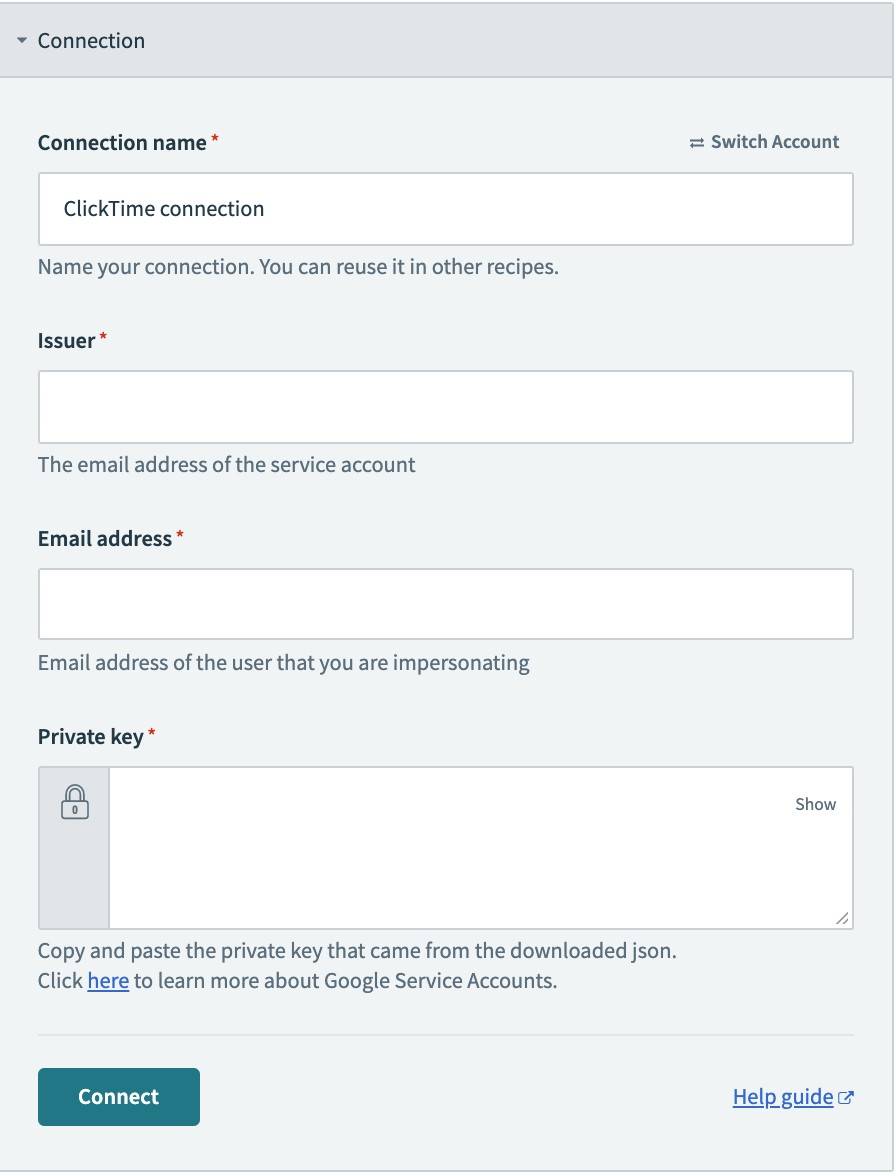

Step 1 - Defining Connection fields
This component tells Workato what fields to show to a user trying to establish a connection. In the case of Client Credentials Authentication, you would need the Client ID and Client Secret that the user has generated in Percolate.
Information neededDescription
IssuerThe "iss" (issuer) claim identifies the principal that issued the JWT.
SubjectThe "sub" (subject) claim identifies the principal that is the subject of the JWT. The claims in a JWT are normally statements about the subject. In this case, it is the email address of the user that you are impersonating.
Private/public keyThis is the "password" that is obtained from the downloaded JSON.
This is done in the fields key, which accepts an array of hashes. Each hash in this array corresponds to a separate input field.

Configured Google calendar connection fields
TIP
When defining fields, you need to at least provide the name key. Additional attributes like optional, hint and control_type allow you to customize other aspects of these fields. For sensitive information like Client Secrets, remember to use the control_type as password.
Refer to Connection fields for more information on defining input fields in Workato.
