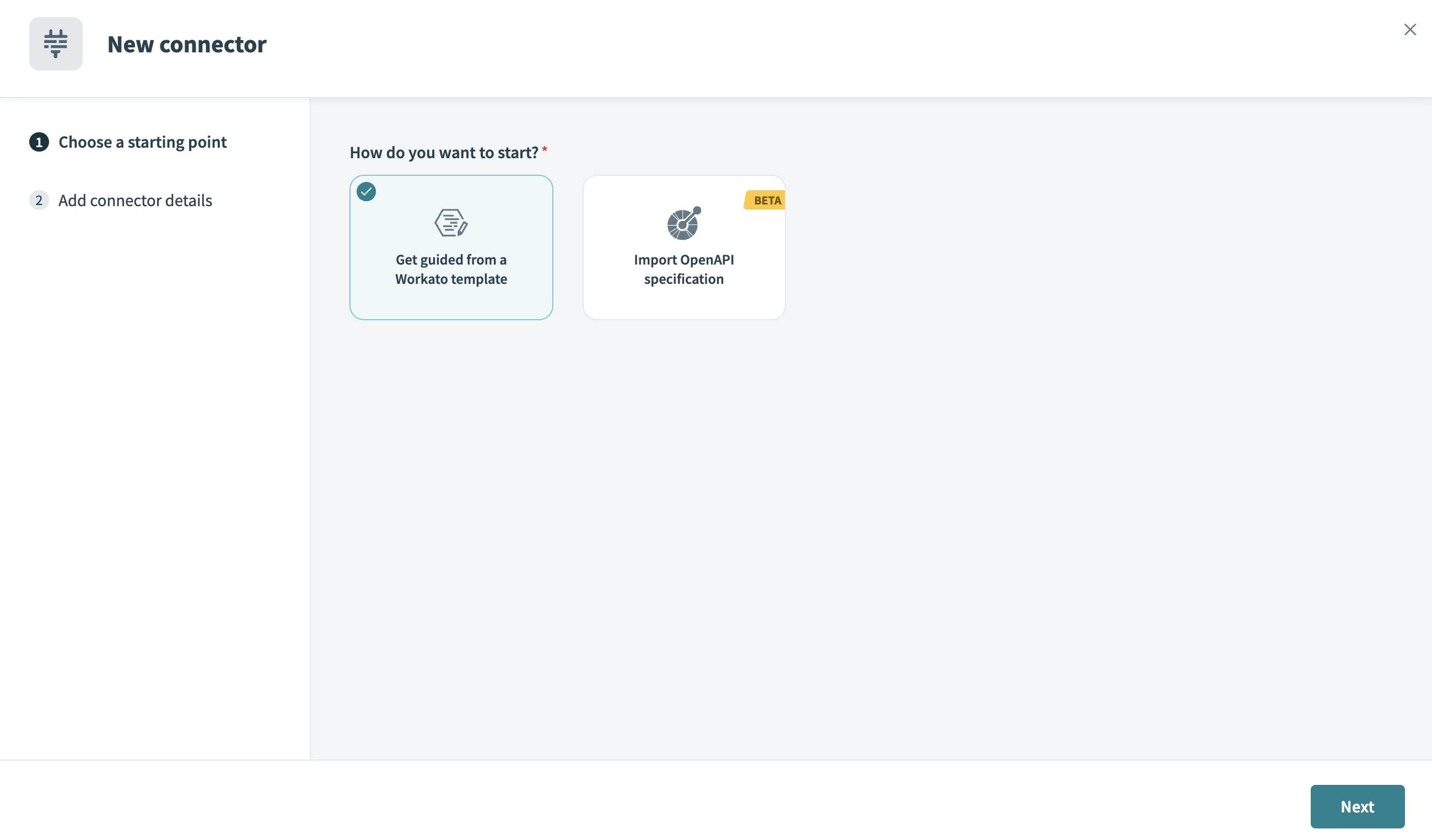

Select Get guided from a Workato template or Import OpenAPI specification as your starting point, then click Next. Note that OpenAPI is in beta and must be provided in OpenAPI 3.0 specification. Learn more about OpenAPI specification.
Create a new connectorSelect the icon logo to upload an icon from your local machine

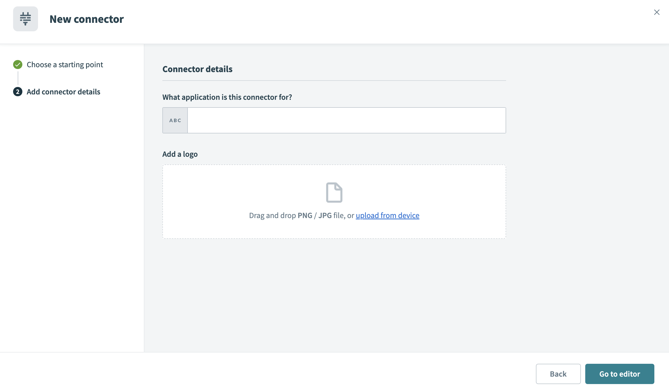

Provide a description and logo for your connector, then click Go to editor.
Add connector detailsProvide a description and logo
