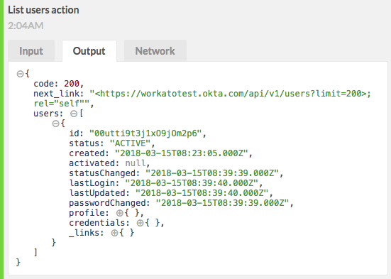

after_response can be used to handle all these parts of the HTTP response. Suppose I have an action that lists all users and outputs the entire response, including the link to the existing page from the header.
execute: lambda do |connection, input|
get("/api/v1/users").after_response do |code, body, headers|
code: code,
next_link: headers["link"],
users: body
end
endThe resultant output of this action will contain all 3 parts of the response.
"code": 200,
"next_link": "<https://workatotest.okta.com/api/v1/users?limit=200>; rel=\"self\"",
"users": [
"id": "00utti9t3j1xO9jOm2p6",
"status": "ACTIVE",
"created": "2018-03-15T08:23:05.000Z",
"activated": null,
"statusChanged": "2018-03-15T08:39:39.000Z",
"lastLogin": "2018-03-15T08:39:40.000Z",
"lastUpdated": "2018-03-15T08:39:40.000Z",
"passwordChanged": "2018-03-15T08:39:39.000Z",
"profile": {},
"credentials": {},
"_links": {}
}Testing
You can easily verify this while developing your custom connector. When you include post-request handling, the output tab should reflect the expected JSON object.
Output with response code and header values
