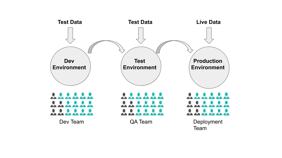

An example of a typical software lifecycle includes the use of 3 environments: a development, staging (QA), and a live production environment.
EnvironmentsSet up with dev, test, and production environments

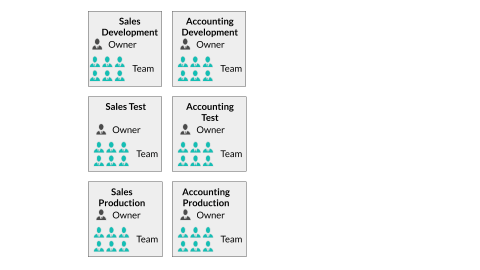

Multiple workspaces
When there are a large number of recipes in use, or when multiple distinct departments or groups work on recipes within a single stage (for example: each department does its own development), then there are a couple of ways to segment accounts further. One is to use distinct accounts for each group + stage. For example, like this:
Workspaces and departmentsA workspace account is created for each department

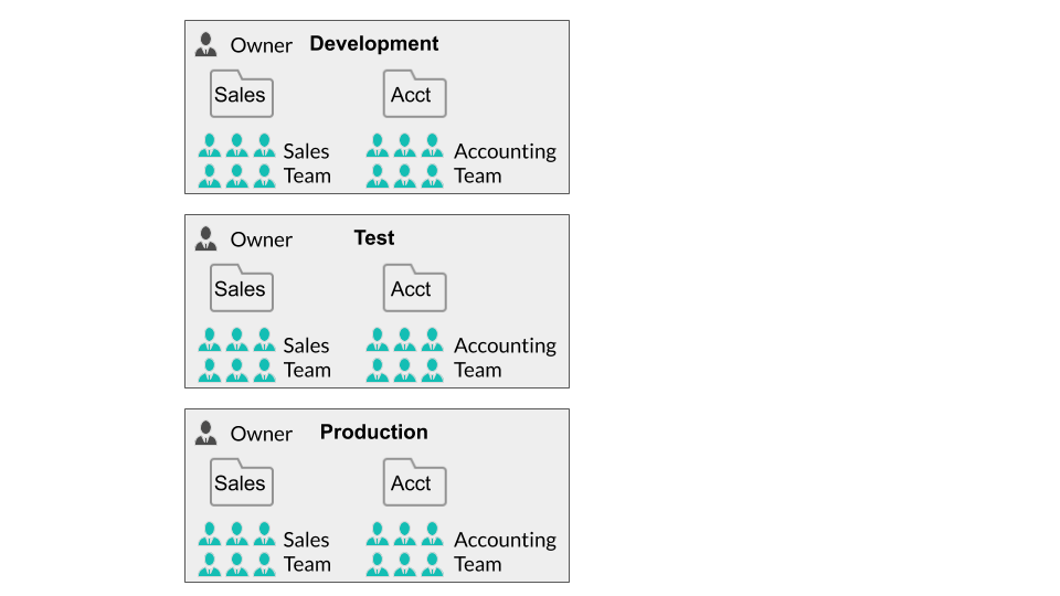

Multiple folders
Another possibility is to segment one or more of the workspace accounts so that different users access different folders, like this:
RLM in tools gifFolders are created in each environment for distinct departments
This can be convenient, but may complicate role management, for reasons described in the next section.

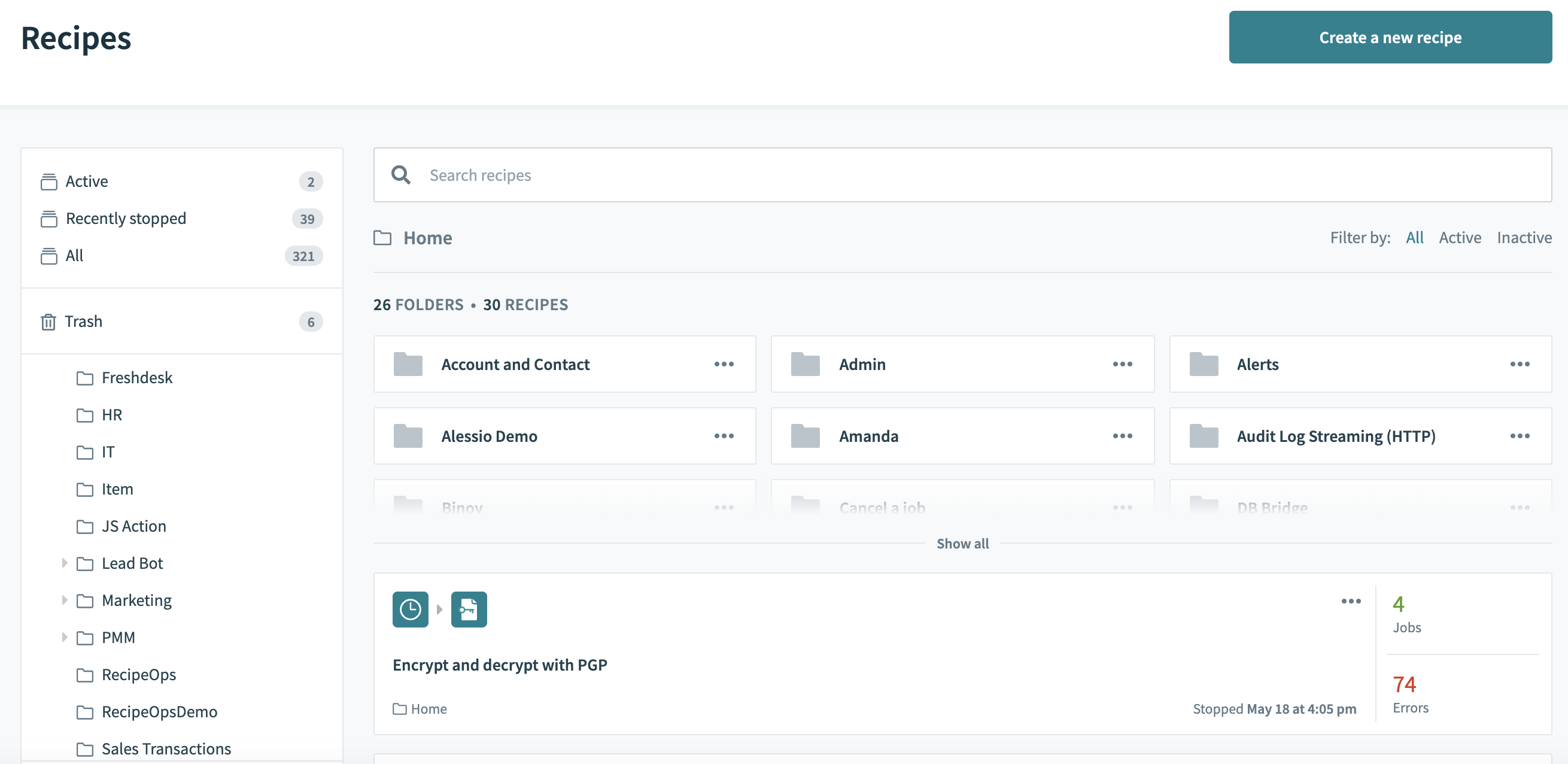

Folders
It is also worth thinking about how recipes should be organized into folders, and what naming conventions should be used for this. As mentioned earlier, you may want to use folders together with custom roles so that members within a workspace can be assigned responsibility for recipes within a particular folder or folders.
FoldersExample of recipes in a folder
You should try to avoid having a large number of recipes all placed in the root (Home) folder, which is the default location. Workato recommends that if you have more than 5-10 recipes, these should be organized into folders, and that each folder should also be restricted to a small manageable number (10 or so maximum) of related recipes.
Folders are also the unit that is used for import and export of assets, so recipes and related objects such as connections should be placed together in a folder if they are to be migrated across accounts together.

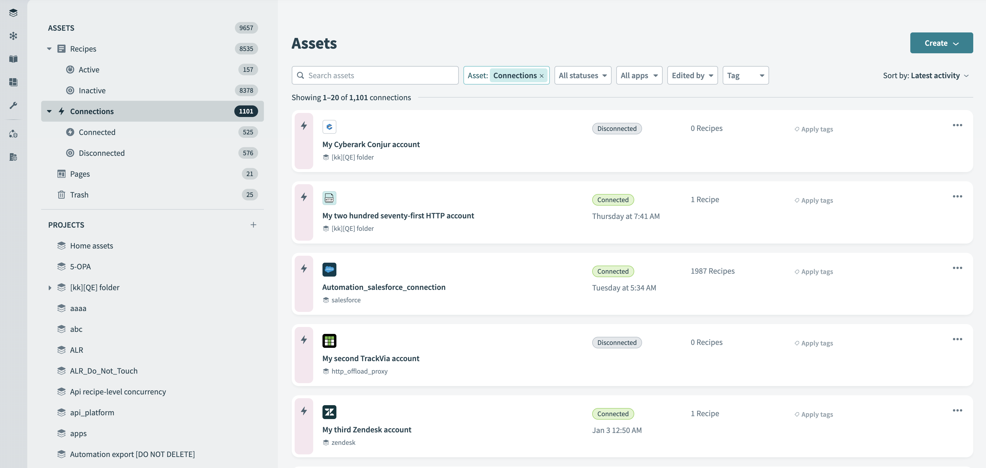

Connections
Connections can be scoped into folders in Workato. By default, their scope is the Home folder. However, when preparing to use Lifecycle Management, you may want to associate the connections required by the recipes in a folder you plan to export to that folder.
This can be done by visiting the App Connections tab and dragging the corresponding connections into a folder shown on the left-hand side of the page. This will help organize your connections and ensure that the correct connections are used for each exported folder.
App connectionsApp connections can be organized and managed by folders
Assigning connections to folders also makes it possible to restrict access to connections by workspace members. Only those connections in folders to which a workspace member has access will be visible and usable by that member.

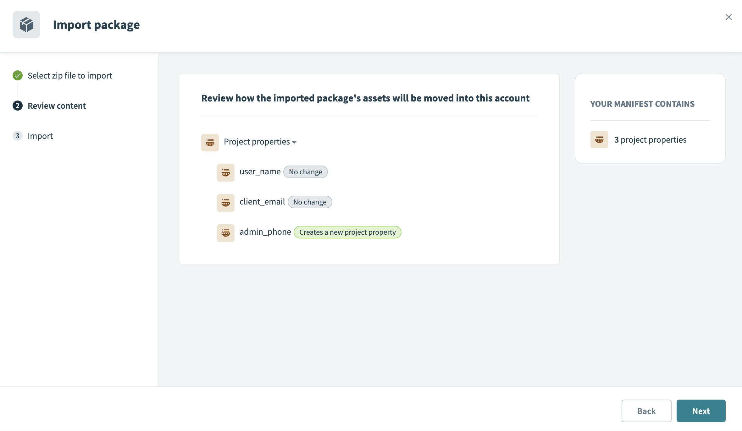

Project properties
Project properties are available only at the project level in the specific project where you create and maintain them. You can deploy these properties to another folder.
However, if you have created project properties, but have not used them in any active recipes, Workato does not include them in your manifest and you cannot export them using the recipe lifecycle management tool.
When Workato exports project properties, it exports only the Property name and does not include the Value of the property. Because of this, if you import a package containing project properties into a folder where project properties with the same names already exist, Workato does not override the value of the existing properties.
For example, consider a situation where a folder named Customer onboarding contains a project property named client_email whose value is [email protected]. If you import a package into Customer onboarding that also contains the property client_email with the value [email protected], client_email's value is still [email protected].
Import project propertiesInclude project properties in a package

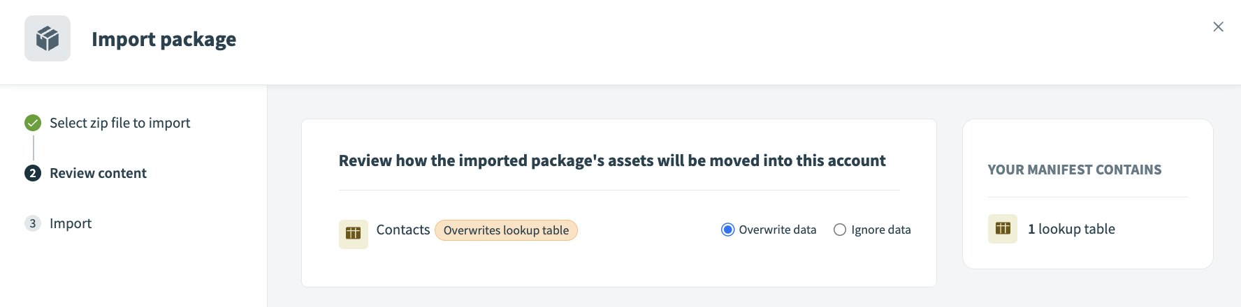

Lookup tables
If you plan to export a lookup table (LUT) as part of your package, you must use the lookup table in a recipe. The recipe lifecycle management tool does not export lookup tables that are not included in recipes.
Whether scoped to a specific project or globally, a lookup table cannot have the same name as another lookup table in the same workspace. Because of this, when you import a recipe with a lookup table, Workato follows this logic:
  • If a lookup table with this name does not exist in the target workspace, the lookup table from the package is created. It inherits its scope (project or global) from the source workspace.
  • If a lookup table with this name already exists in the target workspace, the structure of the lookup table (and content, if you choose to import it) overwrites the existing lookup table. However, its scope (project or global) does not change and matches the scope of the original lookup table. We recommend that you check the scope before and after importing a lookup table into your workspace.
Import a lookup tableOverwrite or ignore lookup table data
