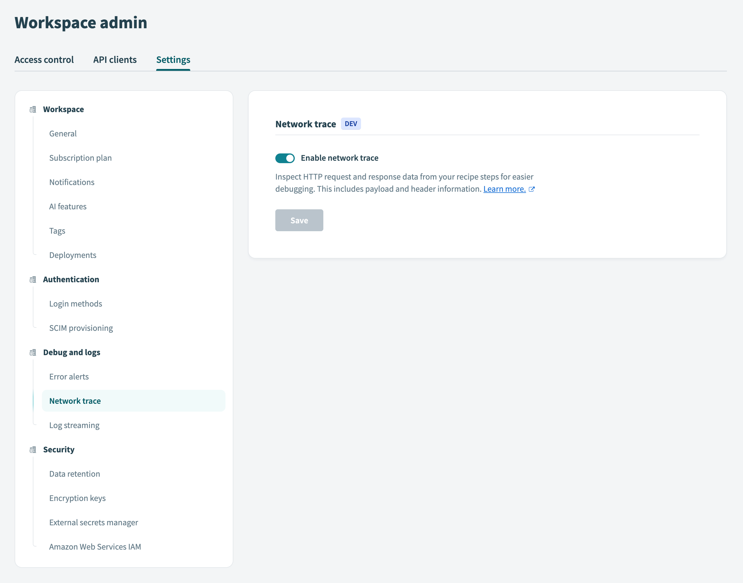

# Enable and disable job debug tracing
To enable or disable job debug tracing:
Go to Workspace admin > Settings > Network trace.
Click the Enable network trace toggle.
Click Save.
Enable or disable job debug tracing Enable or disable job debug tracing
