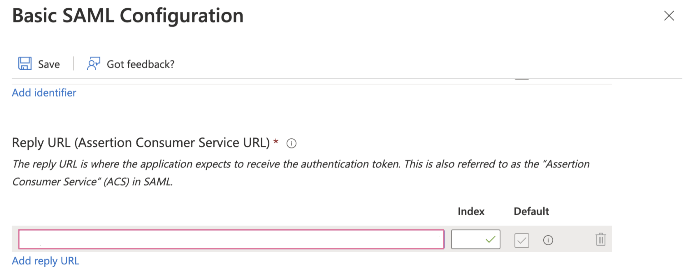

Go to the Basic SAML Configuration section and click Edit.
Paste the Service provider (SP) entity ID from Workato into the Identifier (Entity ID) field.
Paste the Single sign-on URL from Workato into the Reply URL (Assertion Consumer Service URL) field.
Click Save.
