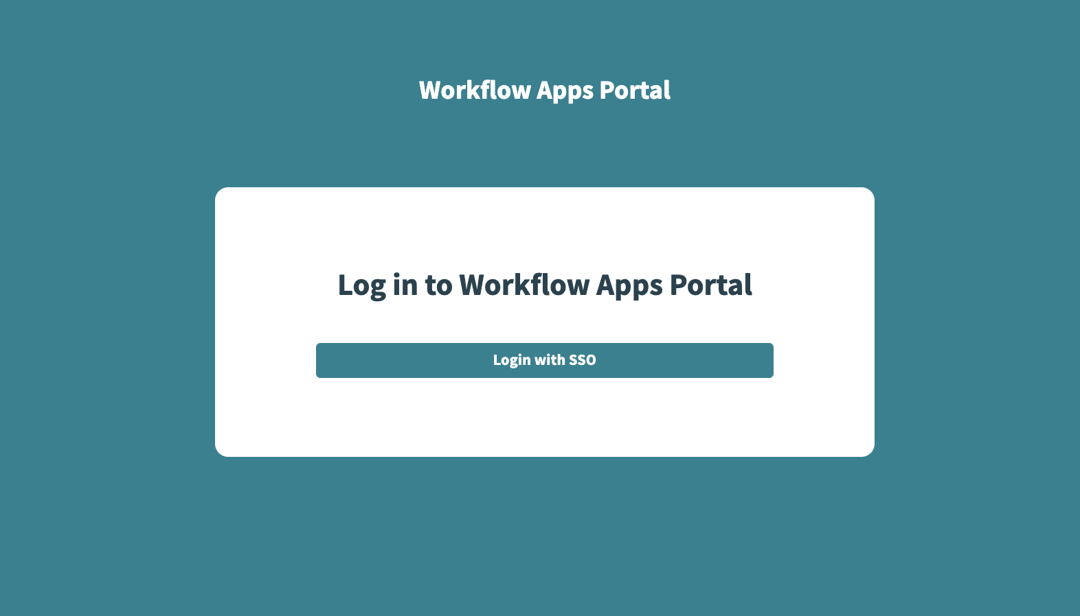

Sign in to the Workflow apps portal through SAML-based SSO

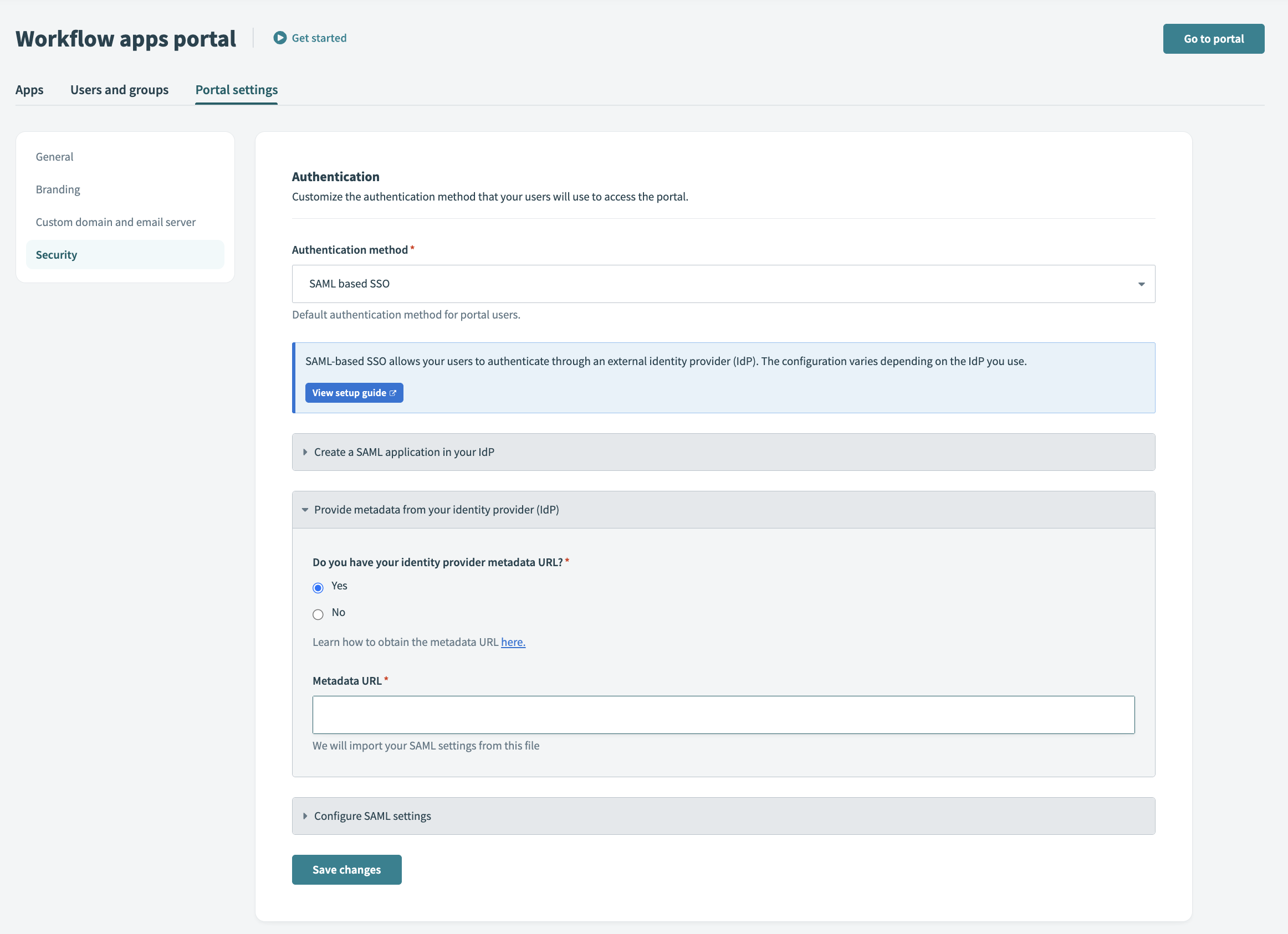

Go to Platform > Workflow apps portal > Portal settings > Security.
In the Authentication method field, select SAML based SSO.
Workato SAML setup
After you select SAML based SSO, the portal settings display the Single Sign-On URL and Audience URI (SP Entity ID). Use these values to set up a SAML application in your IdP.
The Single Sign-On URL and Audience URI (SP Entity ID) formats vary and are unique to your Workflow apps portal subdomain/domain and the data center in which your account is located.
Provide metadata from your IdP. In the Do you have your identity provider metadata URL field, select Yes or No.
In the Enforce SAML authentication for field, decide whether to enforce SAML authentication for all Workflow apps users or only specific domains.
Users outside those domains can sign in using password authentication. This approach is useful for complying with organizational SSO policies while allowing external users without an identity provider account to access Workflow apps.
Optionally, click Enable JIT (Just-In-Time) provisioning to automatically add users to the portal after identity provider authentication.
When JIT is enabled, any user signing in to Workato through SSO for the first time is automatically added to the portal.
Optionally, click Enable user groups syncing to sync user groups from your IdP. This step is mandatory if you plan to manage user groups through your IdP.
User group syncing does not take effect immediately. Group syncing is enforced each time a user signs into the portal through their IdP.
If you plan to enable user groups syncing
Specify the following SAML attributes in your identity provider:
| Name | Value | |
| Attribute 1 | workato_app_user_name | user.displayName |
| Attribute 2 | workato_app_user_groups | appuser.workato_app_user_groups |
Optionally, customize the session duration for the Workflow apps portal by modifying the SessionNotOnOrAfter parameter in your identity provider. Otherwise, the default session timeout is seven days if you haven't enabled group syncing through your IdP. When group syncing is enabled through your IdP, the default session timeout is one day if you don't customize this parameter.
Refer to your IdP's documentation to learn how to enable this capability for your app integration.
Click Save changes.
