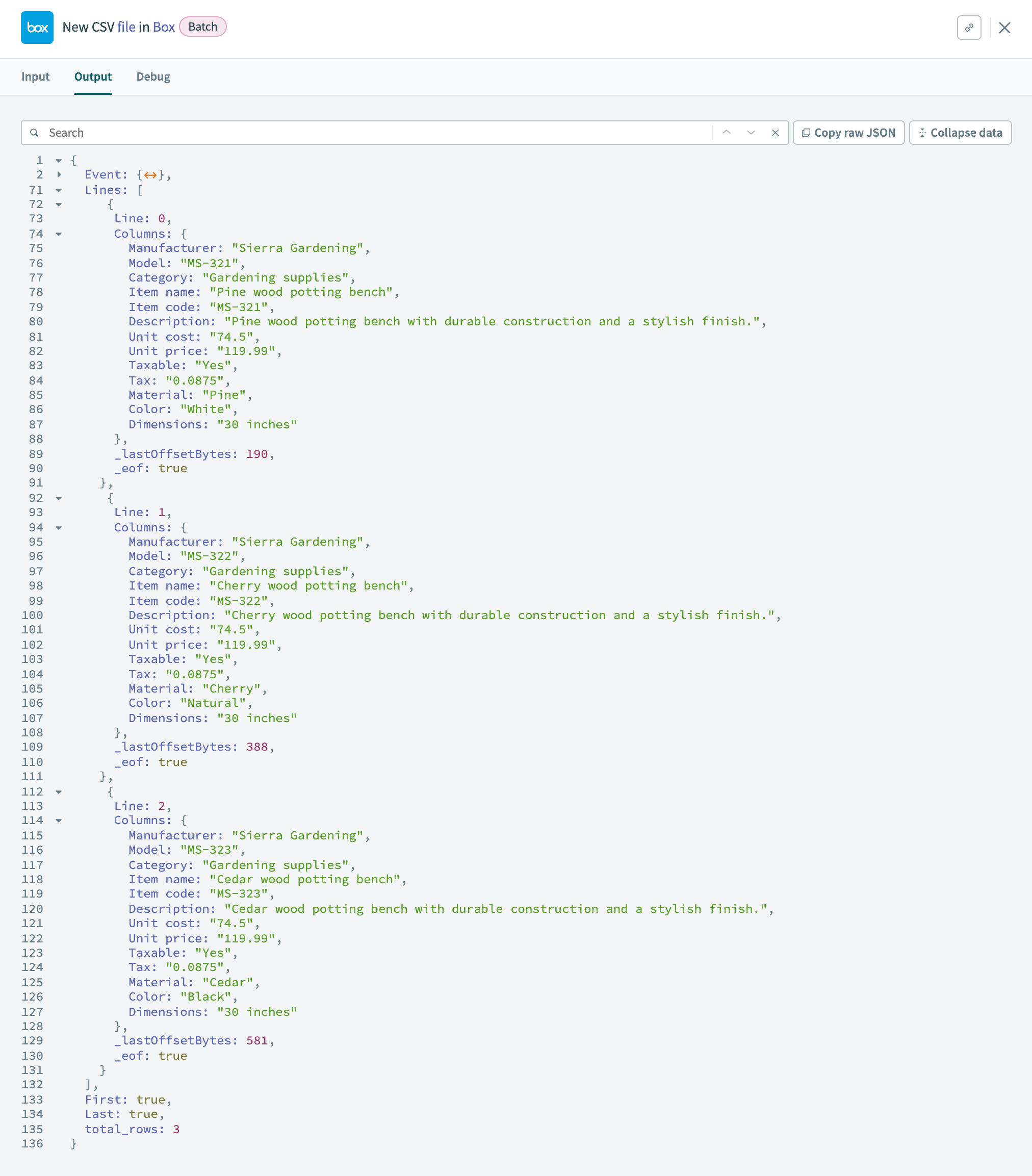

In the job details page, the trigger output displays all three lines within the CSV file.
Trigger output details displaying lines within the CSV file
As the Log message action uses only datapills directly from the list, without handling the list in any way, only the first line's data is retrieved.
Log message input displaying only the first line of data

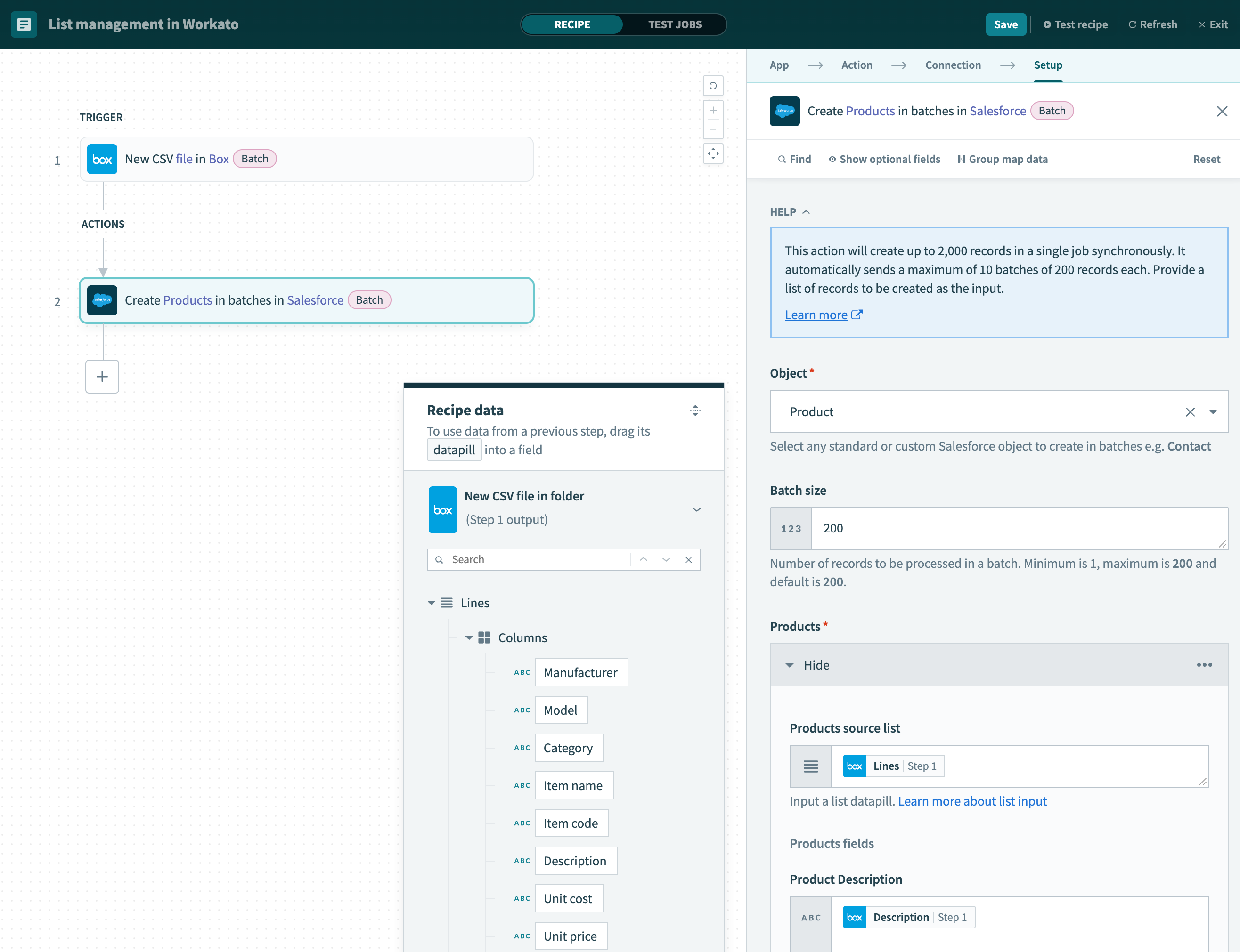

The following is an example scenario that imports new products from a Box CSV file into Salesforce via the Bulk insert action.
Example recipe using list input. Example recipe (opens new window)
Actions that take lists as inputs will have an input field called Source list, which will only take in list pills. When these list input fields are selected, the datatree changes to offer only list pills. The Rows list object pill is mapped into the Salesforce product source list input field.
For the list object passed into the input source list, the list will be transferred from the source app to the target app, with the values being transferred based on the fields mapped in the recipe. The three inventory items will be moved from Box into Salesforce as products.

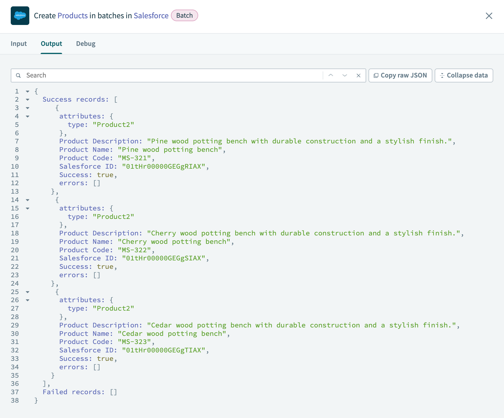

The action output in the job history shows that three products have been created accordingly in Salesforce.
Salesforce bulk insert via list input

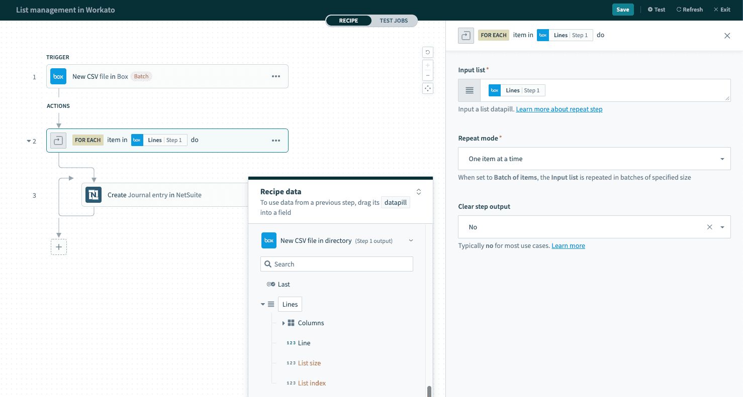

In order to move through the list and create three NetSuite inventory items, the Repeat step should be used to iterate through the list, and carry out the same action for each iteration.
Recipe using repeat step to iterate through NetSuite list of inventory items. Example recipe (opens new window)
To iterate through the Rows list, pass the Rows list object as input for the repeat step. The recipe will therefore iterate through the list thrice to repeat the "Add inventory item" action thrice, with different values from different CSV lines each time.
Provide the list object as input for repeat step

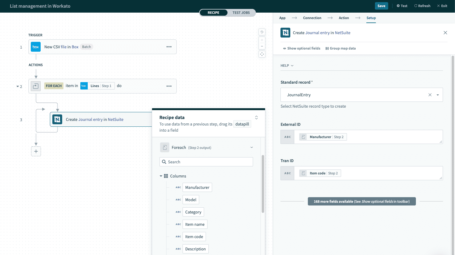

When using the Repeat step, the important thing to note is to retrieve datapills from the For each datatree.
Mapping datapills from the Foreach datatree
This ensures that, when the list is being iterated through, the first Add inventory item step uses the first line:
Sierra Gardening, MS-321, Gardening supplies, Pine wood potting bench, MS-321, Oakwood potting bench, 74.50, 119.99, Yes, 0.0875, Pine, White, 30 inches
The second Add inventory item step uses the second line:
Sierra Gardening, MS-322, Gardening supplies, Cherry wood potting bench, MS-322, Oakwood potting bench, 74.50, 119.99, Yes, 0.0875, Cherry, Natural, 30 inches
And the third Add inventory item step uses the third line:
Sierra Gardening, MS-323, Gardening supplies, Cedar wood potting bench, MS-323, Oakwood potting bench, 74.50, 119.99, Yes, 0.0875, Cedar, Black, 30 inches
