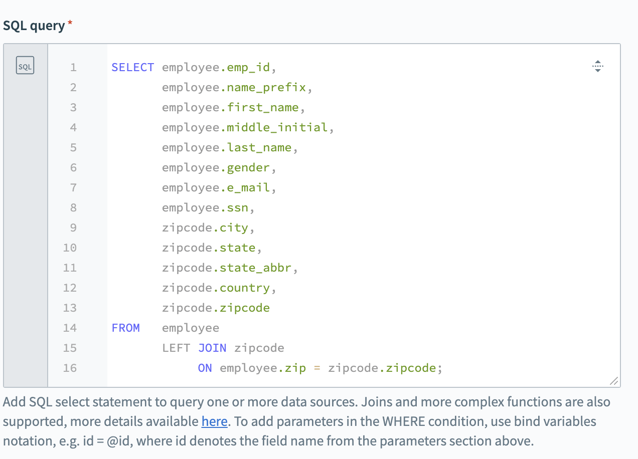

Example query setup
The following query merges the employee and zipcode tables together based on the zipcode column in both tables.
Example query setupExample query setup
