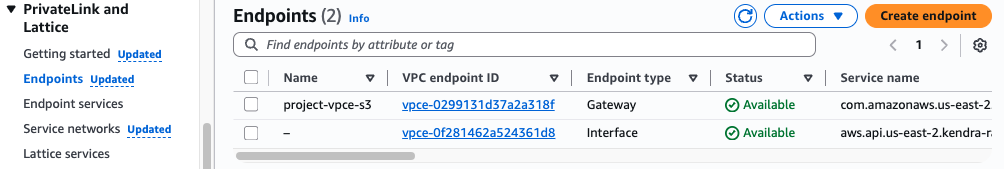

Open the AWS console and go to VPC dashboard > PrivateLink and Lattice > Endpoints.
The AWS console Endpoints page

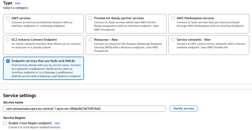

Click Create endpoint.
Set the endpoint Type to Endpoint services that use NLBs and GWLBs.
The endpoint Type and Service name
Enter the Service name provided by Workato.
Click Verify service to ensure the service name is formatted correctly.

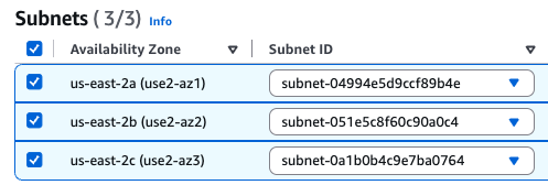

Go to the Subnets section and select three Availability Zones.
Select three Availability Zones
Use the Subnet ID drop-down menu to select a subnet for each zone.

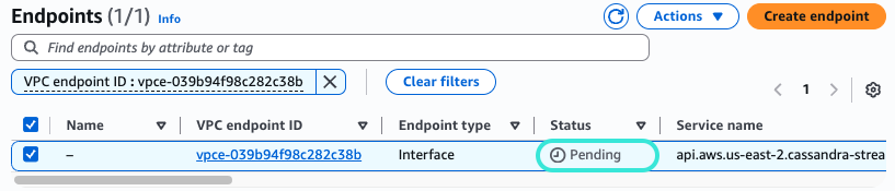

Click Create Endpoint. The newly created endpoint is Pending acceptance until Workato approves it and it becomes Available. You can check an endpoint's Status on the Endpoints page.
Check an endpoint's status on the Endpoints page

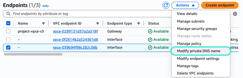

Select the endpoint for which you plan to enable private DNS names.
Use the Actions drop-down menu to select Modify private DNS name.
Select Modify private DNS name

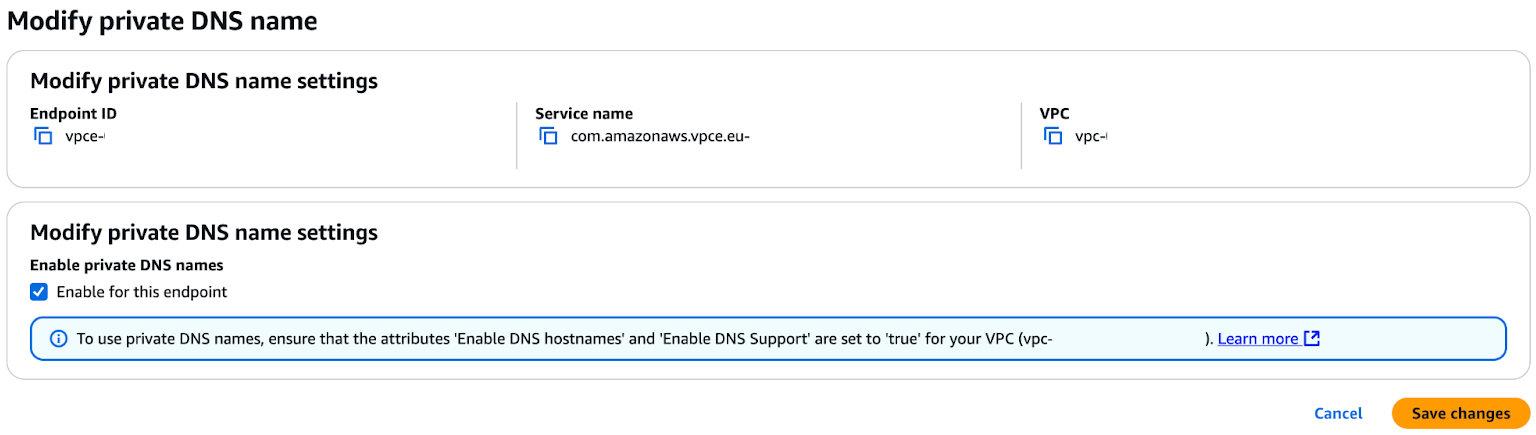

Click the Enable for this endpoint checkbox, then click Save changes.
Ensure the endpoint's Private DNS name is the same as the DNS name provided by Workato.
