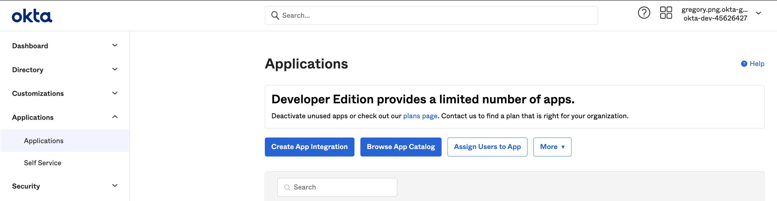

Go to Applications > Applications and click Create App Integration.
Add application in Okta

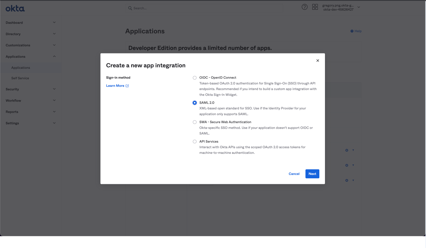

Select SAML 2.0 as the Sign-in method and click Next.
Create a new application in Okta
