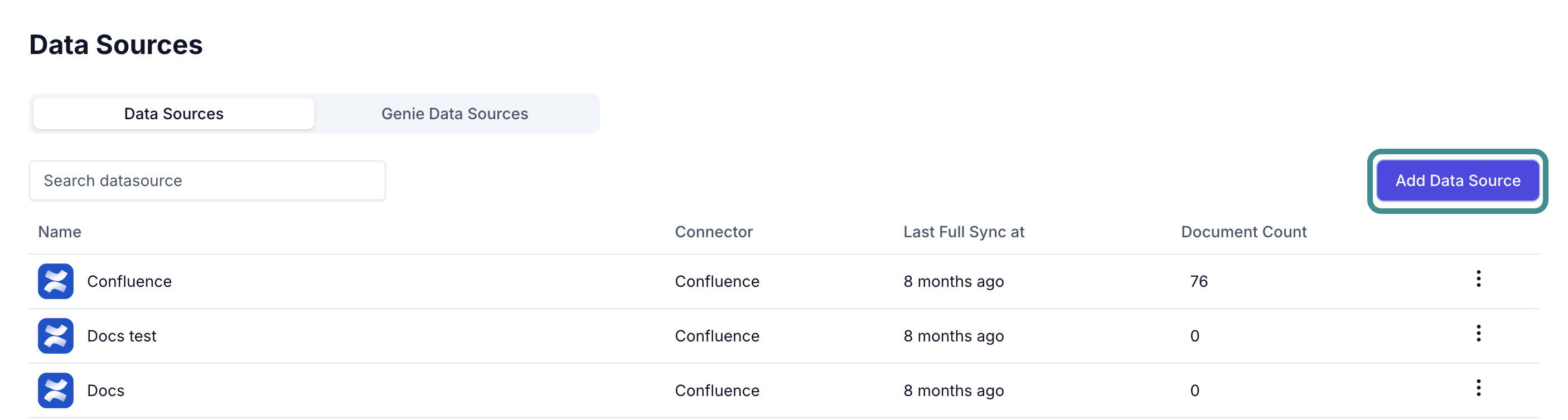

Sign in to Workato GO and go to Data sources.
Click Add Data Source.
Add data sourceAdd data source

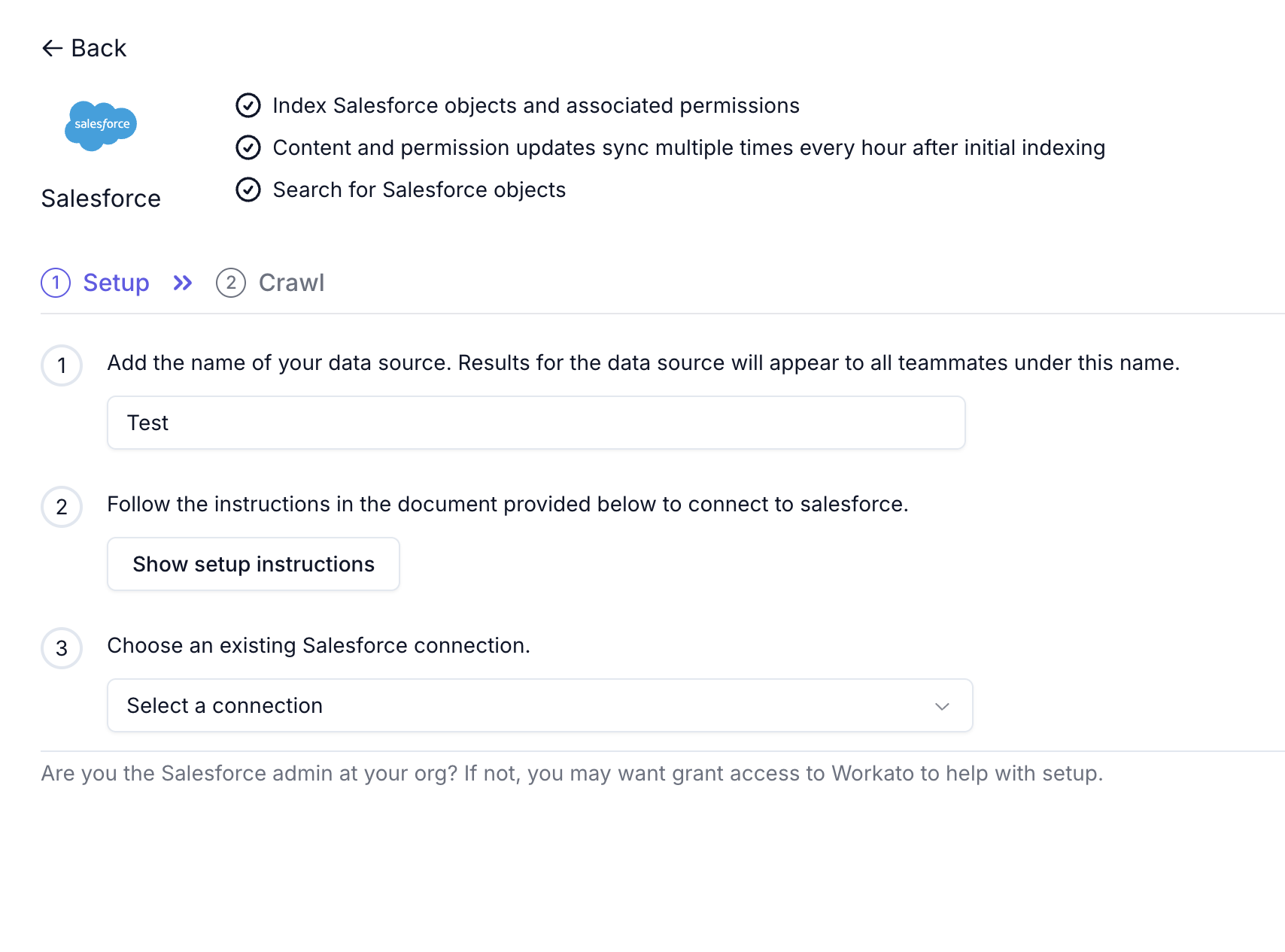

Select Salesforce.
Salesforce data sourceSalesforce data source
Enter a name for the data source. Results for this data source appear to all teammates under this name.
Configure your data sourceConfigure your data source
Optional. Click Show setup instructions to view the Salesforce connection setup guide if you haven't configured a connection.
Use the Choose an existing Salesforce connection drop-down menu to select your Salesforce connection.

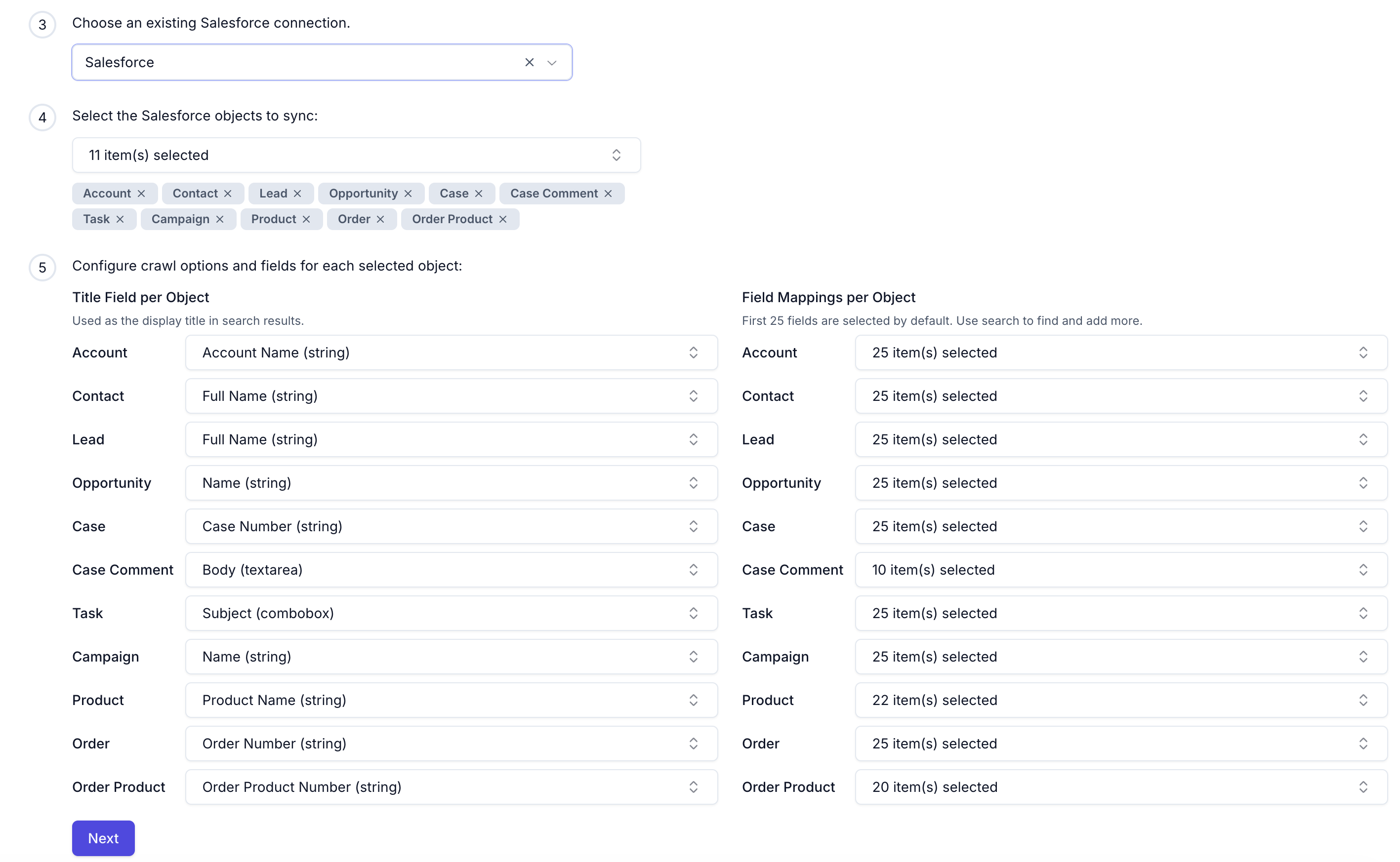

Select the Salesforce objects to sync.
Select Salesforce objects to syncSelect Salesforce objects to sync
Configure crawl options and fields for each selected object:
  • Use the Title Field per Object drop-down menu to select the field displayed as the title in search results for each object.
  • Use the Field Mappings per Object drop-down menu to review or update the fields indexed for each object. The first 25 fields are selected by default.
Click Next.

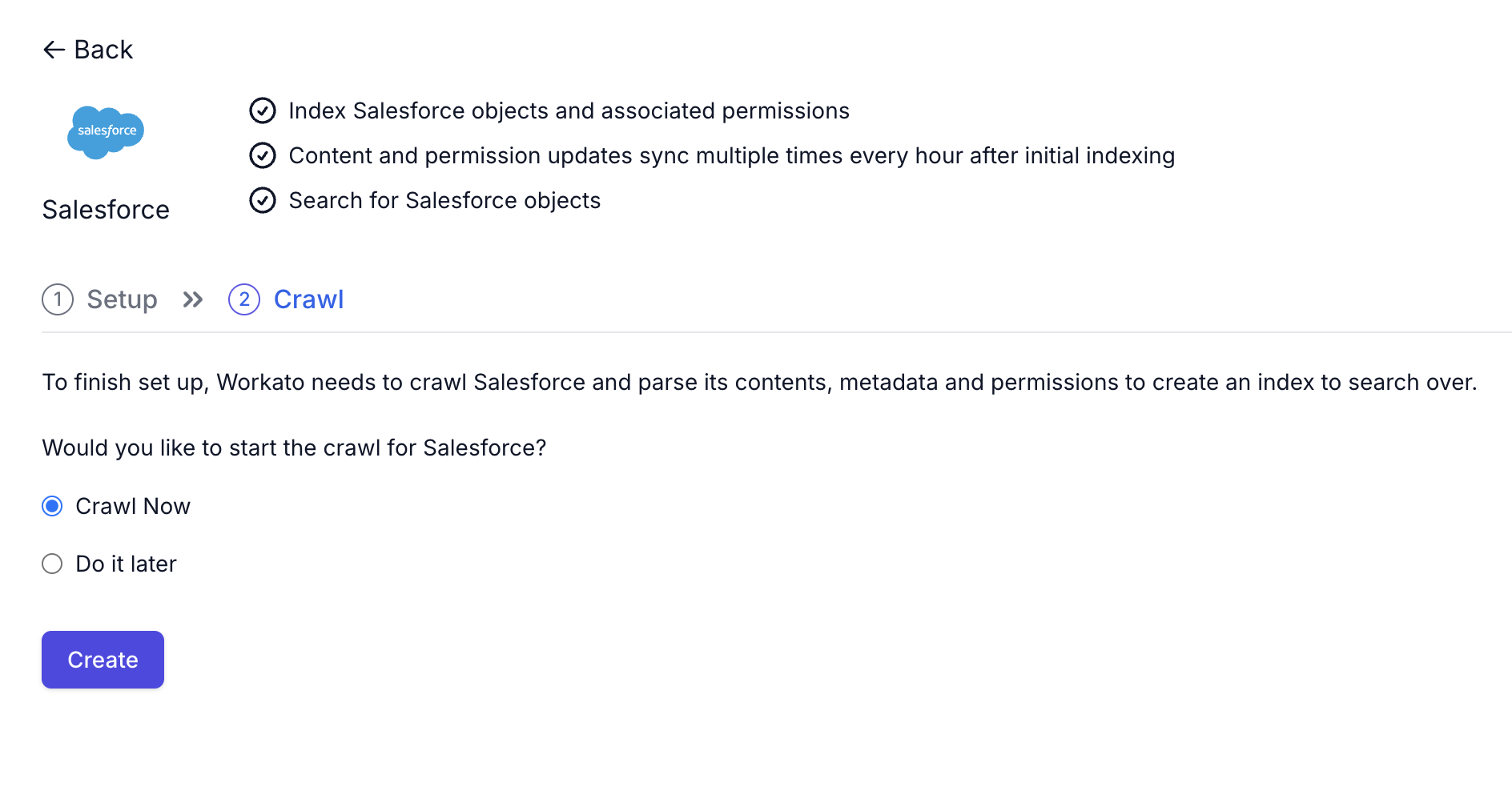

Choose when to start the crawl:
  • Select Crawl Now to start immediately
  • Select Do it later to delay the crawl
Click Create.
Finish set upFinish set up
