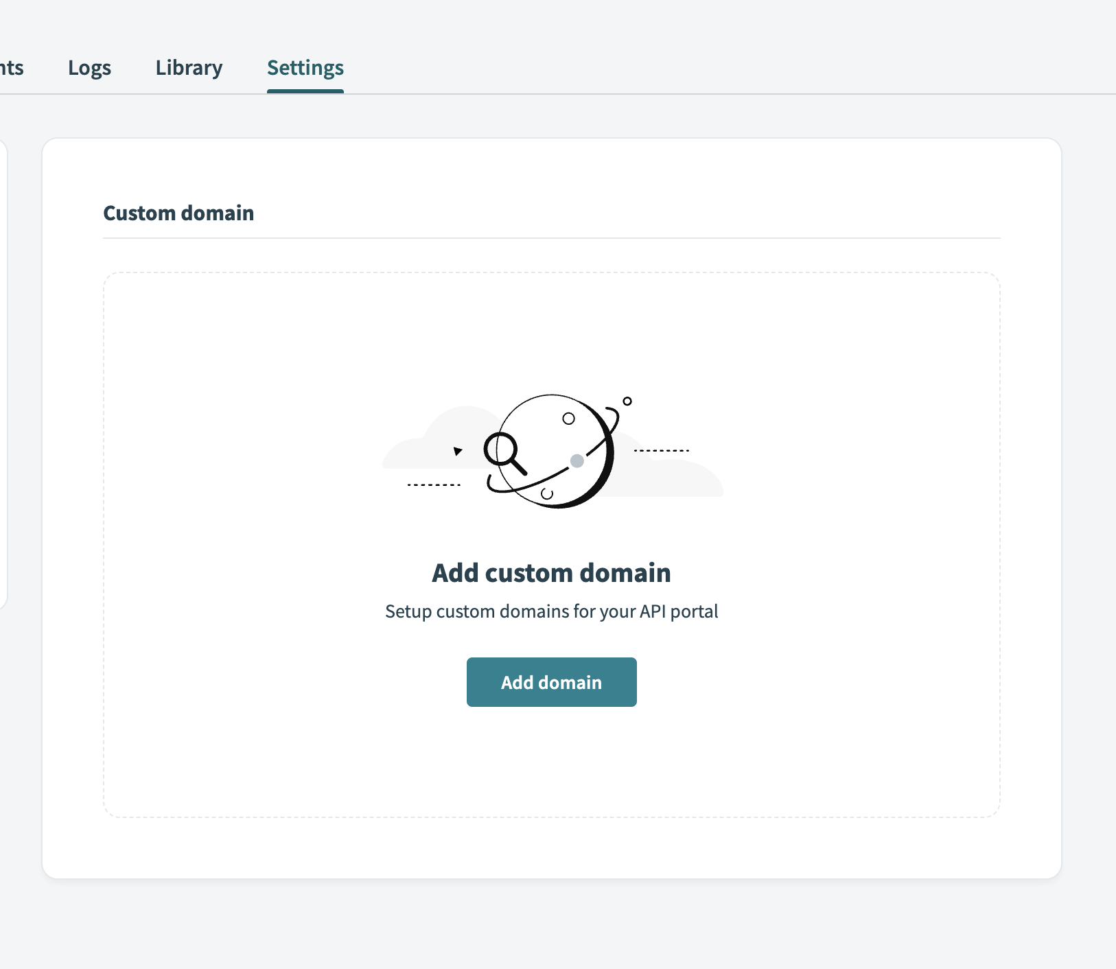

Go to Platform > API platform > Settings > Developer Portal > Custom domain.
Click Add domain.

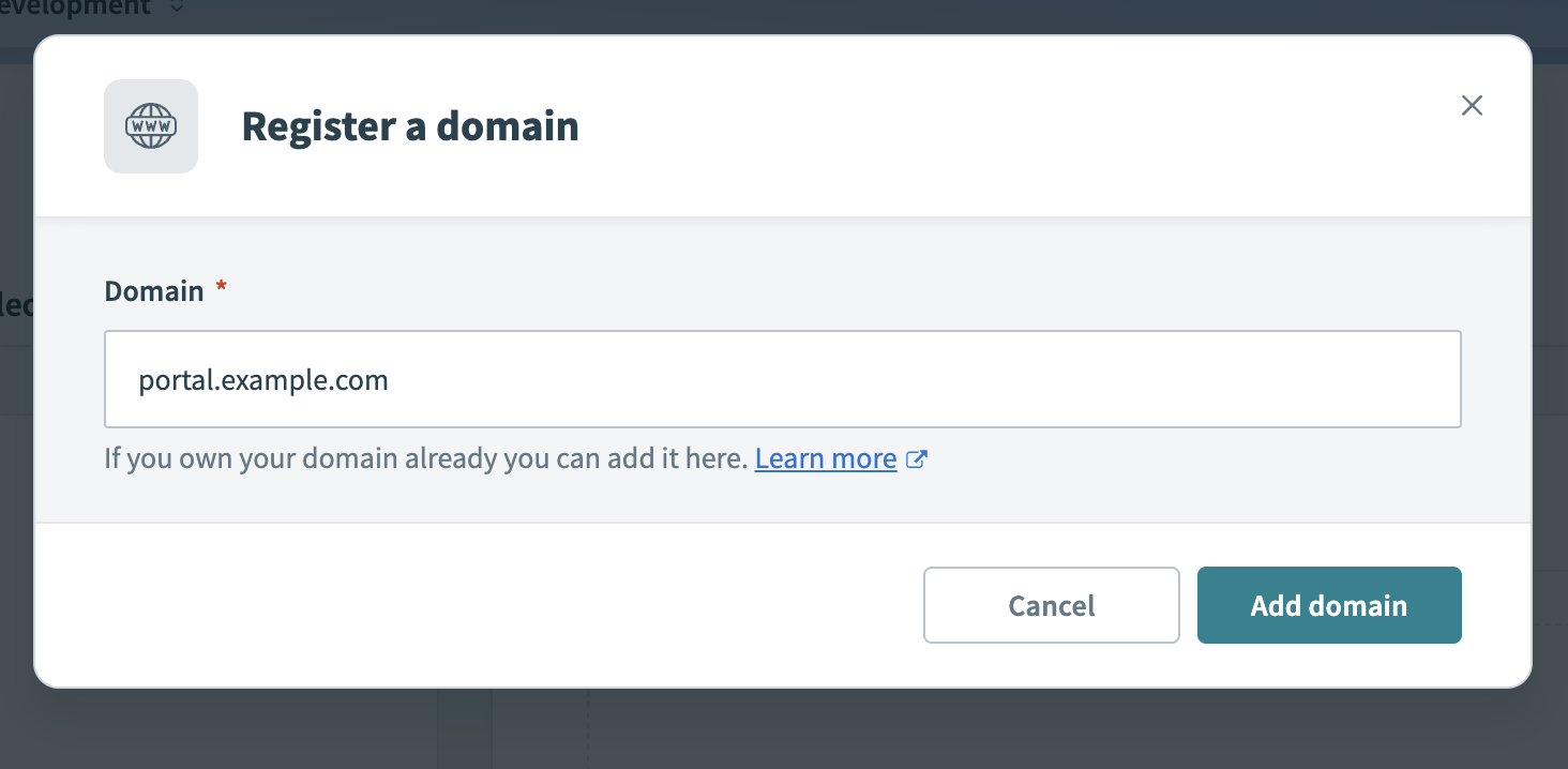

Add custom domain
Enter your full subdomain and click Add domain. For example, portal.example.com.

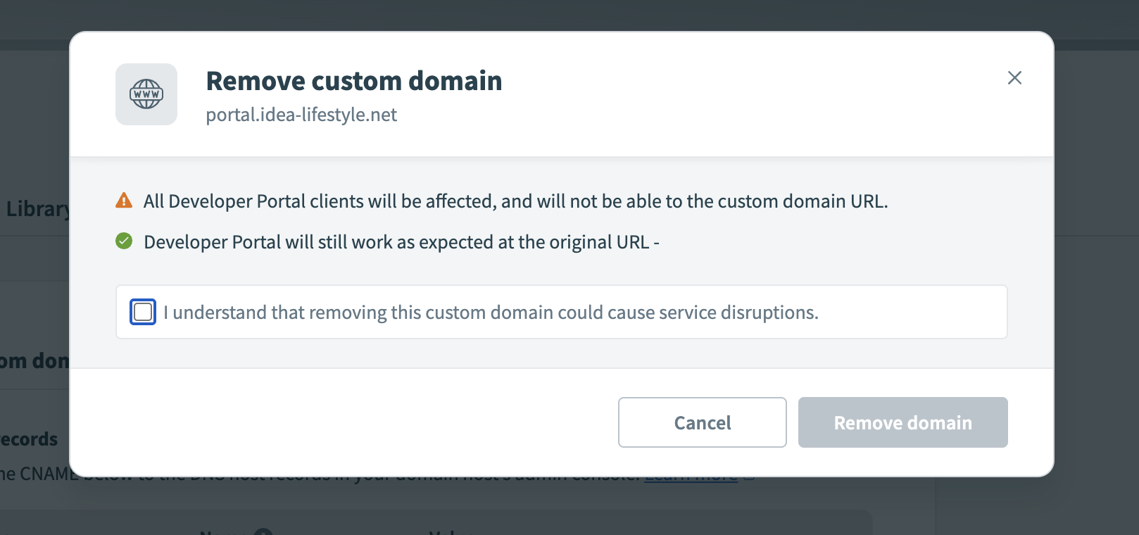

Complete the following steps to remove a custom domain:
Click Remove next to the custom domain entry.
Confirm the action in the modal dialog to revert to the default Workato domain.
