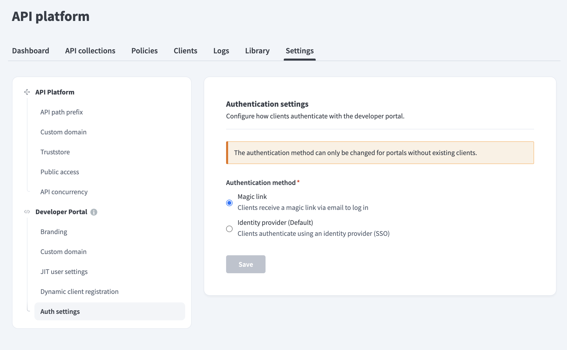

Change the authentication method
You can change a portal's authentication method only while it has no existing clients. After you add the first client, the method is locked. Remove all clients first to change the method on a portal that already has clients.
Complete the following steps to change the authentication method:
Go to Platform > API platform > Settings > Developer Portal > Auth settings.
Use the Authentication method drop-down menu to select Magic link or Identity provider (Default).
Authentication settingsAuthentication settings
Click Save.

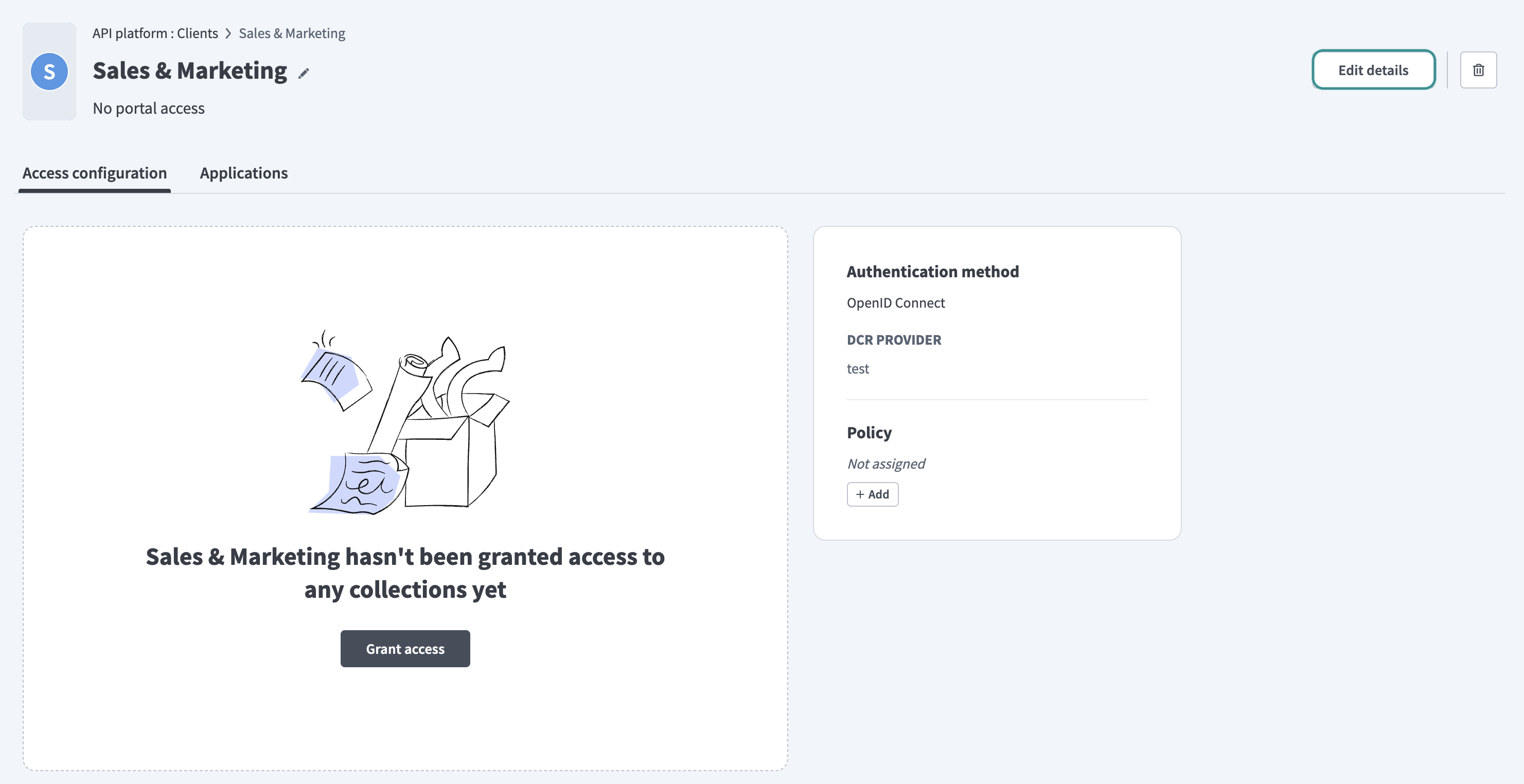

Manage client access
The Clients tab provides access to the All clients page, where you can review and update client details, access configurations, and policy assignments.
All clients pageAll clients page
To manage a specific client's access, click their name to open their details page. From here, you can configure the following settings:
Edit client details
Click Edit client to update basic client information, such as the client's name or email address, from the client details page.
Edit client detailsEdit client details
Access configuration
Use the Access configuration tab to manage your client's access to API collections and set usage policies.

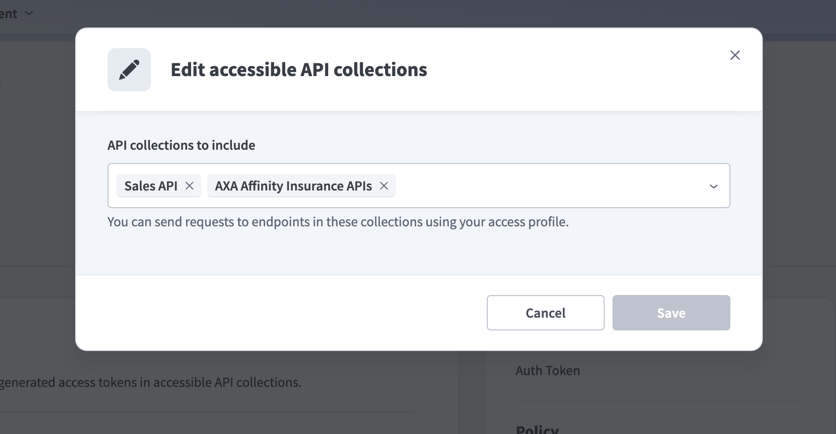

View and adjust the Accessible collections assigned to the client. Add or remove collections to tailor access based on the client's specific requirements.
Edit accessible API collectionsEdit accessible API collections
CLIENT ACCESS LIMITATION
Every client must have access to at least one API collection. You can't remove a client's last remaining accessible collection.
If you try to remove the last collection and click Save, the action fails, and Workato displays an error message explaining the limitation. Ensure the client retains access to at least one collection before saving your changes.
