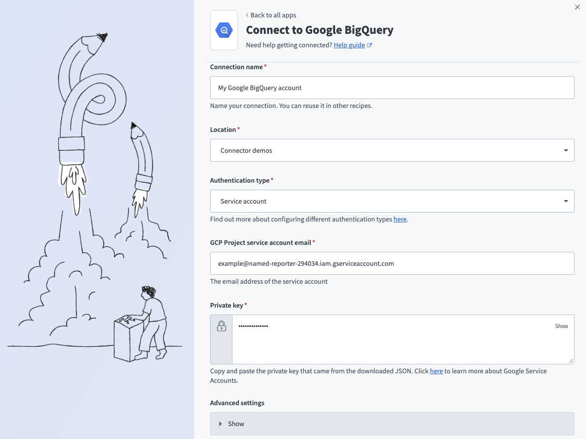

Configuring Google BigQuery connection
Complete the following steps to establish a connection to Google BigQuery in Workato:
Search for and select the Google BigQuery connector.
Enter a unique name for your connection in the Connection name field that identifies which Google BigQuery instance it is connected to.
Select the project or folder where you plan to store the connection from the Location drop-down menu.
Select OAuth 2.0 or Service account from the Authentication type drop-down menu. Choose OAuth 2.0 when using a user account to connect to Google BigQuery. Choose Service account when using a service account to connect to Google BigQuery.
Applicable to service account authentication. Enter the email address of your service account in the GCP Project service account email field.
Applicable to service account authentication. Enter the private key of your service account in the Private key field.
Applicable to service account authentication. Expand the Advanced settings section and select scopes to request your connection.
Click Sign in with Google.
Click Allow when prompted to authorize Workato to access your Google account.

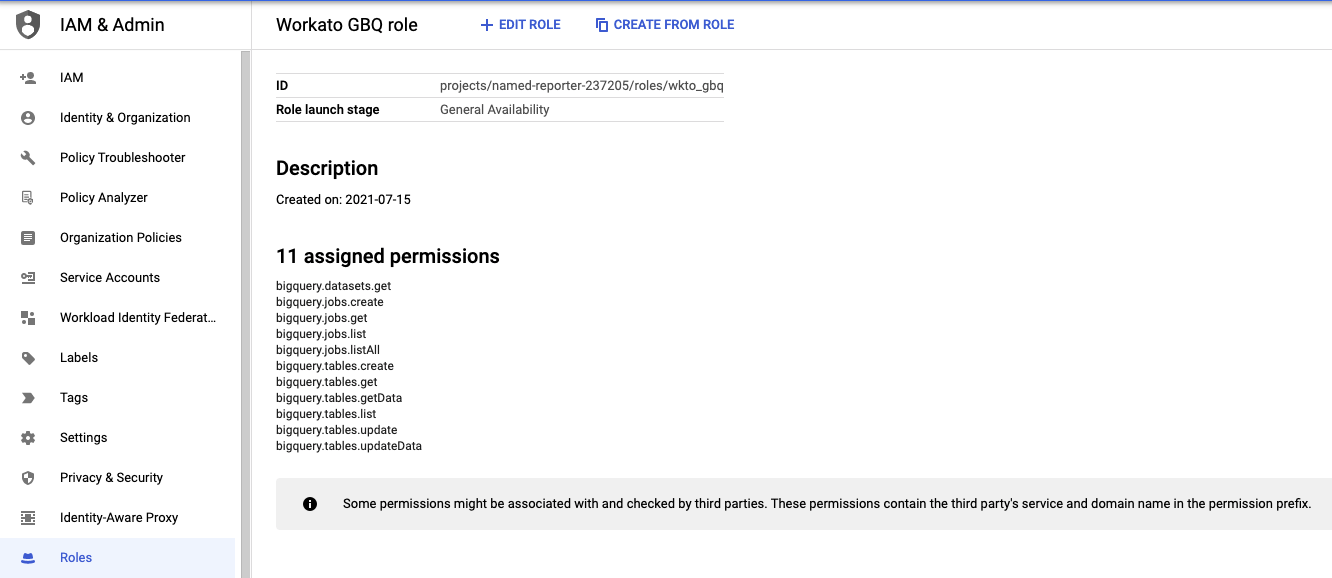

To use all triggers and actions in the Google BigQuery connector, you must give your service account the BigQuery Admin IAM role or a custom role with the following permissions:
  • bigquery.datasets.get
  • bigquery.jobs.create
  • bigquery.jobs.get
  • bigquery.jobs.list
  • bigquery.jobs.listAll
  • bigquery.tables.create
  • bigquery.tables.get
  • bigquery.tables.getData
  • bigquery.tables.list
  • bigquery.tables.update
  • bigquery.tables.updateData
TIP
If you would like to only insert data with this connection on Workato, you may:
  • Use the BigQuery Data Editor role.
  • Add the bigquery.jobs.create permission.
If you would like to only select data with this connection on Workato, you may:
  • Use the BigQuery Data Viewer role.
Google BigQuery custom role with 11 assigned permissions
Refer to Google's documentation on creating custom roles and Google BigQuery permissions for more information.

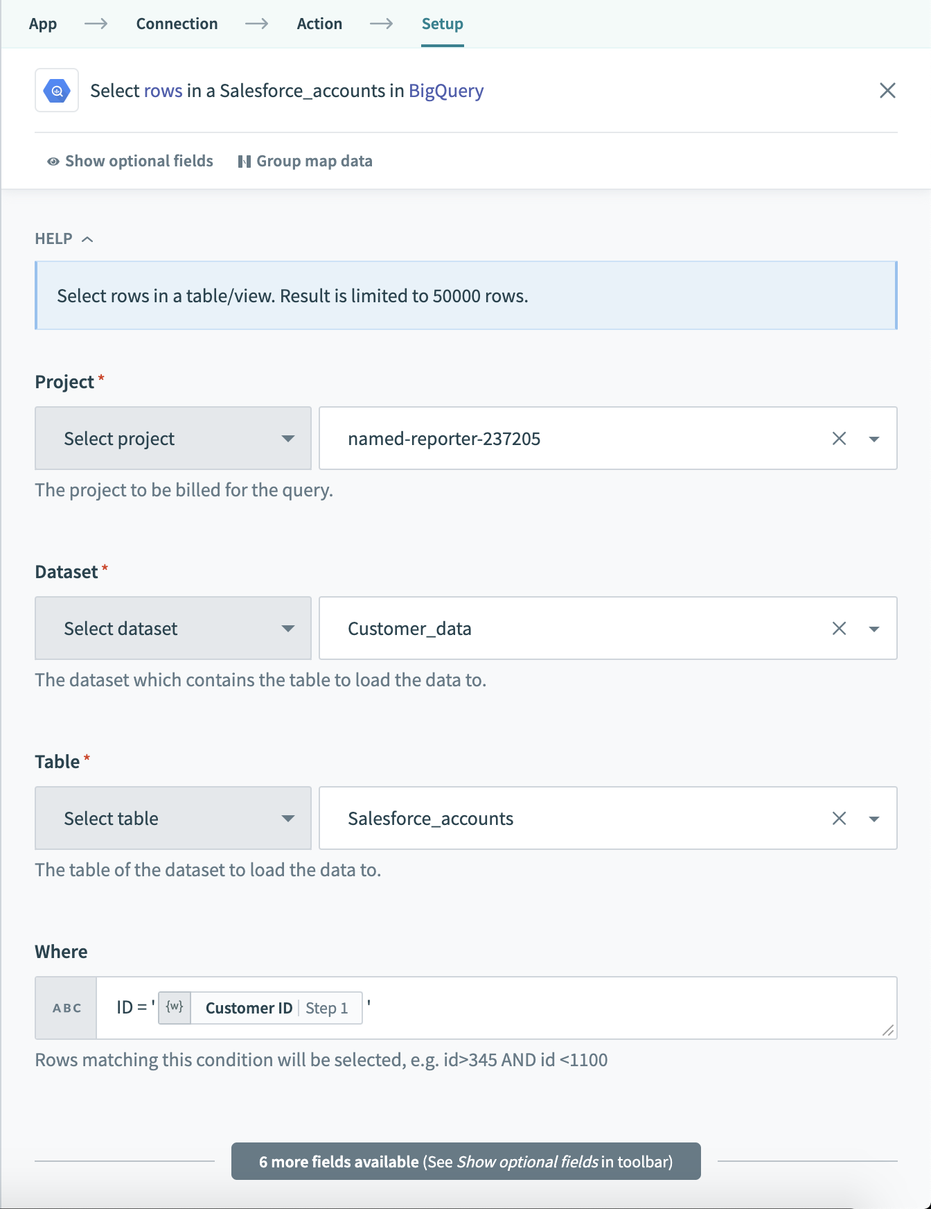

Using the Google BigQuery connector
After establishing a connection with the Google BigQuery connector, most actions require additional parameter inputs.
FieldDescription
ProjectThe project to bill for the query.
DatasetThe dataset from which the action or trigger pulls possible tables.
TableThe table inside the dataset.
LocationThe geographical location where the job should be run.

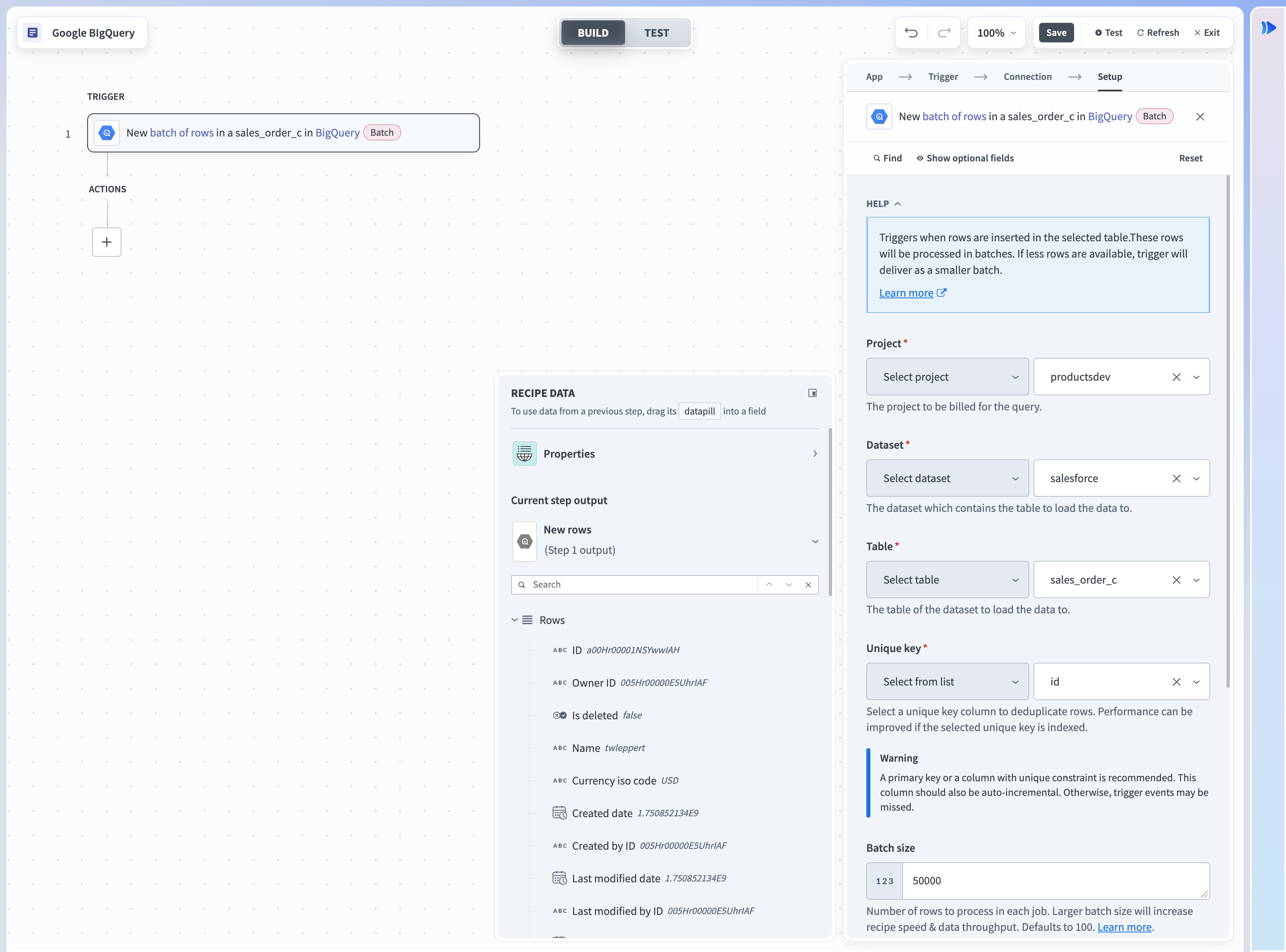

Single row versus batch of rows

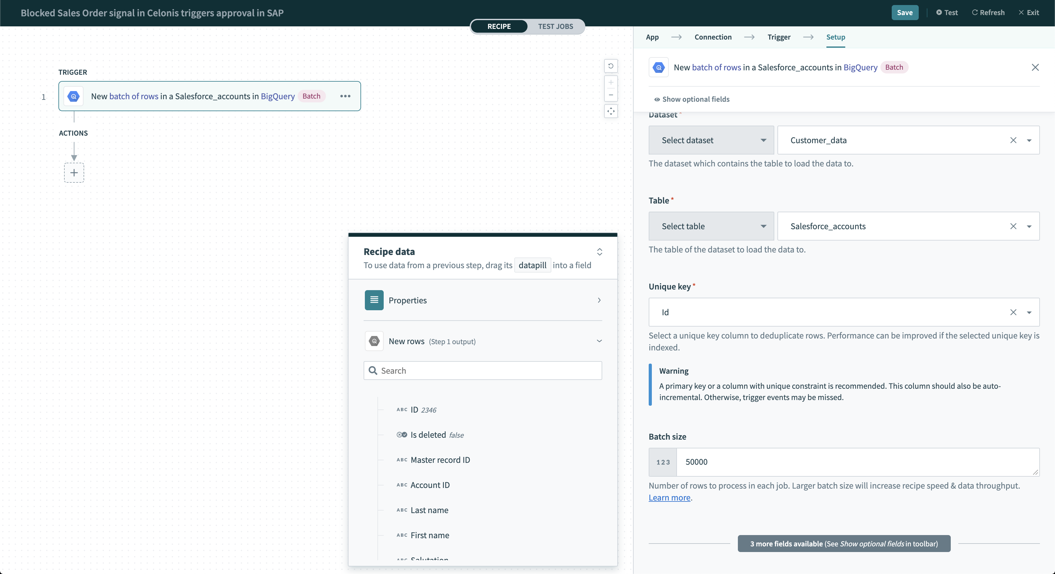

The Google BigQuery connector can read or write to your database either as a single row or in batches. When using batch read actions or triggers, you must provide the a batch size. The batch size can be any number between 1 and 50000, with a maximum batch size of 50000.
Batch trigger inputsBatch trigger inputs

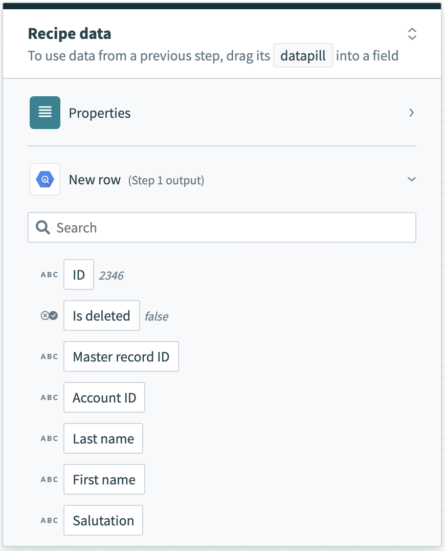

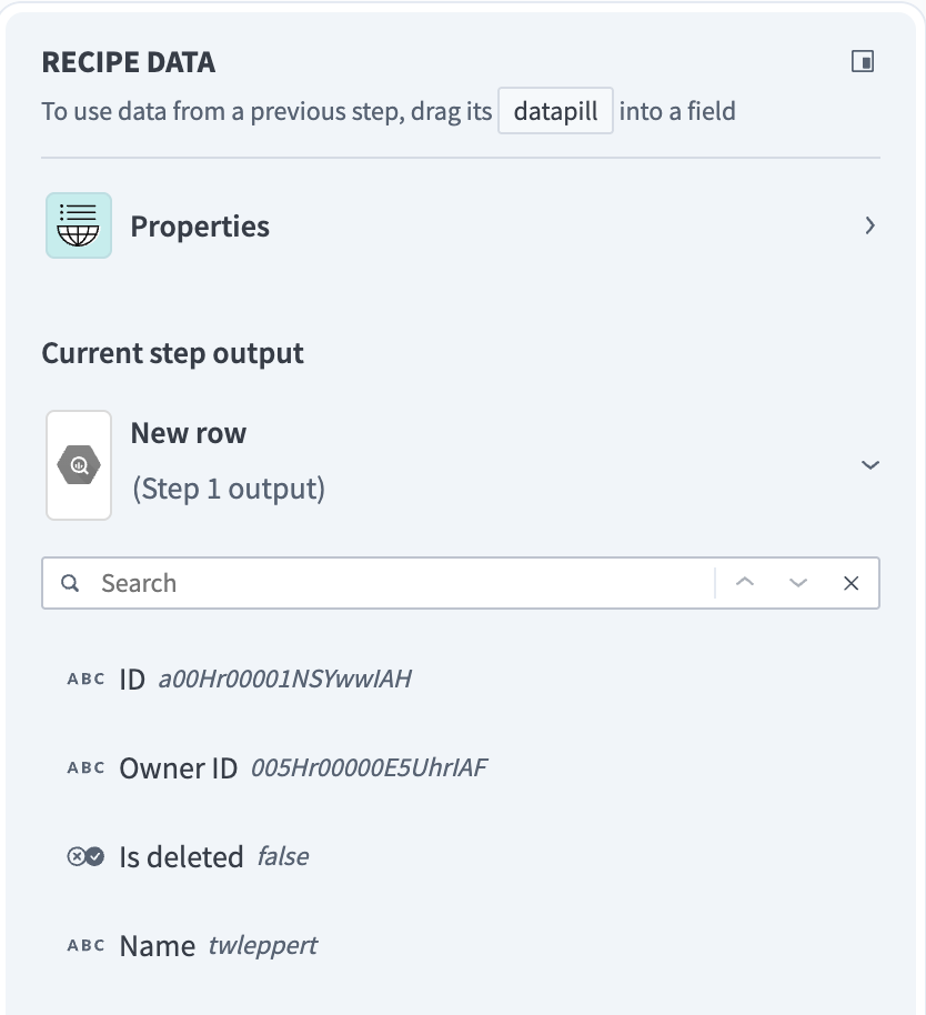

The output of single and batch triggers and actions also differ. For example, a single trigger that processes rows one at a time returns an output datatree that allows you to map data from that single row.
Single row outputSingle row output

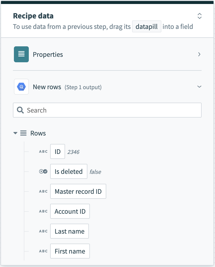

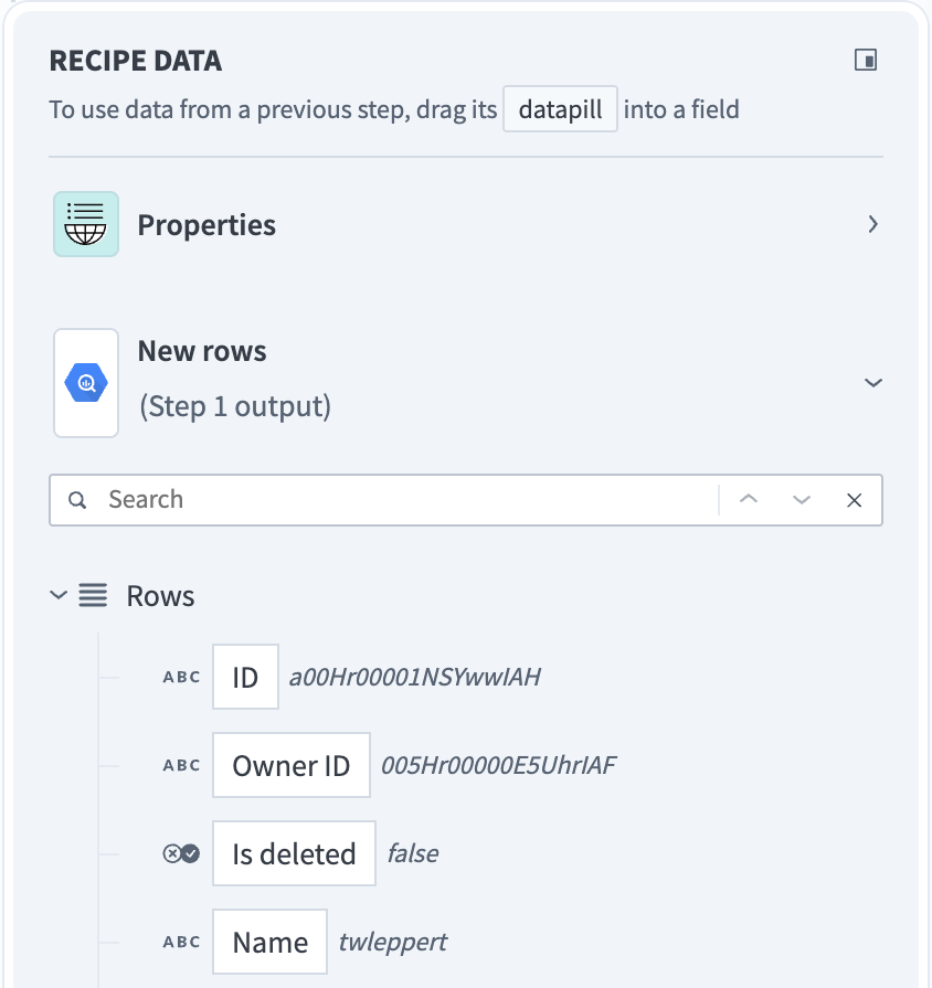

A batch trigger that processes rows in batches returns this data as an array of rows. The Rows datapill indicates that the output is a list containing data for each row in that batch.
Batch trigger outputBatch trigger output

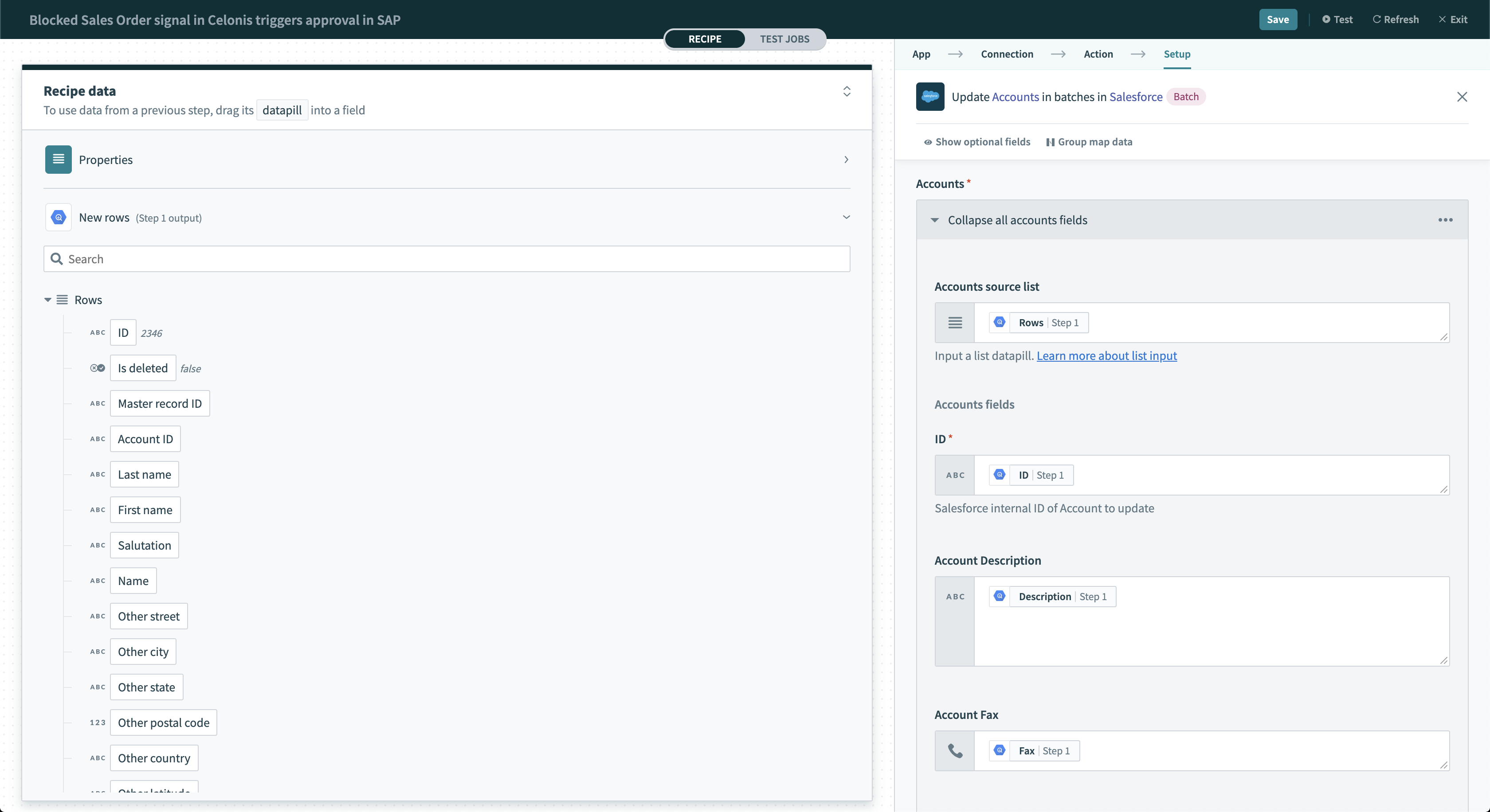

You must handle the output of batch triggers or actions differently. In cases where downstream batch actions accept Rows source list input fields, you can map the Rows datapill to process the entire array.

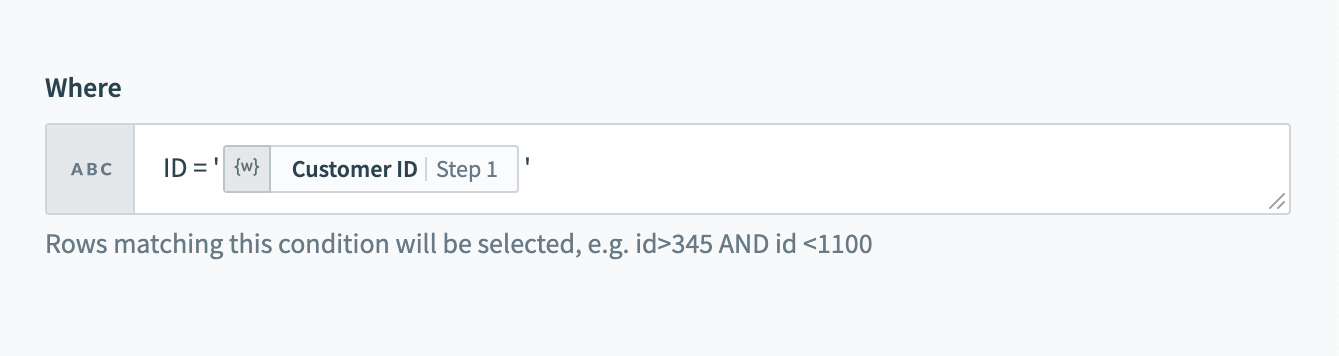

Simple statements
Knowing the column's data types in Google BigQuery is important to build working queries. When comparing string values, you must enclose values in single quotes (''), and the columns used must exist in the table. When comparing integer values, the supplied value should not be enclosed in single quotes.
A simple WHERE condition to filter rows based on values in a single column looks like this:
sql
string_column = 'USD' and integer_column = 1111
If used in a Select rows action, this WHERE condition will return all rows that have the value 'USD' in the currency column. Just remember to wrap datapills with single quotes in your inputs.
Using datapills in WHERE conditionUsing datapills in WHERE condition

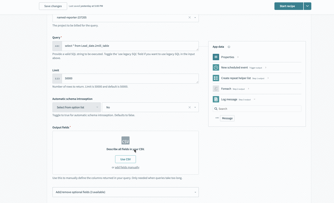

Defining your output fields
Some Google BigQuery actions and triggers allow you to define the expected output columns of a query. This input field is available in the following triggers and actions:
  • Scheduled query trigger
  • Get query job output
  • Select rows using custom SQL

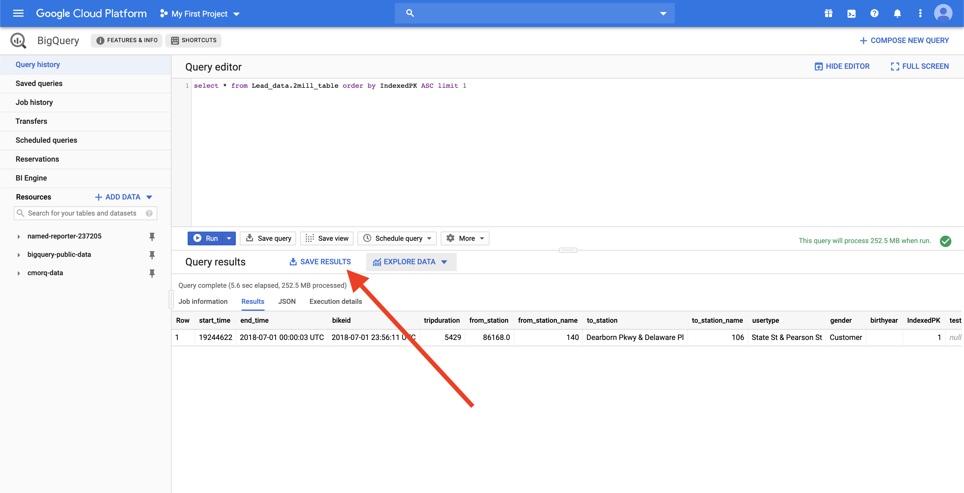

Define your output fields in the output schema designer using our CSV uploader. In these cases, run a sample query in the Google BigQuery console and export a CSV.
Upload this CSV into the schema wizard, and Workato automatically generates all fields.
