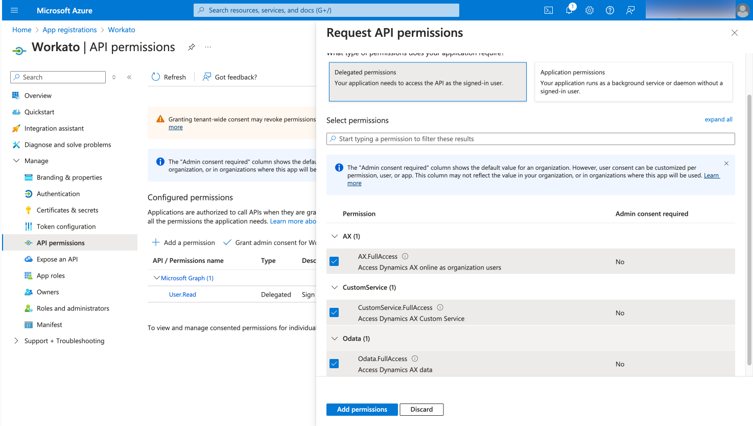

In the navigation sidebar, select Manage > API permissions.
Click + Add a permission and select Dynamics ERP API.
Dynamic ERP
Select Delegated permissions, then check the permissions required. At minimum, the following permission is required to connect:
AX.FullAccess
Add additional permissions as required, according to your use case.
AX-full-access
Click Add permissions.

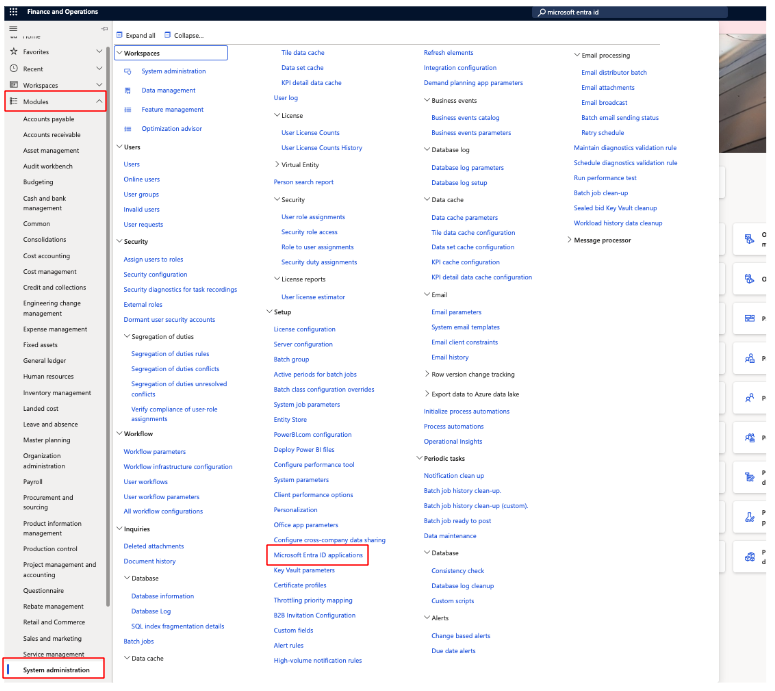

Set up the application registered in Azure

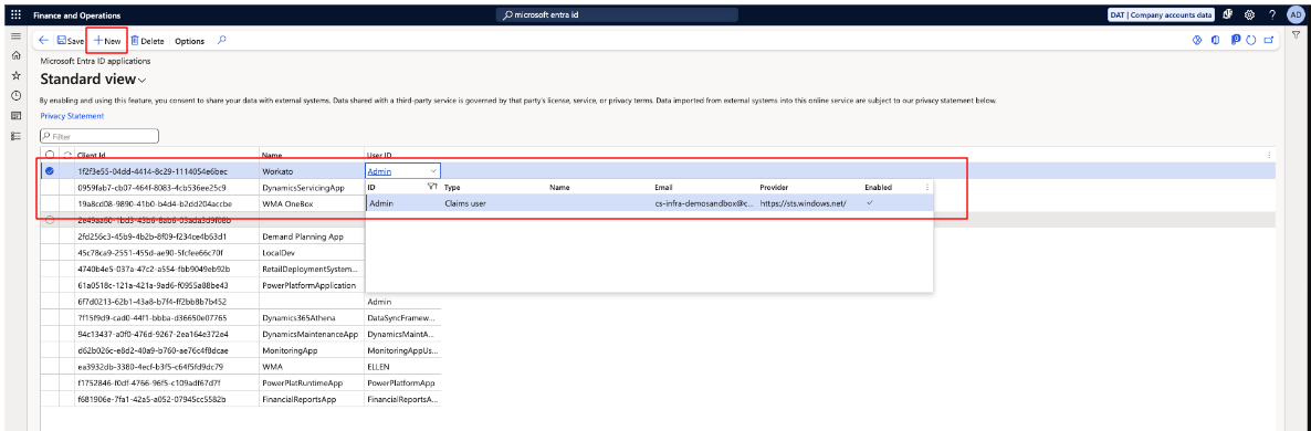

Click Modules and navigate to System administration > setup. Select Microsoft Entra ID applications.
Select New and paste the Client ID, which you can copy from the application registration in Azure.
Assign a Name, and add the User ID. This user should have the necessary roles and privileges for the entities that you need to access.
Click Save.

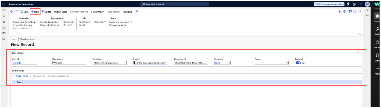

Create a new user and assign roles and privileges for entities

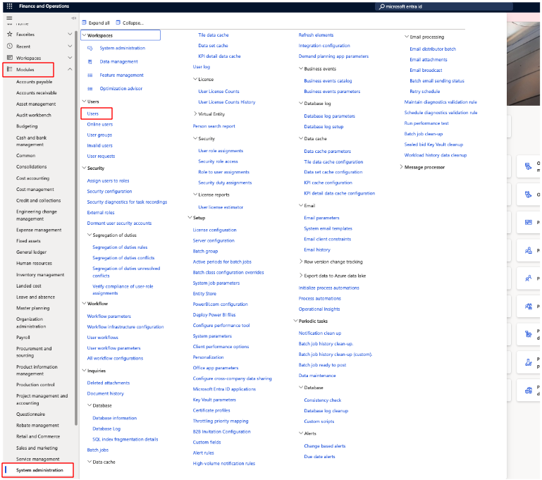

Click Modules and go to System administration. Select Users and click New.
Users
Add the details, including the roles you plan to assign and click Save.

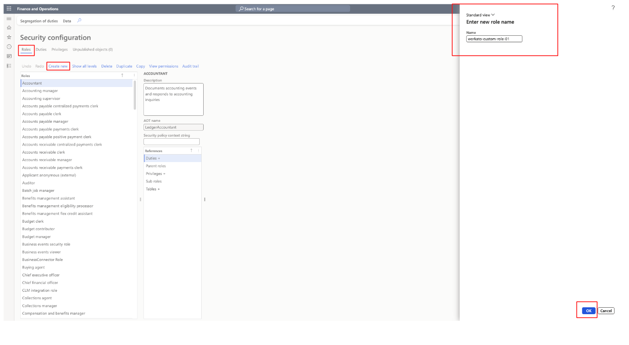

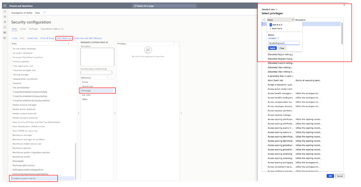

Complete the following steps to create a new role and assign it privileges. This is useful in situations where you don't plan to use prebuilt roles like Admin.
Click Modules from the left side. Go to Security configuration and click the Roles.
Click Create new and enter the new role name. Click OK.
New role name
Select the new role from the Roles list.

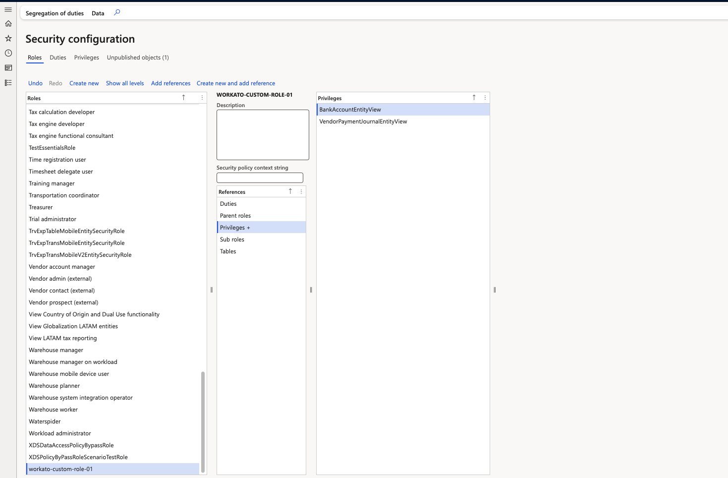

Click Privileges and select Add references. Search for the particular privileges and select the privilege.
Click OK.
Select privileges
Similarly, you can add whichever privileges you need by clicking on Add references.
Add references

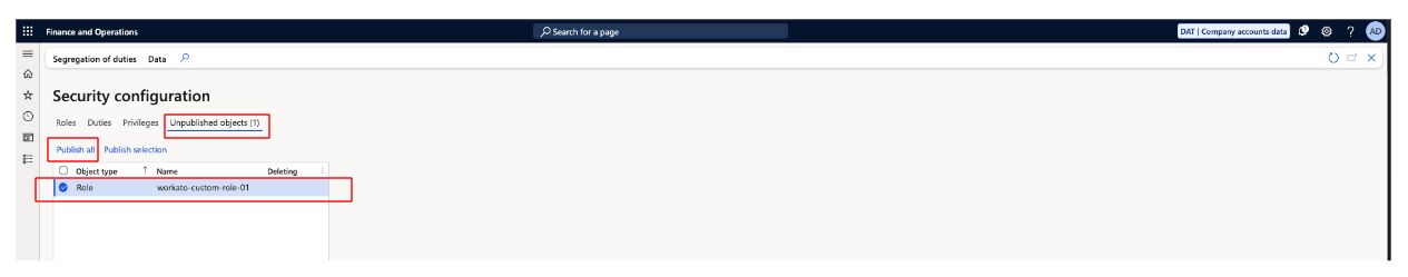

After adding the privileges, you must publish the privileges.
Click Unpublished objects and select the Role from the Object type list and click Publish all.
Publish objects

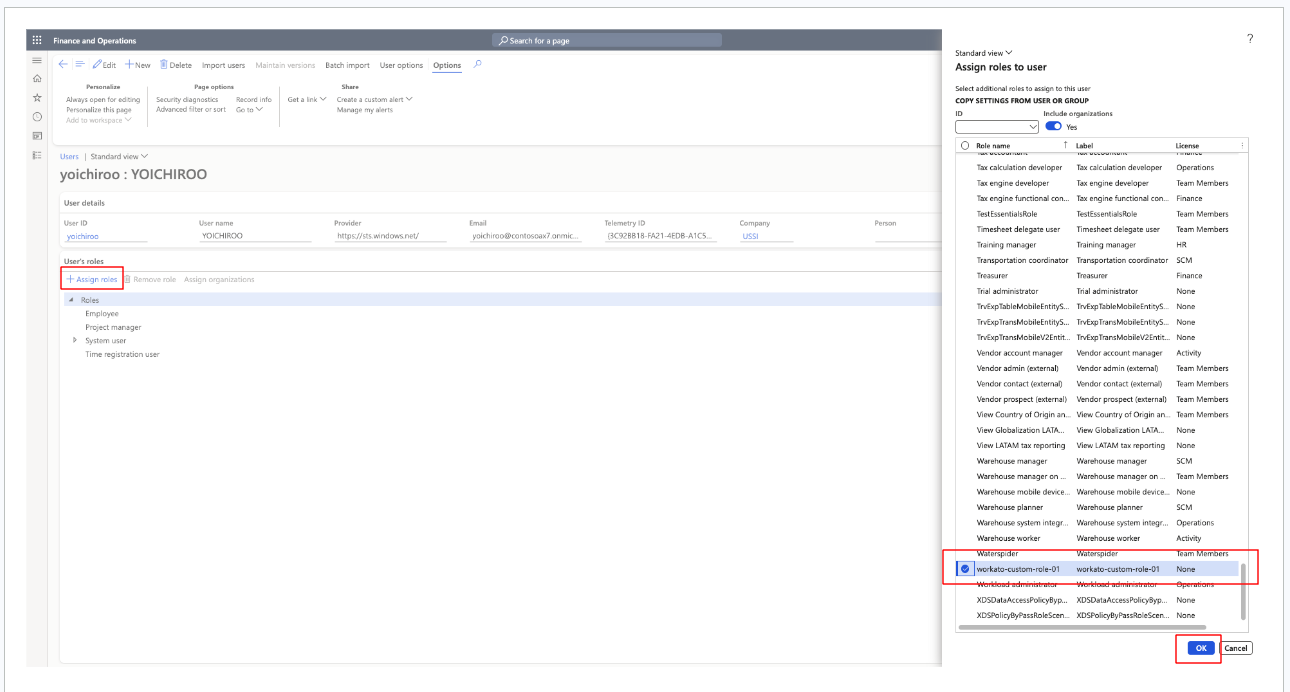

Add the role to your newly-created user
Go to Modules and select System administration.
Select Users then select the specific user from the User list.
Click on Assign roles and select one or more roles you plan to assign to the user from the Roles list and then click OK.
Role assignment

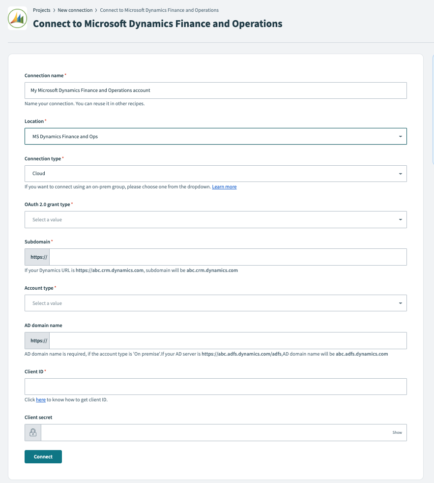

Search for and select Microsoft Dynamics Finance and Operations as your connection in the New connection page.
Select the Connection type you plan to use. Select Cloud for direct connections, or an on-prem group from the drop-down.
In the OAuth 2.0 grant type field select Authorization code as the connection type.
Provide your AD domain name. Your subdomain is provided by your MDSFO application administrator. If your Dynamics URL is https://abc.crm.dynamics.com/adfs, the subdomain is abc.crm.dynamics.com. This step is mandatory for on-prem connections and optional for cloud connections.
Supply the Client ID and Client secretfor your app. Refer to the Register an app in Azure section to learn more.
