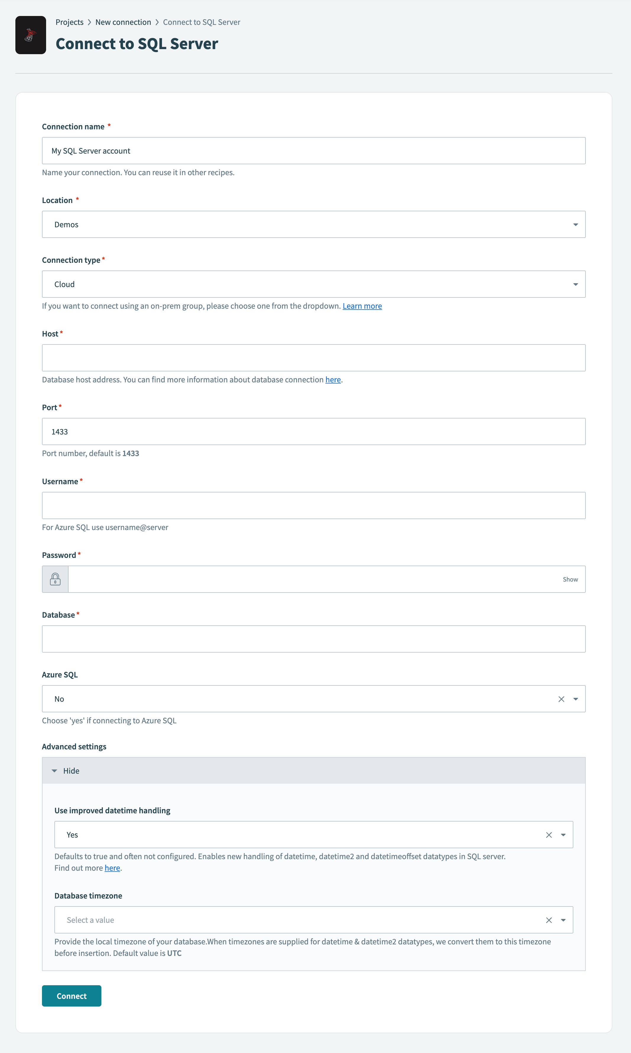

Cloud
Complete the following steps to connect to SQL Server using a cloud connection:
Search for and select SQL Server as your connection on the New connection page.
Provide a Connection name that identifies which SQL Server instance Workato is connected to.
Connect to SQL Server using a cloud connectionConnect to SQL Server using a cloud connection
Use the Location drop-down menu to select the project or folder where you plan to store this connection.
Use the Connection type drop-down menu to select Cloud.
Enter the URL of your hosted server in the Host field.
Enter the port number your server runs on in the Port field. The default port for SQL Server is 1433.
Enter the username to connect to SQL Server in the Username field.
Enter the password to connect to SQL Server in the Password field.
Enter the name of the SQL Server database you plan to connect to in the Database field.
Optional. Specify whether you're connecting to an Azure SQL instance in the Azure SQL field. The default is No.
12
Optional. Expand the Advanced settings field to configure additional settings:
FieldDescription
Use improved datetime handlingEnable enhanced handling of datetime, datetime2, and datetimeoffset datatypes in SQL Server. Defaults to true. Refer to the Improved datetime handling section for more information.
Database timezoneSet your database's local timezone. When timezones are provided for datetime and datetime2 datatypes, values convert to this timezone before insertion. Default is UTC.

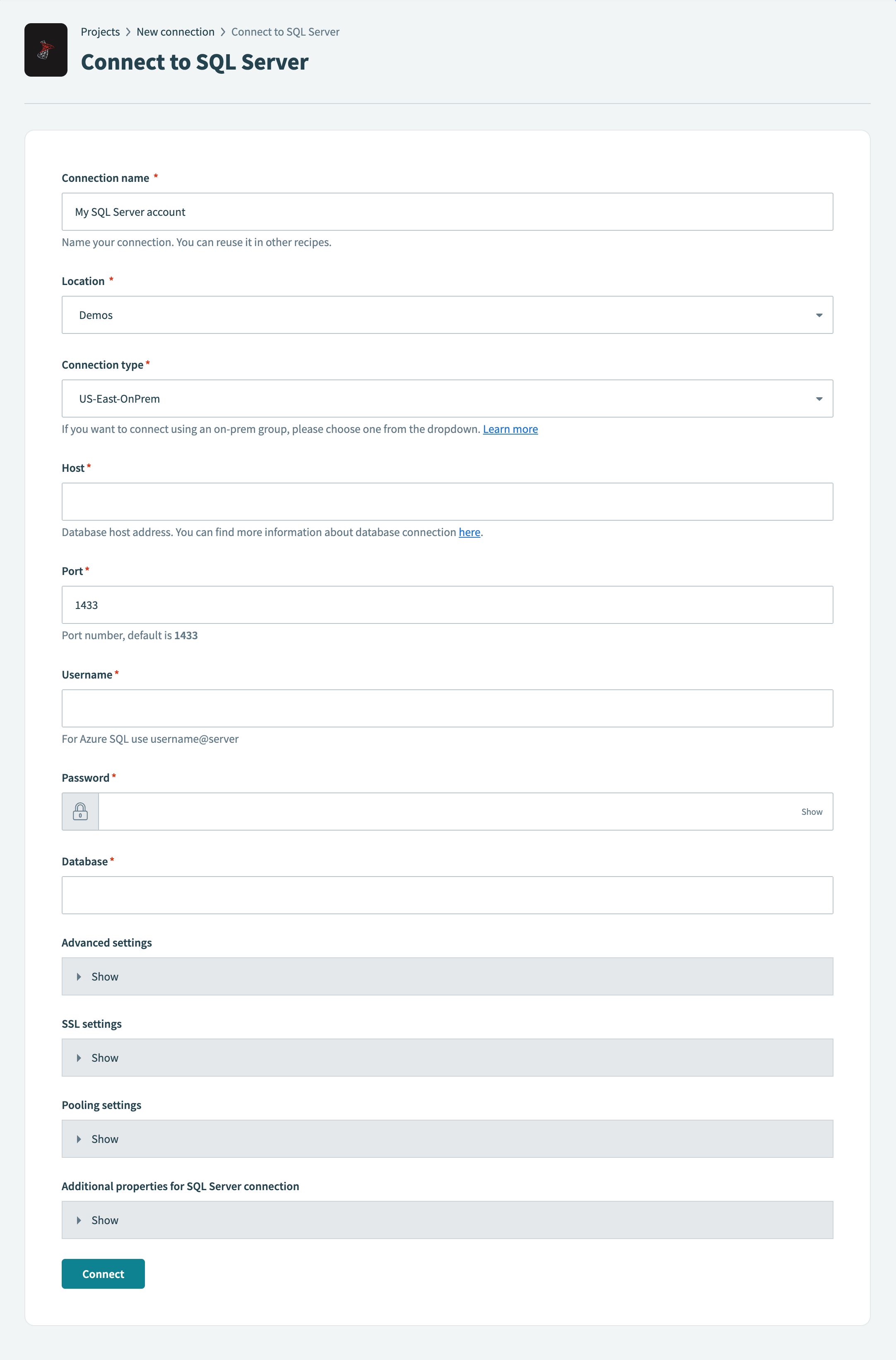

On-prem
Complete the following steps to connect to SQL Server using an on-prem connection:
Connect to SQL Server using an on-prem connectionConnect to SQL Server using an on-prem connection
Use the Connection type drop-down menu to select your on-prem group.
Optional. Expand the Advanced settings section to configure additional settings:
FieldDescription
12
Optional. Expand the SSL settings section to configure the following fields:
FieldDescription
Server certificateProvide the X509 server certificate in .pem format.
SSL certificateProvide the X509 client certificate in .pem format.
SSL certificate keyProvide the RSA client key in .pem format.
Trust allSpecify whether the client should trust any certificate chain. Self-signed server certificates are supported.
13
Optional. Expand the Pooling settings section to set connection pool behavior:
FieldDescription
Minimum pool sizeSet the minimum connections OPA maintains in the pool, including idle and active connections. Default is 1.
Maximum pool sizeSet the maximum pool size. When full with no idle connections available, new connection requests block until timeout. Default is 10.
Idle timeoutSet how long (in seconds) connections can remain idle before removal. Use 0 to never remove idle connections. Default is 30 minutes.
Maximum lifetimeSet the maximum connection lifespan (in seconds). Connections are removed when they reach this age, even if recently used. Default is 30 minutes.
TimeoutSet how long (in seconds) clients wait for pool connections. Use 0 for no timeout. Default is 30 seconds.
14
Optional. Expand the Additional properties for SQL Server connection section to add custom connection parameters, such as required properties for Windows Authentication or Managed Identity.
15

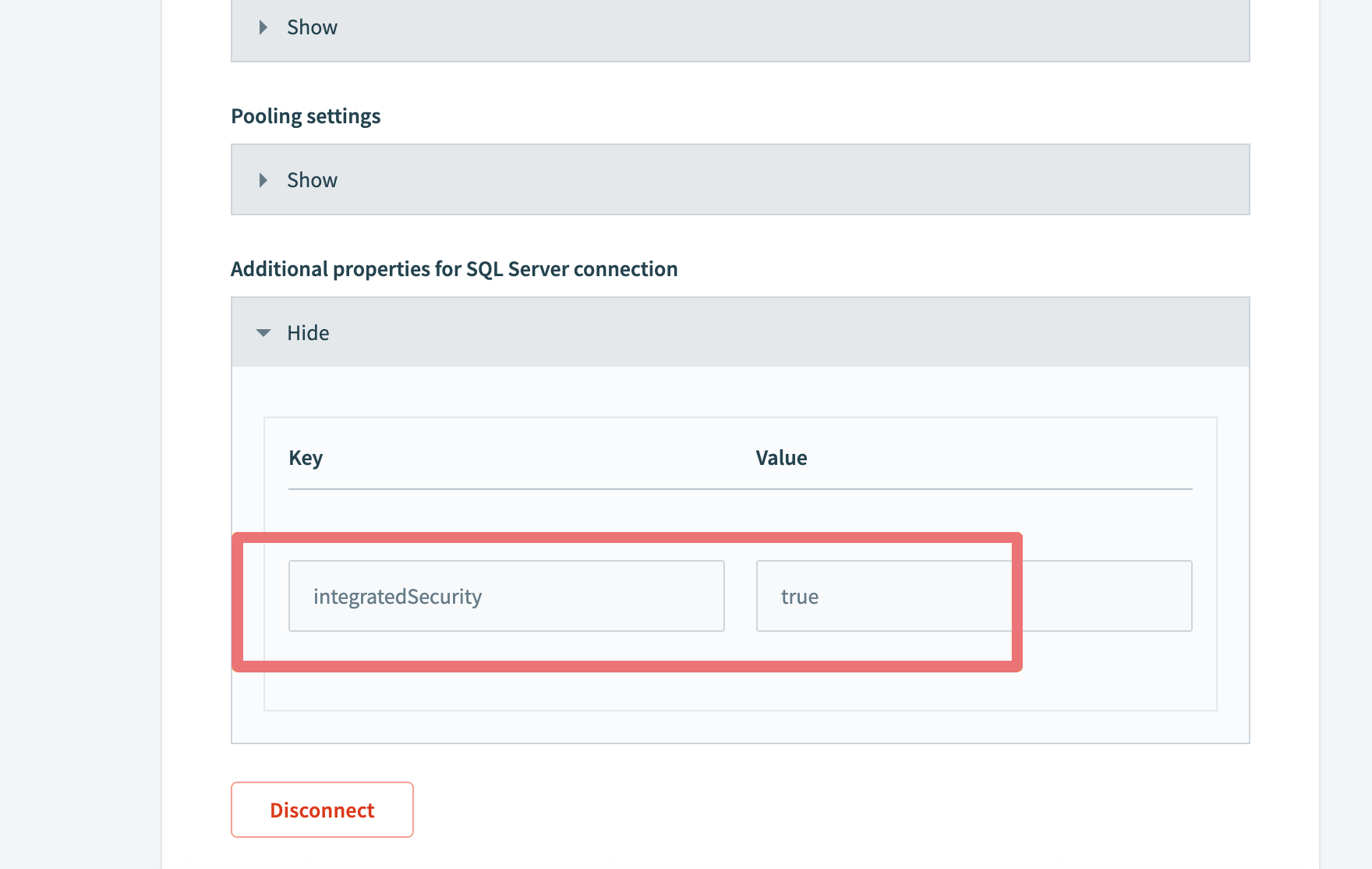

Follow the on-prem connection setup, then expand the Additional properties for SQL Server connection section and add integratedSecurity: true. The Username and Password fields can be left blank.
Set integratedSecurity to true for Windows authentication connectionsSet integratedSecurity to true for Windows authentication connections

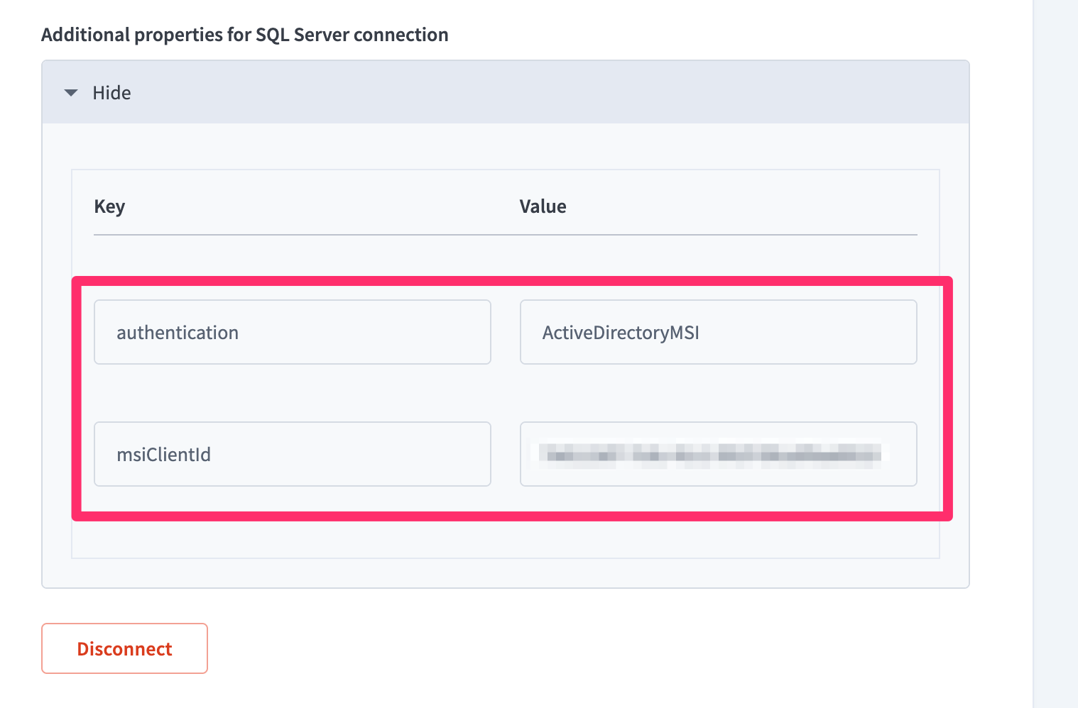

Managed Identity
Follow the on-prem connection setup, then expand the Additional properties for SQL Server connection section and add the following:
KeyValue
authenticationActiveDirectoryMSI
msiClientIdEnter the client ID of the Managed Identity in Azure that has been granted access to SQL Server.
Add Managed Identity properties to the connectionAdd Managed Identity properties in the Additional properties section

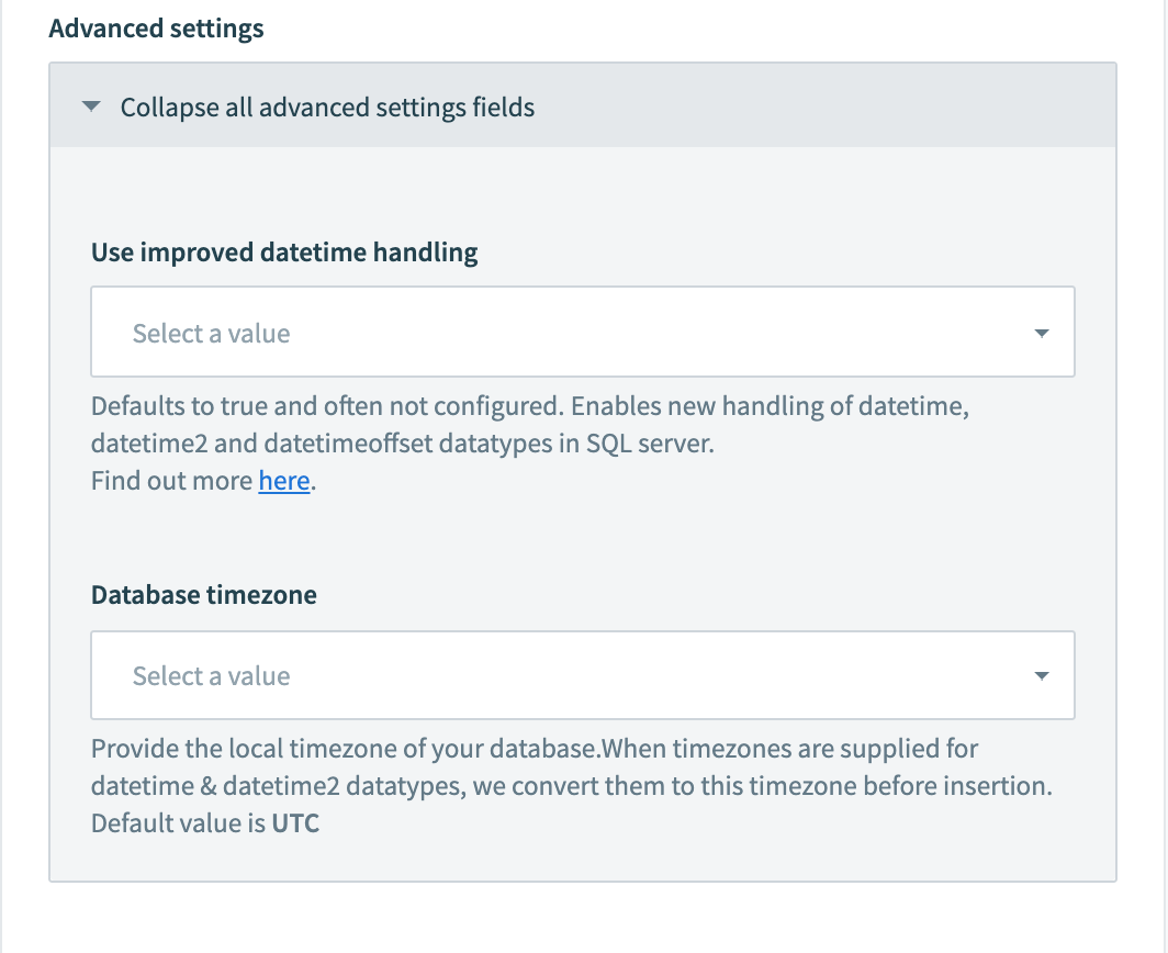

The SQL Server connector now has the option to utilize improved handling of datetime, datetime2, and datetimeoffset datatype. This can be enabled in the connection settings of each SQL server connection. This defaults to Yes for all new connections and defaults to UTC timezones. Change this to the local timezone of your database if needed. This affects all actions that insert rows into SQL server.
Advanced connection settingConfigure this in the setting of your SQL server connection
Summary of behavior
DatatypeWorkato inputImproved datetime handling set to false/unselectedImproved datetime handling set to true
datetime/datetime2Time with no timezoneWorkato workspace timezone assumed. Converted to UTC before insertion.No TZ assumed. Inserted as is.
datetime/datetime2Time with timezoneConverted to UTC before insertion.Converted to database timezone in connection setting timezone before insertion.
datetimeoffsetTime with no timezoneWorkato workspace timezone assumed. Converted to UTC before insertion with +00:00 tzInserted with +00:00 timezone assumed.
datetimeoffsetTime with timezoneConverted to UTC before insertion with +00:00 timezone.Insert with given timezone .
Note
When using the calendar datepicker for datetime/datetime2/datetimeoffset fields, times are defined using your Workato workspace timezone.

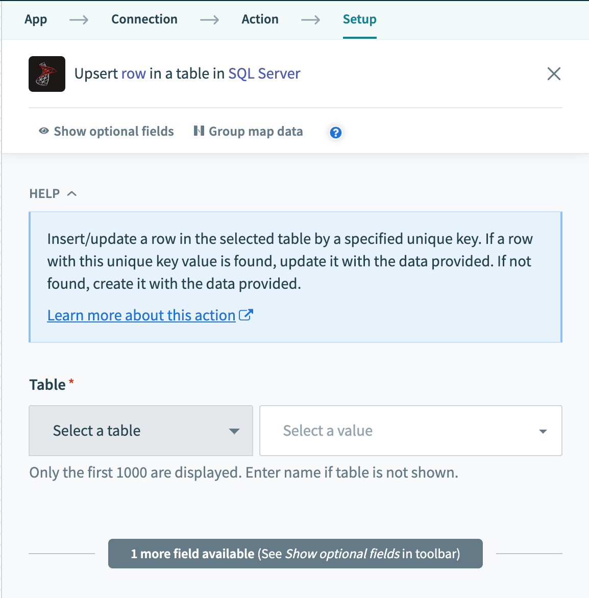

After successfully connecting to your SQL Server and selecting an action/trigger in your recipe, you will often be prompted to select either a table, view, or stored procedure. This tells Workato which tables you want to pull or send data to.
Tables & Views
The SQL Server connector works with all tables and views. These are available in pick lists in each trigger/action or you can provide the exact name. Views can be called using this as well and be used in the same way as a table.
Table selection from pick listSelect a table/view from pick list
Exact table name providedProvide exact table/view name in a text field
Case sensitivity of the name of a table/view depends on your database implementation. A default SQL Server is case insensitive. Databases or database objects with CS in the COLLATION indicates that it is case sensitive.

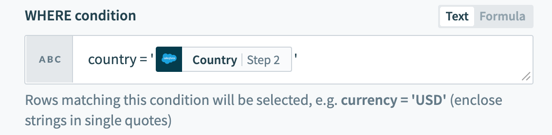

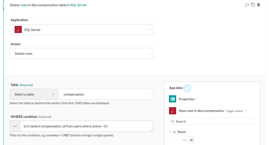

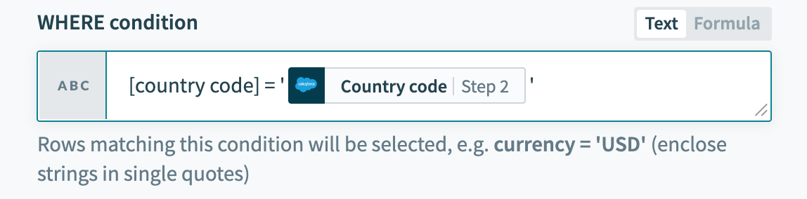

Using WHERE conditions
This input field is used to filter and identify rows to perform an action on. It is used in multiple triggers and actions in the following ways:
  • filter rows to be picked up in triggers
  • filter rows in Select rows action
  • filter rows to be deleted in Delete rows action
This clause will be used as a WHERE statement in each request. This should follow basic SQL syntax. Refer to this SQL Server documentation for a comprehensive list of rules for constructing WHERE statements. Below, we go through some basics needed to form your WHERE statements.
TIP
Examples below showcase how to use WHERE conditions directly with user input. For added security, use WHERE conditions with parameters to prevent SQL injection. Learn more

A simple WHERE condition to filter rows based on values in a single column looks like this.
sql
country = 'United States of America'
If used in a Select rows action, this WHERE condition will return all rows that has the value 'USD' in the currency column. Just remember to wrap datapills with single quotes in your inputs.
Using datapills in WHERE conditionUsing datapills in WHERE condition
Column names with spaces or special characters must be enclosed in double quotes ("") or square brackets ([]). For example, currency code must to enclosed in brackets to be used as an identifier.
sql
[country code] = 'USA'
WHERE condition with enclosed identifierWHERE condition with enclosed identifier

Using sub-queries in your WHERE conditions
Your WHERE condition can also contain subqueries. The following query can be used on the compensation table.
id in (select compensation_id from users where active = 0)
When used in a Delete rows action, this will delete all rows in the compensation table related to users who are no longer active (active = 0).
Using subquery in WHERE condition _Using subquery in WHERE condition_

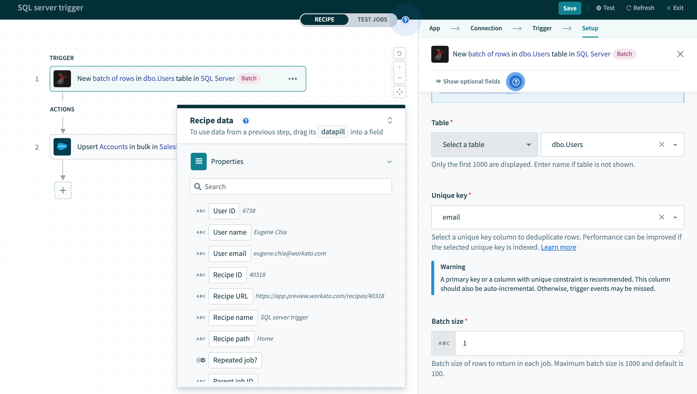

SQL Server connector can read or write to your database either as a single row or in batches. When using batch triggers/actions, you have to provide the batch size you wish to work with. The batch size can be any number between 1 and 100, with 100 being the maximum batch size. Batch triggers and actions are great for jobs when you expect to read, create, or update a large number of rows. Choosing to batch your job runs rather than having them split into separate jobs runs not only saves operations but reduces recipe runtimes and decreases load on your servers.
Batch trigger inputsBatch trigger inputs

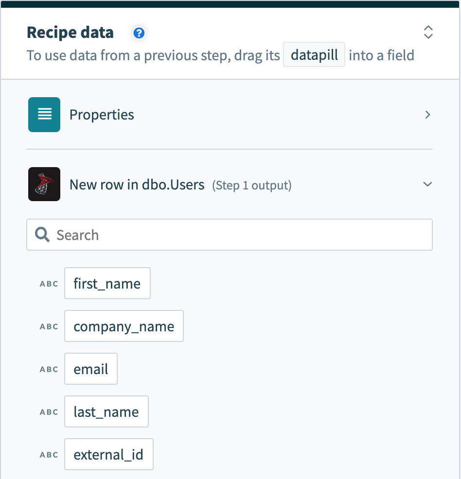

Besides the difference in input fields, there is also a difference between the outputs of these 2 types of operations. A trigger that processes rows one at a time will have an output datatree that allows you to map data from that single row.
Single row outputSingle row output

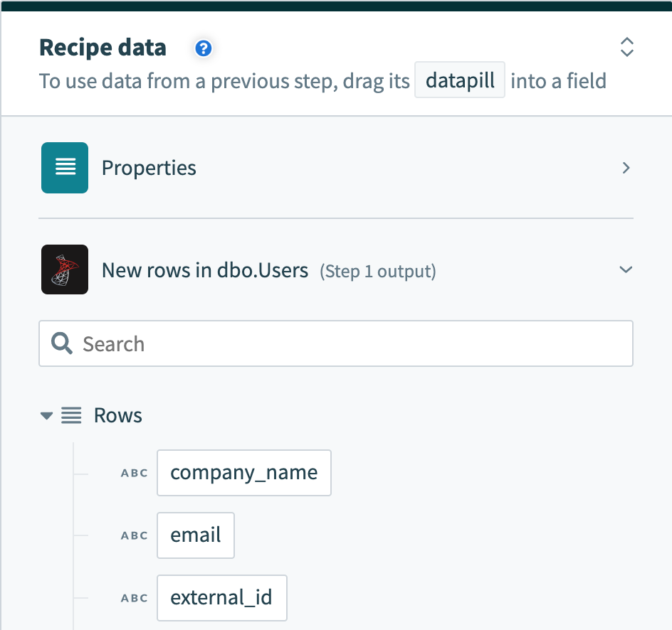

However, a trigger that processes rows in batches will output them as an array of rows. The Rows datapill indicates that the output is a list containing data for each row in that batch.
Batch trigger outputBatch trigger output

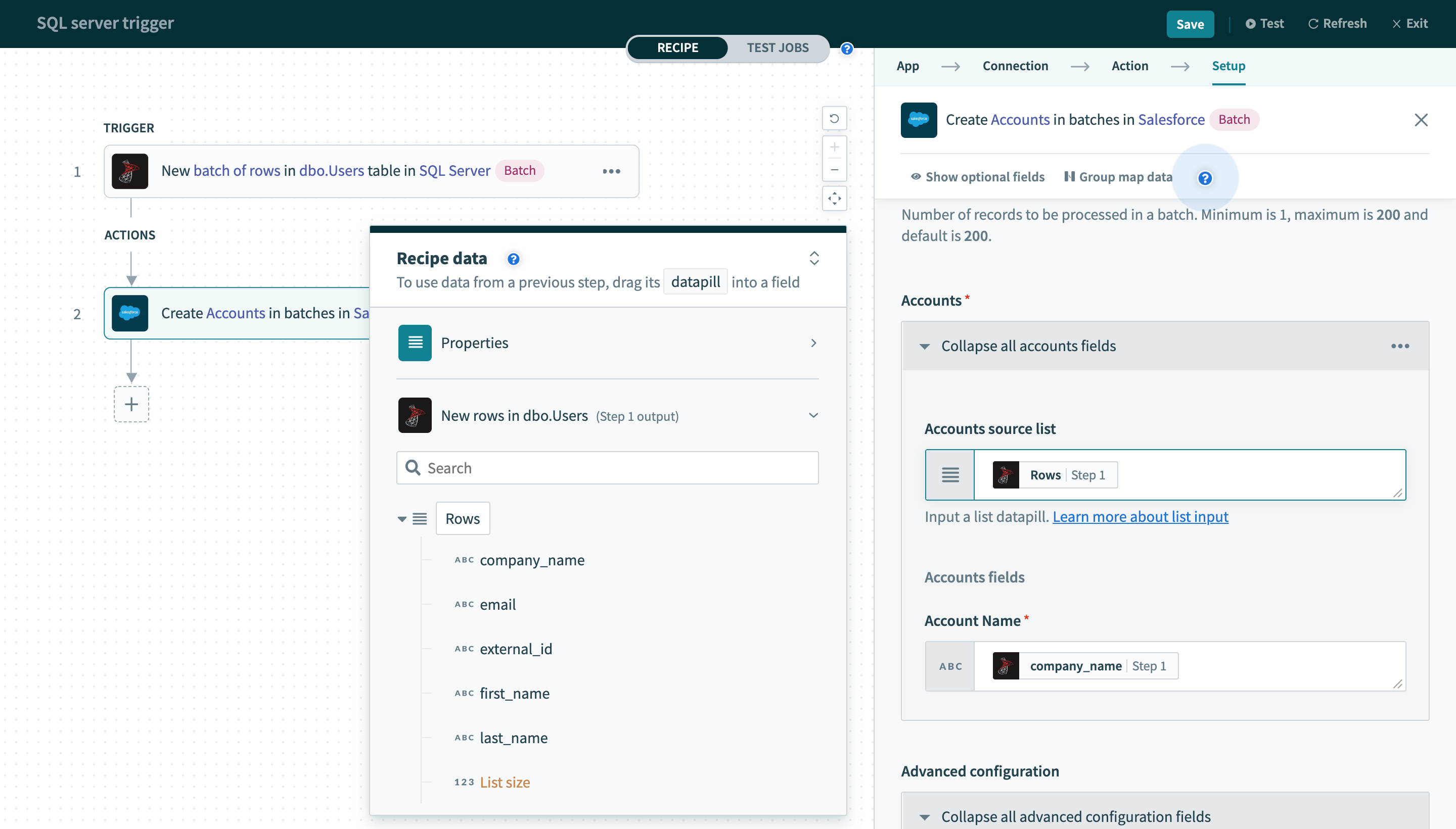

As a result, the output of batch triggers/actions needs to be handled differently. This recipe uses a batch trigger for new rows in the users table. The output of the trigger is used in a Salesforce bulk create action that requires mapping the Rows datapill into the source list.
Using batch trigger outputUsing batch trigger output
Outputs from batch triggers/actions can also be used outside of actions that work specifically with lists. By using Workato's repeat step, you'll be able to control batch outputs and use them with any action built for single rows..
