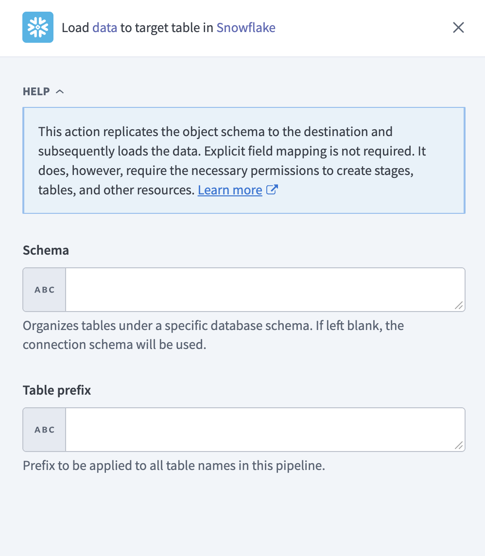

Optional. Click the Load data to target table in destination app action to configure how tables are created in Snowflake.
Enter a Schema to organize tables under a specific schema. Workato uses the default schema from your connection if left blank.
Enter a Table prefix to prepend a value to all table names. This helps prevent naming conflicts when multiple pipelines write to the same schema.
Configure Snowflake schema and table prefixConfigure Snowflake schema and table prefix
You can't change the Schema or Table prefix after the pipeline runs for the first time.
