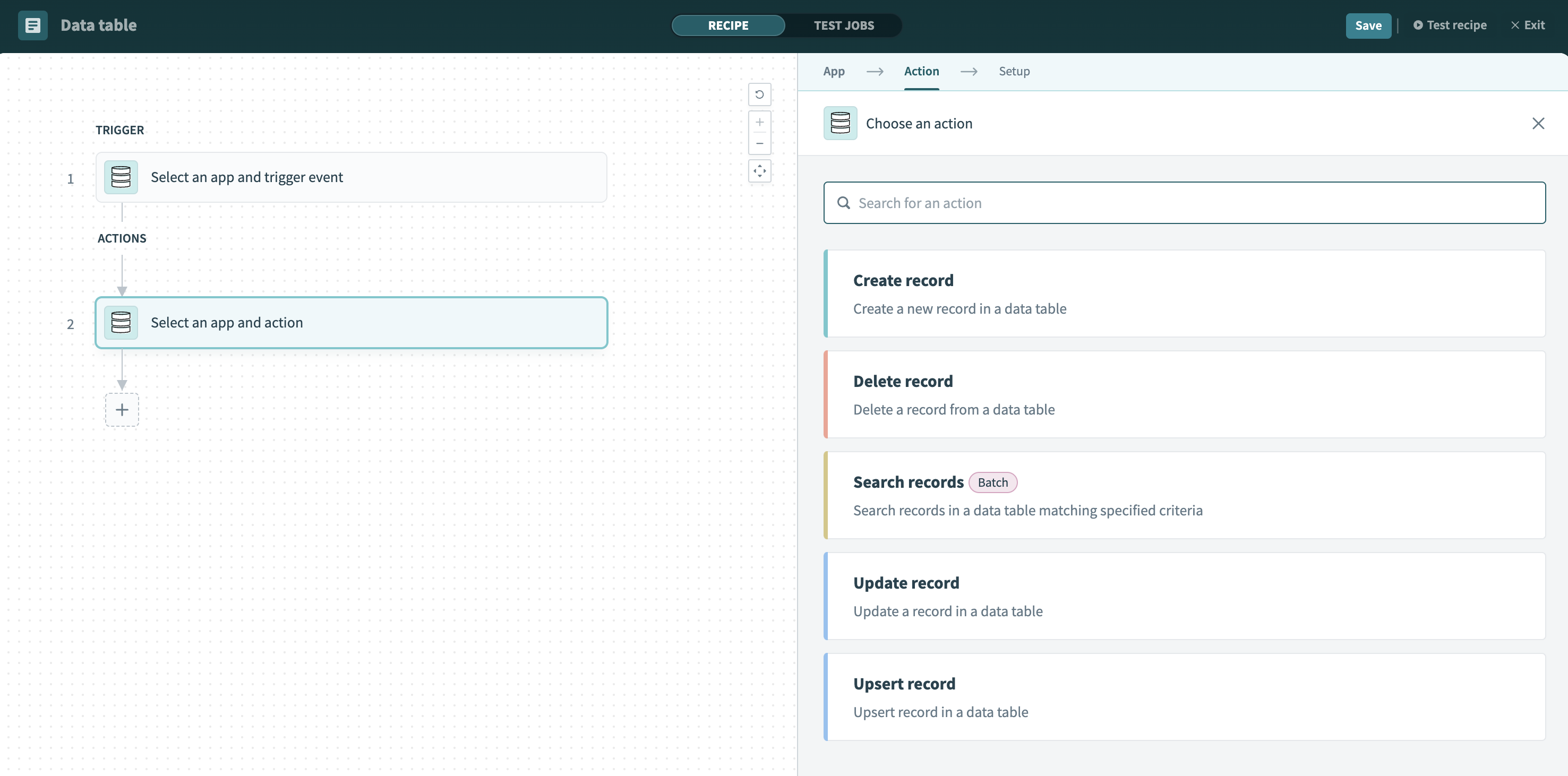

Workato’s Data table connector supports triggers and actions that enable you to use your data tables in your recipes.
Data table connector actions

Available triggers and actions include:
- New records trigger (batch)
- New record trigger (real-time)
- New/updated records trigger (batch)
- New/updated record trigger (real-time)
- Create record action
- Create records action (batch)
- Delete record action
- Delete records action (batch)
- Remove values from a record
- Search records action (batch)
- Truncate table action (batch)
- Update record action
- Update records action (batch)
- Upsert record action
- Upsert records action (batch)
