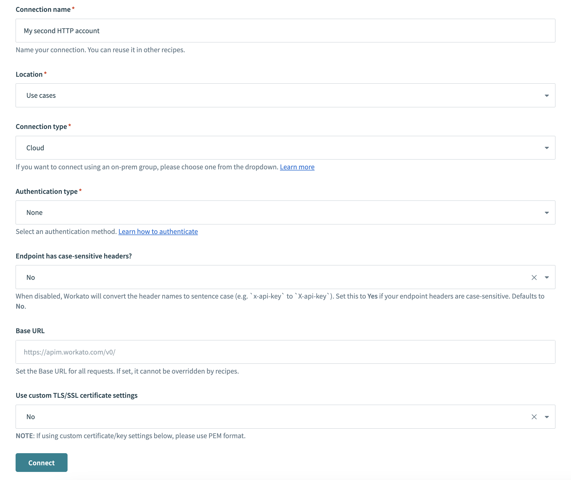

None authentication type
The None authentication type enables you to create a connection without providing authentication details. Use this authentication type when you plan to receive a webhook trigger from an app. Workato generates a URL to direct your webhooks to, and retrieves information from the webhook payload.
Complete the following steps to set up an HTTP connection with the None authentication type:
Provide a Connection name that identifies your HTTP instance.
HTTP connector authentication type: NoneHTTP connector authentication type: None
Use the Connection type drop-down menu to select the connection type you plan to use.
Use the Authentication type drop-down menu to select None.
Use the Endpoint has case-sensitive headers? drop-down to set the case sensitivity for your connection.
ASYNC MODE LIMITATION
The Endpoint has case-sensitive headers? field has no effect when the Wait for response field is set to Yes (async mode) in the HTTP action. Configure this option only when Wait for response is set to No.
Provide your base URL in the Base URL field. Recipes can't override this setting.
Use the Use custom TLS/SSL certificate settings drop-down menu to determine your certificate settings.

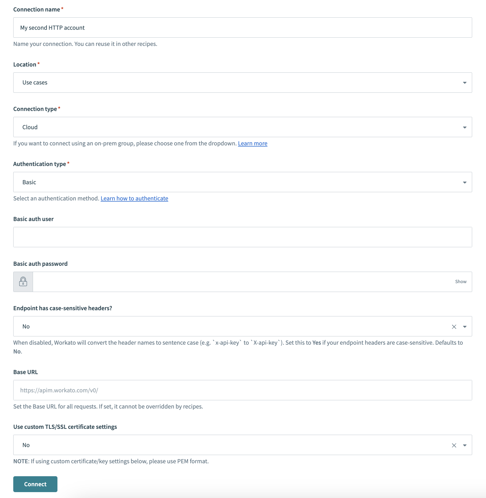

Basic authentication type
The Basic authentication type requires your username and password. As an alternative to your username and password, you can use an API key or API token retrieved from your account settings. This is a common authentication flow encoded with Base64 in transit over SSL.
HTTP connector authentication type: BasicHTTP connector authentication type: Basic
Use the Authentication type drop-down menu to select Basic.
Provide your user authentication name in the Basic auth user field.
Provide your user authentication password in the Basic auth password field.
Use the Endpoint has case-sensitive headers? drop-down menu to set the case sensitivity for your connection.

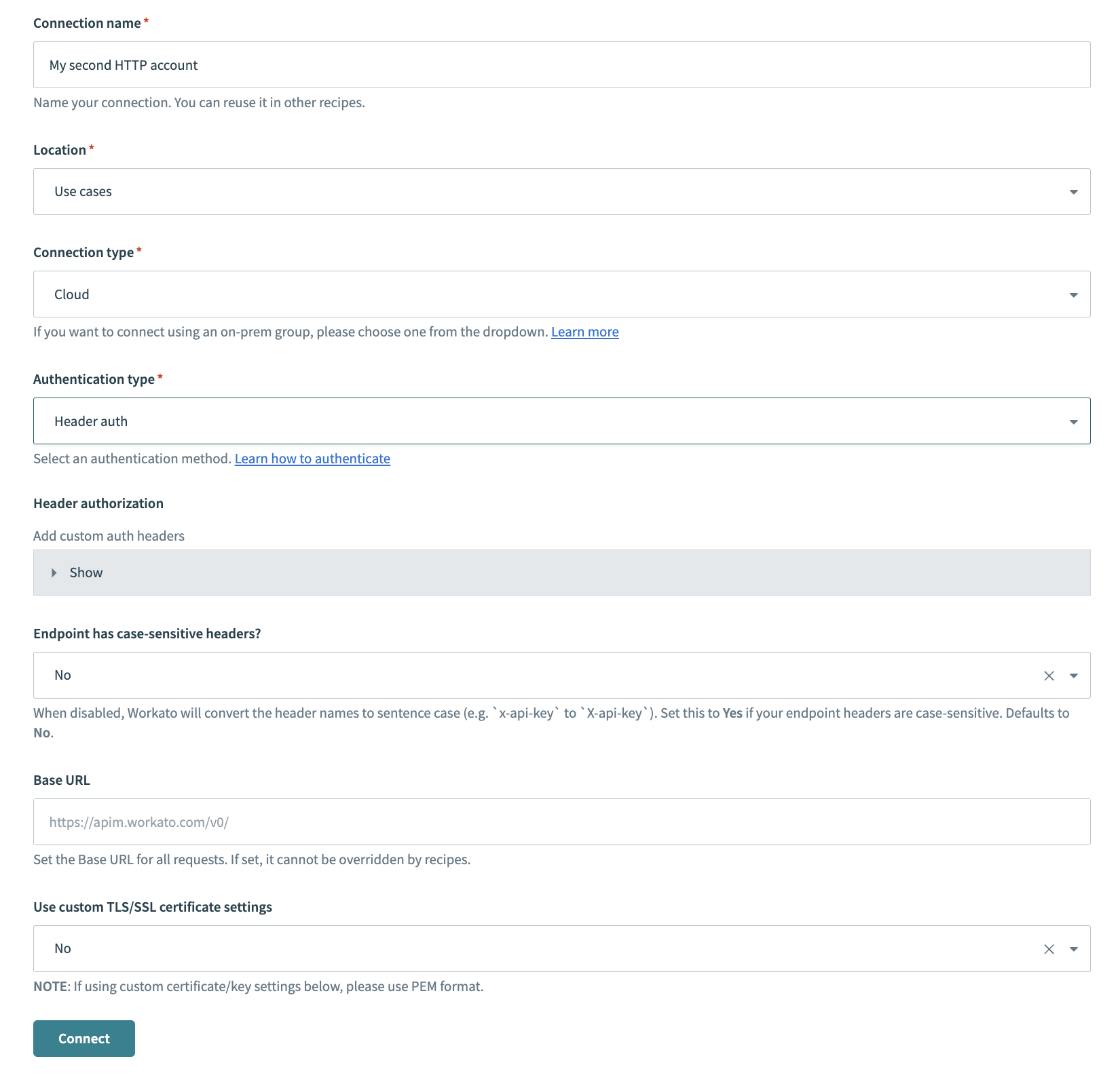

Header auth authentication type
The Header auth authentication type enables you to customize the headers sent in a request. This is useful if your app requires additional headers beyond the standard username and password or API key. You can also use this authentication type if you have a generated token.
Complete the following steps to create an HTTP connection with the Header auth authentication type:
HTTP connector authentication type: Header authHTTP connector authentication type: Header authorization
Use the Authentication type drop-down menu to select Header auth.
Optional. Expand Header authorization to add custom auth headers.

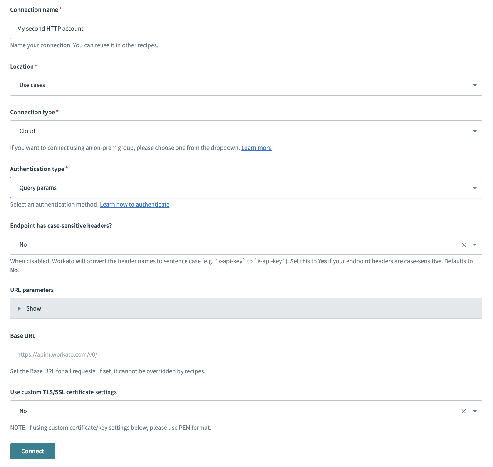

Query params authentication type
Use the Query params authentication type when you plan to use applications that require a validated API key as a parameter.
HTTP connector authentication type: Query paramsHTTP connector authentication type: Query params
Use the Authentication type drop-down menu to select Query params.
Optional. Expand Url parameters to add URL parameters.

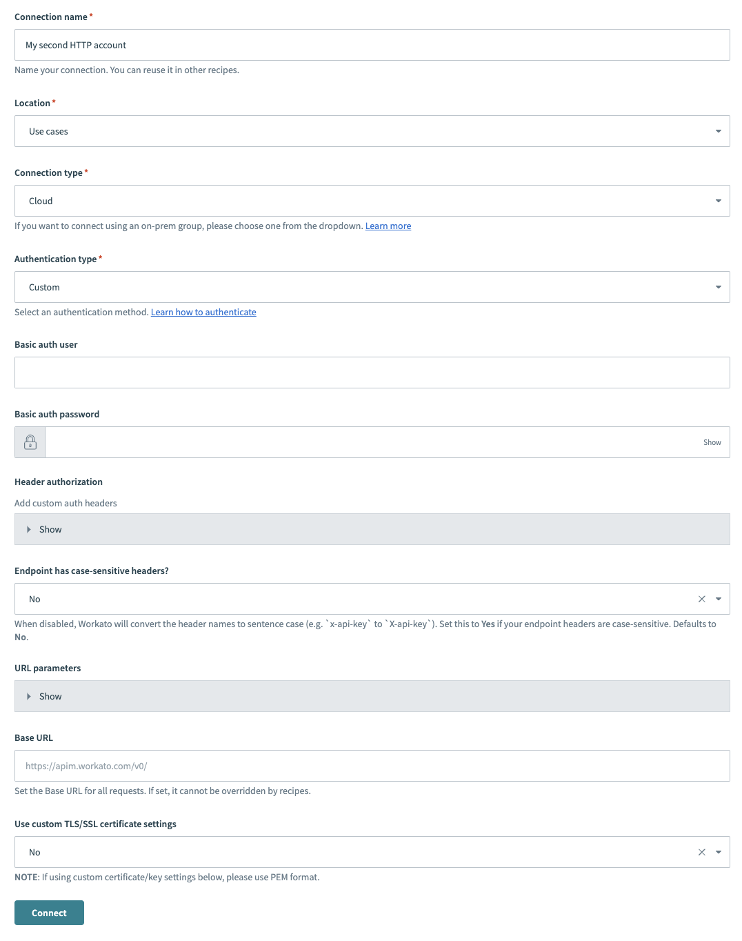

Custom authentication type
The Custom authentication type enables you to use a tailored combination of input fields to satisfy custom authentication requirements.
Custom http connectorHTTP connector authentication type: Custom
Use the Authentication type drop-down menu to select Custom.
Optional. Provide your user authentication name in the Basic auth user field.
Optional. Provide your user authentication password in the Basic auth password field.

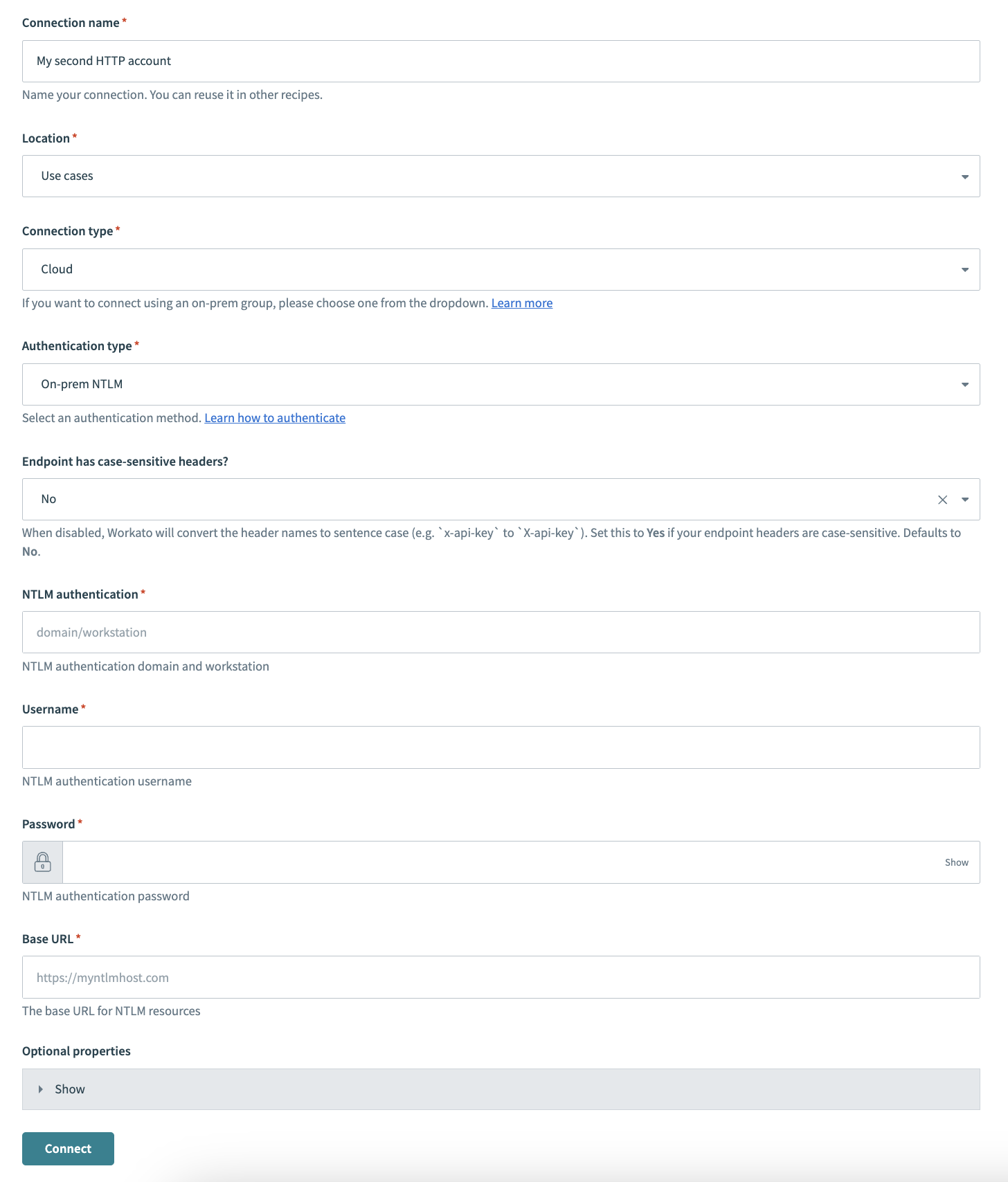

On-prem NTLM authentication type
Use the NT LAN Manager (NTLM) authentication type if you have a configured Workato on-prem agent and the application you plan to use requires NTLM authentication.
Complete the following steps to set up your HTTP connection with NTLM authentication:
Custom http connectorHTTP connector authentication type: On-prem NTLM
Use the Authentication type drop-down menu to select On-prem NTLM.
Provide your NTLM authentication domain or workstation name in the NTLM authentication field.
Provide your NTLM authentication username in the Username field.
Provide your NTLM authentication password in the Password field.
Optional. Expand Optional properties to configure additional profile properties.
The following profile properties are supported:
Property nameDescription
NTLM authenticationNTLM authentication domain and workstation name.
UsernameUsername for NTLM authentication.
PasswordPassword for NTLM authentication.
Base URLThe base URL for NTLM resources.
Connections per routeOptional. Sets the number of connections per route/host (must be a positive number, default 5).
Maximum connectionsOptional. Sets the maximum number of connections (must be a positive number, default 10).
TimeoutOptional The timeout in milliseconds used when requesting a connection (must be a positive number, default 10000).
Connection request timeoutOptional The timeout in milliseconds until a connection is established (must be a positive number, default 10000).
Socket timeoutOptional The socket timeout in milliseconds, which is the timeout for waiting for data or, put differently, a maximum period inactivity between two consecutive data packets (must be a positive number, default 10000).
Verify hostOptional. Specifies whether to enable verification of the host name for SSL/TLS connections (default true).
Trust allOptional. Specifies whether trust all certificates for SSL/TLS connections (default false).

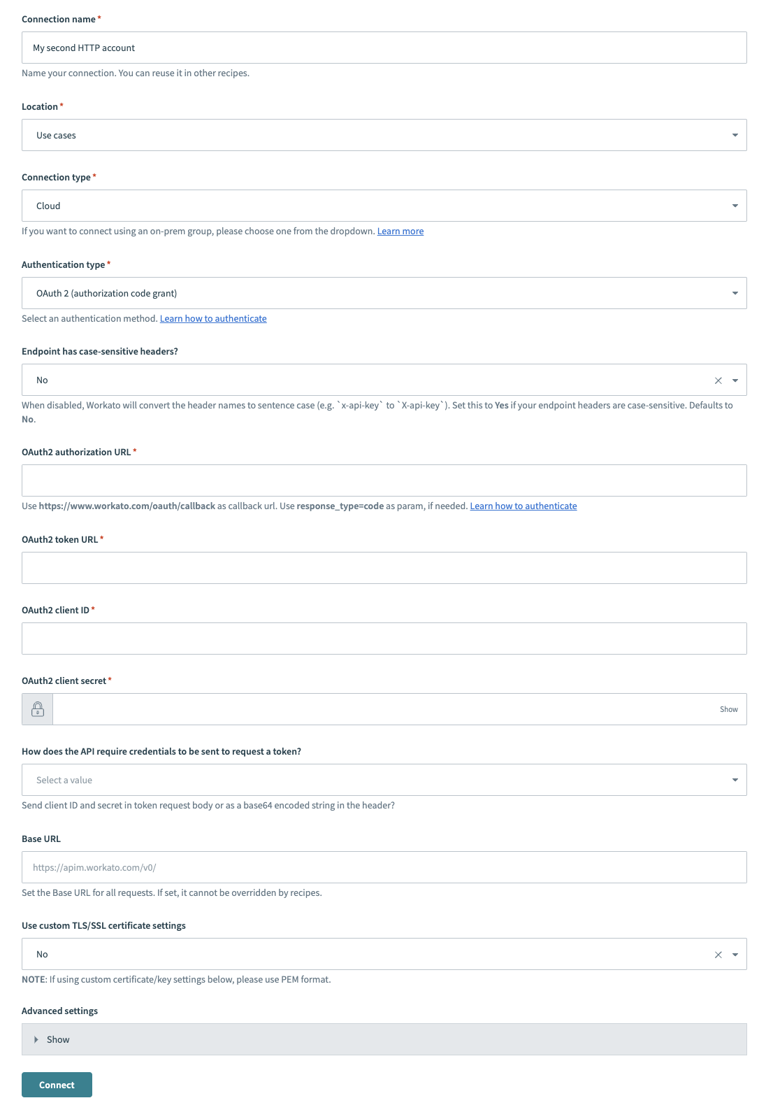

OAuth 2.0 authorization code grant authentication type
The OAuth 2.0 authorization code grant authentication type enables you to provide third parties with access to your apps without disclosing your username and password. Confidential and public clients use this authentication type to exchange an authorization code for an access token. Workato redirects you to your app to enter your login credentials when you use this authentication type. This enables Workato to act on your behalf when making API requests.
Complete the following steps to set up your HTTP connection with OAuth 2.0 authorization code grant authentication:
HTTP (OAuth2 auth code grant) connector's connection fieldsHTTP (OAuth2 authorization code grant) connector's connection fields
Use the Authentication type drop-down menu to select OAuth 2 (authorization code grant).
Provide your authorization URL in the OAuth2 authorization URL field.
Provide your token in the OAuth2 token URL field. This auth token is used to verify that Workato has permission to access your app.
Provide your client ID in the OAuth2 client ID field. The client ID identifies you as the user who’s sending the API requests.
Use the How does the API require credentials to be sent to request a token? drop-down menu to determine whether to send the client ID and secret in the token request body or as a base64 encoded string in the header.
12
Optional. Expand Advanced settings to configure OAuth2 scopes and token settings.

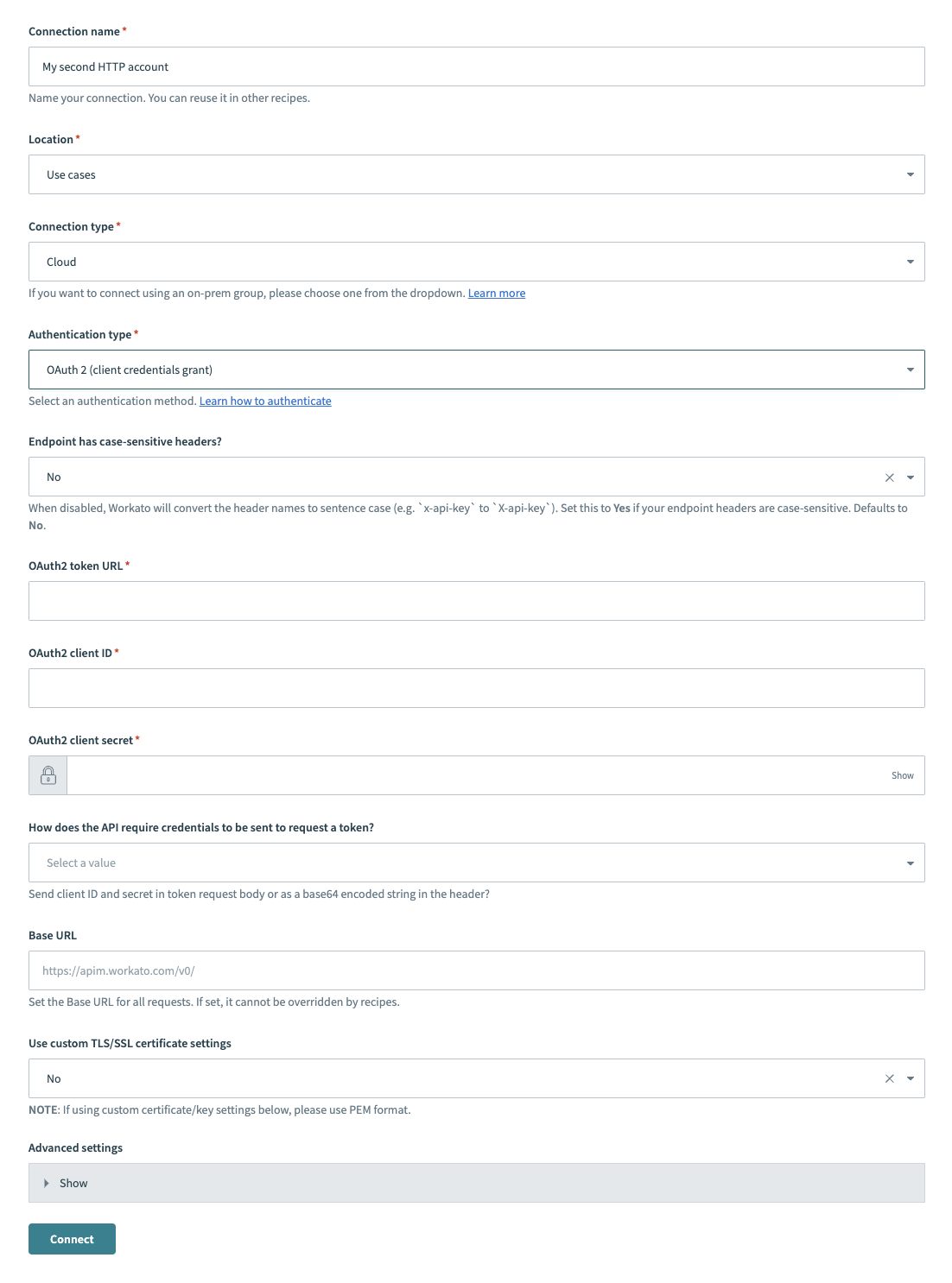

OAuth 2.0 client credentials grant authentication type
Use the OAuth 2.0 client credentials grant authentication type if you plan to enable the client to request an access token using only client credentials. This authentication type is usually used when the client is requesting access to the protected resources under its control or for machine-to-machine authentication where a specific user’s permission to access data is not required. The client credentials grant type can only be used by confidential clients.
Complete the following steps to set up your HTTP connection with OAuth2 client credentials grant authentication:
HTTP (OAuth2 client credentials grant) connector's connection fieldsHTTP (OAuth2 client credentials grant) connector's connection fields
Use the Authentication type drop-down menu to select OAuth 2 (client credentials grant).
Provide your OAuth2 token URL in the OAuth2 token URL field.
Provide your client secret in the OAuth2 client secret field.
12
Optional. Expand Advanced settings to configure OAuth2 scopes.
13

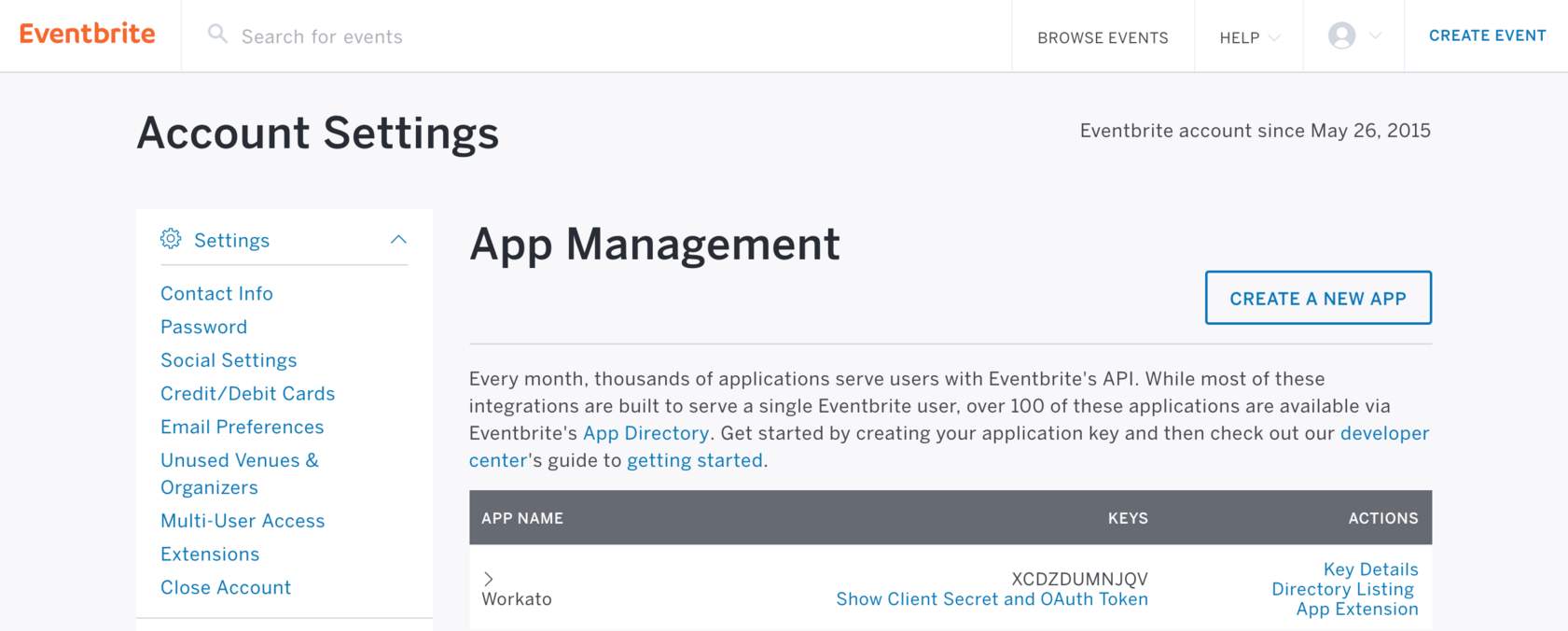

You must have a client ID and client secret to connect to your Eventbrite account successfully. You must register an app with Eventbrite to obtain these credentials.
Complete the following steps to obtain your credentials:
Log in to Eventbrite and navigate to Account Settings > App Management.
Eventbrite's App Management screenEventbrite's app management screen
