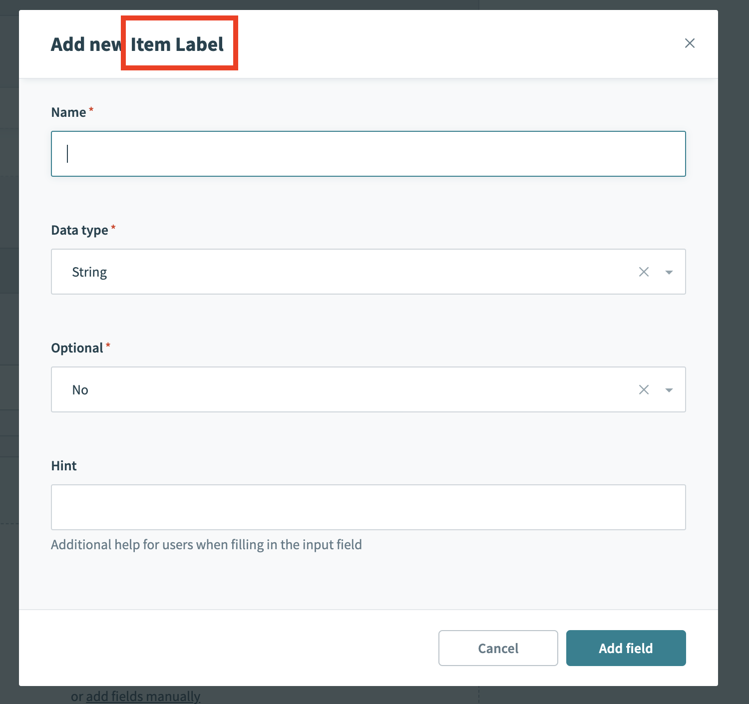

item_labelOptional. Only used with control_type: "schema-designer" or control_type: "key_value". This allows you to configure the item name stated in the modal popup. Setting item_label: "Item Label" results in the following:
add_field_labelOptional. Only used with control_type: "schema-designer" or control_type: "key_value". This allows you to configure the label of the add button. Setting add_field_label: "Custom Add Label" results in the following:

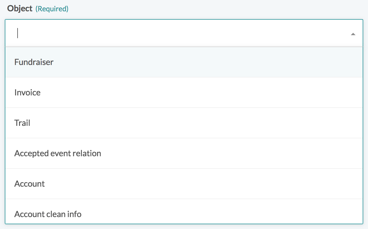

select Control type to provide a predefined list of values to choose from. Make sure to include the pick_list property.
select control type

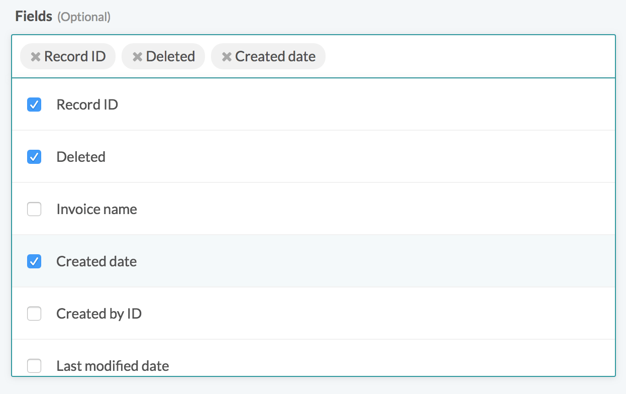

multiselect Control type similar to select with additional ability to select multiple values. This control type must be accompanied with pick_list and delimiter properties.
multiselect control type

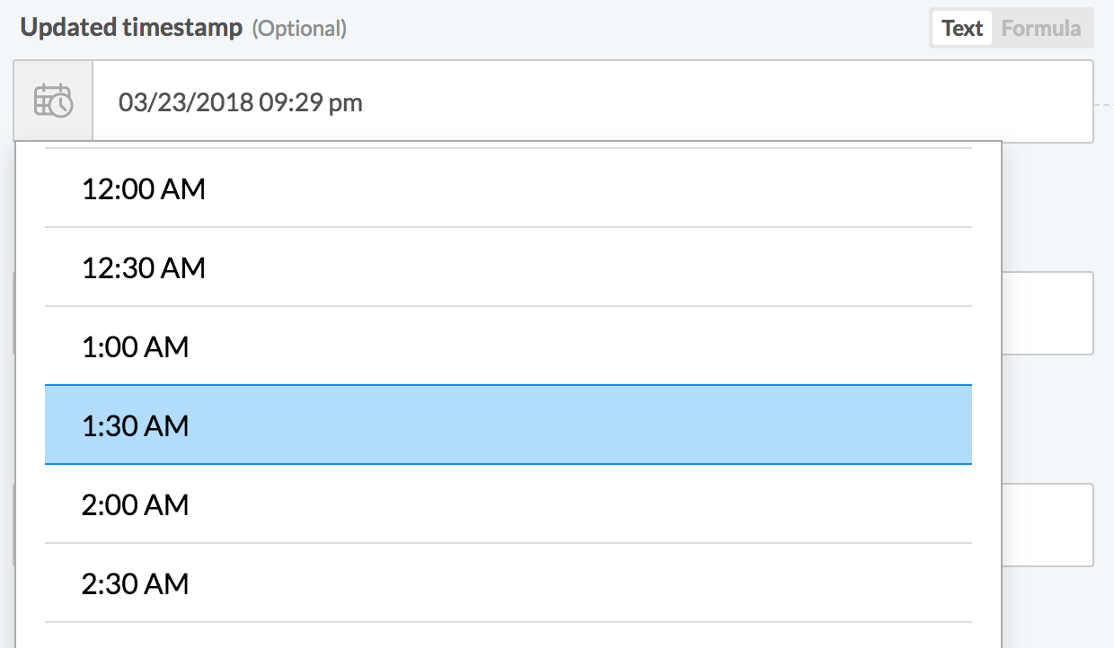

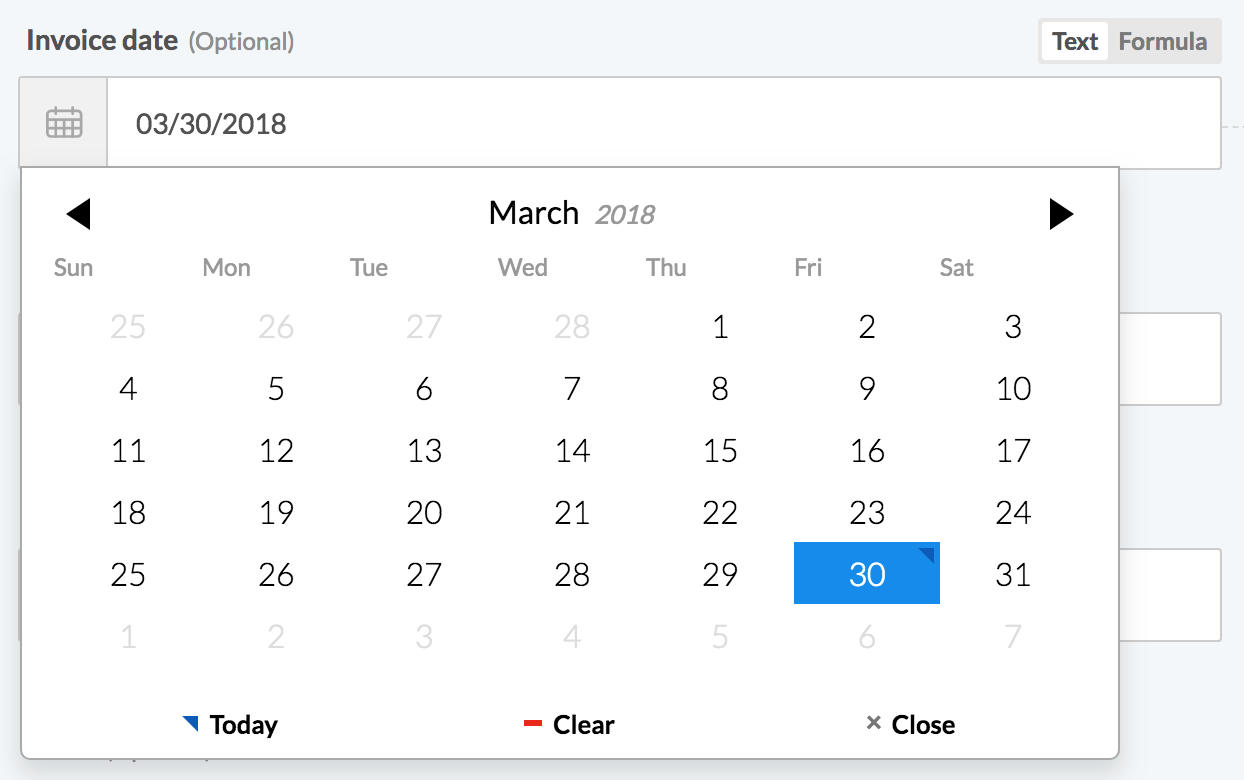

date Control type indicating date value. This control type has a formula mode option. date control type
date_time Control type indicating date with time value. This control type has a formula mode option. date_time control type

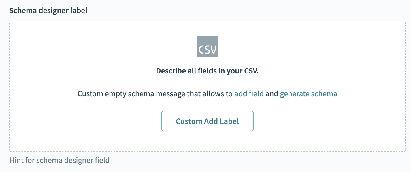

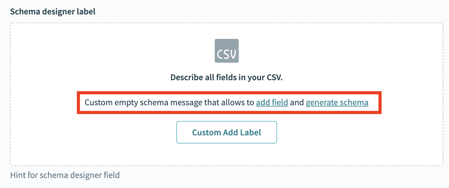

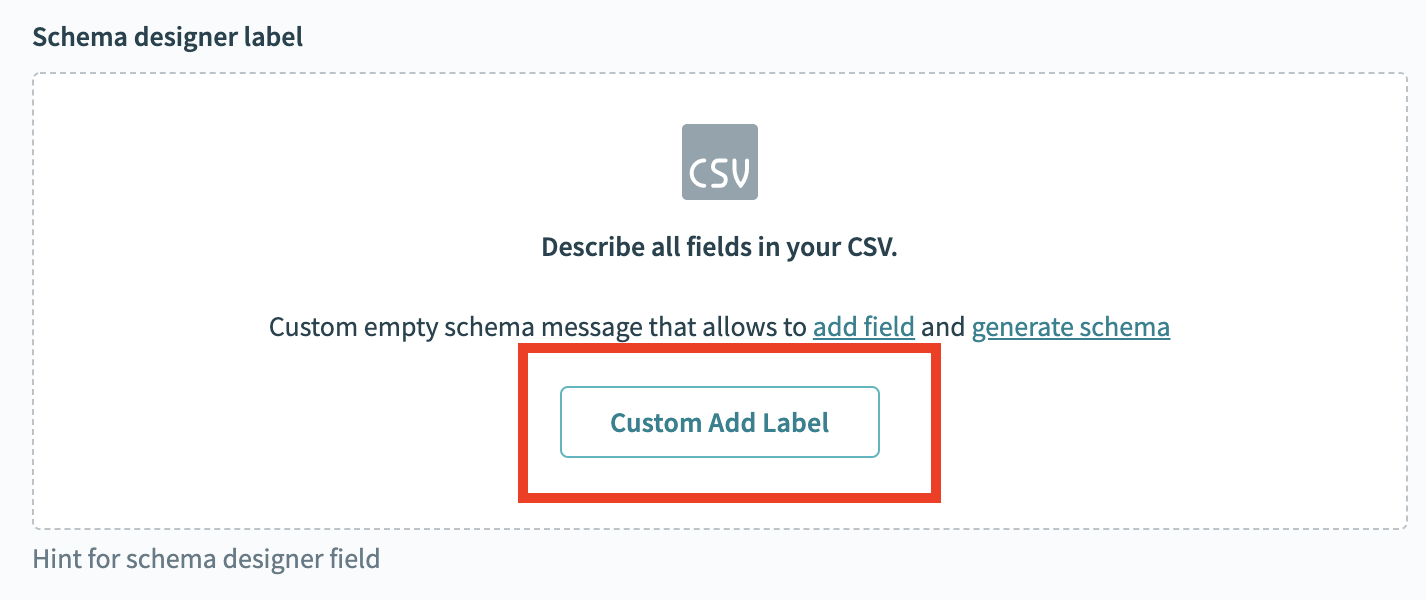

schema-designer Control type that allows you to collect schema information from users. This is useful when you need users to give your input during recipe design time to create input or output fields. This requires extends_schema: true to take effect.
  extends_schema: true,
  schema_neutral: false,
  control_type: 'schema-designer',
  label: 'Schema designer label',
  hint: 'Hint for schema designer field',
  item_label: 'button',
  add_field_label: 'Custom Add Label',
  empty_schema_message: 'Custom empty schema message that allows to <button type="button" data-action="addField">add field</button> and <button type="button" data-action="generateSchema">generate schema</button>',
  sample_data_type: 'csv' # json_input / xml
schema-designer

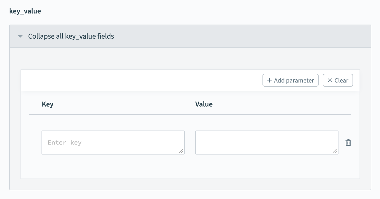

key_value Control type that allows you to collect key and value pairs from users. This is useful when you need users to give your input during recipe design time for URL query parameters. Must be accompanied with `properties` defined and two inputs given.
  control_type: "key_value",
  label: "key_value",
  empty_list_title: "Add query parameters",
  empty_list_text: "Description for empty list",
  item_label: "Query parameter",
  type: "array",
  of: "object",
  properties: [
    { name: "key"},
    { name: "value"}
key_value

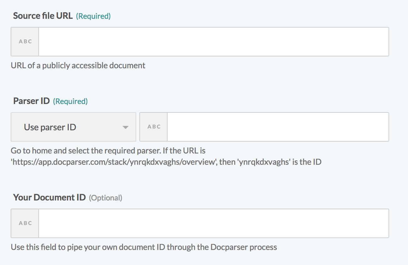

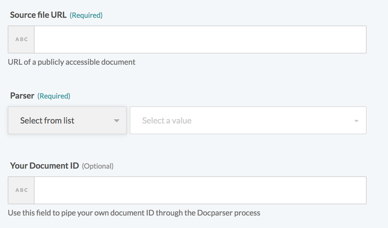

Toggle fields are a special type of input fields that allow 2 input types. They are a great way to introduce greater flexibility and increase usability in your input fields. When used, toggle fields allow users to switch between two control types.
TIP
Toggle fields are often used in conjunction with pick lists. Since pick lists produce drop-downs, users are unable to map datapills which they normally would in recipes. Toggle fields fix that by allowing them to toggle to plain text fields which can accept datapills.
Sample code snippet
ruby
    input_fields: lambda do |object_definition, connection, config_fields|
        label: "Document Parser",
        hint: "The Document Parser the file gets imported to",
        control_type: :select,
        pick_list: "parsers",
        optional: false,
        toggle_hint: "Select from list",
        toggle_field: {
          label: "Parser ID",
          type: :string,
          control_type: "text",
          optional: false,
          toggle_hint: "Use Parser ID",
          hint: "Go to home page and select the required parser. If the URL is 'https://app.docparser.com/stack/ynrqkdxvaghs/overview', then 'ynrqkdxvaghs' is the ID"
    end
toggle primaryPrimary toggle field
toggle secondarySecondary toggle field
You can use a picklist input type to create a customized user experience. However, this makes the action value mapping static. All recipe jobs executing this action use the single parser ID value you selected, because only one value can be selected from the picklist. You can avoid this limitation by using a text field. A text field allows you to dynamically map the input field value.
If both field types are preferred for your planned use case, you can use the toggle_field to provide both input options to users. The picklist type is set as the primary toggle and the text field is set as the secondary (nested toggle_field) because the most common scenario is for users to select one parser per action.

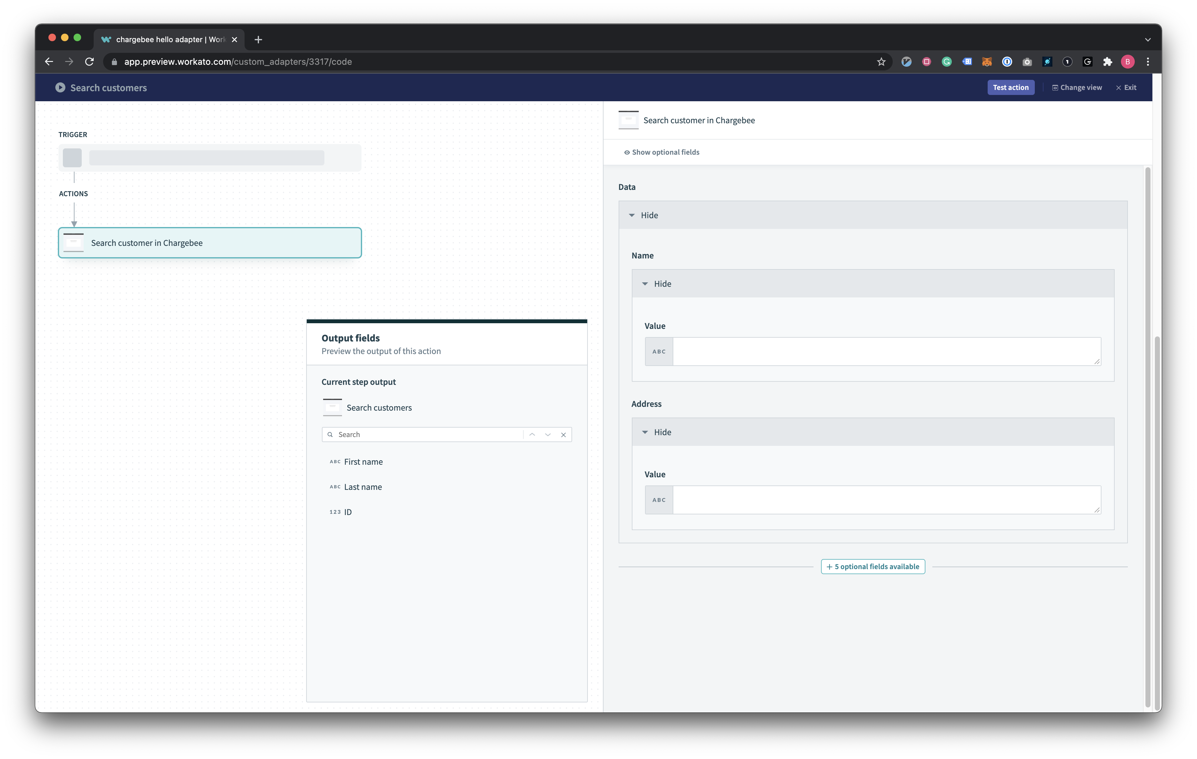

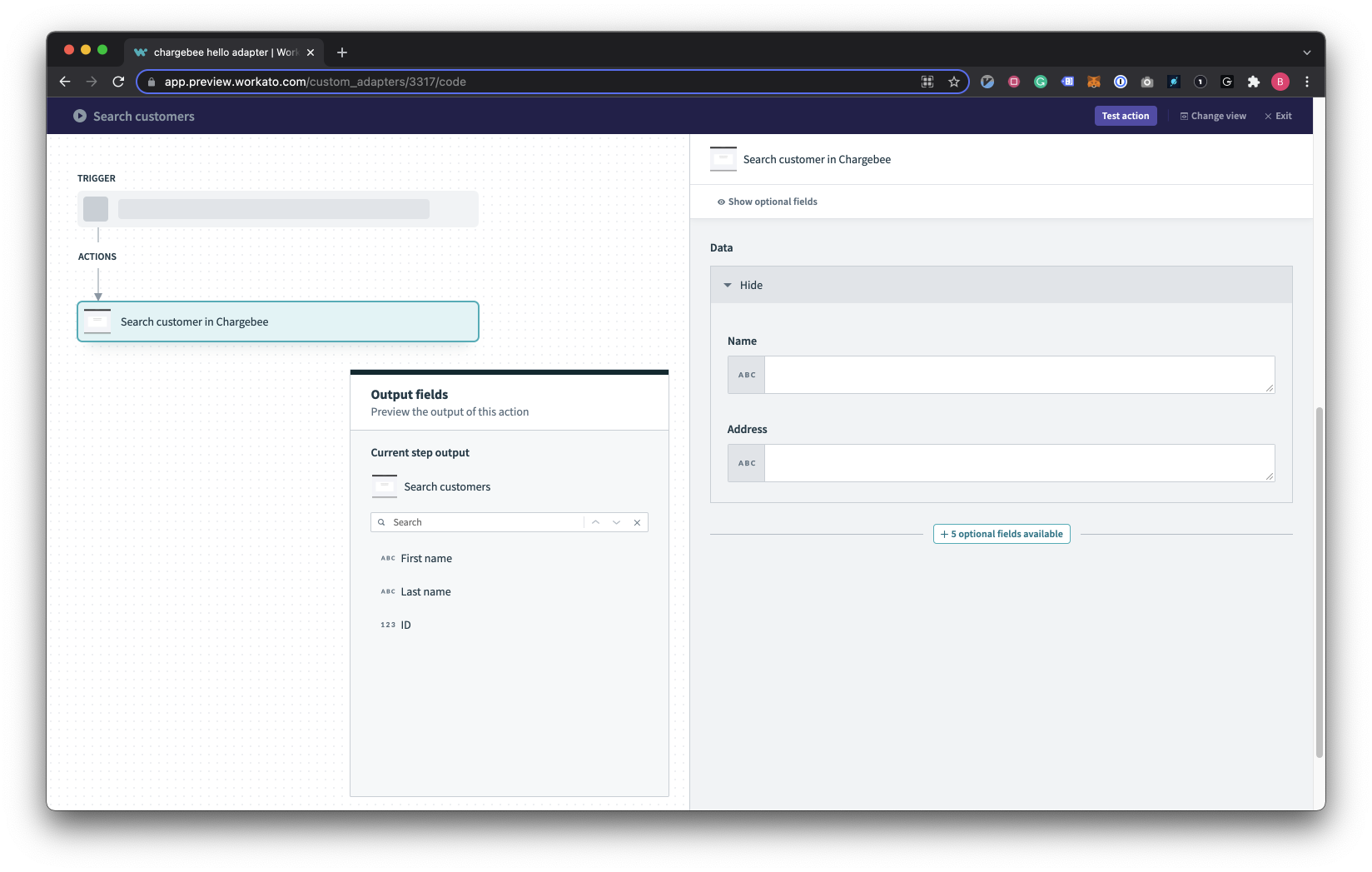

The corresponding input_field representation might be overly nested, making it cumbersome for users.
Nested fieldsInput fields represented by the earlier example
Custom lambdas help you improve the UX of your connector by allowing you to present a relatively flat input field structure and performing the transformations afterwards.
