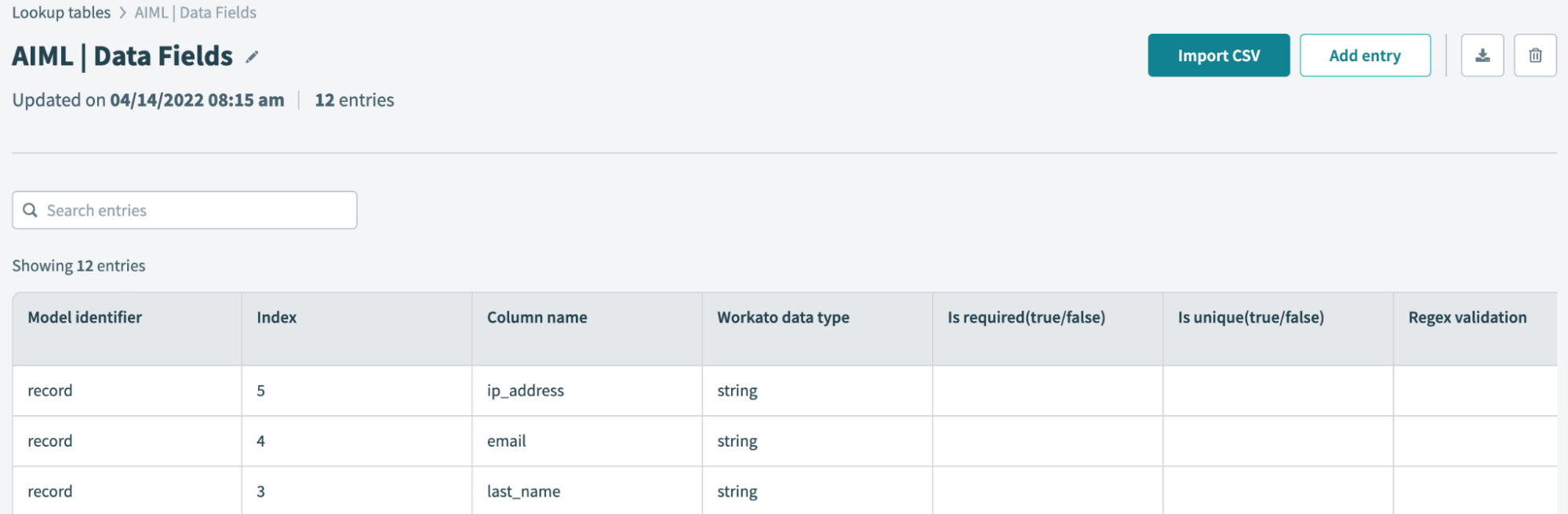

The AIML|Data Fields lookup table saves the schema of the data model deployed on SageMaker. Workato sends data to Sagemaker to create and train a data model. Sagemaker then validates this data against the rules defined in the AIML | Data Fields lookup table.
AIML Data fieldsData fields lookup table

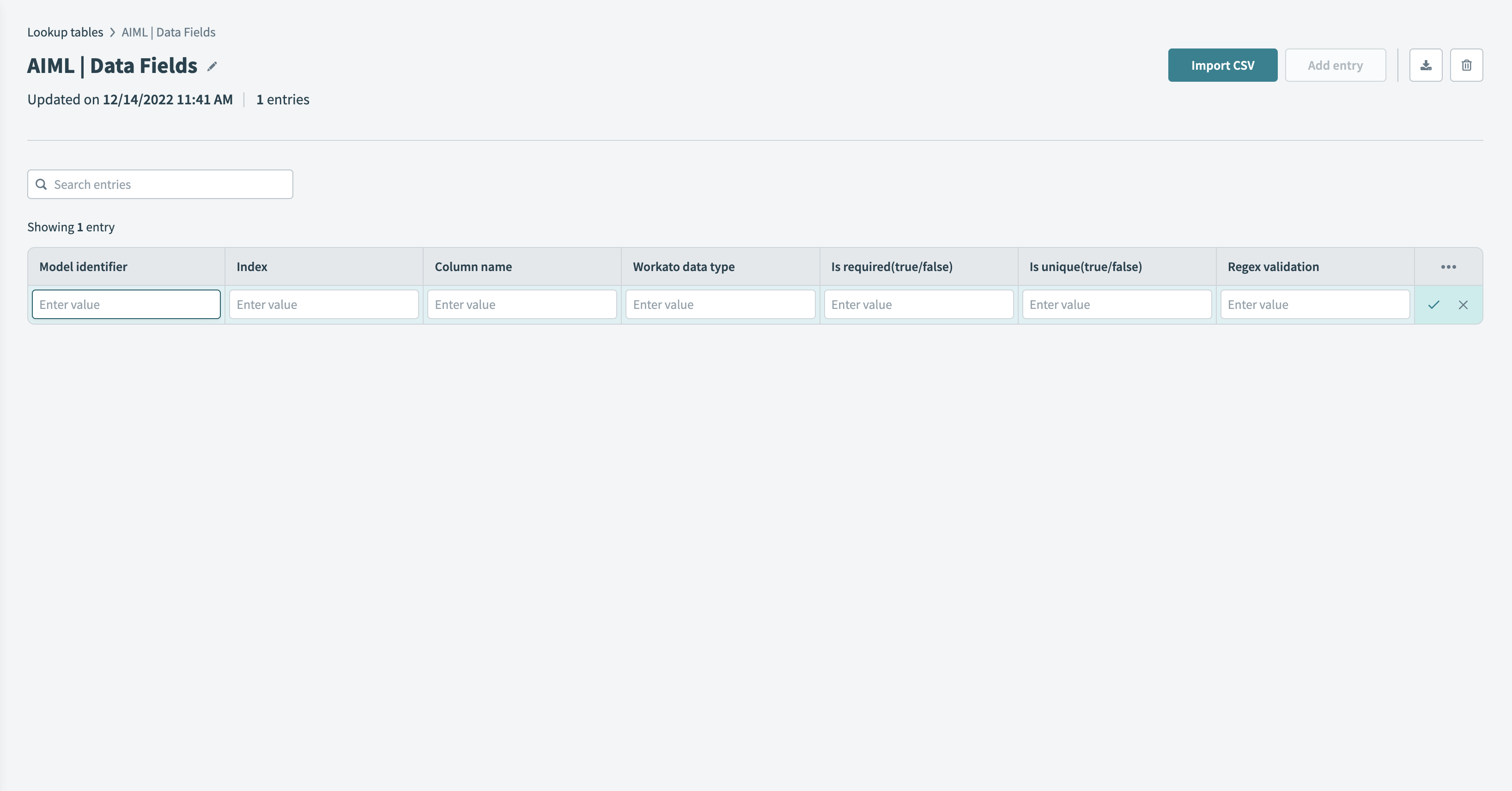

There are two options to configure the AIML | Data Fields lookup table. The first option is to click Add Entry and manually configure each data field. The second option is to use the AIML|REC-009|Load Model Schema recipe to automate this process. This recipe also adds an entry to the AIML | Model Profile lookup table.

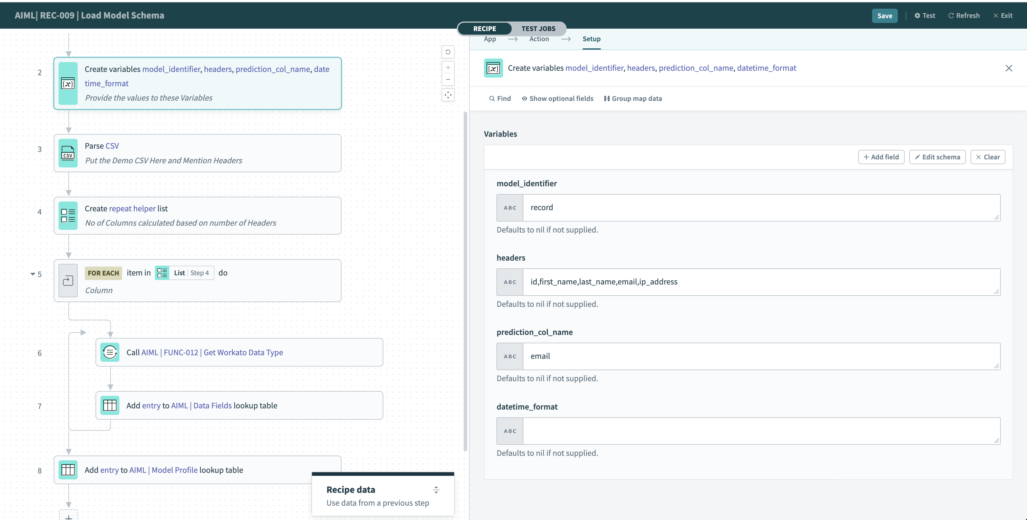

Follow these steps to use the AIML | REC-009 | Load Model Schema recipe:
In Workato, Navigate to Projects > Home > AIML Accelerator > Bootstrap.
Select AIML | REC-009 | Load Model Schema.
Configure the input fields in Step 2.
Configure the input fieldsConfigure input fields
model_Identifier
Provide a unique, user-friendly name to identify the machine learning model.
headers
Provide the column names of the schema in CSV format without any spaces.
prediction_col_name
Provide the name of the prediction column.
datetime_format
If the data contains date-time values, provide the format to enable Workato to parse them. See date-time formats for a list of formats Workato supports.
In Step 3, provide sample CSV data for the data model to consume.
Example:
id,first_name,last_name,email,ip_address
1,Lucy,Carrigan,[email protected],123.45.678.900
2,Jude,Feeney,[email protected],987.65.43.210.012
3,Sadie,Simmons,[email protected],345.67.890.100
Click Test to run the recipe one time.
Navigate to the AIML|Data Fields lookup table to check for the updated values.
Manually provide the validation rules by configuring the input fields.
Workato data type
Provide the data type of the field. See Workato-supported data types for a list of data types Workato supports.
Is required (true/false)
Set to true if the field is a required field. Set to false or leave blank if the field is not required.
Is unique (true/false)
Set to true if the field's value must be unique within the dataset used to train the model. Set to false or leave black if the value must not be unique.
Regex pattern
Workato checks data against this pattern.
