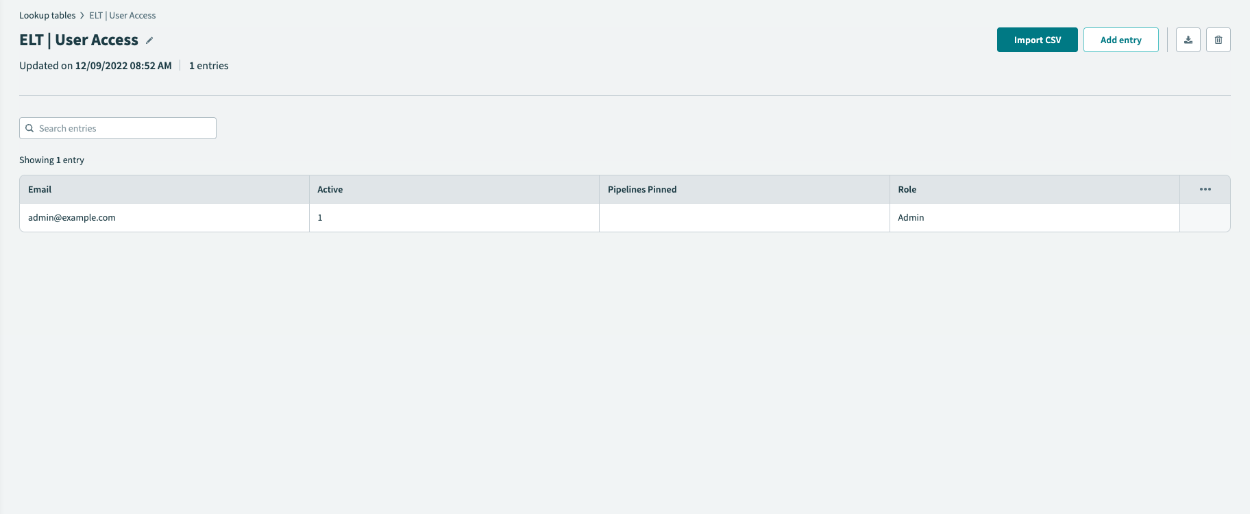

# Set up the ELT | User Access lookup table
Navigate to Tools > Lookup tables.
Select ELT | User Access from the list of available lookup tables.
Add a user to your lookup table. Assign them to an Admin role.
Add user to lookup table

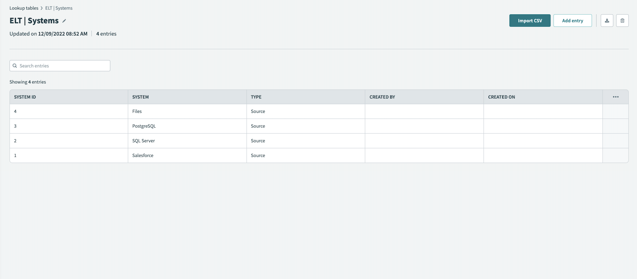

# Set up the ELT | Systems lookup table
Workato preconfigures the ELT | Systems lookup table with four sources:
  • Salesforce
  • SQL Server
  • PostgreSQL
  • On-prem files
If you don't need to use some of these sources, you can remove them by editing this lookup table.
Select ELT | System Access from the list of available lookup tables.
Edit or remove sources, as necessary.
Edit lookup table
