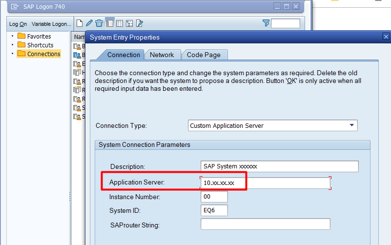

SAP - Direct Connection
Below is the example of Direct connection type. Use this connection type if SAP system is directly exposed as an application server.
yaml
server:
  classpath:
    - lib_ext
sap:
  # Direct connection to an ABAP application server
  sap_profile_1: # This is on-prem agent connection profile name
    network_connection:
      gateway_host: "xx.xx.xx.xx"
      system_number: "00"
      program_id: "WORKATO"  # Only needed if you are using IDocs. This can be omitted for connections that only use RFCs.
      metadata_refresh_interval: "10"
    user_logon:
      client: "800"
      language: "EN"
      user: "USERN"
      password: "PASSW"

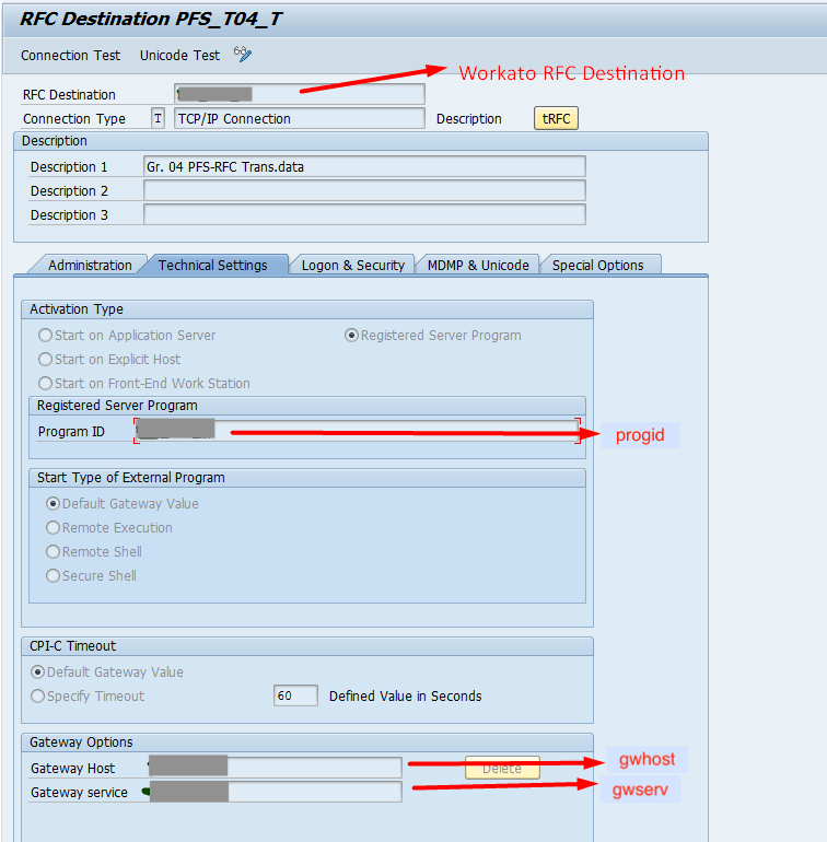

Parameter (JCO Connection Property)DescriptionClick to expand image
gateway_host (jco.client.ashost)Can be either DNS name or IP address. If present, this describes a direct connection to SAP host. Can be in the format xx.xx.xx.xx. This is the IP Address of the SAP application server to which you are directly connecting. This can be seen on the SAP Logon Pad which is used to log in to your on-premise SAP Application server.Host

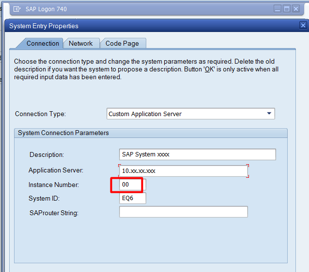

system_number (jco.client.sysnr)Two-digit SAP system number. It identifies the logical port on which the application server is listening for incoming requests. Commonly found from the TCP Port 33XX where XX is the system_number. This defaults to 00 if not provided.System number
program_id (jco.server.progid)OPTIONAL. This matches the program ID given to the RFC destination linked to Workato in Tcode SM59.Program ID

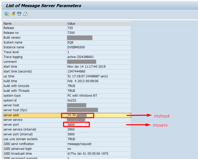

SAP - Message Server Connection
Below is the example of messageserver connection type. Use this connection type when SAP system is behind message server gateway.
yaml
server:
  classpath:
    - lib_ext
sap:
  # Message Server connection to an ABAP application server
  sap_profile_2: # This is on-prem agent connection profile name
    network_connection:
      message_server_host: "10.30.xx.xx"
      logon_group: "PUBLIC"
      system_id: "DEV"
    user_logon:
      client: "800"
      language: "EN"
      user: "USERN"
      password: "PASSW"
message_server_host (jco.client.mshost)Message Server host in the format of xx.xx.xx.xx. This is the IP Address of the Message Server you are connecting.Message Server Host
logon_group (jco.client.group)Optional. Logical group name of the application servers. Can be found in SAP Tcode SMLGGroup
system_idThe system ID of the system the message server belongs to. See SAP Note 52959 in case of connection error.
client (jco.client.client)The actual client number which is used for connecting to Workato. Use the same client you log into with your SAP Logon Pad. It's always a three-digit integer.Client
language (jco.client.lang)OPTIONAL. Represents the logon language. If the property is not provided, the user's or system's default language is used. Valid values are two-character ISO language codes or one-character SAP language codes.Language
user (jco.client.user)SAP user provisioned for Workato. Using background user and disabling dialog properties are recommended.User
password (jco.client.passwd)SAP user password.Password
metadata_refresh_intervalThe interval in minutes to refresh metadata from SAP (except JCo cache). Default is 1440 minutes (24 hours).
