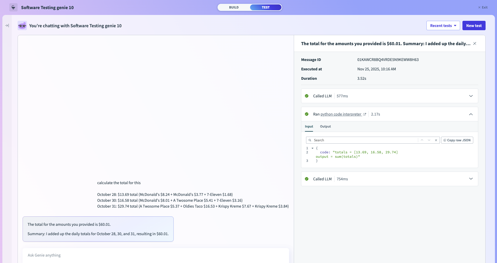

Arithmetic error solution
Provide your genie with a Python code execution skill to handle mathematical operations reliably. This solution uses the following workflow:
  • Genie identifies when mathematical calculations are needed
  • Genie calls the Python execution skill
  • Python performs the calculation with precision
  • Genie receives and uses the accurate result

Python code interpreterPython code interpreter
