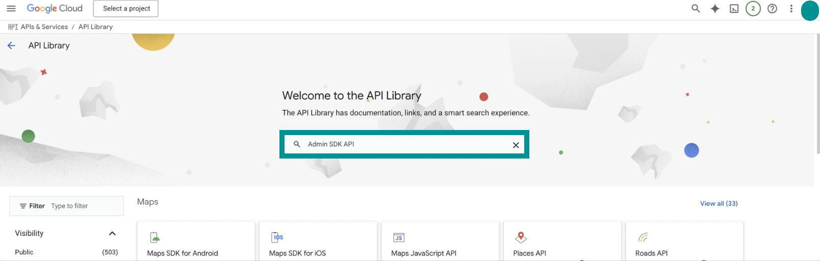

Go to the Google Cloud Console API library (opens new window) using the Google Workspace account that provides the service accounts.
Go to the Google Cloud Console API libraryGo to the Google Cloud Console API library
Search for and select Admin SDK API.
Select Admin SDK APISelect Admin SDK API
REQUIRED FOR INDEX CRAWLING
You must enable the Admin SDK to allow index crawling.
Click Enable.
Enable Admin SDK APIEnable Admin SDK API

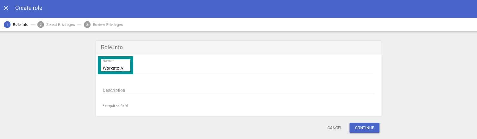

Click Create new role to create a custom admin role.
Create new roleCreate new role
Name the role Workato AI.
Name the roleName the role
Optional. Add a Description for the role.
Click Continue.

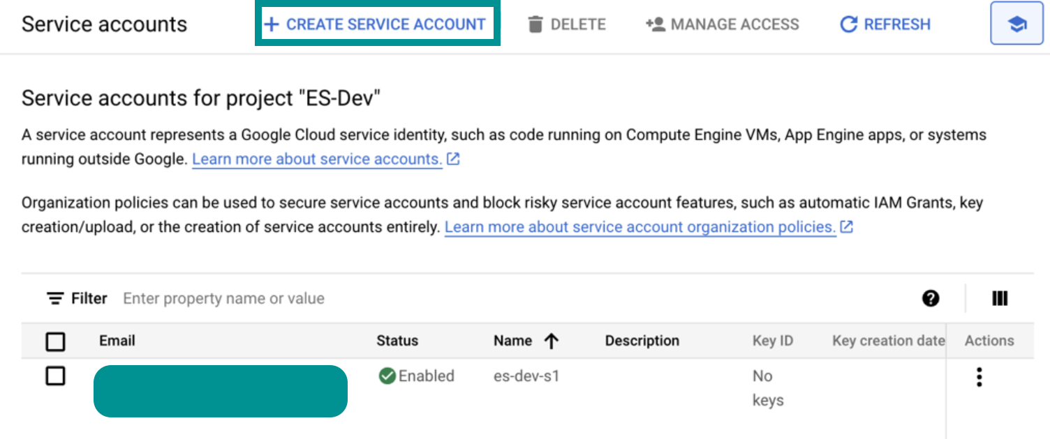

Go to Google Service Accounts (opens new window) in Google Cloud Console and select an existing project or create a new project if one doesn't already exist.
USE THE SAME SERVICE ACCOUNT FOR YOUR GOOGLE APPS
You can use the same service account for the Gmail, Google Calendar, and Google Drive Workato GO data sources.
Click CREATE SERVICE ACCOUNT and skip the optional steps.

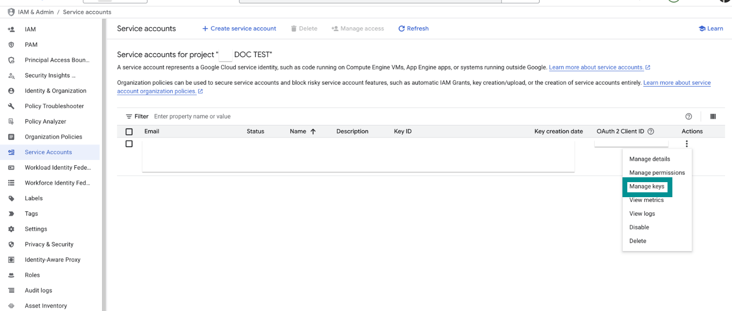

Go to the Actions column for the service account and click the manage menu (three dots).
Click the manage menuClick the manage menu
Click Manage keys. The Keys page automatically displays.

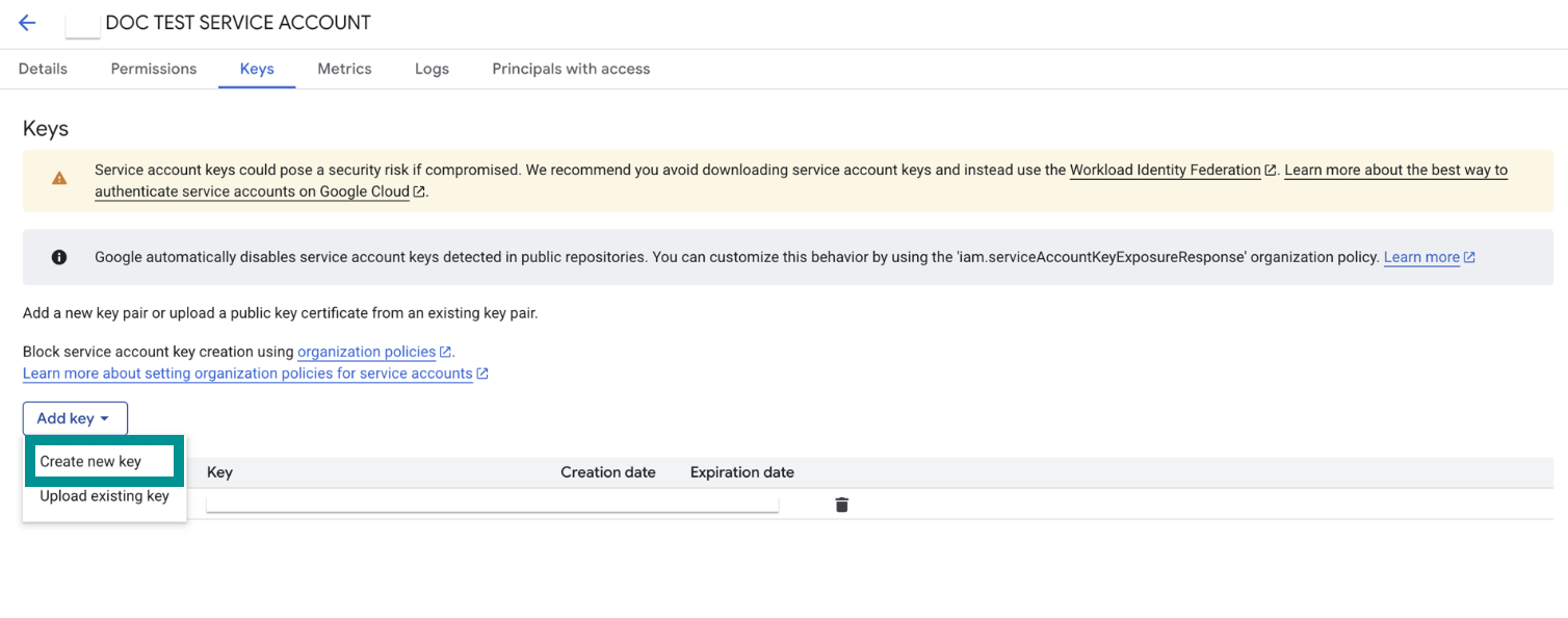

Click Add key > Create new key. The Create private key modal opens.
Create new keyCreate new key
Select JSON and click Create. A JSON file automatically downloads to your computer. Store the file safely as its contents are required for the Service Account JSON section in the Workato GO platform.

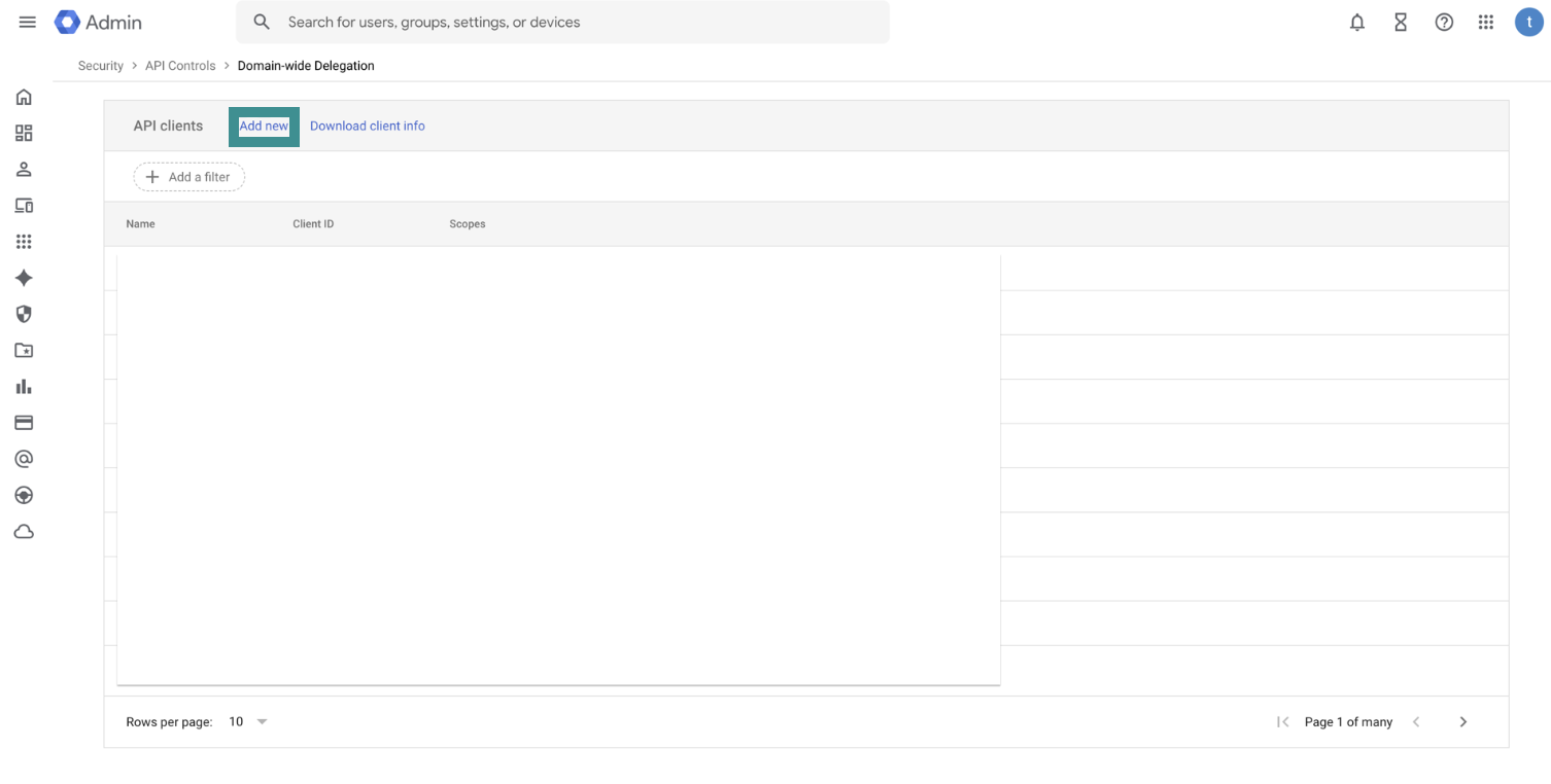

Go to Google Admin Console and sign in as an admin.
Go Menu > Security > Access and data control > API controls > Manage Domain Wide Delegation.
Click Add new.
Add API scopesAdd API scopes
Enter the OAuth 2.0 Client ID that you created in the preceding steps into the Client ID field.
Enter the Client IDEnter the Client ID
