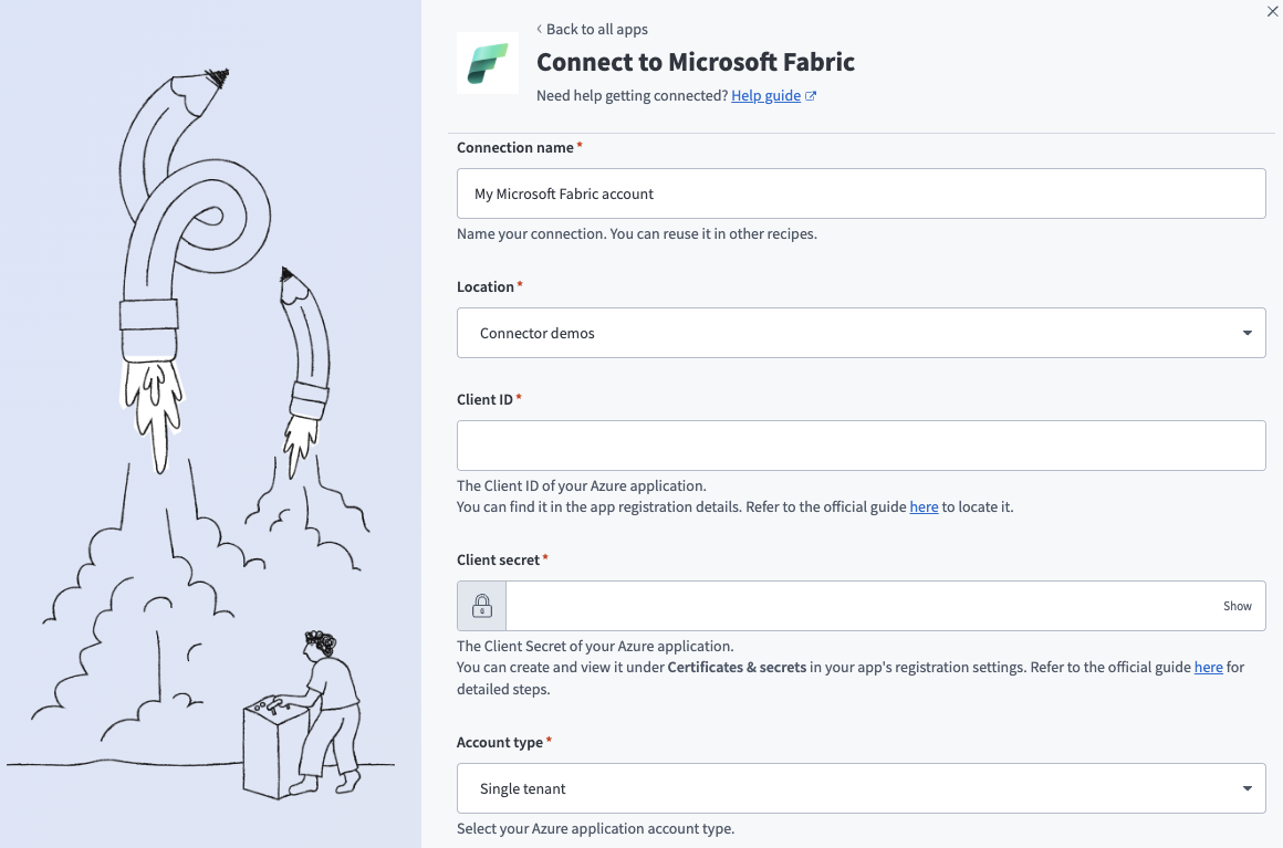

Complete the following steps to set up an authorization code grant connection to Microsoft Fabric in Workato:
Search for Microsoft Fabric and select it as your app.
Microsoft Fabric authorization code connectionMicrosoft Fabric authorization code connection
Use the Authentication type drop-down menu to select OAuth2 Authorization Code.
Enter the Client ID of your Azure application.
Enter the Client secret of your Azure application.
Use the Account type drop-down menu to select your Azure application's account type. Options are Single tenant, Multitenant, or Active directory multitenant. Defaults to Single tenant.
Enter the Tenant ID of your Azure application. The Tenant ID field is only available when Account type is Single tenant.
Optional. Enter additional Scopes as a comma-separated list. Refer to Minimum and default scopes for more information.
