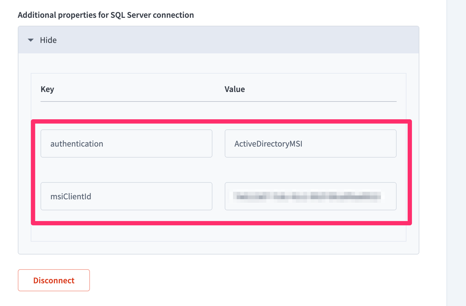

# Managed Identity
Follow the on-prem connection setup, then expand the Additional properties for SQL Server connection section and add the following:
Key Value
authentication ActiveDirectoryMSI
msiClientId Enter the client ID of the Managed Identity in Azure that has been granted access to SQL Server.
Add Managed Identity properties to the connectionAdd Managed Identity properties in the Additional properties section
The Username and Password fields can be left blank.
