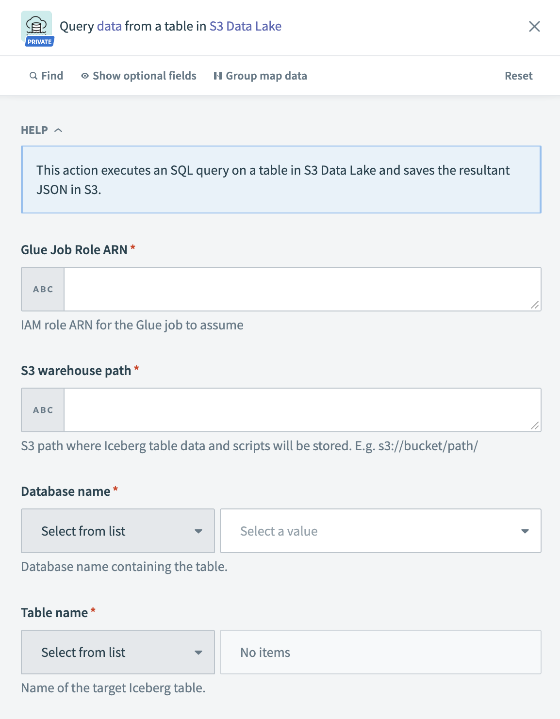

The Query data action runs a SQL query on a Glue Iceberg table and write the results to S3 in JSON format.
S3 Data Lake – Query data actionS3 Data Lake – Query data action
Input ​
Input fieldDescription
Glue Job Role ARNEnter the IAM role ARN for the Glue job to assume.
S3 warehouse pathProvide the S3 path where you plan to store the Iceberg table data and scripts. For example, s3://bucket/path/.
Database nameSelect the Glue database containing the Iceberg table.
Table nameSelect the Iceberg table to query.
ColumnsSelect columns to include in the query. Leave blank to return all columns.
SQL WHERE ClauseEnter a WHERE clause to filter records in the query.
LimitSet the maximum number of records to return.
Glue versionSelect the AWS Glue version to use. Defaults to 4.0 if left blank.
Worker typeChoose the AWS Glue worker type.
Number of workersSpecify how many workers to allocate. Defaults to 2 if left blank.
