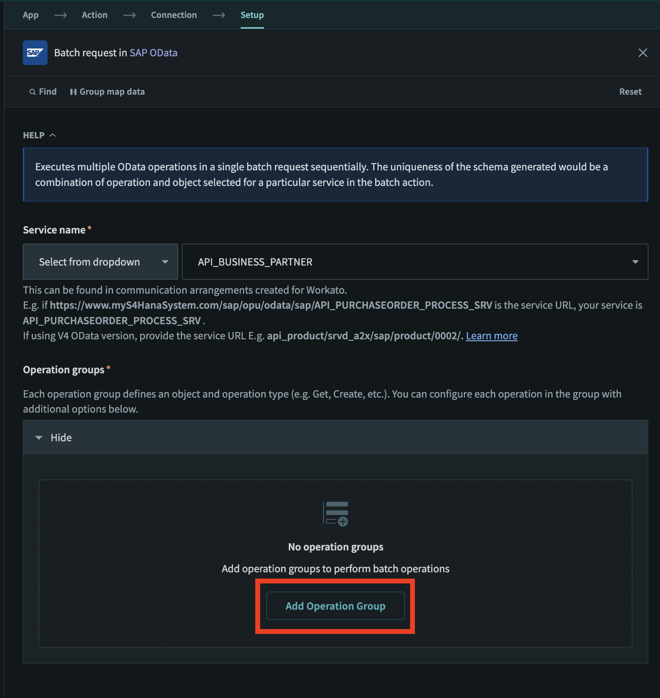

Batch request action
This action enables customers to execute multiple CRUD (Create, Read, Update, Delete) operations in a single request, significantly improving efficiency, reliability, and cost-effectiveness.
Select the service. OData batch service selectionSelect service
Click Add operation group. OData batch operation group selectionAdd operation group

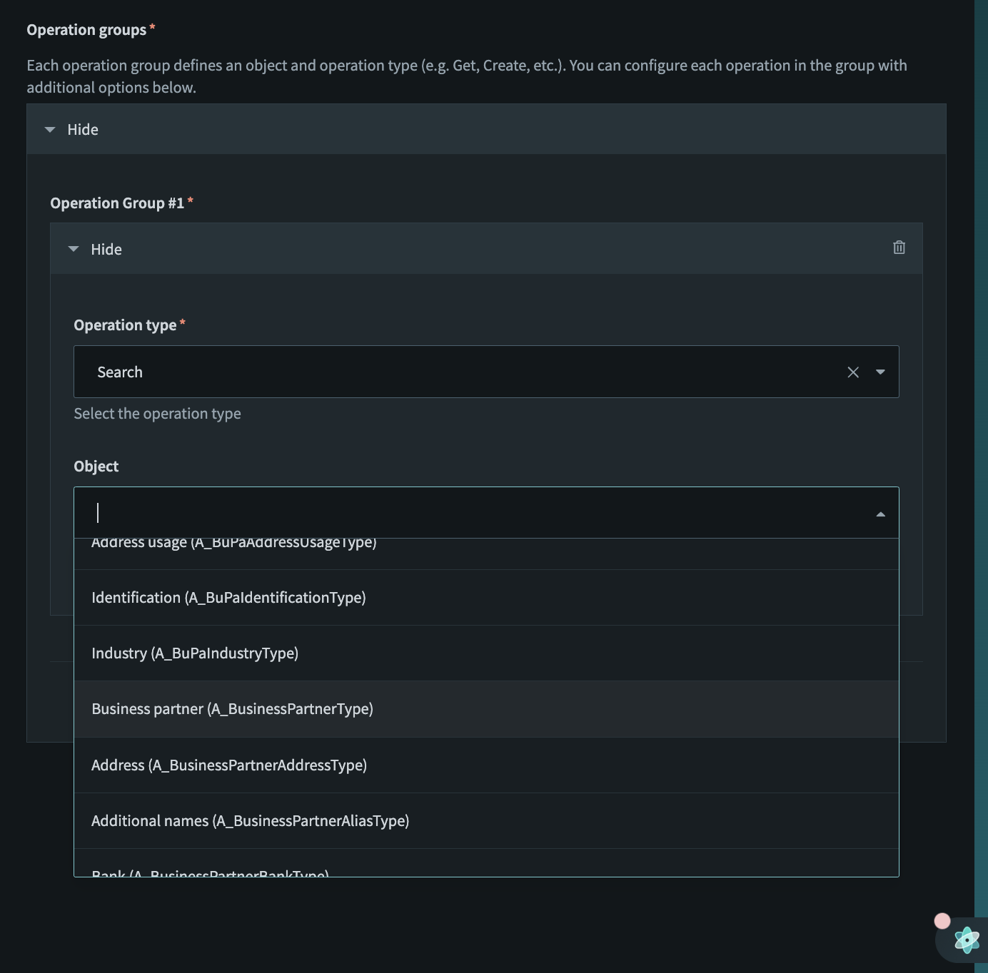

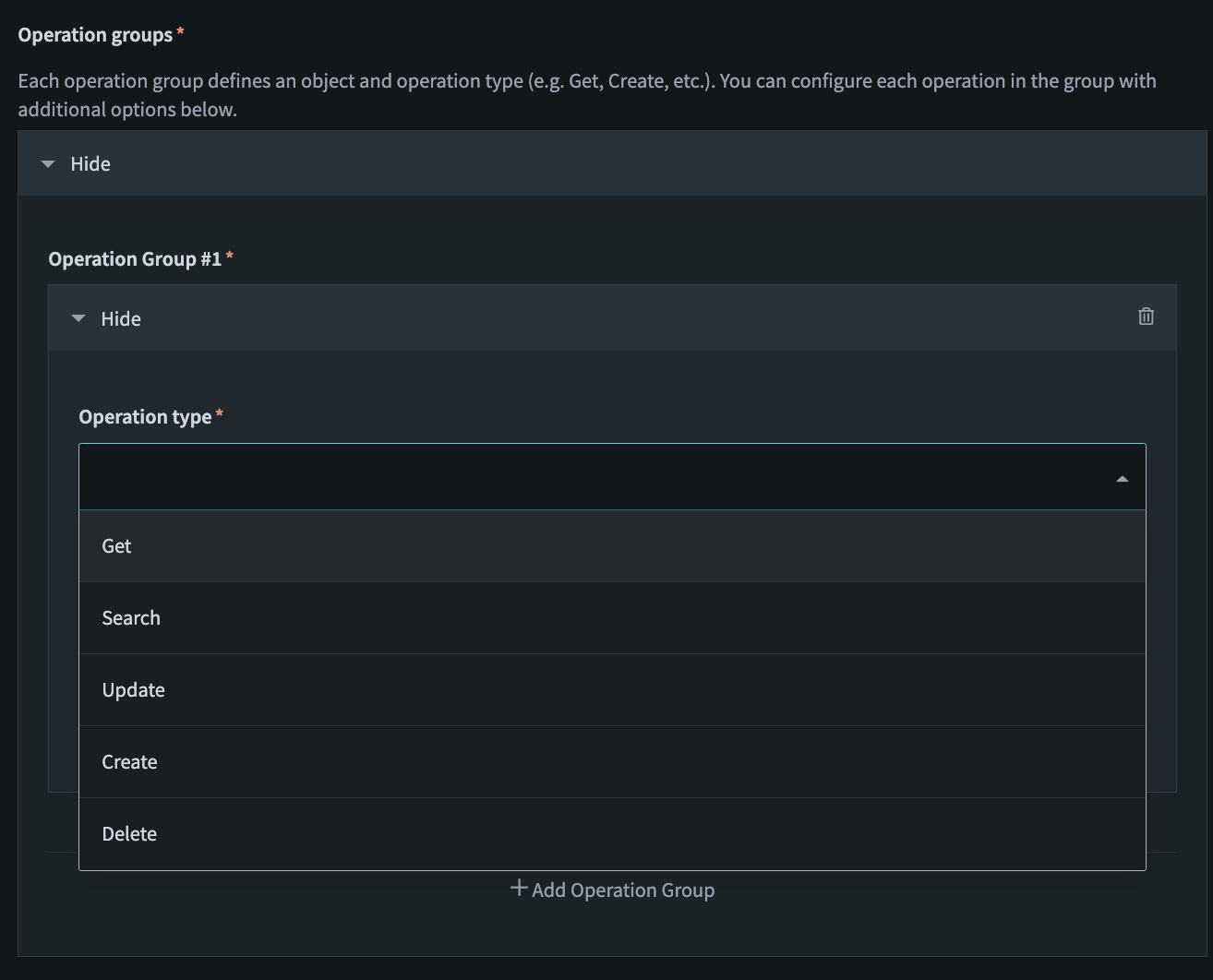

The uniqueness of the schema generated would be a combination of operation type and object selected for a particular service in the batch action.
Select operation type and object. OData batch operation typeSelect operation type
OData batch objectSelect object

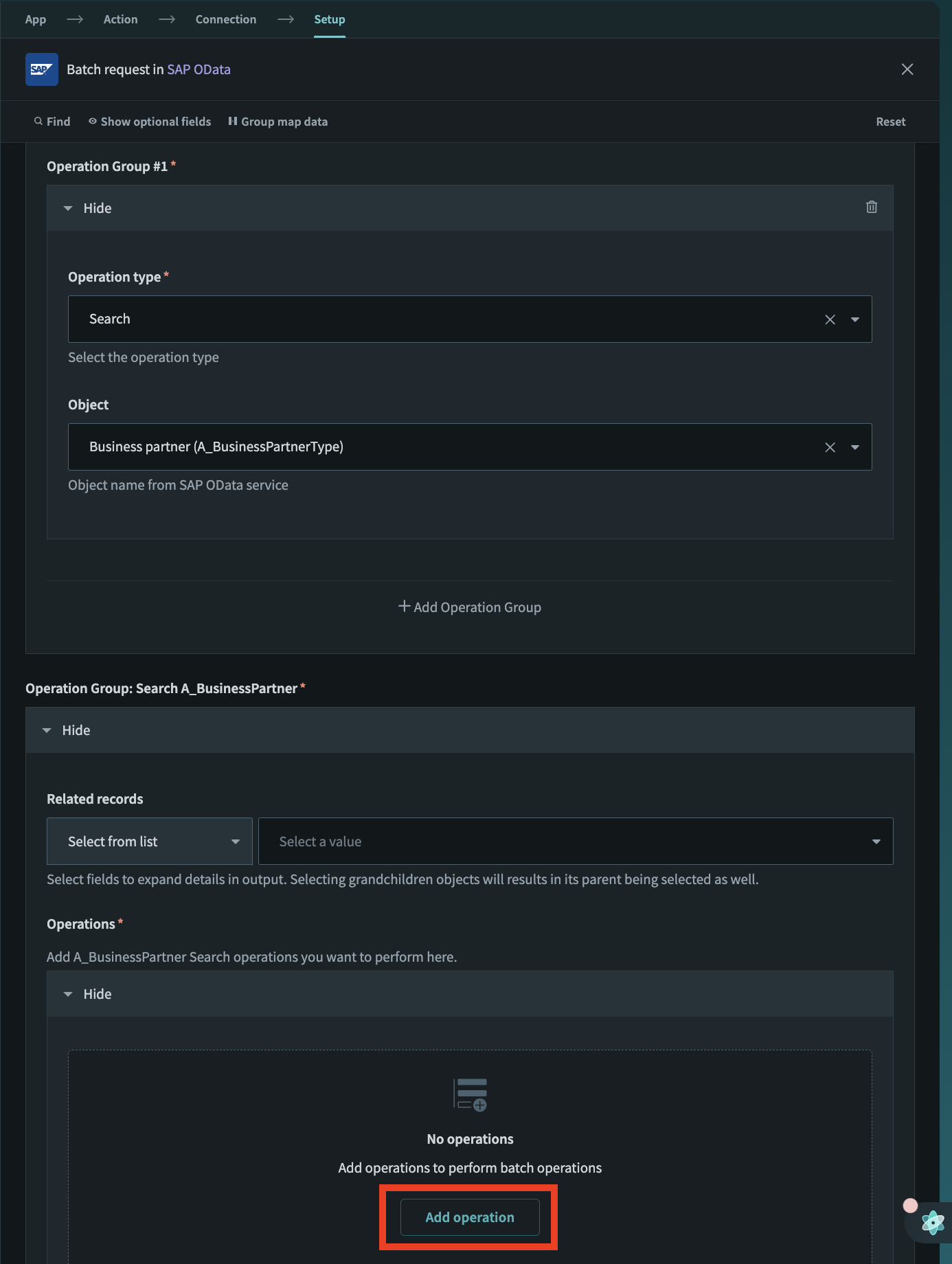

Add more operation groups to be processed in batch by repeating steps 2 and 3.
For every operation group added, there will be an extended schema created where must add operation.
OData batch operationAdd operation
You can add multiple operations for the same operation group with a unique operation type and object. Also, within the operation, you can add optional fields to be used for respective use-cases. OData batch multiple operationOperations

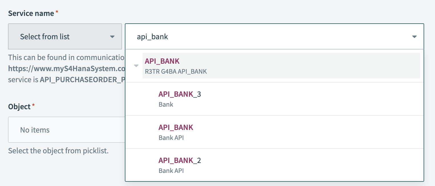

You can confirm the service group name in the API Business Hub documentation. Visit SAP's documentation and locate the Service Group Name in the Attributes tab.
As recommended practice, select the latest API version which can be identified based on the serial number like <service name>_1, <service name>_2, etc. Here, API_BANK_3 is the latest and is corresponding to the service URL https://<S4host>/sap/opu/odata4/sap/api_bank/srvd_a2x/sap/bank/0003/.
If it is not shown in the drop-down due to the limited items we populate in the drop-down, then enter the Service Name manually. For example, if the service URL is https://<S4host>/sap/opu/odata4/sap/api_bank/srvd_a2x/sap/bank/0003/, then service name would be api_bank/srvd_a2x/sap/bank/0003/.
OData v4 action manualEntering service name manually

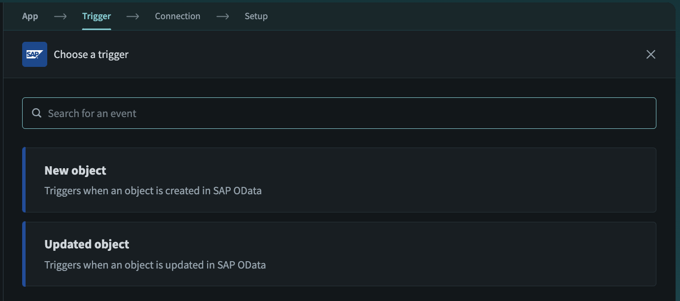

Triggers supported
The SAP OData connector supports the following triggers:
  • New object - Triggers when an object is created in SAP.
  • Updated object - Triggers when an object is updated in SAP.
triggers supportedSAP OData triggers
