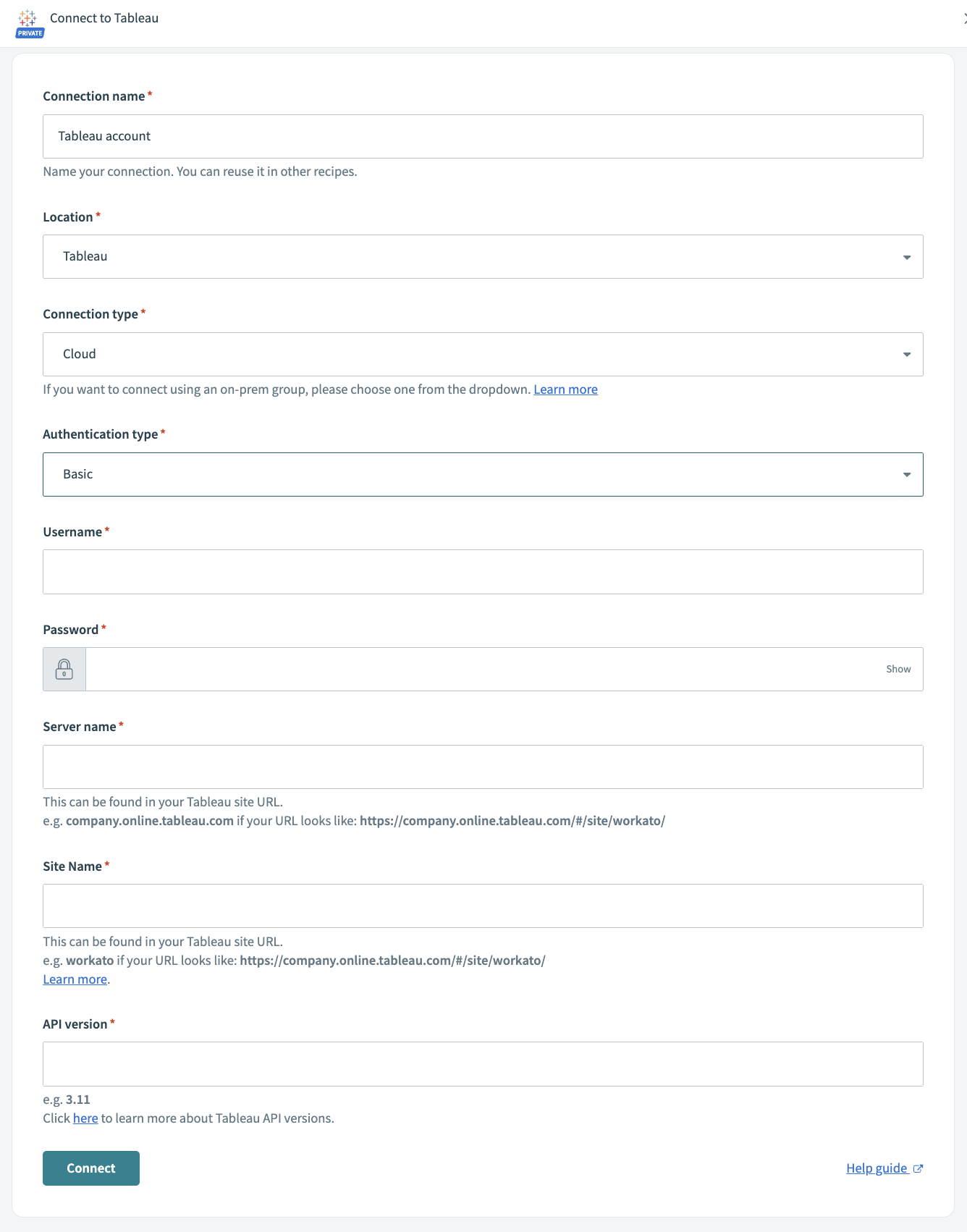

How to connect to Tableau on Workato ​
Complete the following steps to establish a connection to Tableau:
Click Create > Connection.
Search for and select Tableau as your connection in the New connection page.
Provide a name for your connection in the Connection name field. Tableau connectionTableau connection fields
Select either Cloud or On-prem group as your Connection type.
Select the Authentication type from the drop-down list.
Provide the Server name. You can find the server name in the Tableau site URL. For example, a server with the name company.online.tableau.com will have the URL https://company.online.tableau.com/#/site/workato/.
Enter the Site name. You can find the site name in the Tableau site URL. For example, a site with the name workato will have the URL https://company.online.tableau.com/#/site/workato/.
Enter the Tableau API version.
Click Connect to establish the connection.
