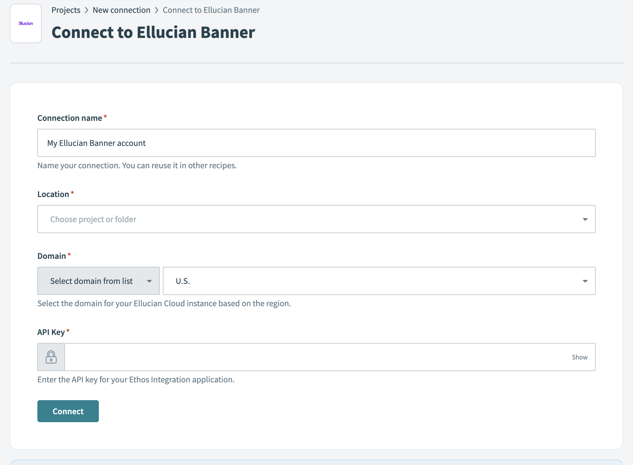

# Connect to Ellucian Banner
Complete the following steps to connect to Ellucian Banner as a data pipeline source. This connection enables the pipeline to extract and sync records from your Ellucian environment.
Select Create > Connection.
Search for and select Ellucian Banner on the New connection page.
Ellucian Banner connection setupEllucian Banner connection setup
Select Cloud in the Connection type field, unless you need to connect through an on-prem group.
Select your region from the Domain drop-down. Choose the domain based on the location of your Ellucian Cloud instance (for example, U.S., Canada, or Europe).
Enter your API key. This is the API key for your Ethos Integration application in Ellucian.
Select Connect to verify and store the connection.
