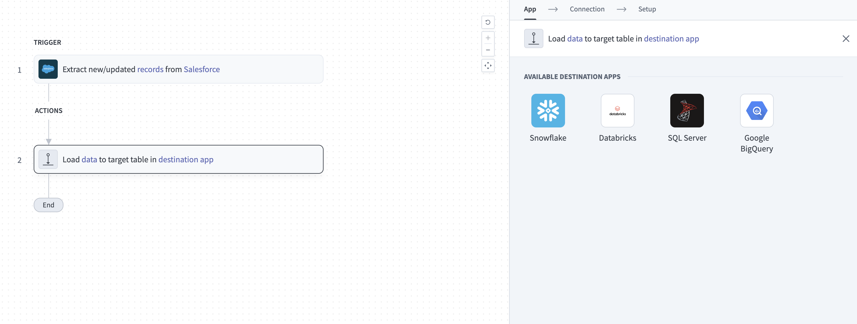

Sign in to your Workato account and open the data pipeline recipe you plan to configure.
Click the Load data to target table in destination app action. This action defines how the pipeline replicates data in the destination.
Load data to target table in destination appConfigure the Load data to target table in destination app action
Select Google BigQuery from the list of available destination apps.

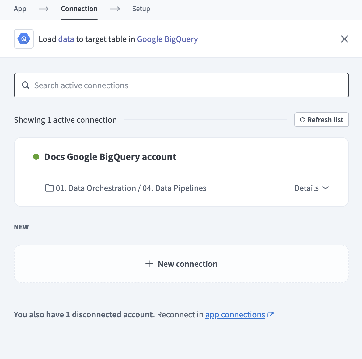

Choose the Google BigQuery connection you plan to use for this pipeline. Alternatively, click + New connection to create a new connection.

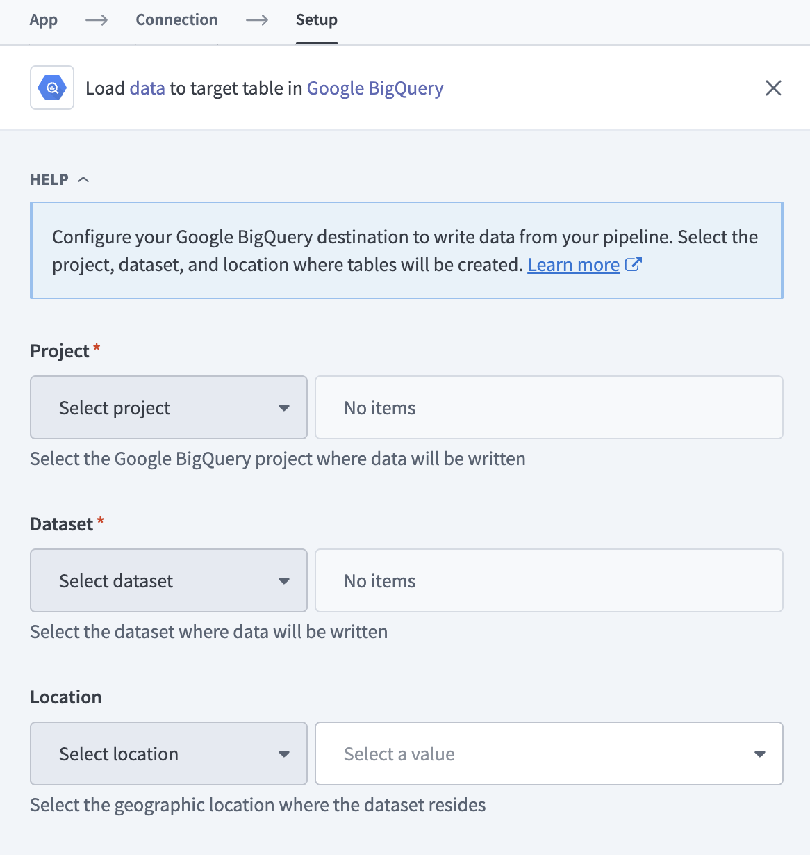

Use the Project drop-down to select the Google BigQuery project where data is written.
Configure your Google BigQuery destinationConfigure your Google BigQuery destination
Use the Dataset drop-down to select the dataset where data is written.
Use the Location drop-down to select the geographic location where the dataset resides.
Select Save to save the pipeline.
