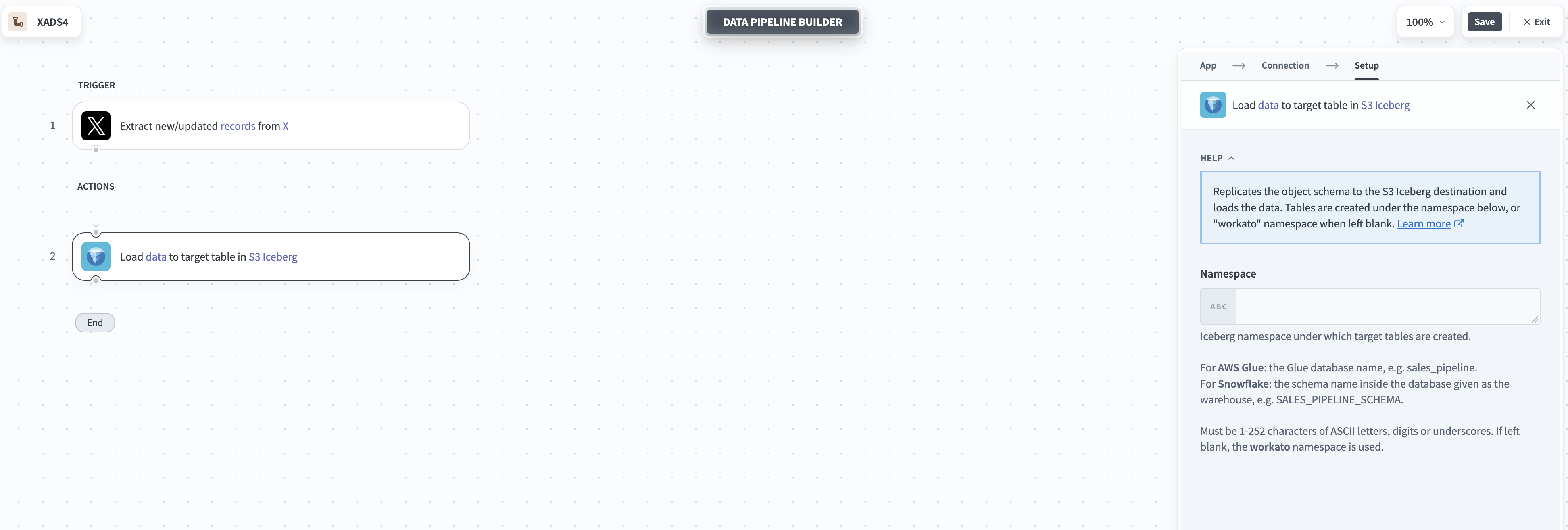

Configure the destination action ​
Ensure the destination warehouse and catalog are newly created and empty before you start the pipeline. This prevents errors during the initial sync and allows the pipeline to create destination tables without conflicts.
Click the Load data to target table in destination app action. This action defines how the pipeline replicates data in the destination.
Select S3 Iceberg from the list of available destination apps.
Choose the S3 Iceberg connection you plan to use for this pipeline. Alternatively, click + New connection to create a new connection.
The Load data to target table in destination app action automatically replicates the object schema from the source to S3 Iceberg. Explicit field mapping isn't required.
Enter a value in the Namespace field. This sets the Iceberg namespace under which target tables are created:
  • AWS Glue: the Glue database name, such as sales_pipeline. Glue database names must be 1-255 characters. Refer to the AWS Glue Table API reference for the full naming pattern.
  • REST catalogs: a catalog-specific value. For Snowflake, enter the schema name inside the database given as the warehouse, such as SALES_PIPELINE_SCHEMA. Naming limits depend on your catalog, so refer to your catalog vendor's identifier rules.
Configure S3 Iceberg destinationConfigure S3 Iceberg destination
Workato creates tables under the workato namespace if you leave this field blank.
Select Save to save the pipeline.
