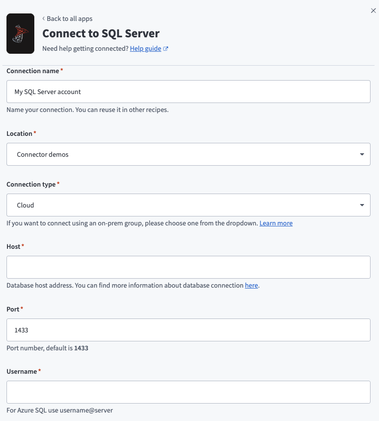

Connect to SQL Server ​
Complete the following steps to connect to SQL Server as a data pipeline destination. This connection allows the pipeline to write records into a target table in your SQL Server instance.
Search for SQL Server and select it as your app.
SQL Server connection setupSQL Server connection setup
Select Cloud in the Connection type field, unless you need to connect through an on-prem group.
Enter the URL of your hosted server in the Host field.
Enter the port number your server runs on in the Port field. The default port for SQL Server is 1433.
Enter the username to connect to SQL Server in the Username field.
Enter the password to connect to SQL Server in the Password field.
Enter the name of the SQL Server database you plan to connect to in the Database field.
Optional. Specify whether you're connecting to an Azure SQL instance in the Azure SQL field. The default is No.
12
Optional. Expand the Advanced settings field to configure additional settings:
FieldDescription
Use improved datetime handlingEnable enhanced handling of datetime, datetime2, and datetimeoffset datatypes in SQL Server. Defaults to true. Refer to the Improved datetime handling section for more information.
Database timezoneSet your database's local timezone. When timezones are provided for datetime and datetime2 datatypes, values convert to this timezone before insertion. Default is UTC.
13
Select Connect to verify and store the connection.

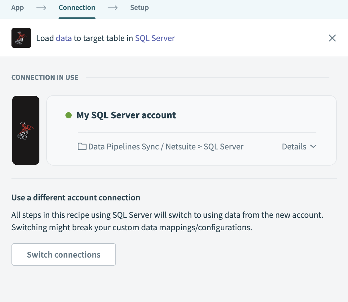

Configure the destination action ​
Before you start the pipeline, ensure the schema in SQL Server is newly created and empty. This prevents errors during the initial sync and allows the pipeline to create destination tables without conflicts.
Click the Load data to target table in destination app action. This action defines how the pipeline replicates data in the destination.
Load data to target table in destination appConfigure the Load data to target table in destination app action
Select SQL Server from the list of available destination apps.
Choose the SQL Server connection you plan to use for this pipeline. Alternatively, click + New connection to create a new connection.
Choose a SQL Server connectionChoose a SQL Server connection
The Load data to target table in destination app action automatically replicates the object schema from the source to SQL Server. Explicit field mapping isn't required.
Workato pipelines automatically create destination tables based on the source schema. The pipeline also creates a stage and temporary tables to support data replication and update operations.
Select Save to save the pipeline.
