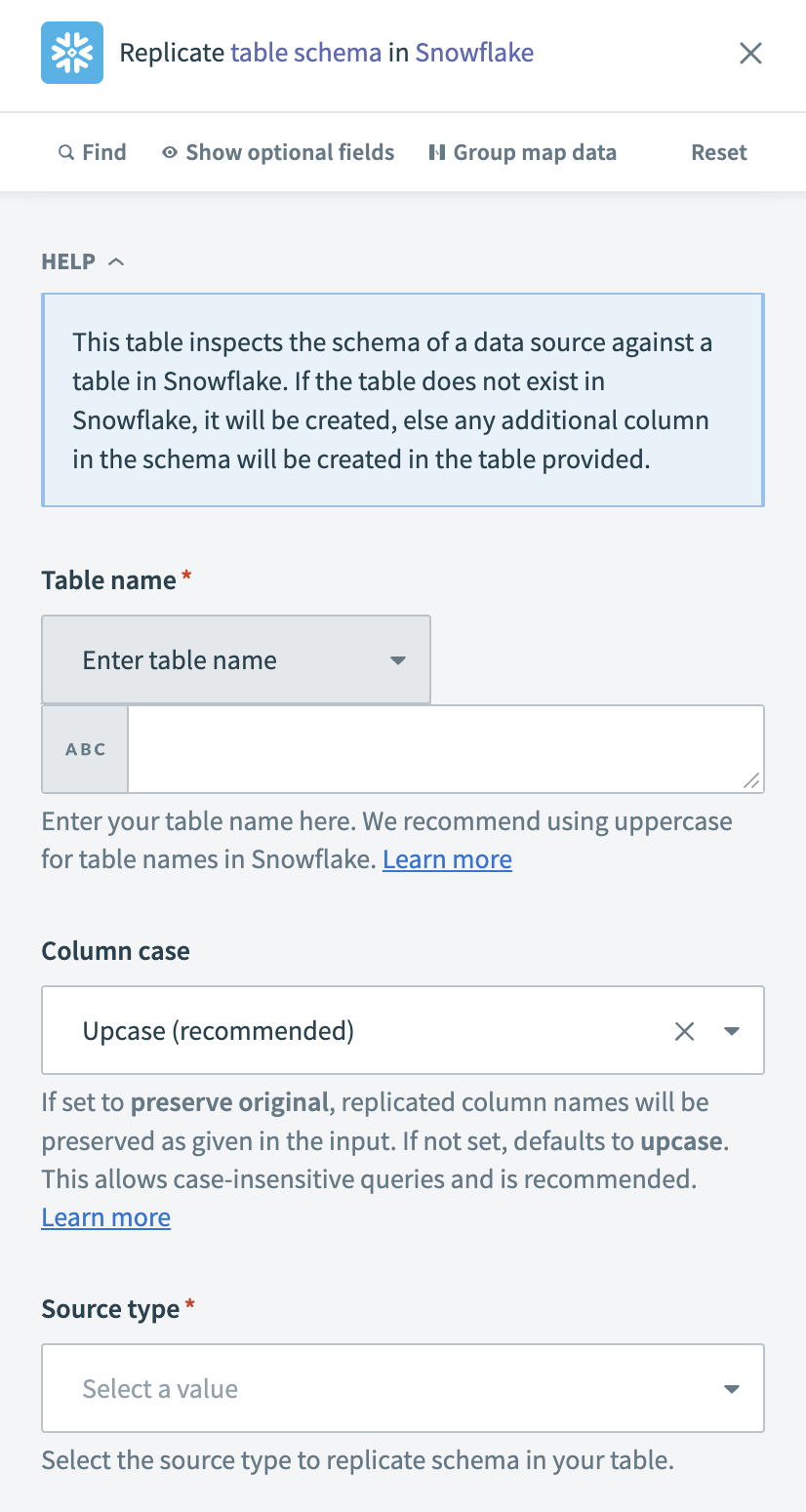

Go to Workato and configure the Replicate schema action for Snowflake.
Replicate schema actionConfigure the Replicate schema action
Select the destination table in Snowflake in the Table name field. You can select from a list of existing tables in Snowflake, or enter a table name manually.
CASE-SENSITIVITY IN TABLE NAMES
Table names are case-sensitive because Workato applies double-quotes around them. This allows you to use special characters in table names. Refer to the Double-quoted identifiers documentation for more information.
Optional. Select how to format replicated column names in the Column case field.
Choose whether the Source type is CSV or Schema.
Configure the following schema fields based on your selected data type:
Optional. Enter one or more unique keys to identify duplicate rows in the Key columns field.
Optional. Specify one or more columns to exclude from replication in the Exclude columns field.
